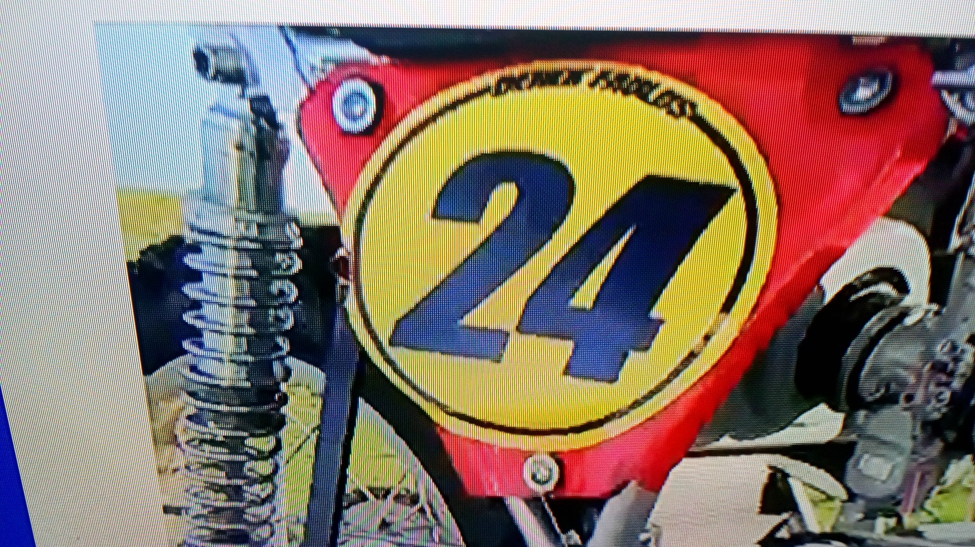

Old man Posted August 14, 2020 Report Share Posted August 14, 2020 Hi wanting to spray the side panel's so it's matches the Tank as believe the yellow circle in the same orange red would look nice. Seen a Pursang with the colours on Youtube .(Photo ) Don't know wear to find the information to tell me the correct colour. Any help would be appreciated or point wear I can do my homework would be great. Thank-You Quote Link to comment Share on other sites More sharing options...
bullylover Posted August 15, 2020 Report Share Posted August 15, 2020 The Bultaco Red in PPG paints is Torch Red. Code DAR 74013. Thanks to Bultaco Classic for this information. I think In Motion also has spray cans of this red. The yellow is on the sidecovers because that is the universal colour that an open class motorcrosser has to have on all of its numberplates. 1 Quote Link to comment Share on other sites More sharing options...

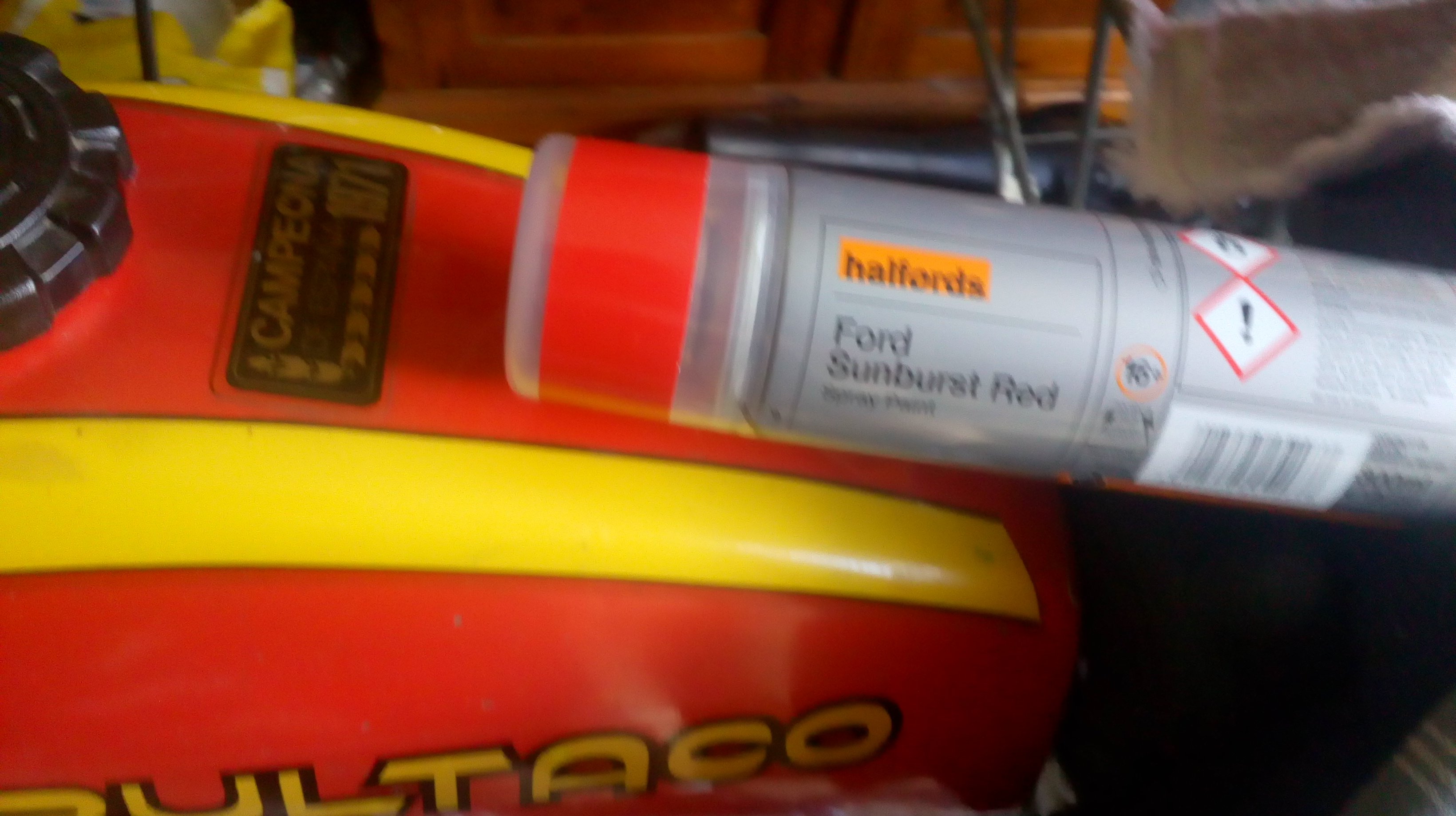

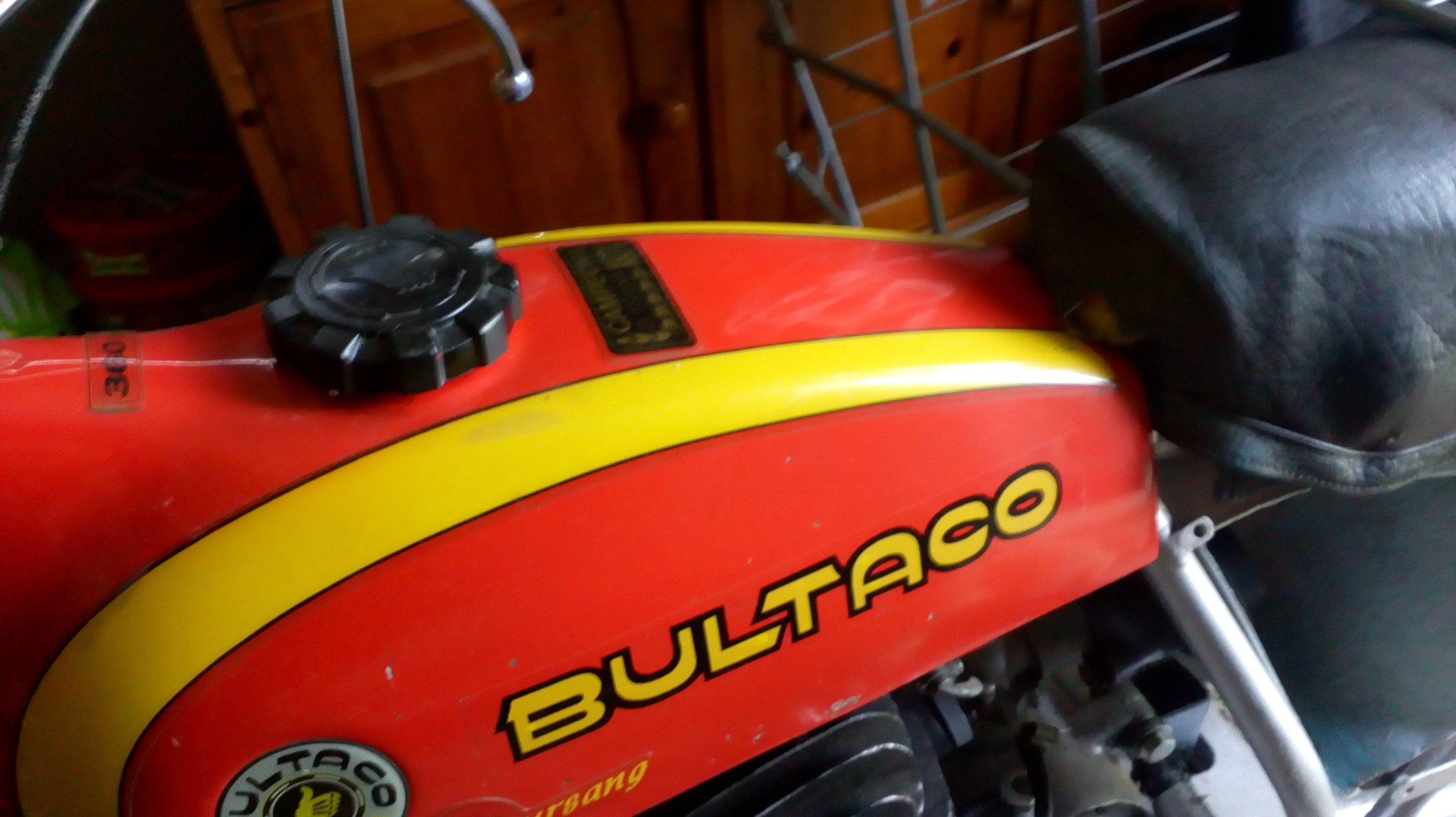

Old man Posted August 15, 2020 Author Report Share Posted August 15, 2020 Hi thanks thought it might be a different colour as bought Torch Red from Halfords when Sprayed the Sherpa tank. The Pursang tank seems more Orange red than Red thoe took photos of tank so going to Halfords today. Looked for Yellow circle to buy to put on side panel but looked very thin paper type so still looking. 1 Quote Link to comment Share on other sites More sharing options...
bullylover Posted August 16, 2020 Report Share Posted August 16, 2020 Every batch of paint that Bultaco bought was a slightly different colour. I can remember in the very early eighties at a Trial over here there were 6 or 7 M199As all lined up in a row and all of the blues were slightly different. 1 Quote Link to comment Share on other sites More sharing options...
Old man Posted August 17, 2020 Author Report Share Posted August 17, 2020 Hi ended up picking Ford Sunburst Red as other can's not much difference in colour. Thank you for help 1 Quote Link to comment Share on other sites More sharing options...
pjw123 Posted August 17, 2020 Report Share Posted August 17, 2020 Take tank down to your local pro auto paint supplier & he will match it perfectly using colour chips. Underside might not be faded. He should be able to mix you up 1/4 or 1/2 litre of 2K base coat, which can then be sprayed & clear coated with 2k clear lacquer. 2K Clear coat most important, as it provides protection from fuel spills. (same as your car). Rattle can finish : cheaper, finish questionable & won't last very long. NB, seal tank internall & only have fuel in it while you are riding it. Otherwise drain completely & vent tank when bike not being used. If you don't do this, you are risking tank going to mush with E5 ethanol fuel. (soon to be E 10 I am hearing , that's 10% not 5% ethanol) Quote Link to comment Share on other sites More sharing options...
