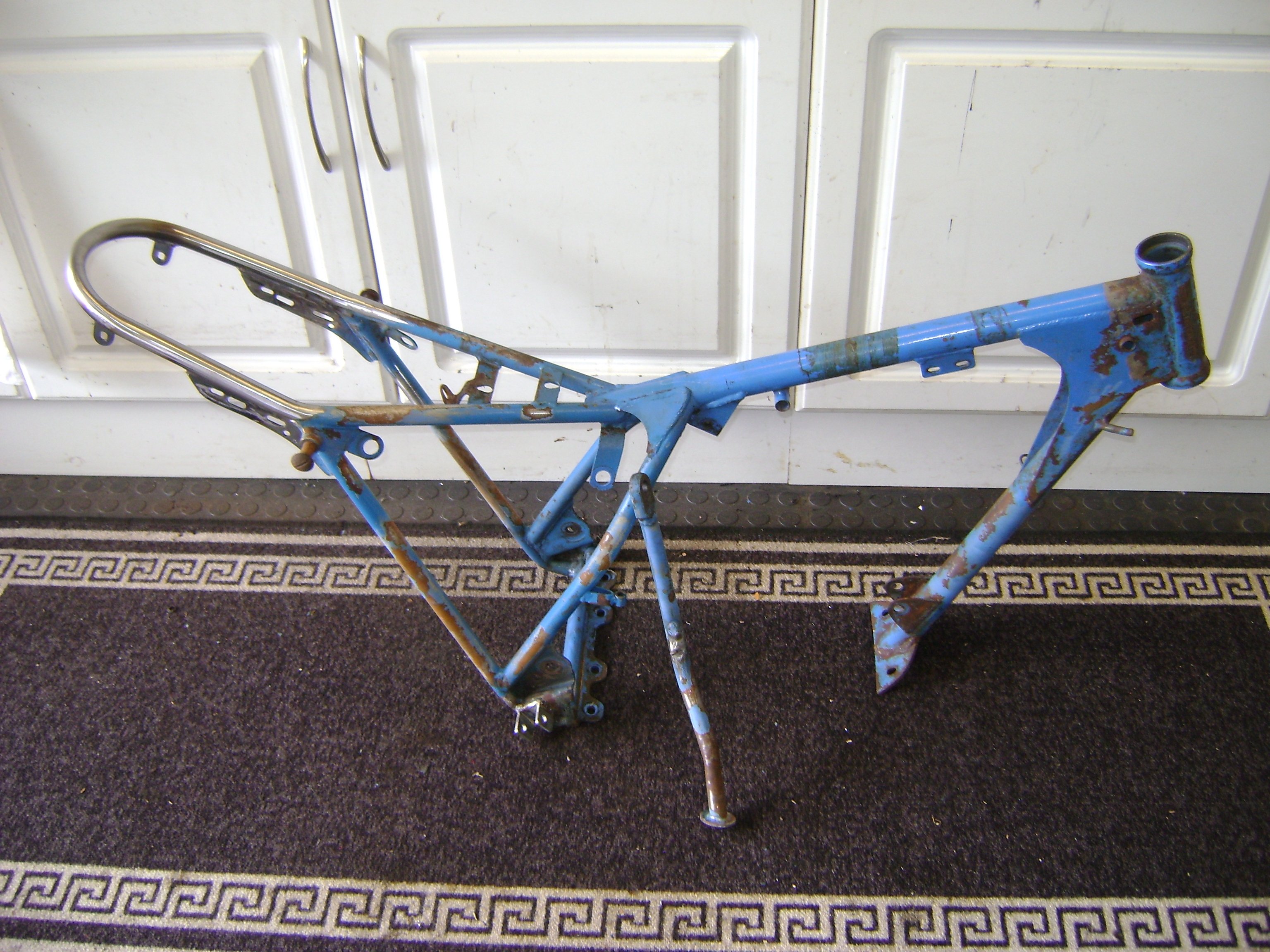

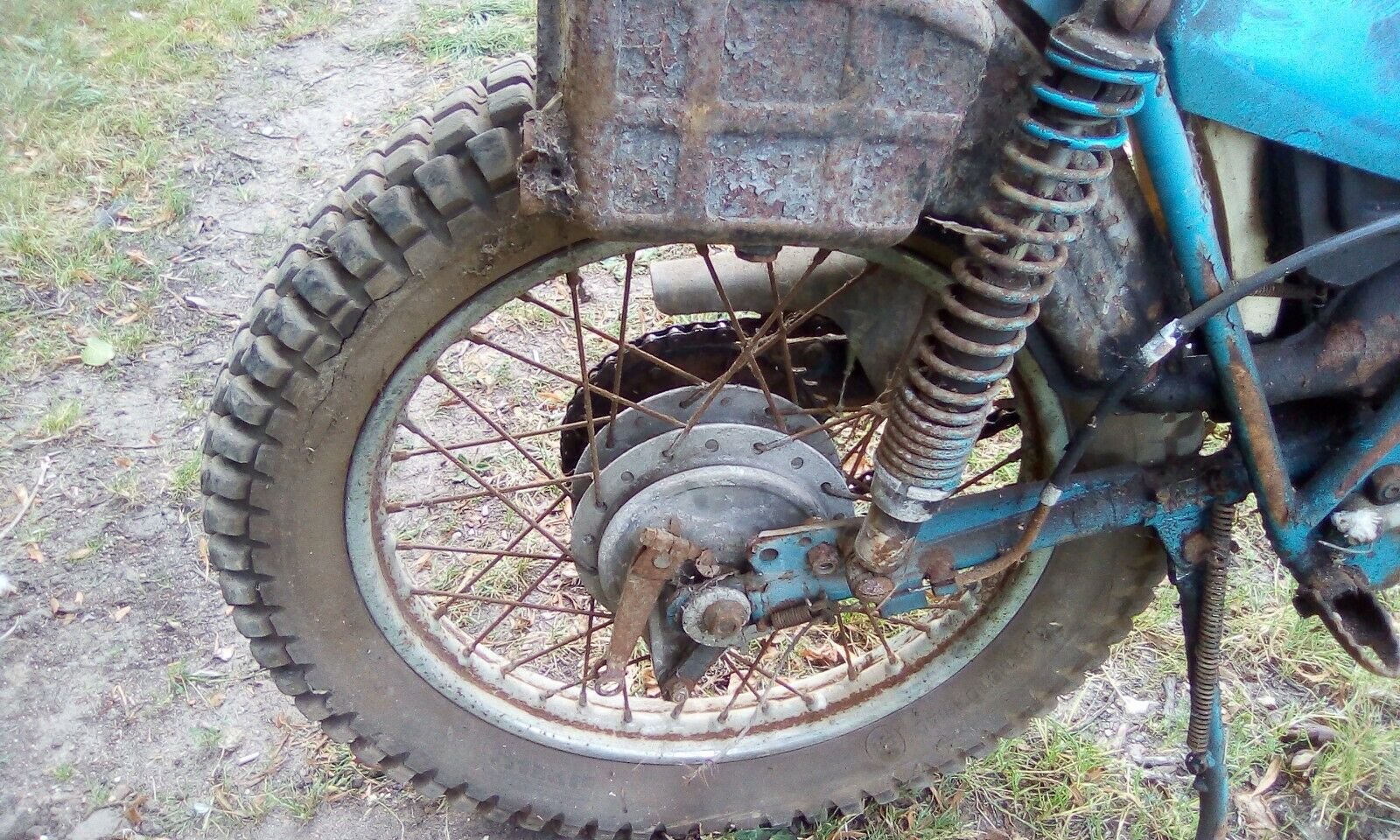

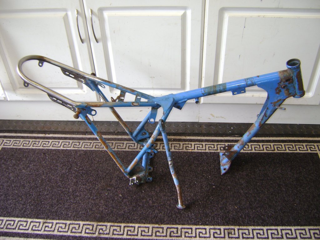

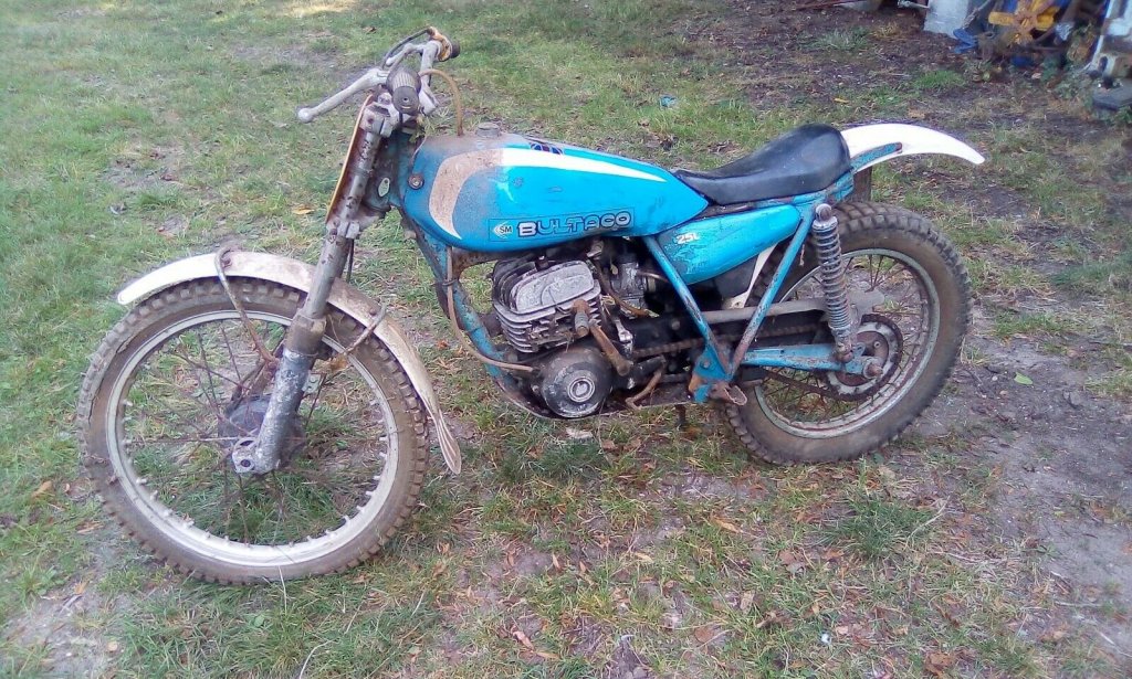

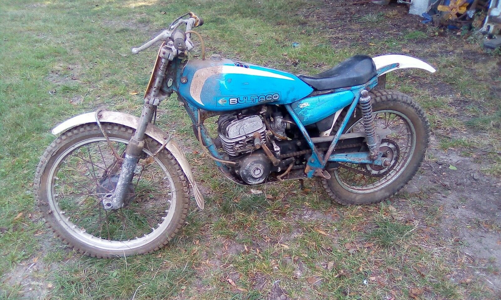

Old Gezzer Posted September 5, 2020 Report Share Posted September 5, 2020 Hi All, Just aquired a Bultaco 198-A I think? to restore. I was told by the seller that the bike has been in a shed for 30 years [And it looks like it]. I am after confimration of which model I have got and a few other questions. The frame Number is RB 198 03580-A Engine number is RM 198 03580-A There are no bottom frame tubes but a factory looking alloy bash plate fitted. Also the rear frame tube is missing and looks as if it is an original alteration. It looks like the 199A Bultaco on the In motion Bike ID page. I will be looking for a Rear Wheel and Brake Plate as there was an unknown wheel fitted very badly in the bike. I will post phots of progress as it happens. Quote Link to comment Share on other sites More sharing options...
gasserguy Posted September 5, 2020 Report Share Posted September 5, 2020 Phone Dave at Bultaco UK with the frame number and he should be able to give you the exact import details and may have the bits you want...... https://www.inmotiontrials.com/ Quote Link to comment Share on other sites More sharing options...

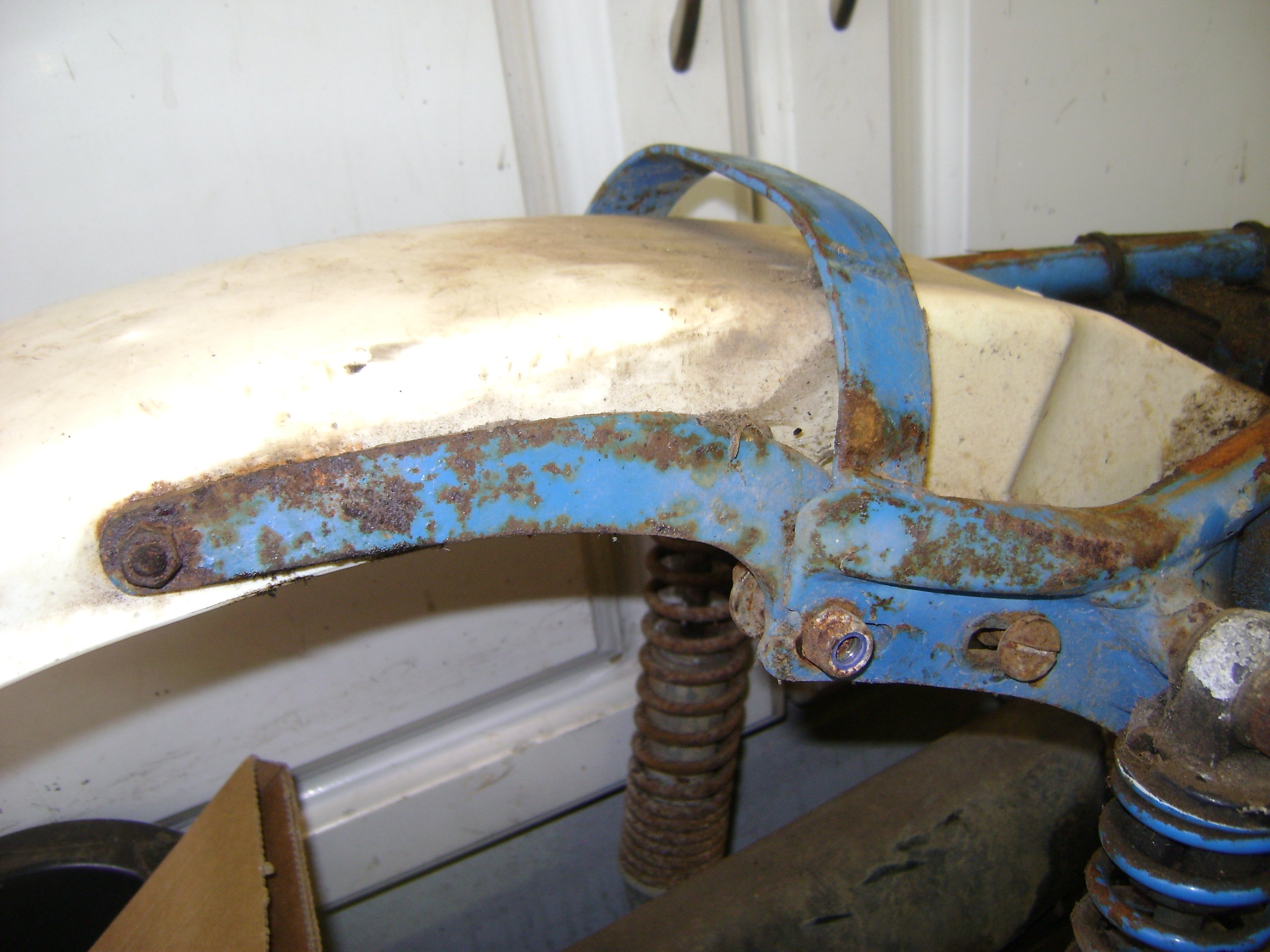

woody Posted September 5, 2020 Report Share Posted September 5, 2020 The model is as you've said, a 198A which is a 1979 model 250 (actually 238cc) No bottom frame tubes and alloy bashplate is correct for this model Rear mudguard loop has been cut off to copy the mod that Comerfords did to the bikes of supported riders at the time, although the bolt on mudguard brackets weren't, that is something a previous owner has done Rear wheel looks Honda. It's not unusual for the bearing housing on the brake side to break up or the chrome to peel off the braking surface in the hub on the Sherpa wheel which maybe why it's been replaced. Or, someone has fitted it so they can have a wheel with a right sided brake so that a right hand pedal can be linked directly to the brake with a rod, although this one has a badly done cable link. With the normal Sherpa wheel a right hand pedal needs a cable to the brake arm which isn't always popular, so some owners use a Yamaha, Montesa or Honda wheel instead to move the brake to the right 4 Quote Link to comment Share on other sites More sharing options...

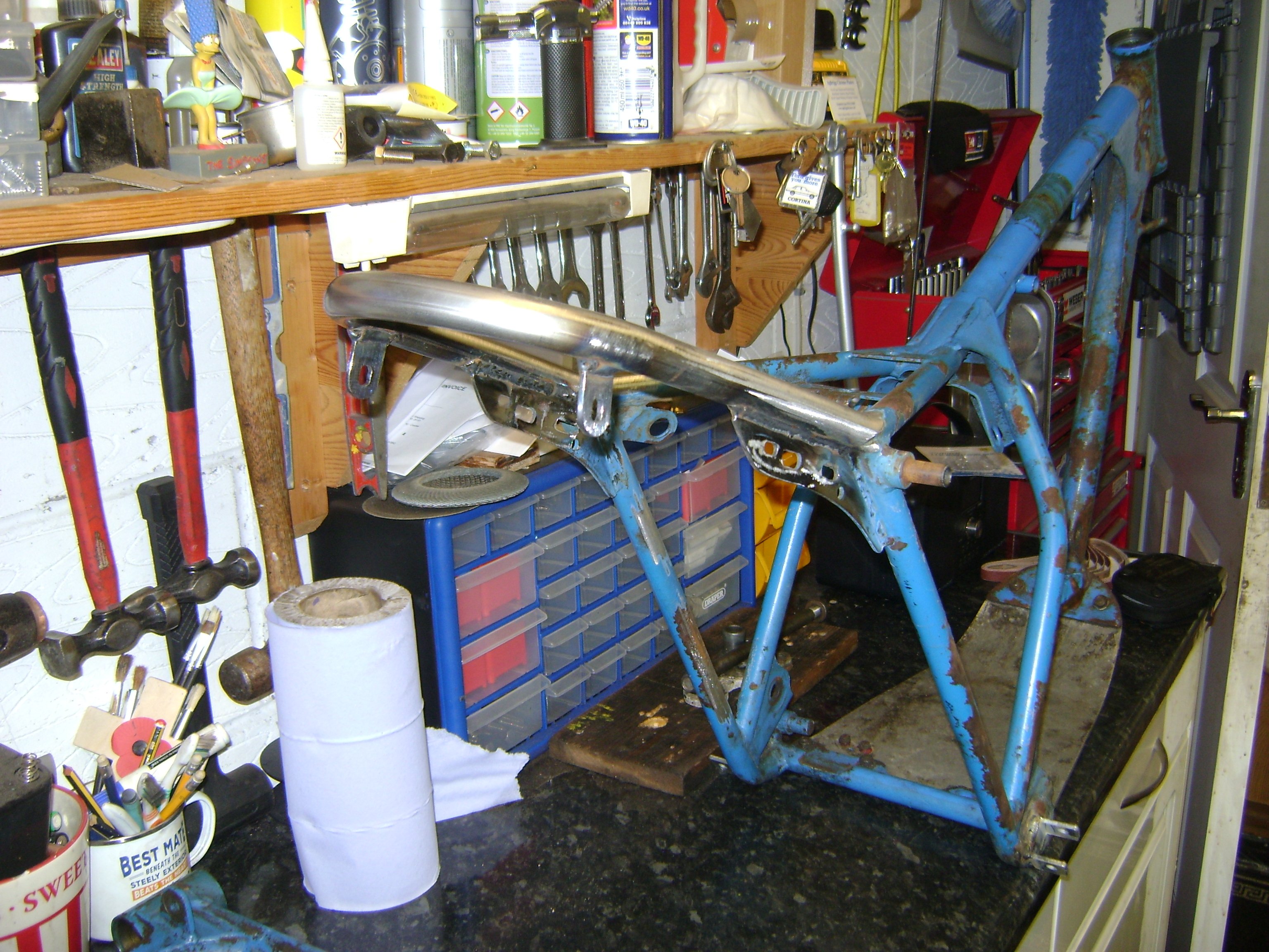

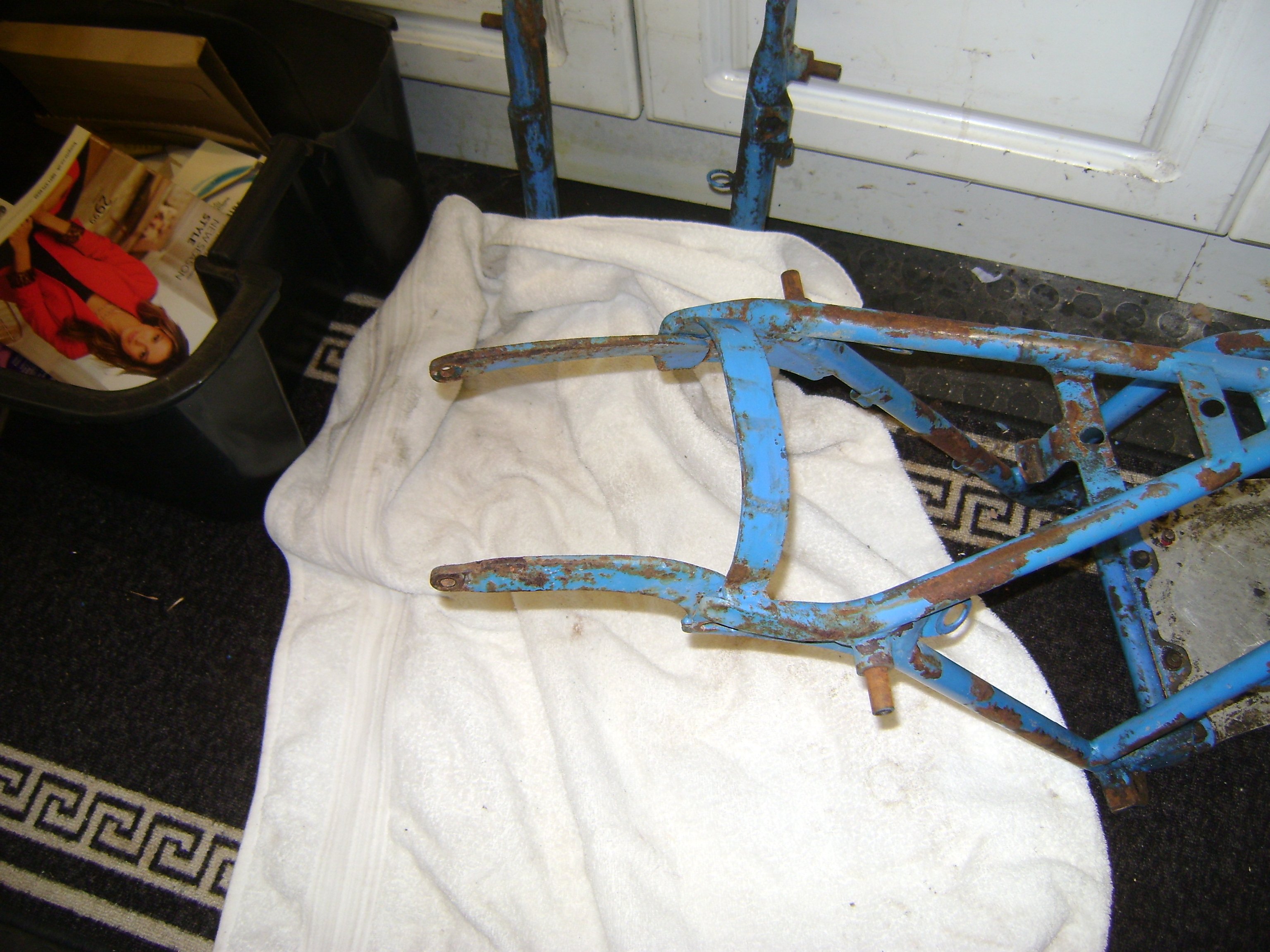

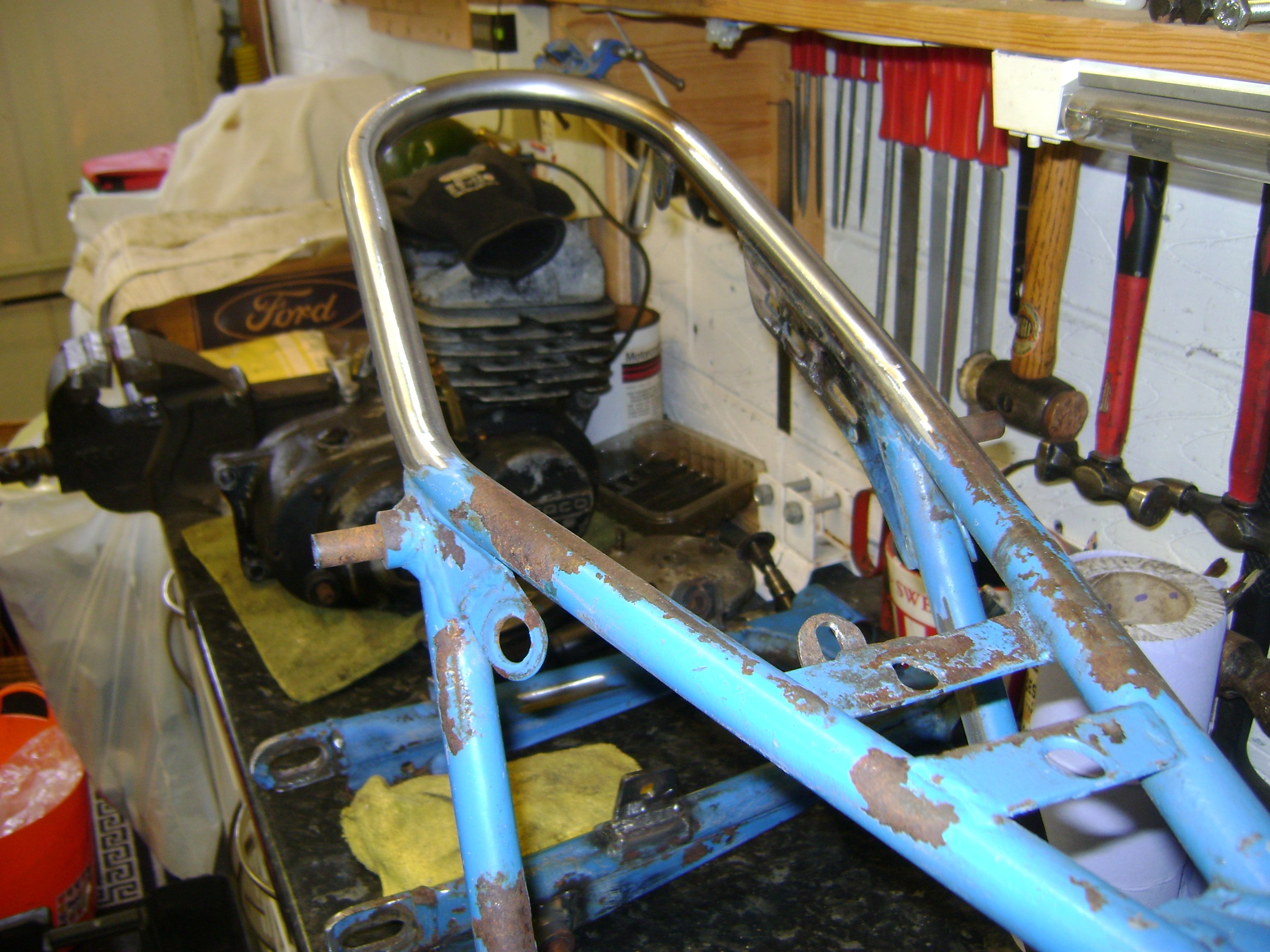

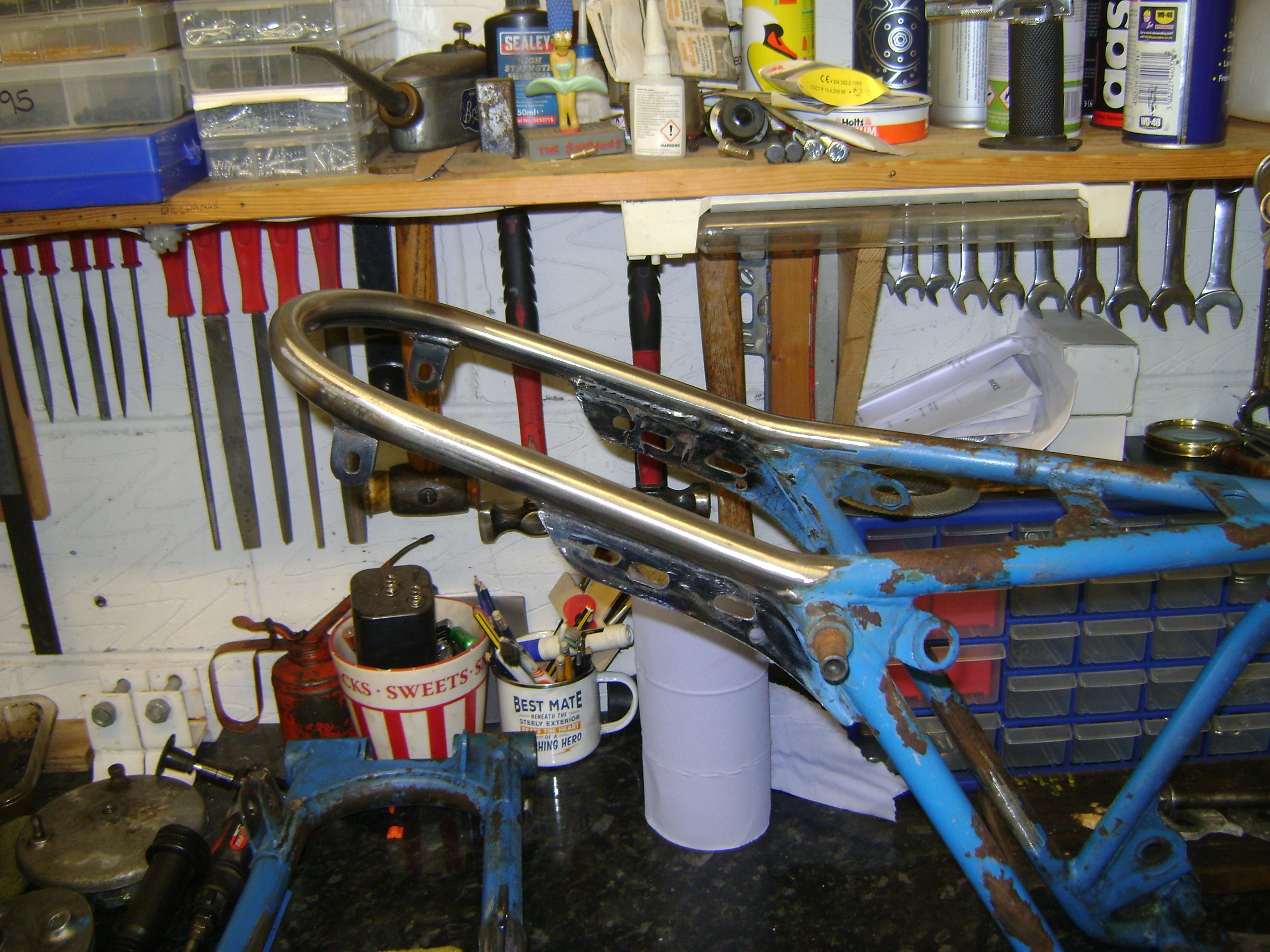

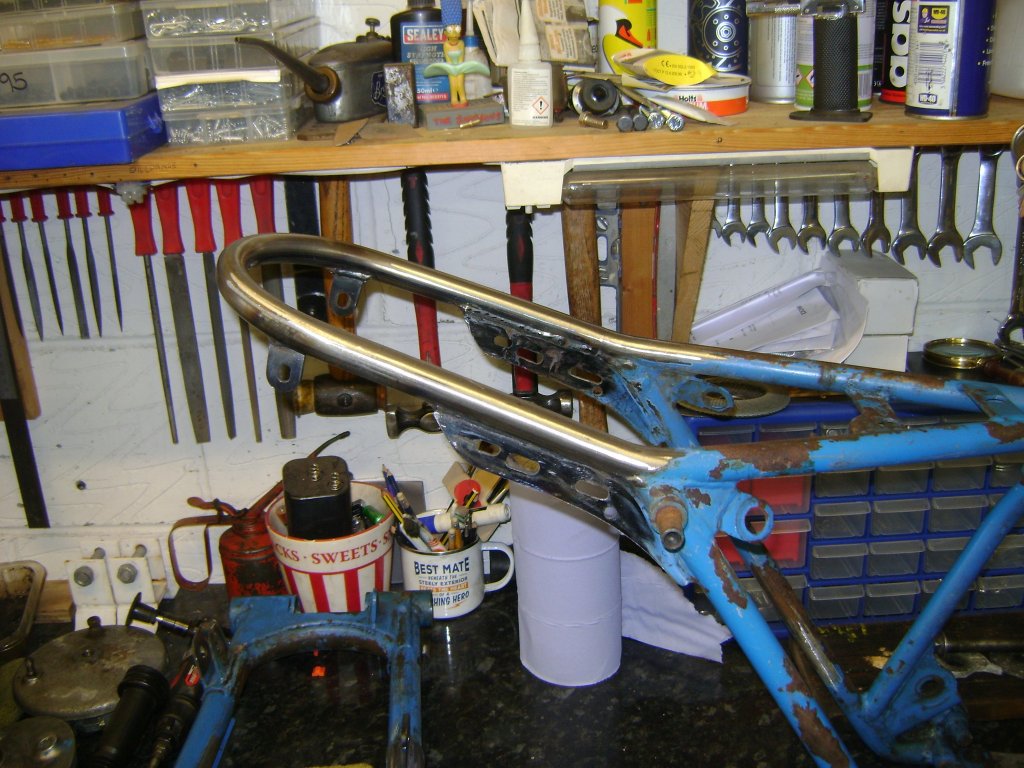

Old Gezzer Posted September 28, 2020 Author Report Share Posted September 28, 2020 (edited) Hi, Progress update on my 198A. I have had the frame away and had the butchered rear frame loop replaced. I have also now got the correct rear wheel but I am still missing a Rear Brake Plate and the "Seal" that fits under the rear sprocket into the rear brake aperture. The work continues. Edited September 29, 2020 by Old Gezzer Spelling! 2 Quote Link to comment Share on other sites More sharing options...
vintagenut Posted September 29, 2020 Report Share Posted September 29, 2020 Wow - beautiful work! It's near impossible (okay - IS impossible) to see where you joined the old tubes to the new loop. Really well done! Looking forward to your continued progress. I'm sure she's gonna be a stunner when done. Enjoy the process ~ C. Quote Link to comment Share on other sites More sharing options...
Old Gezzer Posted September 29, 2020 Author Report Share Posted September 29, 2020 1 hour ago, vintagenut said: Wow - beautiful work! It's near impossible (okay - IS impossible) to see where you joined the old tubes to the new loop. Really well done! Looking forward to your continued progress. I'm sure she's gonna be a stunner when done. Enjoy the process ~ C. As much as I would like to take credit for the replacement rear loop I can't. I am a time served fabricator but small bore tube is not my thing. The work was done through a friend of mine who has knows a fabricator somewhere on Merseyside who does quite a bit of work for him. I have seen other frame repair work he has done and it is very high quality. Not cheap but good work ain't cheap. Quote Link to comment Share on other sites More sharing options...

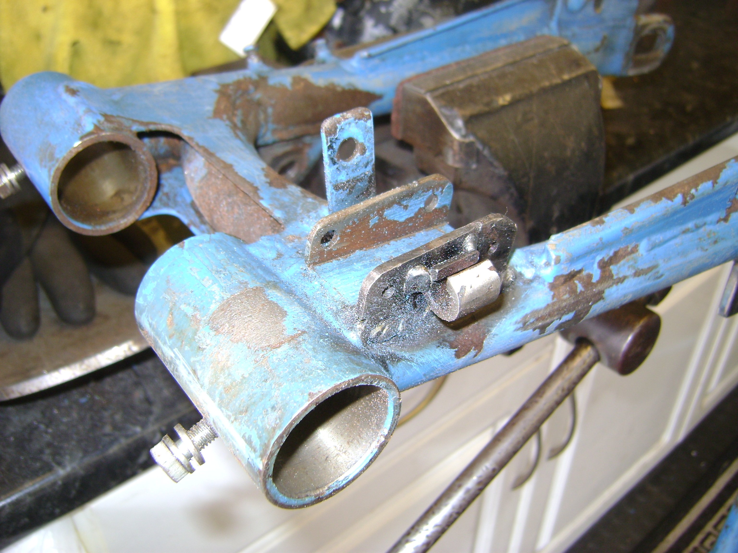

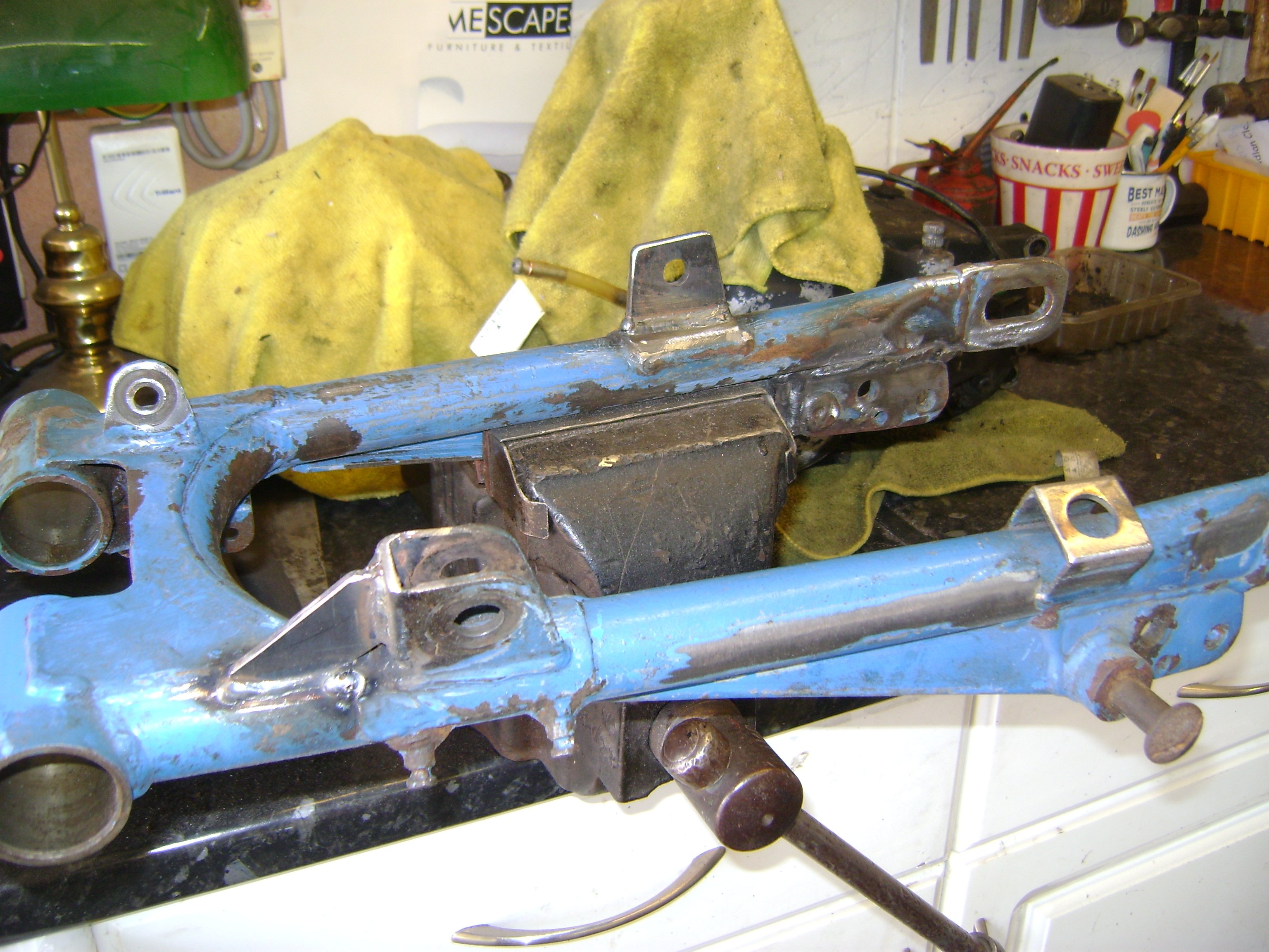

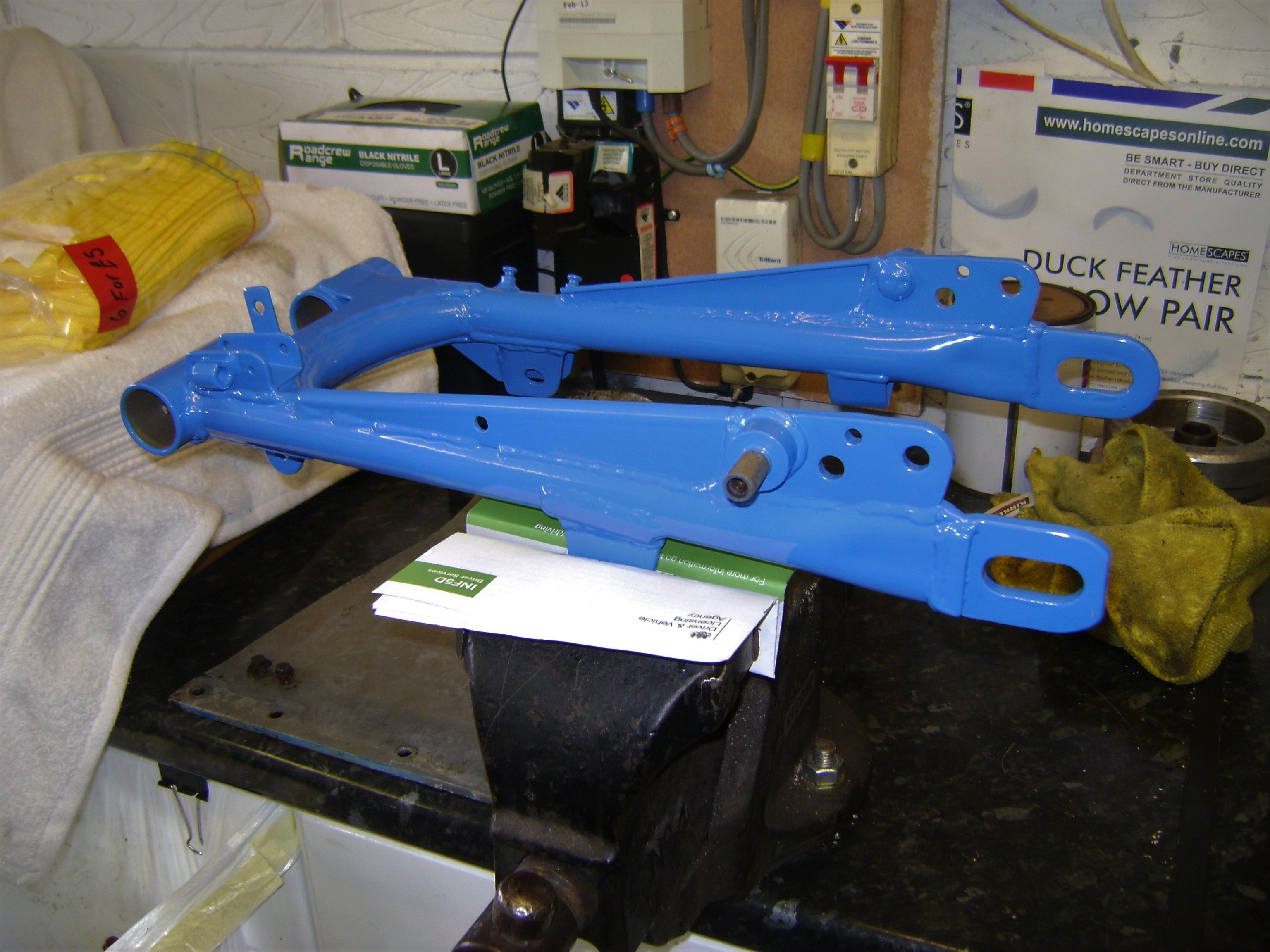

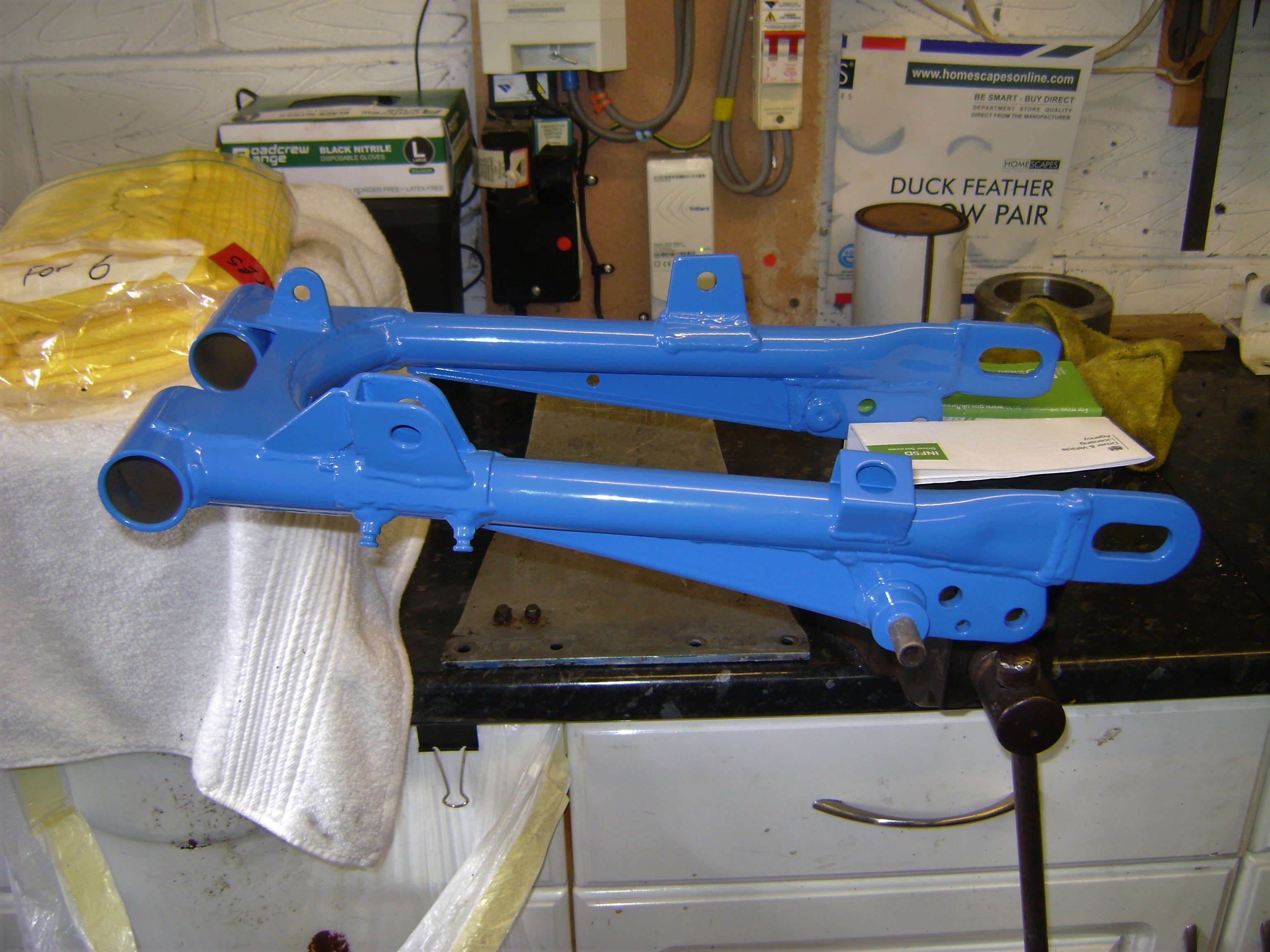

Old Gezzer Posted October 4, 2020 Author Report Share Posted October 4, 2020 Ready to go for Powder Coat in the morning. I have had to do a lot of repair work to the Swing Arm. Replace the chopped of Rear Brake anchor point Repair the mounting point for the side stand rubber Repair and strengthen the side stand mouning bracket Replace the outer side plate for the chain rubber block Replace the front rear brake cable mounting dowel Oh the fun of restoring old abused trials bikes. 2 Quote Link to comment Share on other sites More sharing options...

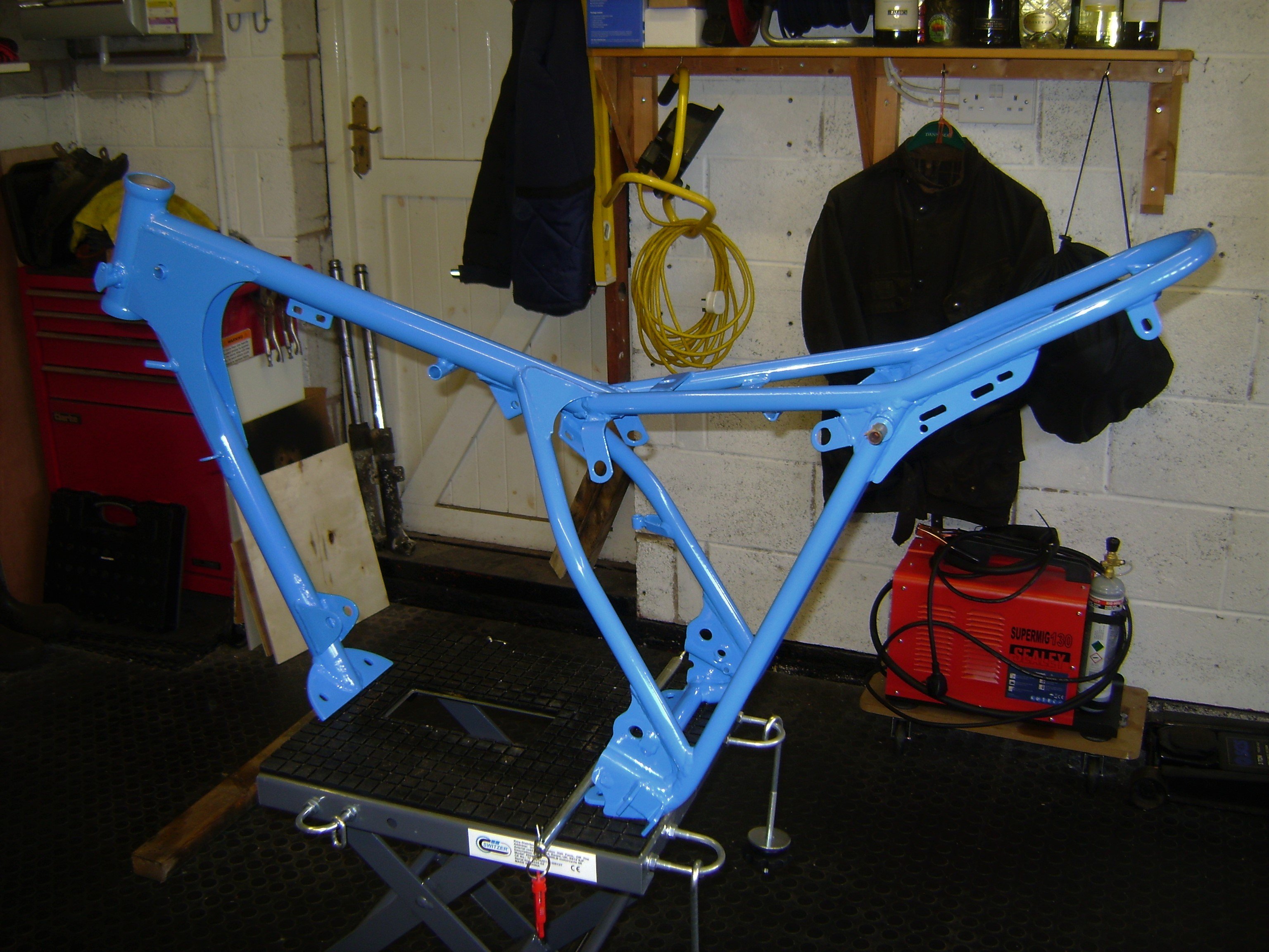

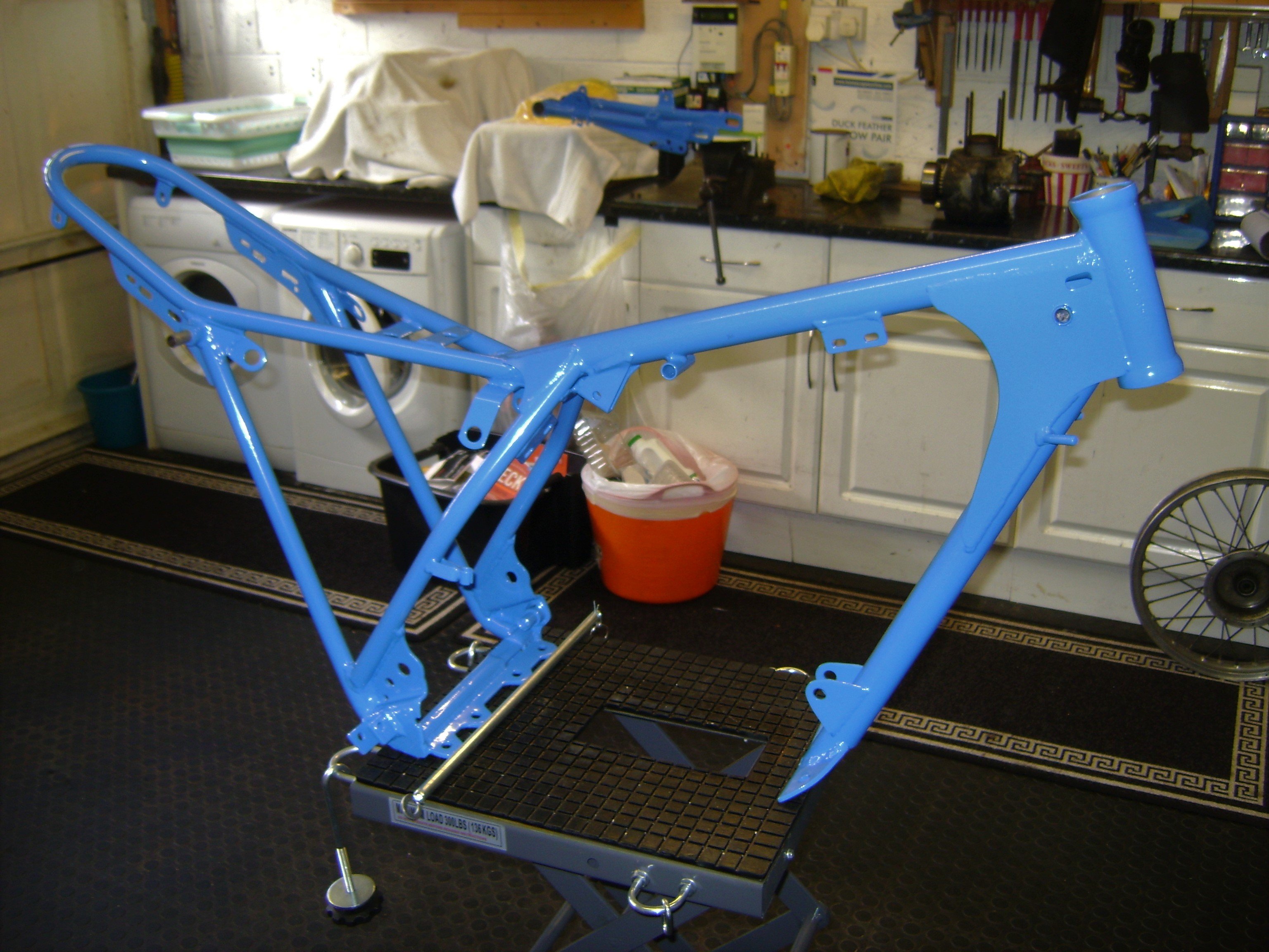

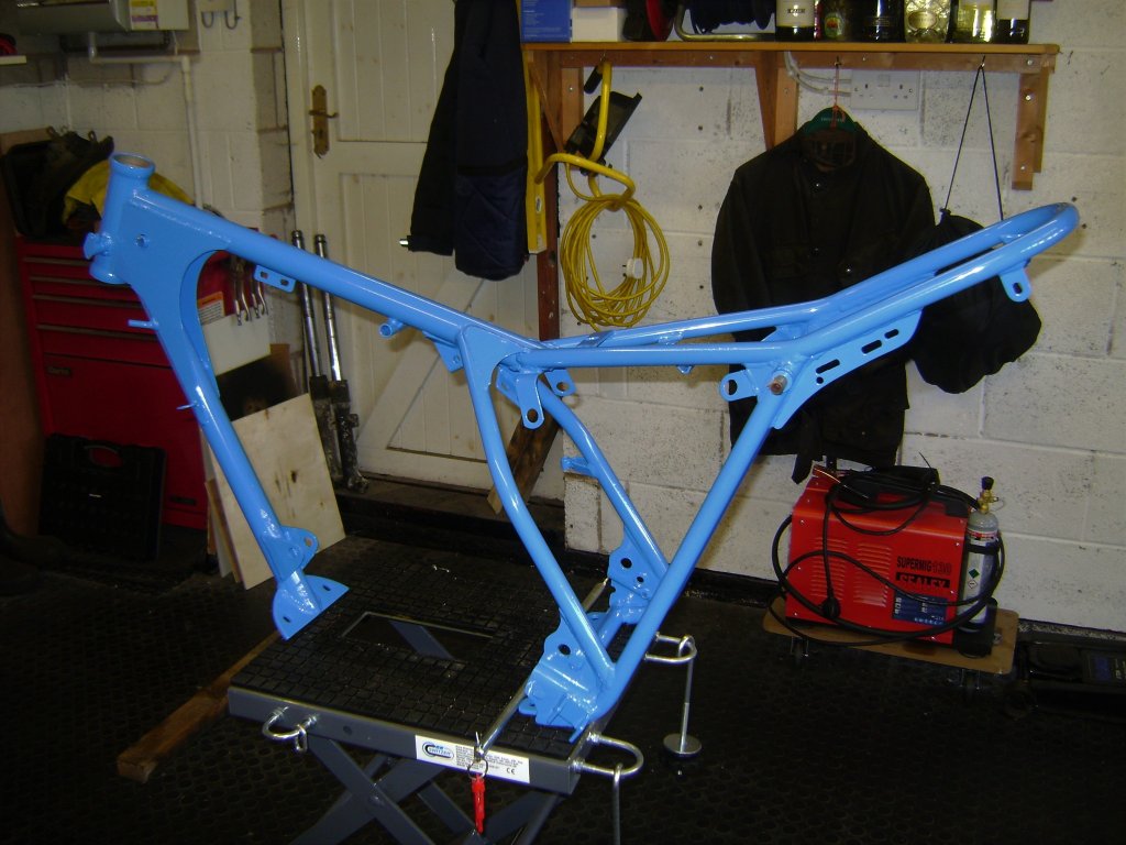

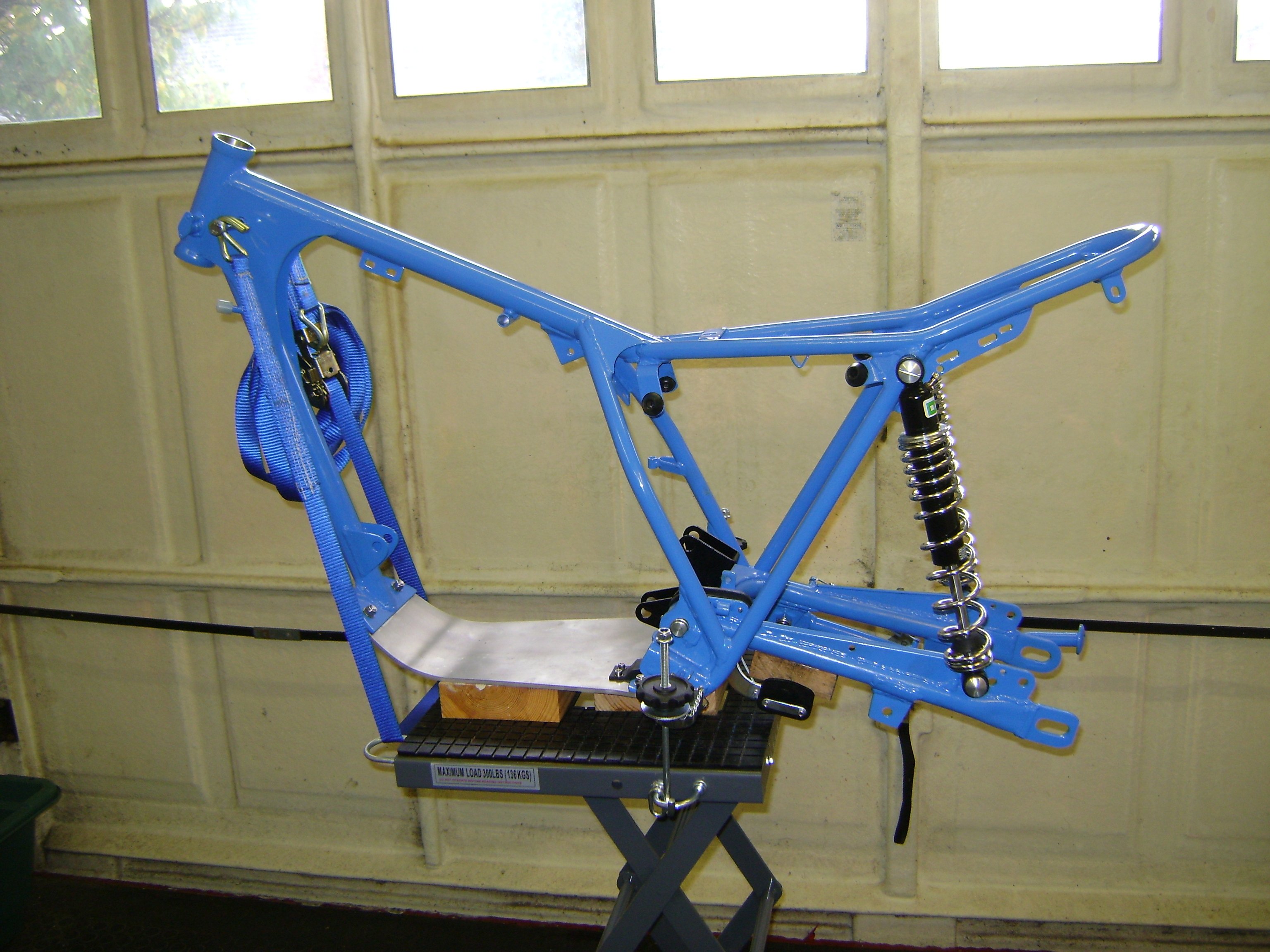

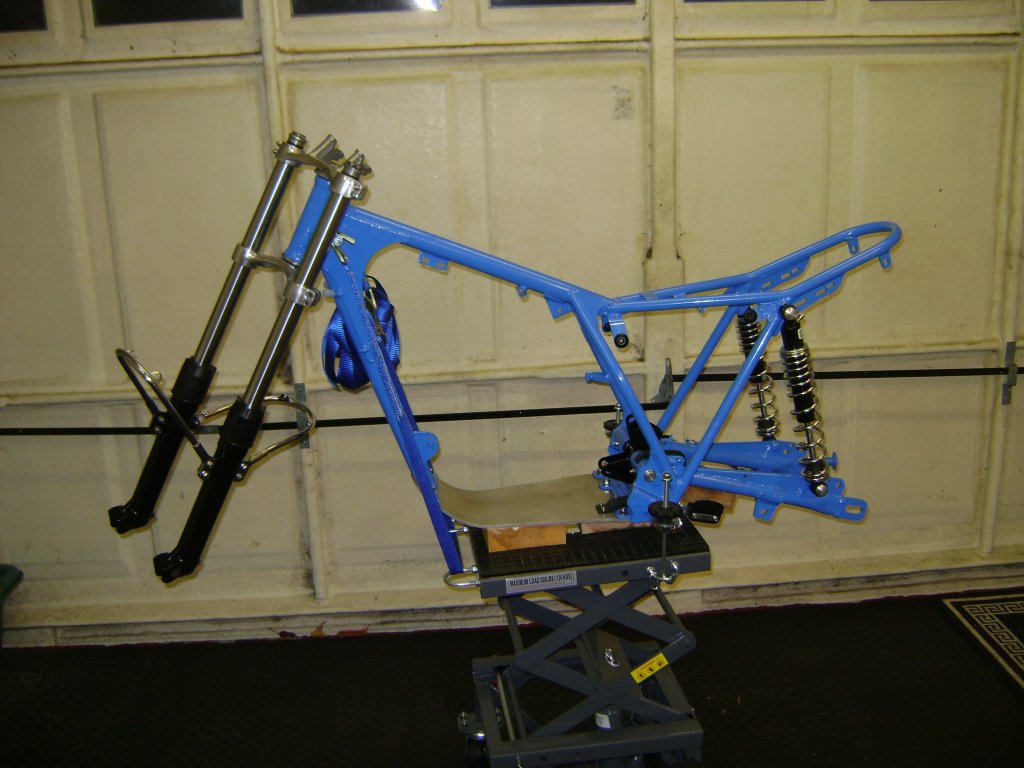

Old Gezzer Posted October 11, 2020 Author Report Share Posted October 11, 2020 (edited) Hi, Got my Frame, Swinging Arm + Side Stand back from the Powder Coaters. I hadn't used this guy before but he is into bikes and older cars so was aware of what I was looking for. He also did all the blanking off etc prior to doing the Powder Coating. Very reasonable I thought at £90 all in. The colour code is RAL5015 a touch on the light side but I am happy with it. Now let the spending start !! Edited October 24, 2020 by Old Gezzer 2 Quote Link to comment Share on other sites More sharing options...

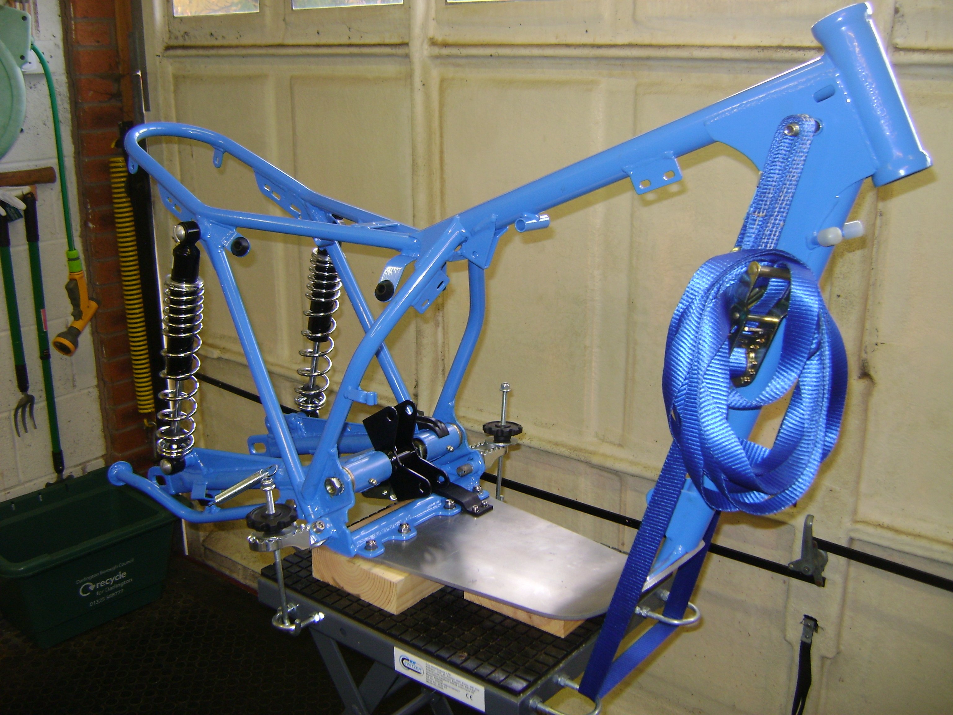

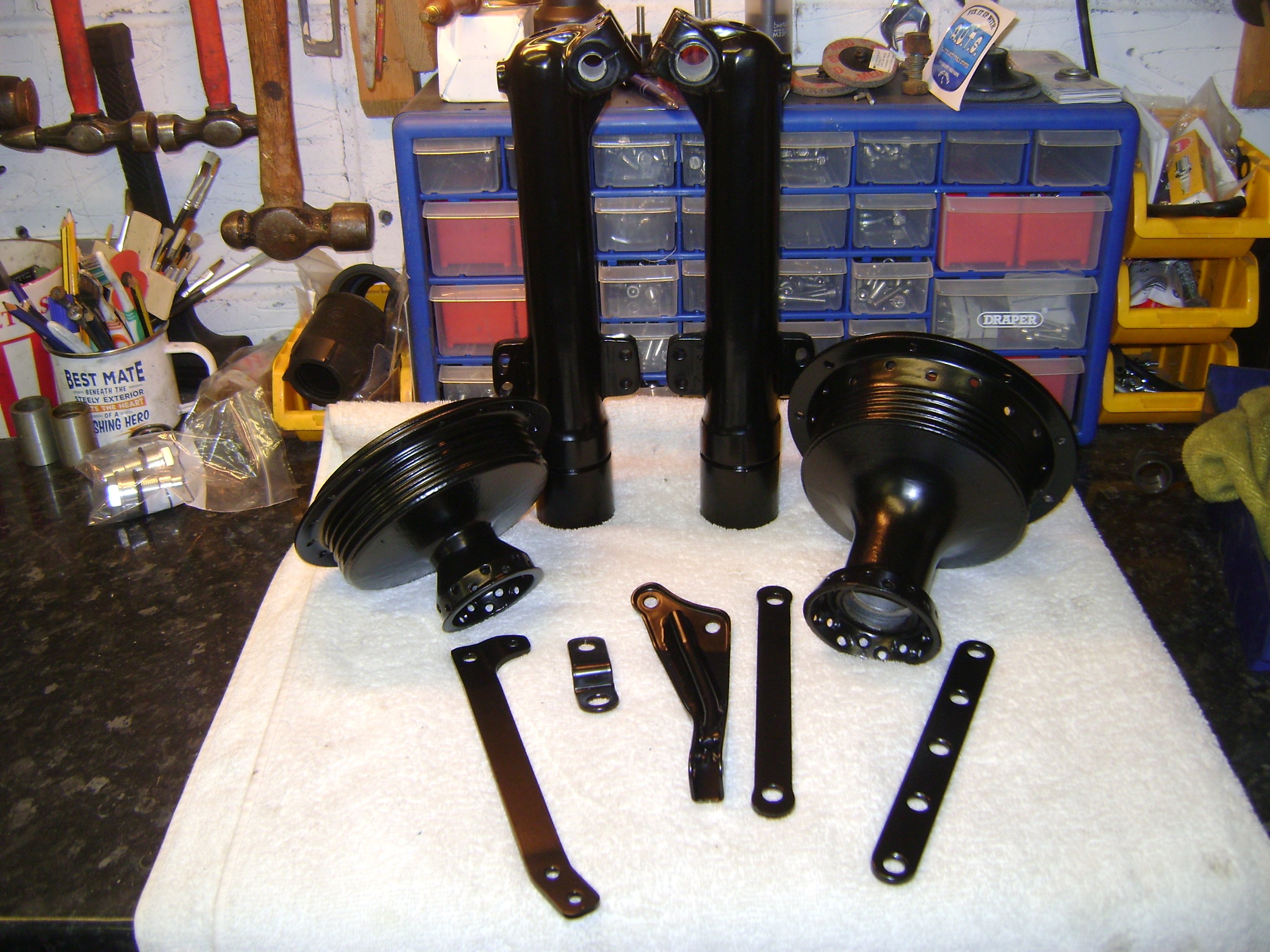

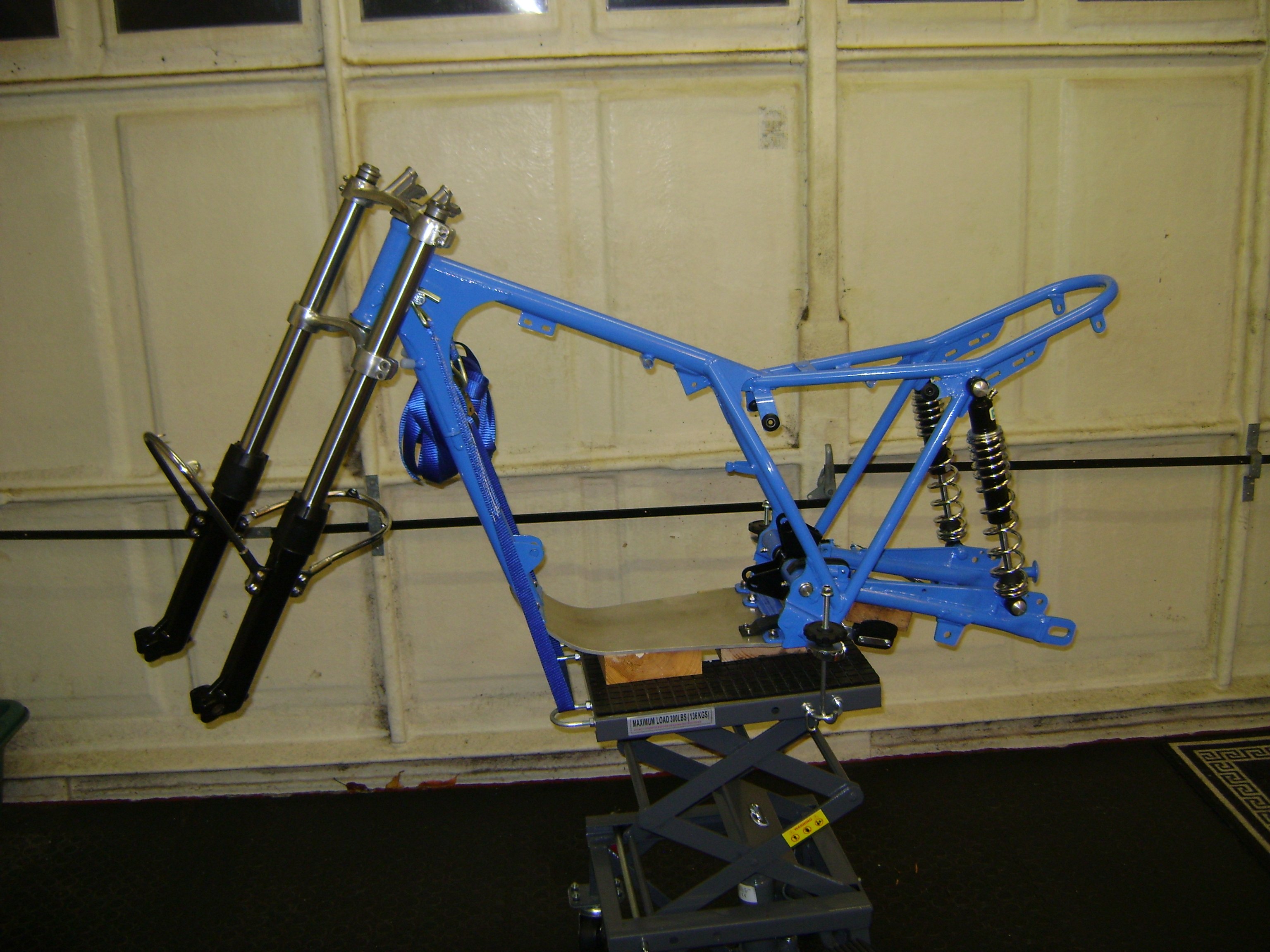

Old Gezzer Posted October 24, 2020 Author Report Share Posted October 24, 2020 (edited) Hi, A quick update on the progress up to today. I do get great satisfaction putting stuff together with mainly new parts. Now I need to spend some more money with Inmotion. I have had quite a few other parts blasted i.e Fork Bottoms, Both Side Cases, Both Hubs, Barrel and Head. More to follow. Edited October 24, 2020 by Old Gezzer 3 Quote Link to comment Share on other sites More sharing options...
motovita Posted October 24, 2020 Report Share Posted October 24, 2020 Nice, bonus points for the color matched tie down strap. 1 Quote Link to comment Share on other sites More sharing options...

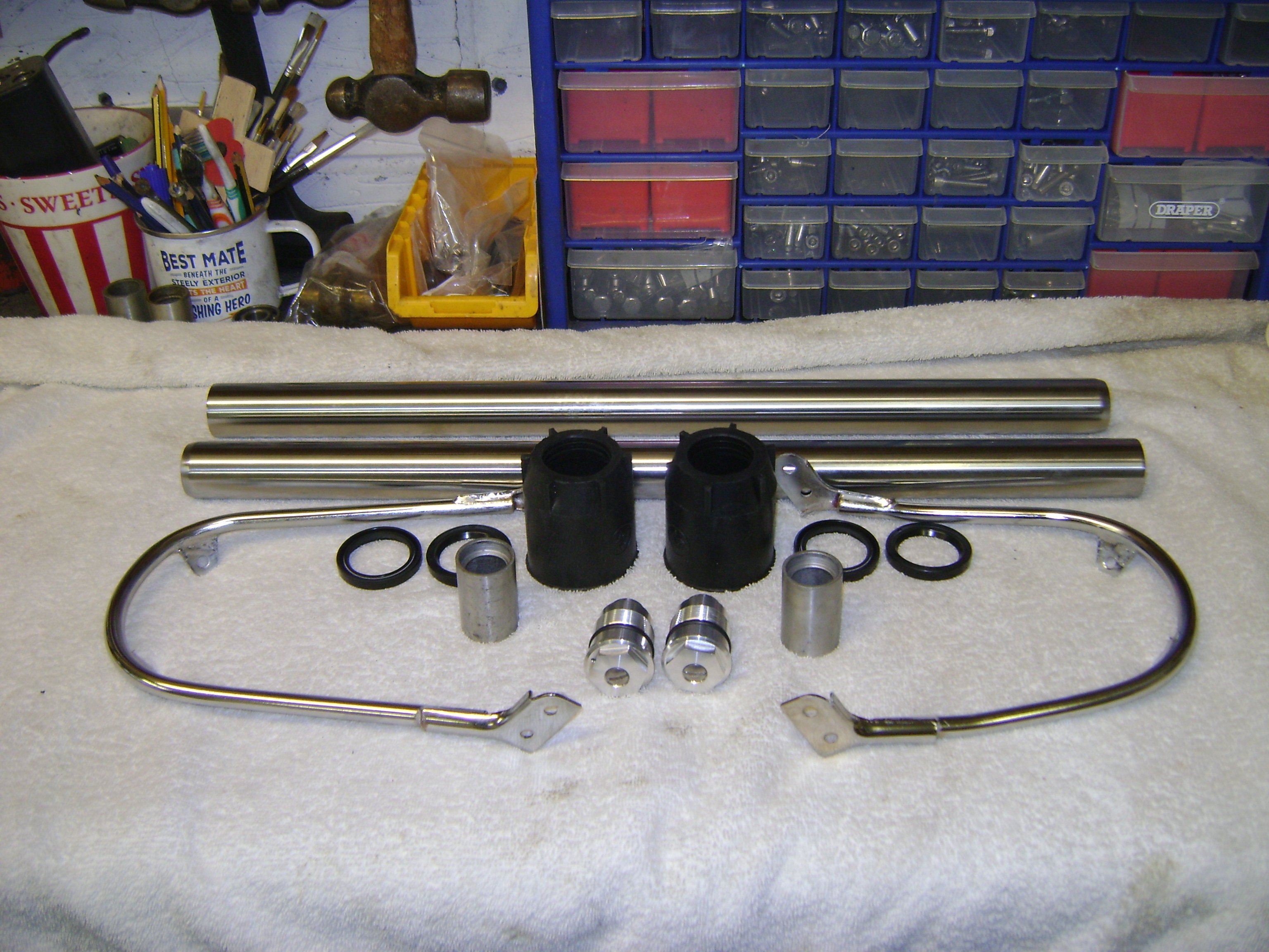

Old Gezzer Posted November 14, 2020 Author Report Share Posted November 14, 2020 (edited) Hi, Another update on my 198A Resto. All the Black parts have been away to the Powder Coaters. Another expensive delivery from Inmotion to go with one I had a couple of weeks ago which contained an Oversize Piston and a Rod Kit. Full set of Engine Bearings sorted out. The rod kit fitting is awaiting the guy to open up after the latest Lock Down but the Barrel is away getting bored as I type. Latest progress is fully rebuilt and fitted Front Forks, with New Stanchions, Intenal Seal Kit, Oil Seals, Outer Wiper Cap Seal, New Stancion Top Nuts. The work goes on. Edited November 14, 2020 by Old Gezzer Spelling! 2 Quote Link to comment Share on other sites More sharing options...

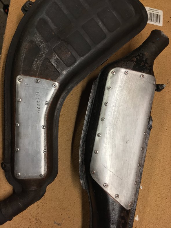

JonnyWobbles Posted November 25, 2020 Report Share Posted November 25, 2020 Looking really good! And have to say your garage is a lot neater (and bigger) than mine! My 198A restro is also coming along. Taken a while as other than the frame I've done the prep and painting myself, including refurbing the original Falcon shocks which took ages! Currently being frustrated by poorly fitting cables! The throttle my own fault as I ordered a straight pull rather than 90 deg. but found I just couldn't get the solder to flow when I shortened it! But the clutch cable is just too long? So ordered some solder free Venhill nipples to shorten! I don't know if you've tackled repacking the silencers? After research I took the plunge and opened them up with a dremmel and they were certainly very gunged up and so cleaned and repacked. As I don't have a welder I replated with 2mm ally and pop-riveted after sealing with copper silicone. Will enable future fiddling if required and when painted looks OK, even though I elected to open the mid-silencer on the visible side rather than compromise the integrity of the bracket etc. Its all good fun and interesting to see yours! Going to try lacing the wheels next as I can't get to the man I had lined up due to lockdown. I can always take them to sort out and true if I struggle! Cheers Jon 3 Quote Link to comment Share on other sites More sharing options...
