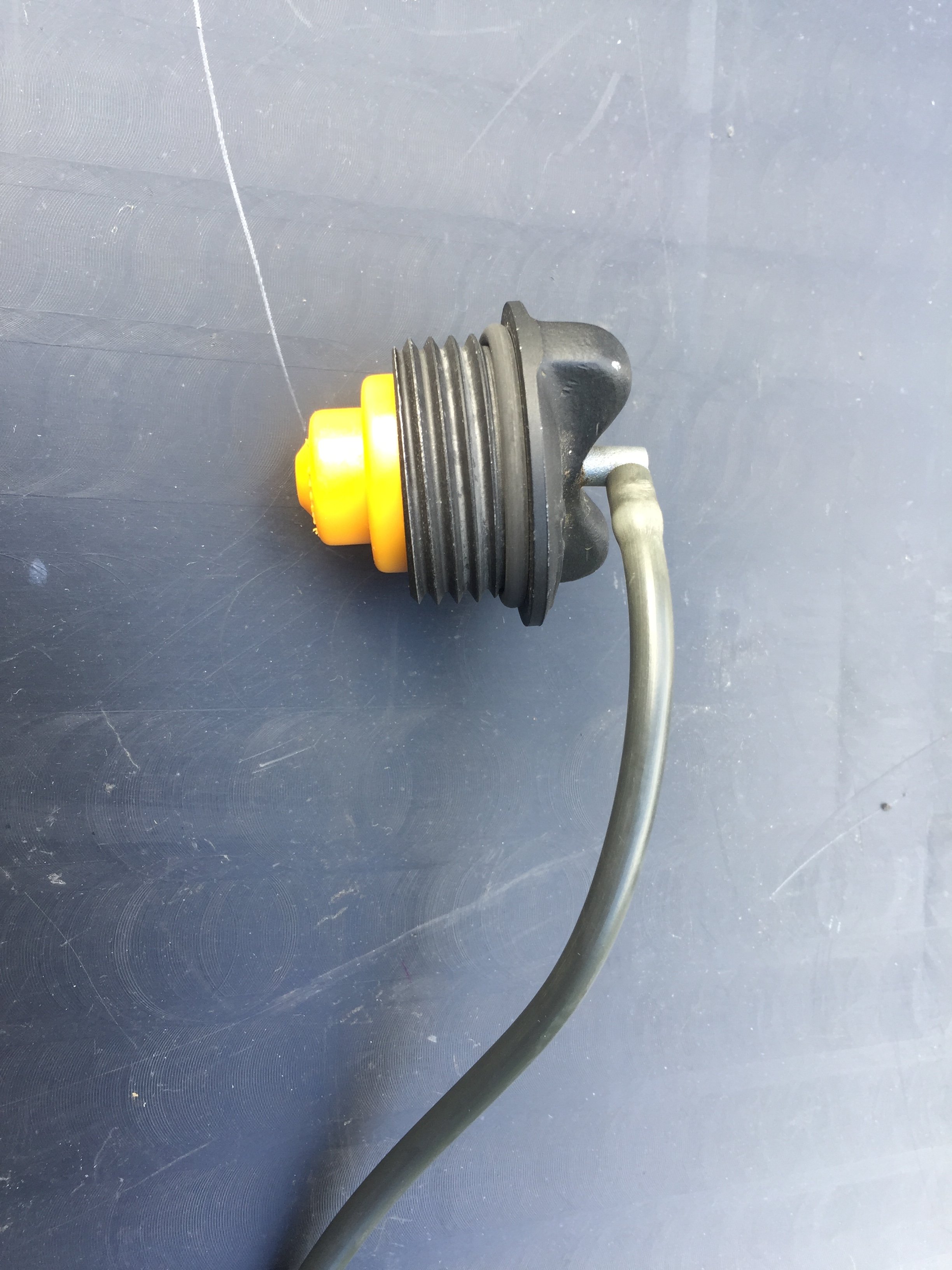

Alshine Posted September 6, 2020 Report Share Posted September 6, 2020 Hi. Got a problem with the valve in my Evo fuel cap and it would help if I could dismantle it to sort out the problem. Has anyone ever pulled one apart eg removed plastic housing that holds the valve. Don’t want to go forcing it loose and end up knackering it. Quote Link to comment Share on other sites More sharing options...

Alshine Posted September 10, 2020 Author Report Share Posted September 10, 2020 Pindie Thanks for your kind offer but Ive sorted it now. The problems I had were exactly the same as you have. I carefully heated up the cap with a hot air blower and spent some time going around the plastic insert with a screwdriver until it came out. Then I had to dismantle the valve itself which was a bit of a fiddle comprising of two small springs and rubber seals. After reassembly all seems fine so far. I can see your from South East Wales just up the road from me in West South Wales. You must have ridden with us at Vale Of Towy at some time. Quote Link to comment Share on other sites More sharing options...
