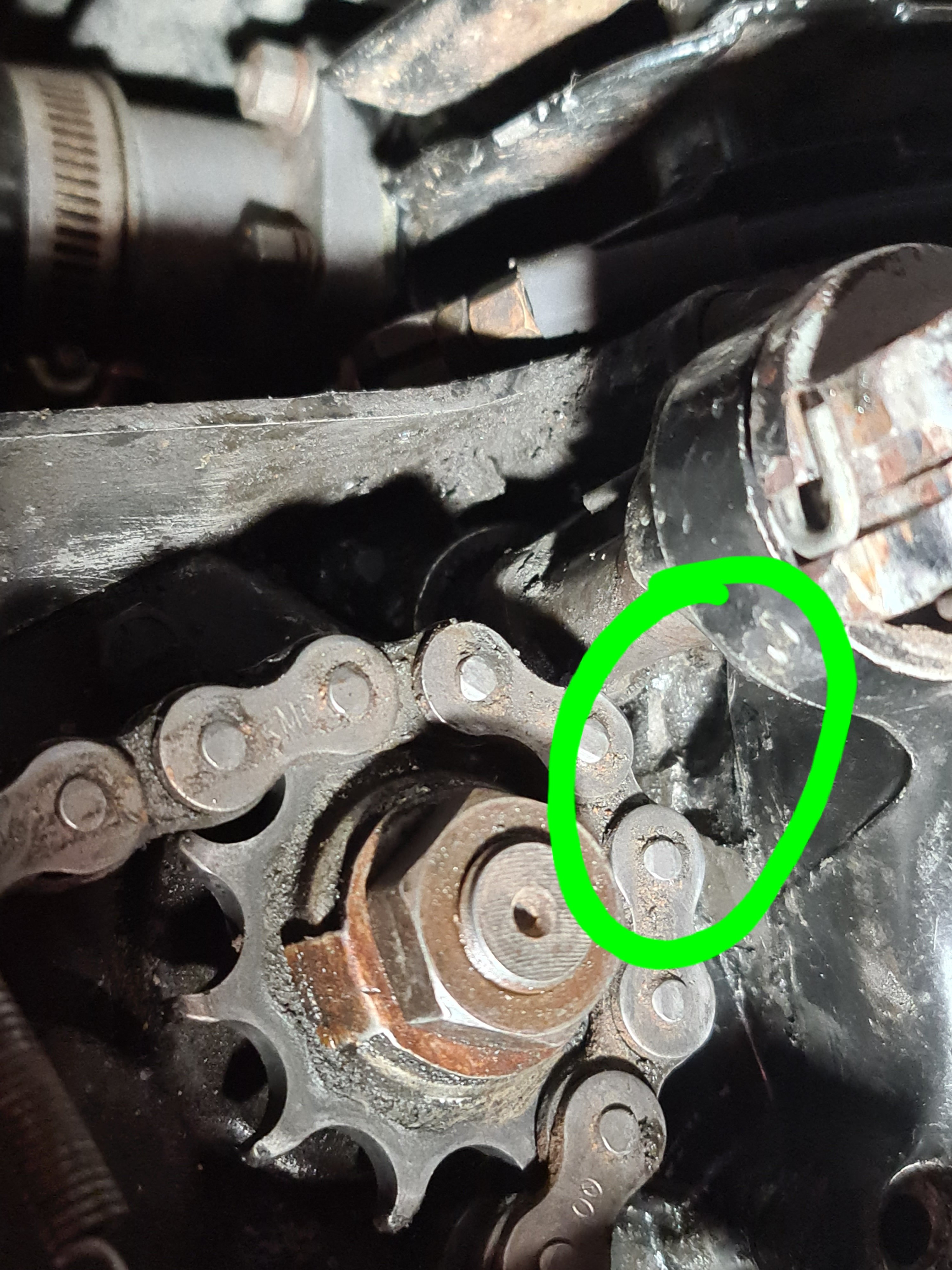

Monty89 Posted September 17, 2020 Author Report Share Posted September 17, 2020 Thanks Guy. That's what I thought. Found another issue.. should I just patch it or replace it? I'm wanting to patch it, even if I get 5 years out of it. This is the hole in my engine case caused from the kickstarted . As you can see, it has been patched before.. Quote Link to comment Share on other sites More sharing options...
barnesy Posted September 17, 2020 Report Share Posted September 17, 2020 Yes that's also common, mine had the same hole wondered why it miss fired when wet... I patched mine with JB weld and I've had no further problems. Quote Link to comment Share on other sites More sharing options...
