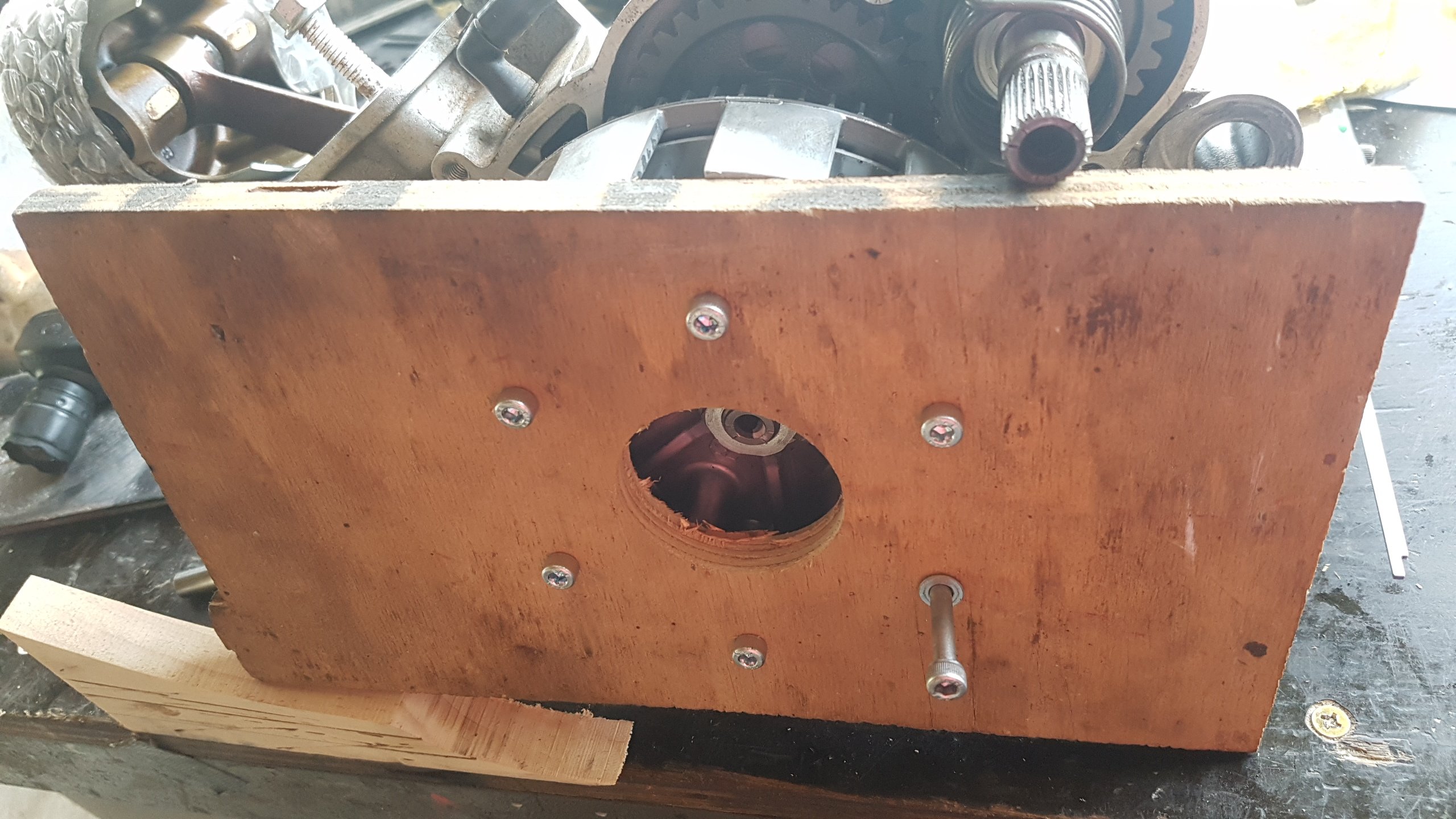

bikerpet Posted September 29, 2020 Report Share Posted September 29, 2020 With the engine out I found I needed to remove the clutch. No holder of course. Inside the inner drum there are ribs with 5mm holes either side at the bottom. Quick drill into some scrap ply, 104.5mm pcd X 6, hole saw out the centre and some M5 bolts. Easy. I'd planned to just check the fit with this one, then make a steel version, but this worked perfectly. 3 Quote Link to comment Share on other sites More sharing options...

bikerpet Posted September 30, 2020 Author Report Share Posted September 30, 2020 21 hours ago, dan williams said: Can’t argue with success.? I'd have used the rattle gun ... except ..... I've a 16 year old son who's become interested in fixing cars the rattle gun's gone missing. Coincidence? I've seen plenty of posts of people discussing how to get the clutch out - thought this was a suitably low-tech solution for those without air tools, you could build this in 10 minutes with a ruler and a hand drill. That it worked so well was a bit of a surprise really. Quote Link to comment Share on other sites More sharing options...
