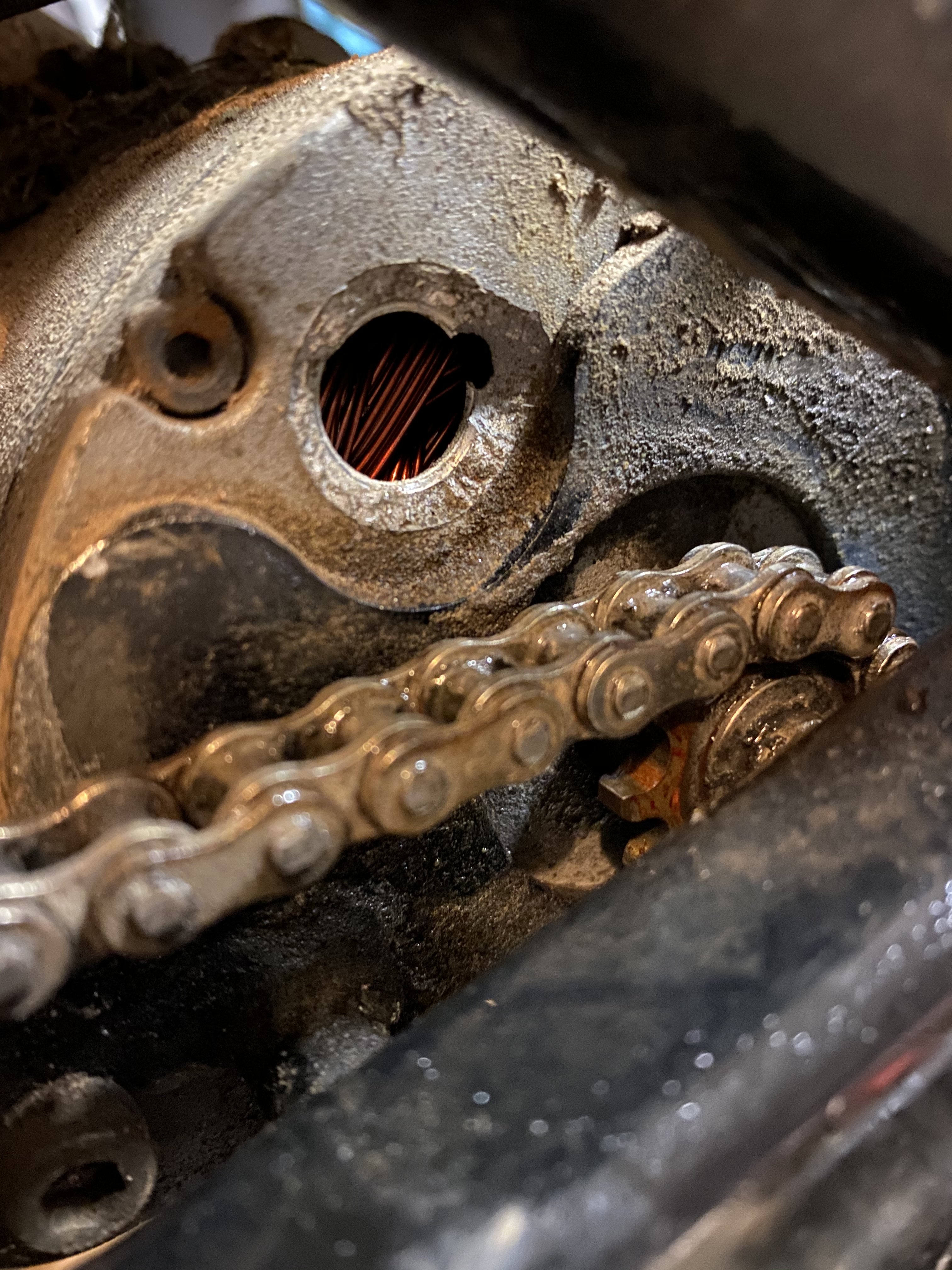

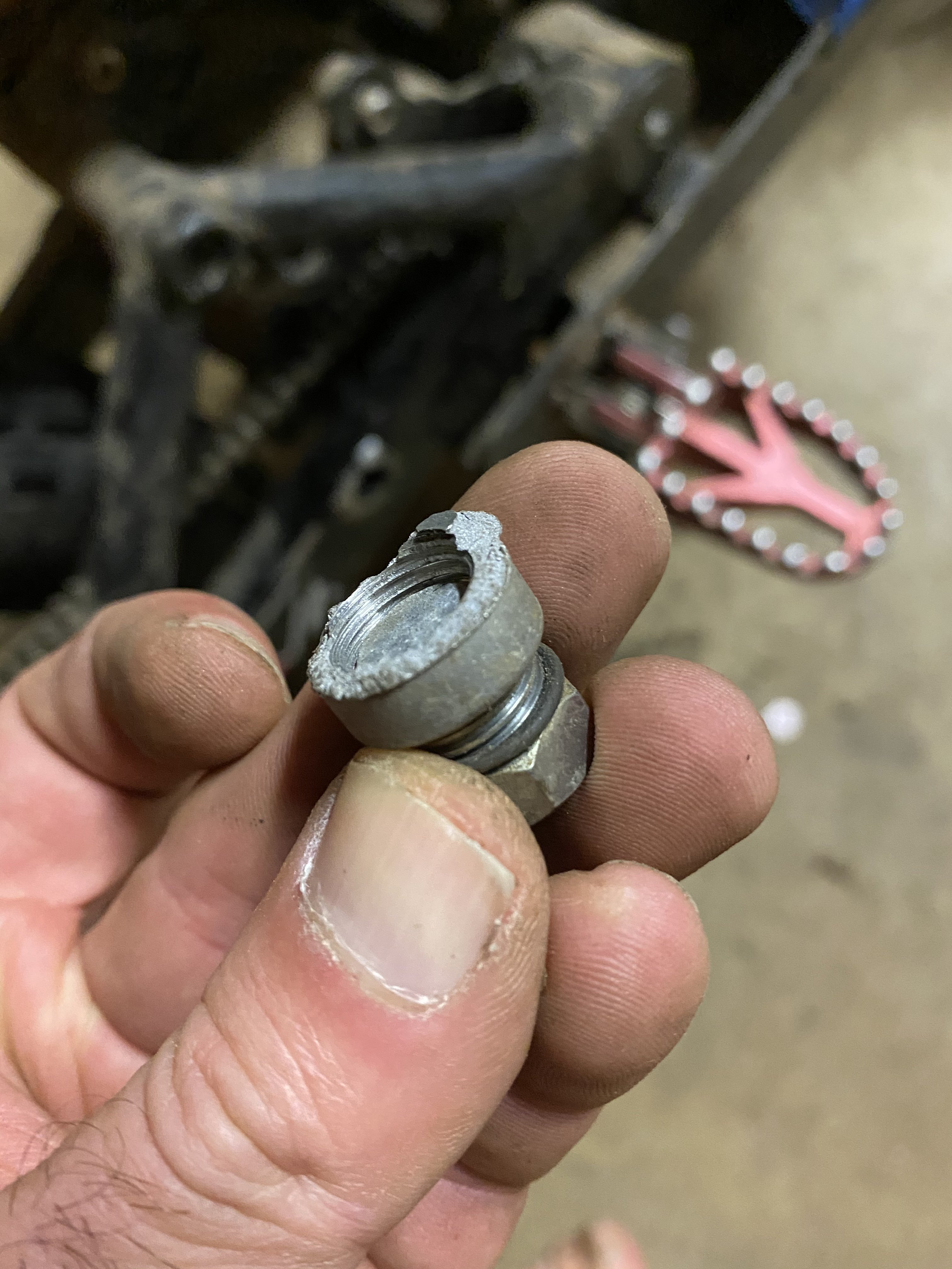

Oset 20, broken part
Omercn
remove the cover clean hole and fill the hole with jb weld dont worry about trying to fit the bolt back on as it serves no purpose. just make sure that when the cover is back on that the coils dont rub or hit any jb weld on the inside
