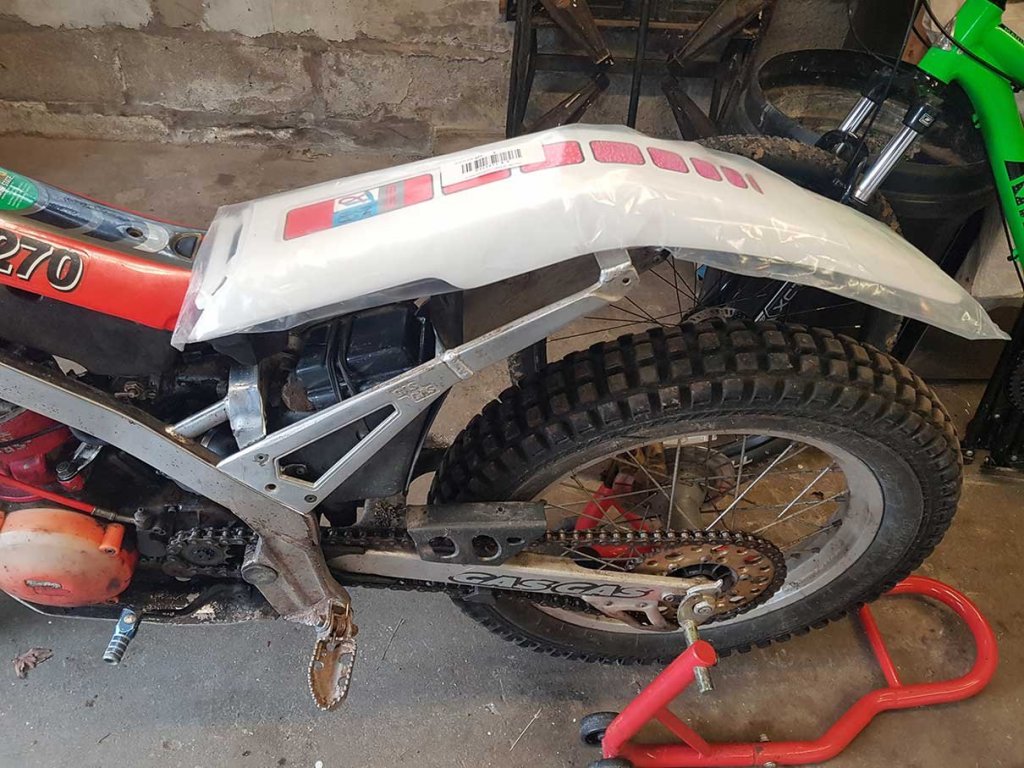

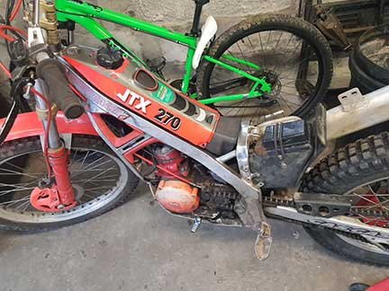

I've just bought what I believe to be a 1994 Gas Gas JTX270 Contact. Frame number shows it as a '94 - VTRGG2594 - but I've just ordered a '94 rear mudguard that doesn't come close to fitting. Can anyone help please? Don't want to keep ordering rear mudguards and sending them back! Cheers, Simon

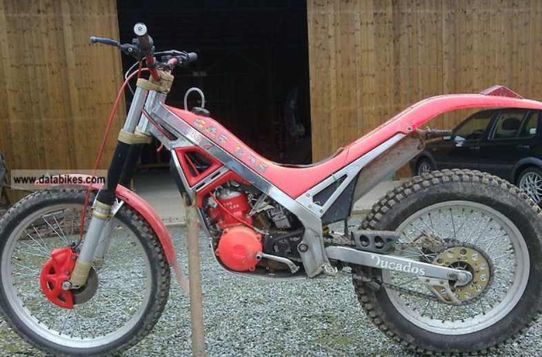

Should fit 94/5 used same mudguard have you a pic of the tank or without the mudguard.or its the wrong tank fitted.see pic of correct one. the tank you have looks like 96/7 in 98 went to alloy tank with the TX model
