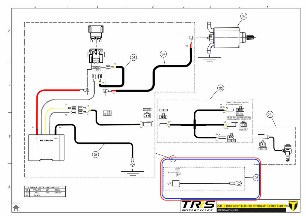

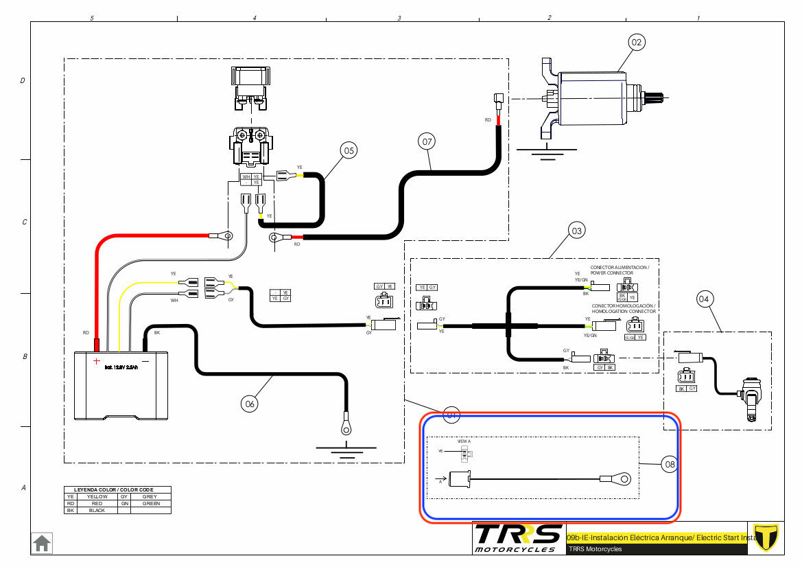

CarlosEcha Posted May 25, 2023 Report Share Posted May 25, 2023 Charging TRS Battery.pdfHi everyone. Here is some help just in case you need to recharge the TRS Battery Pack with a charger. This is the official battery manual to do so. You will need the TRS ADAPTER CHARGER BATTERY ELECTRIC START. Part no. 09016TR100 (No. 8 in the part diagram) Charger type: Use only a ferric lithium-ion charger. See charger description “LiFePO4” You can check all your parts numbers, manuals, racing parts and accessories here: https://trsmotorcycles.com/Descargas See attached wiring diagram and charging manual pdf. Any more questions, please contact your local dealer, importer or write to info@trsmotorcycles.com Thanks to all. Carlos Echavarría S. Charging TRS Battery.pdf Quote Link to comment Share on other sites More sharing options...
