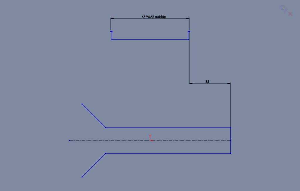

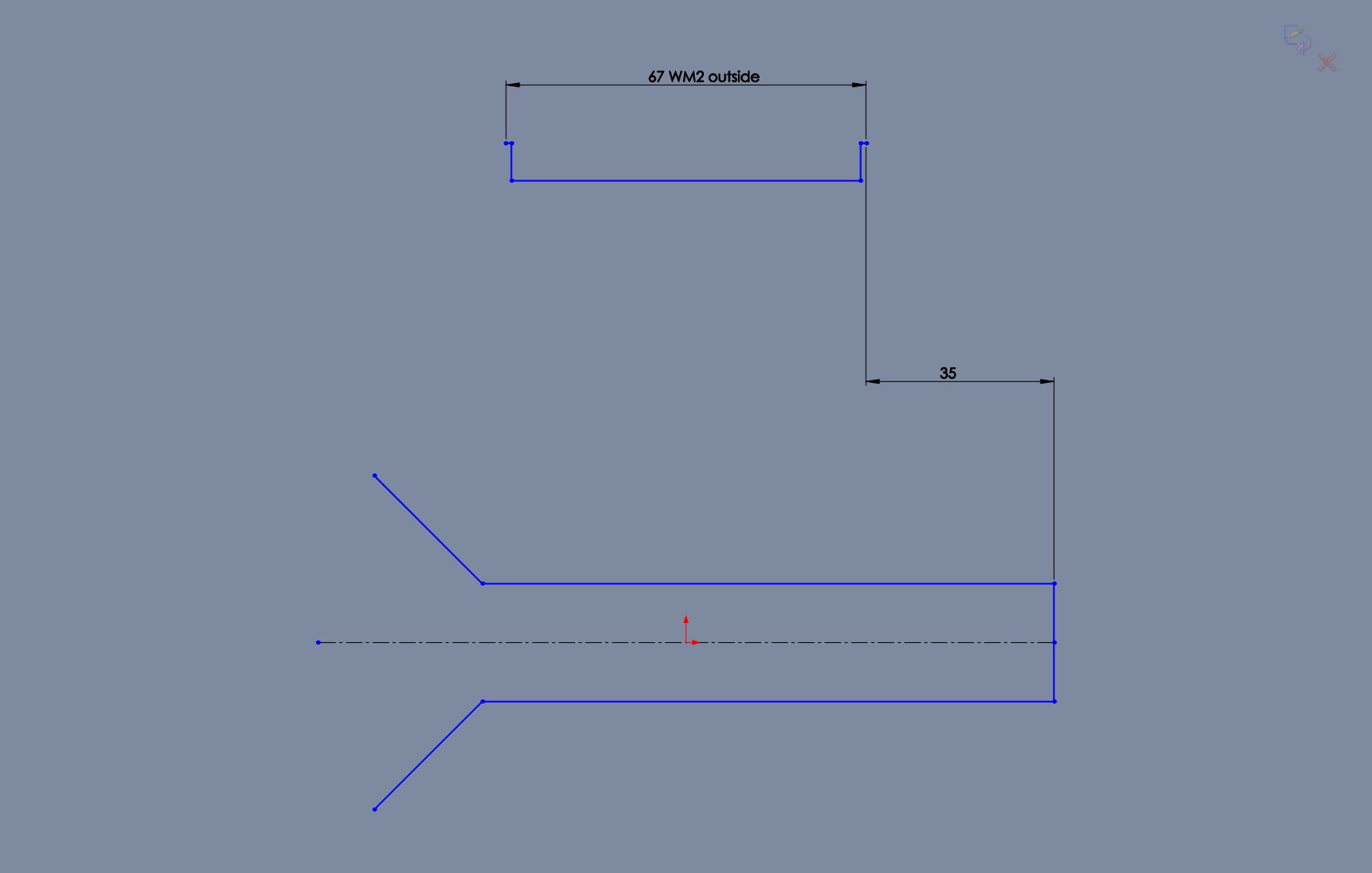

carl ekblom Posted November 30, 2020 Report Share Posted November 30, 2020 (edited) From behind looking forwards What I believe is original 199A rear wheel 67mm is outside WM2 rim Edited November 30, 2020 by carl ekblom Quote Link to comment Share on other sites More sharing options...
JonnyWobbles Posted November 30, 2020 Author Report Share Posted November 30, 2020 Thanks Carl, sounds about right. I rang InMotion who confirmed it should be: Rear: Brake Side = 40mm Flange = 35mm Front: Brake Side = 15mm Flange = 32mm So my wheels were pretty close. I'm going to drop them off with a wheel builder this week, just to be on the safe side! Cheers Jon Quote Link to comment Share on other sites More sharing options...
