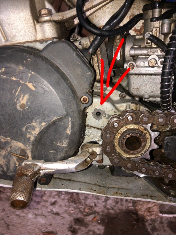

Craigop Posted December 17, 2020 Report Share Posted December 17, 2020 Hi. bought a 2003 Gasgas txt pro 250 few months back. There’s a hole above the gear lever? Is it suppose to be there or should there be a plug in there. Pictures attached thanks Spoiler Quote Link to comment Share on other sites More sharing options...
b40rt Posted December 17, 2020 Report Share Posted December 17, 2020 Breather, maybe ? 1 1 Quote Link to comment Share on other sites More sharing options...
Craigop Posted December 17, 2020 Author Report Share Posted December 17, 2020 Did think that maybe but wasn’t sure? Quote Link to comment Share on other sites More sharing options...
d2w Posted December 17, 2020 Report Share Posted December 17, 2020 Yes. Crank case breather. Normally there's an elbow in the hole, and then a hose which runs up into the steering head area. 2 Quote Link to comment Share on other sites More sharing options...
Craigop Posted December 17, 2020 Author Report Share Posted December 17, 2020 1 hour ago, d2w said: Yes. Crank case breather. Normally there's an elbow in the hole, and then a hose which runs up into the steering head area. Tidy! I’ll get one ordered up! Keep water out of there. Thank you Quote Link to comment Share on other sites More sharing options...
reggie Posted December 17, 2020 Report Share Posted December 17, 2020 If you have trouble finding a p/n it is the same fitting as a dell orto carb float bowl vent 1 2 Quote Link to comment Share on other sites More sharing options...
Craigop Posted December 19, 2020 Author Report Share Posted December 19, 2020 On 12/17/2020 at 6:04 PM, reggie said: If you have trouble finding a p/n it is the same fitting as a dell orto carb float bowl vent Got one order up. Thanks for that though Quote Link to comment Share on other sites More sharing options...
