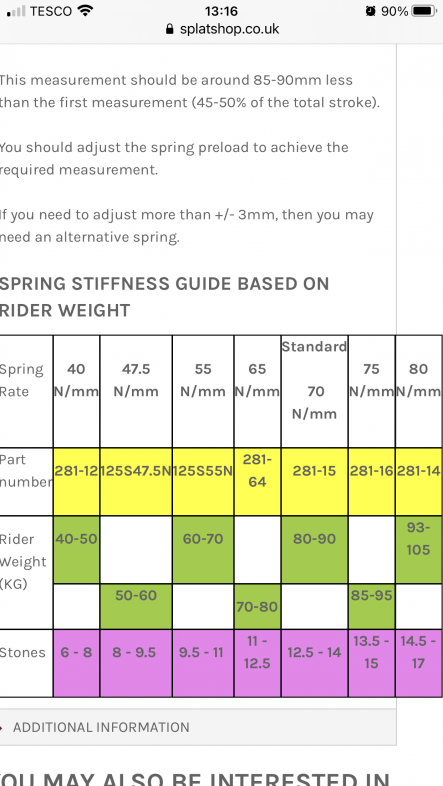

Glearacer Posted December 19, 2020 Report Share Posted December 19, 2020 Hi, I'm new here and just got my 2005 gas gas txt pro 280. I have been thinking that the rear spring is a bit soft as it sags when i stand onto he bike a fair bit. I'm around 16st if this helps. Thanks Quote Link to comment Share on other sites More sharing options...

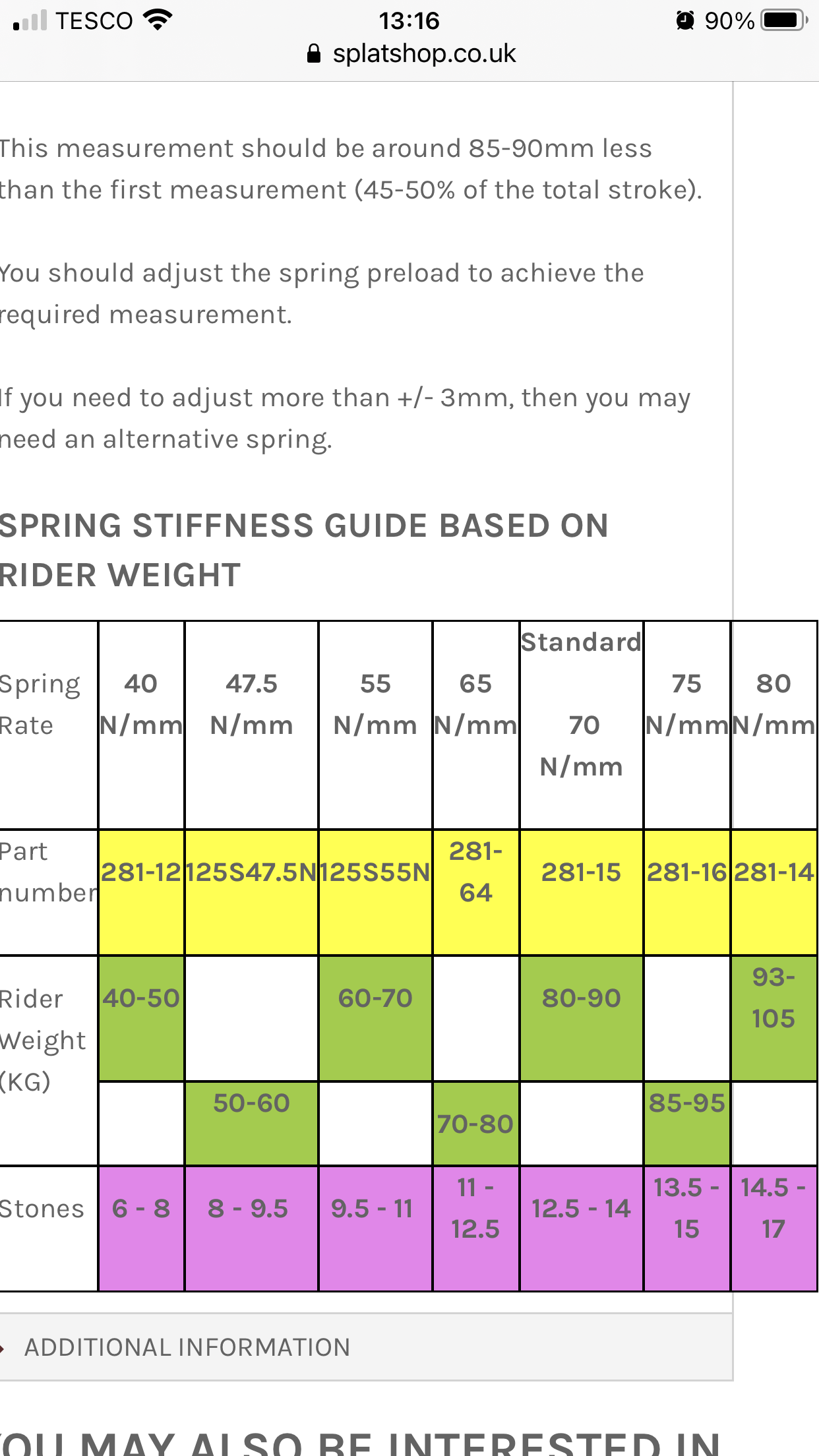

wobblenorbed Posted December 20, 2020 Report Share Posted December 20, 2020 This is for ohlins springs Quote Link to comment Share on other sites More sharing options...
Glearacer Posted December 20, 2020 Author Report Share Posted December 20, 2020 2 hours ago, wobblenorbed said: This is for ohlins springs Excellent, thank you Quote Link to comment Share on other sites More sharing options...
wobblenorbed Posted December 20, 2020 Report Share Posted December 20, 2020 Just now, Glearacer said: Excellent, thank you Give splat shop a shout Quote Link to comment Share on other sites More sharing options...
