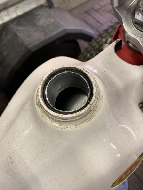

SwiftyM Posted January 1, 2021 Report Share Posted January 1, 2021 Hi, Could any one recommend someone that I can take a fibre glass tank to for resealing. Many thanks Andy Quote Link to comment Share on other sites More sharing options...
ikb Posted January 2, 2021 Report Share Posted January 2, 2021 If you can find the aluminium tank that goes under the shelter on the earlier models it can be made to fit into your fibreglass tank. Just cut out the bottom with a hacksaw blade then the aluminium tank will drop in with a little reshaping and glue it in with builders foam or silicone. Then you end up with a nice sturdy unit that’s full petrol proof. Quote Link to comment Share on other sites More sharing options...
turps Posted January 3, 2021 Report Share Posted January 3, 2021 I bought a two part sealer (Petseal) from Ebay, pretty easy to do yourself. Quote Link to comment Share on other sites More sharing options...

SwiftyM Posted January 6, 2021 Author Report Share Posted January 6, 2021 On 1/3/2021 at 9:14 AM, turps said: I bought a two part sealer (Petseal) from Ebay, pretty easy to do yourself. Hi, I've looked up Petseal on eBay, but is this not for steel tanks as it states rust. Can this be used on fibreglass tanks, cheers Andy Quote Link to comment Share on other sites More sharing options...
turps Posted January 12, 2021 Report Share Posted January 12, 2021 I used it on mine, seems ok but not used the bike much since doing it due to the lockdown. Quote Link to comment Share on other sites More sharing options...
