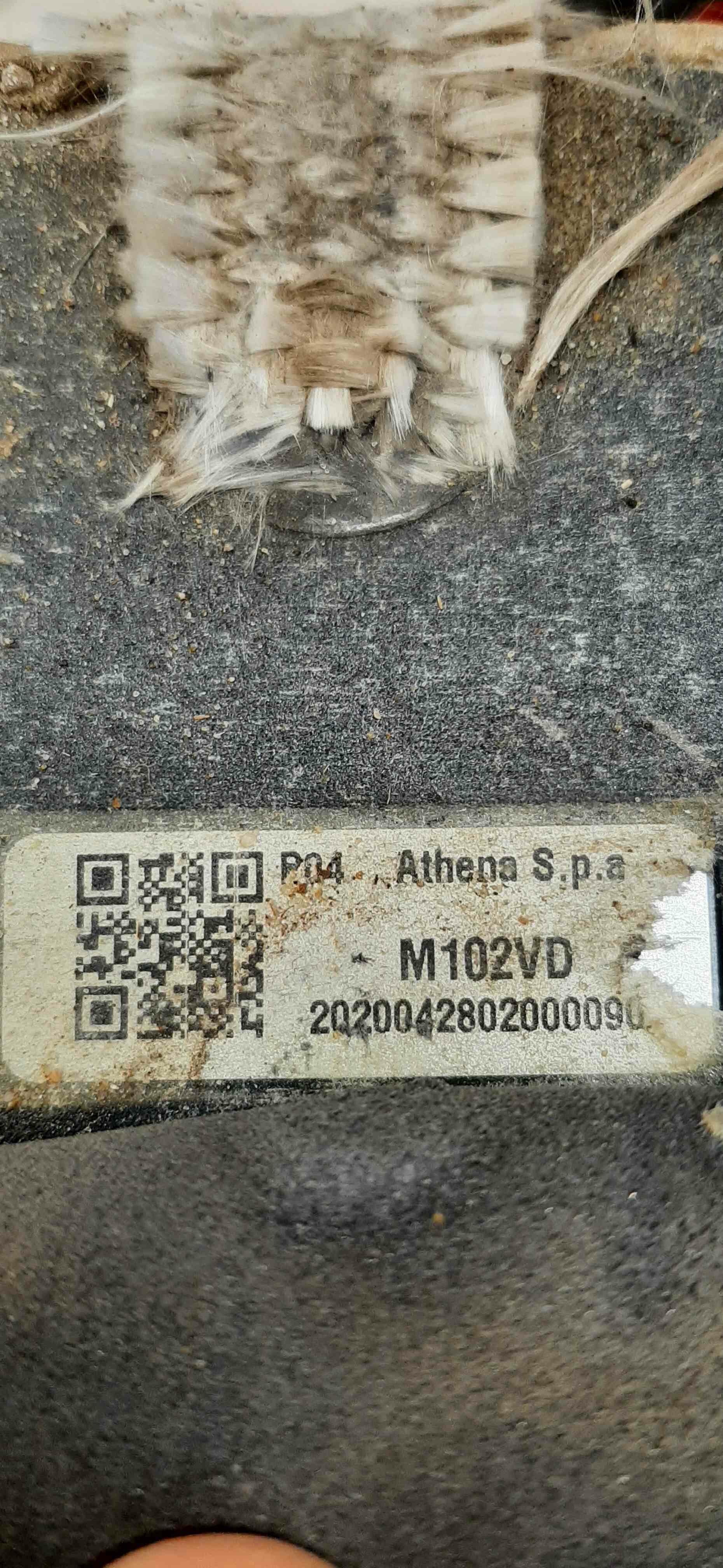

Pavel Posted June 24, 2021 Report Share Posted June 24, 2021 On 1/8/2021 at 1:48 PM, Simonelongus said: I want to buy the wificom module, can you tell me the factory code. I don't want to buy it from an official dealer. Can anyone help me? I don't know if the code is: GK-WFCOM2-0003 or GK-WFCOM2-0001 If anyone can help me Thanks Expand You should look at your ECU. If it is the same as mine (photo attached) you need GK-WFCOM1-003 1 Quote Link to comment Share on other sites More sharing options...
