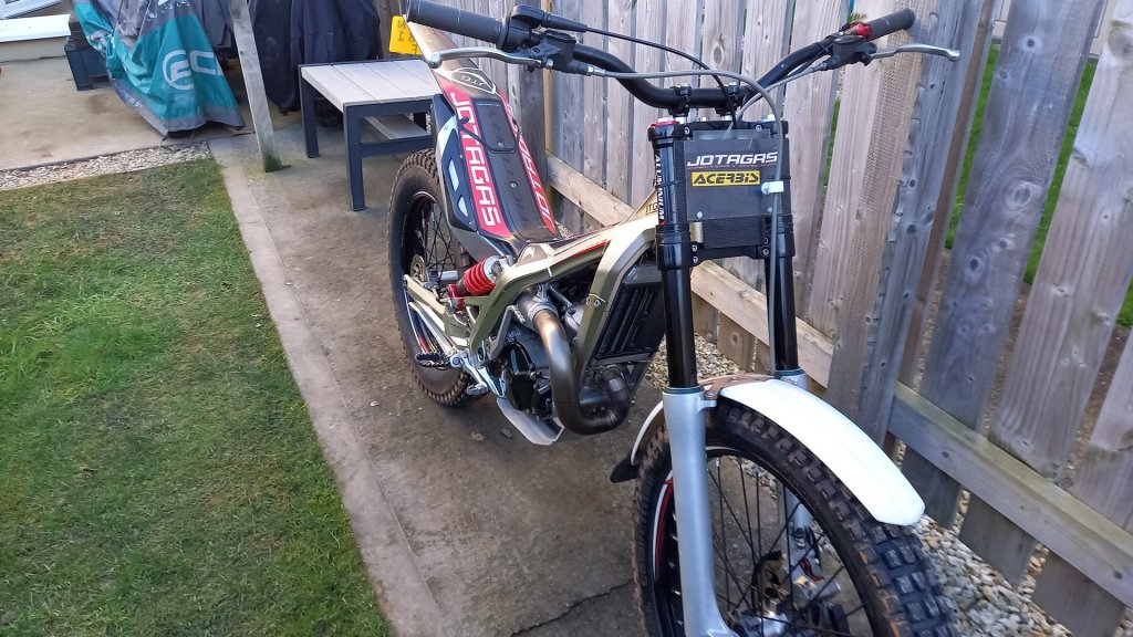

heavydabber Posted January 20, 2021 Report Share Posted January 20, 2021 As the owner of a recently acquired Jotagas 250 I can't fault Vince at Haventrialsport, great with the advice and everything I needed (which was quite a lot, courtesy of some previous owner, in no way the bike's fault), was readily available and came in a few days. Updated stuff from later models can be retrofitted to earlier models such as the improved selector mechanism which gets rid of the excess lever travel...that's next on my list. It rides and handles well, power delivery is smooth and it's generally easy to maintain, lots of components are common to other manufacturers and are industry standard. It's a shame they were let down by politics and poor communications, hopefully they can turn that around. 3 1 Quote Link to comment Share on other sites More sharing options...
freedoo Posted January 20, 2021 Report Share Posted January 20, 2021 Hi Heavydabber !!Very nice bike, it seems in very good shape !!What i suggest is to change the rear brake lever by the improved 2016 version who is inside the frame and not too difficult to do.Perhaps putting 10 mm spacers on the front mudguard and absolutely imperative check the bolts of the crank (top and bottom) and the bolts and nuts of the rear sprocket !!!!Be vigilant to with the space between the muffler and the airbox ,absolutely no contact because the airbox will melt and it ´s pretty expensive !!Enjoy your bike ! Sadly i ´haven't be able to send pictures of mine ! Quote Link to comment Share on other sites More sharing options...
