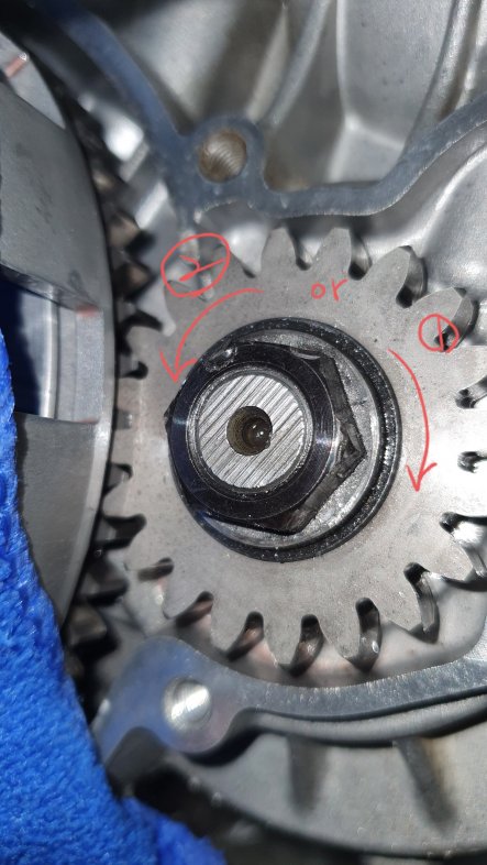

jacsal Posted January 28, 2021 Report Share Posted January 28, 2021 (edited) Hi, I'm trying to replace the crankseal. Which direction is the crank hexnut removed? 2016,sherco trial 290 I Can't find the answer to this problem in the manual. Please leave a comment. 스포일러 Edited January 28, 2021 by jacsal Quote Link to comment Share on other sites More sharing options...
technowaldo Posted January 28, 2021 Report Share Posted January 28, 2021 Look at the portion of thread that’s sticking through the nut and see how it’s cut and you’ll be able to work it out from there 1 Quote Link to comment Share on other sites More sharing options...
tony27 Posted January 28, 2021 Report Share Posted January 28, 2021 Normal direction ie. anti-clockwise to loosen 1 Quote Link to comment Share on other sites More sharing options...
Creepytheclutchmaster Posted January 28, 2021 Report Share Posted January 28, 2021 Anti clock wise, and you will need a impact wrench. I tried removing one with a long bar no chance if its been done up properly before. 1 1 Quote Link to comment Share on other sites More sharing options...

cascao Posted January 29, 2021 Report Share Posted January 29, 2021 Mark the nut and axle relative position first. Than remove nut with a impact gun Change seal Reinstall nut with impact gun untill marks realign again. This way proper tigtening is garanted 1 Quote Link to comment Share on other sites More sharing options...
jacsal Posted January 29, 2021 Author Report Share Posted January 29, 2021 45 minutes ago, cascao said: Mark the nut and axle relative position first. Than remove nut with a impact gun Change seal Reinstall nut with impact gun untill marks realign again. This way proper tigtening is garanted thank U. qood idea Quote Link to comment Share on other sites More sharing options...
