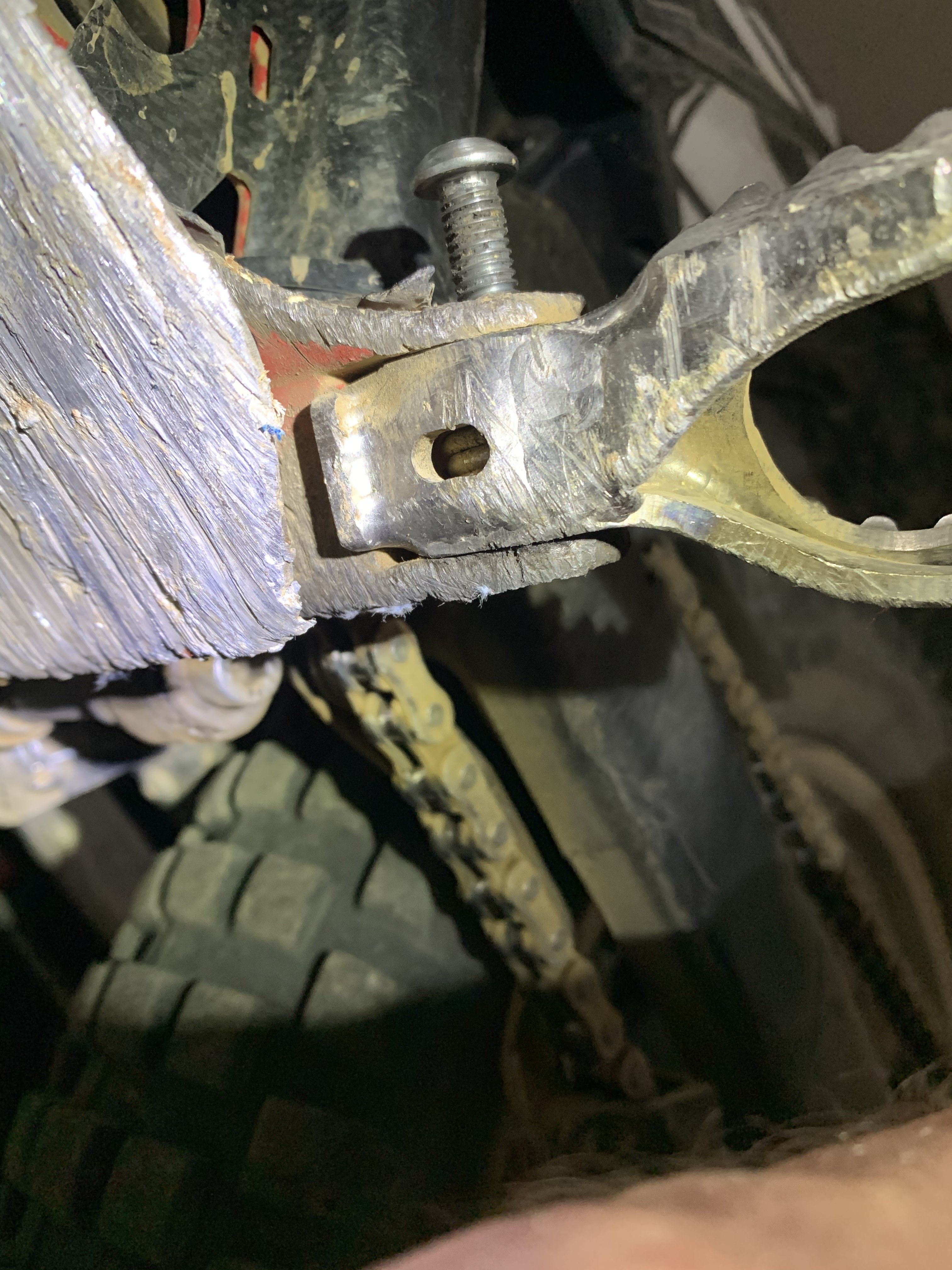

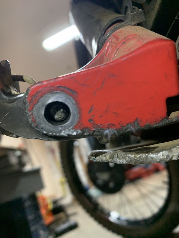

mbeers6 Posted February 22, 2021 Report Share Posted February 22, 2021 Hello all, what are your opinions on how I should fix this issue? 2017 GG with around 400 hours and stock skid plate didn't protect base of footpeg mount so material was scraped off. Now I'm getting concerned as the hole for the footpeg bolt is dangerously close to the "edge" of the mount on both pegs. Another rider in our club said he could weld some "material" to the base to build the mount back up. I think that is the best option right now since I don't think GasGas sells a replacement footpeg mount. Your thoughts? 1 Quote Link to comment Share on other sites More sharing options...

carl ekblom Posted February 22, 2021 Report Share Posted February 22, 2021 (edited) I don't think your 4.8mm left would be an issue but it looks that your hole is sightly oval and that might be an issue that can make your footpegs pointing slightly downwards. Most people feel comfortable if they are horizontal or pointing very slightly upwards. The bolt you have seems to be full length threaded. Better if it is threaded only where it is needed, where the lock nut sits. 8.8 stength is enough for the footpeg bolts. edit: spelling error Edited February 22, 2021 by carl ekblom 1 Quote Link to comment Share on other sites More sharing options...
feetupfun Posted February 23, 2021 Report Share Posted February 23, 2021 Yes repair if you are worried. Only you know your own level of acceptable risk. If it was mine and depending on how much life is left in the rest of the bike I would either fit new peg mounts or let them wear down another few mm. Pre-formed peg mounts are readily available and you could fit them a bit higher than original. 1 Quote Link to comment Share on other sites More sharing options...

gasgasman280- Posted February 24, 2021 Report Share Posted February 24, 2021 Just build up the worn area underneath the peg mounts and grind back flat. That will be perfectly fine. That is some serious scarps tho. I would suggest riding lighter on the bike Quote Link to comment Share on other sites More sharing options...
elemetal Posted February 26, 2021 Report Share Posted February 26, 2021 I can help with this if you want, bring the bike by the shop and I'll add weld to the bottom, will only take 15 minutes or so. Quote Link to comment Share on other sites More sharing options...
