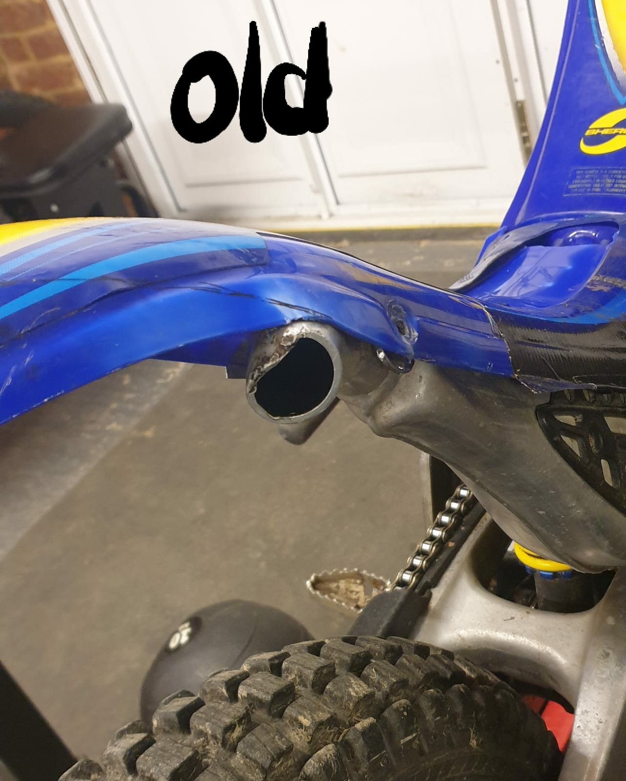

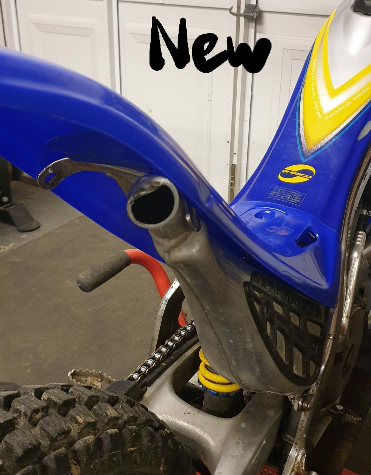

PoppinWhoolies Posted March 10, 2021 Report Share Posted March 10, 2021 I got a new mudguard because the old one was held together by the sticker The old one was bent over the exhaust I assume from crashes The new one does not reach the mounts because it is obstructed by the exhaust. I have considered cutting a notch out or just forcing it over but wanted to see if anyone else has had this issue? Quote Link to comment Share on other sites More sharing options...
turbofurball Posted March 10, 2021 Report Share Posted March 10, 2021 The exhaust is different from the earlier ones, that's probably why. I'd just cut a notch Quote Link to comment Share on other sites More sharing options...
PoppinWhoolies Posted March 10, 2021 Author Report Share Posted March 10, 2021 6 minutes ago, turbofurball said: The exhaust is different from the earlier ones, that's probably why. I'd just cut a notch Ah ok. The exhaust is different from other 99-05 models? I think I'm gonna chop it Quote Link to comment Share on other sites More sharing options...

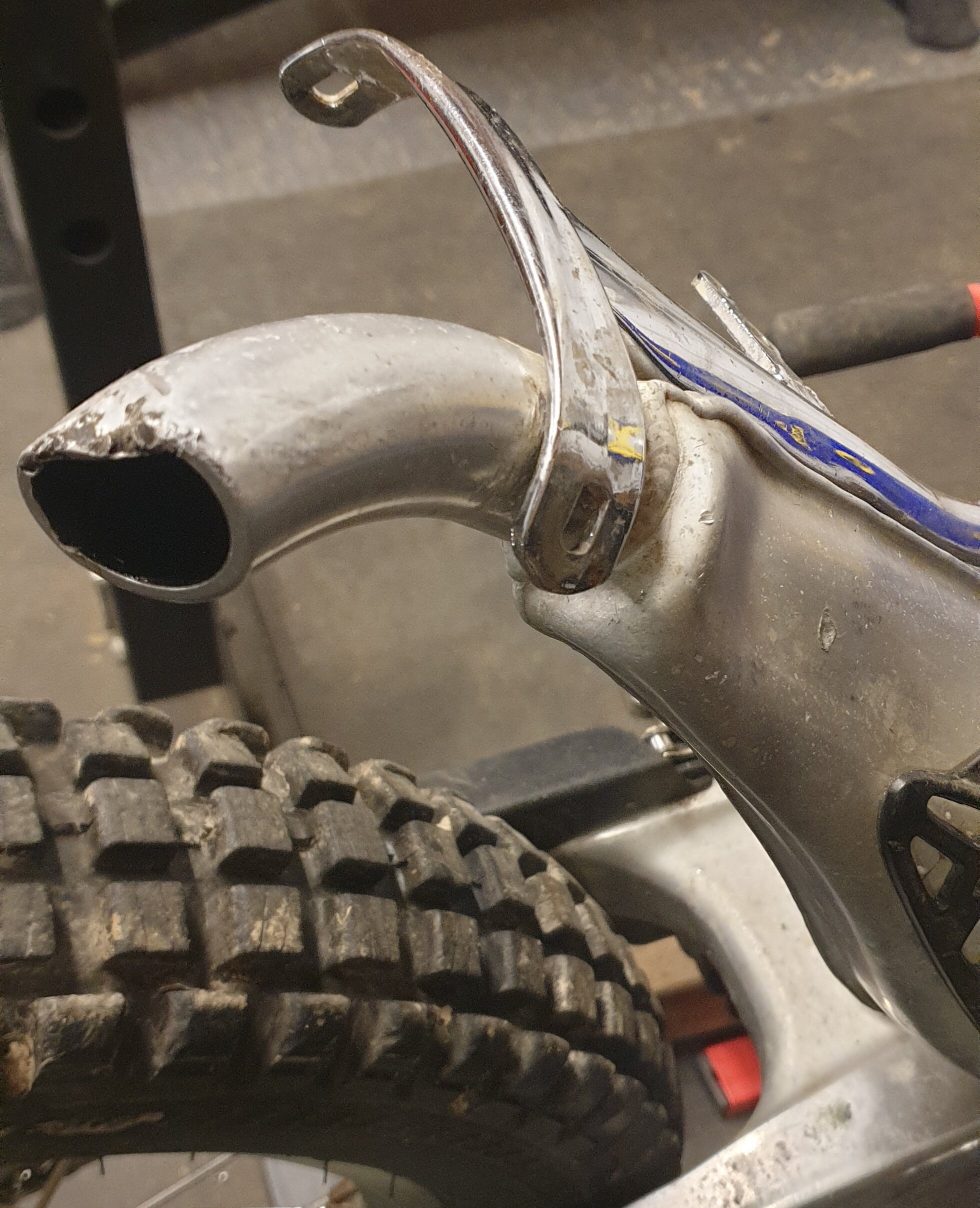

faussy Posted March 10, 2021 Report Share Posted March 10, 2021 (edited) 99 and 2000 had different exhausts. 01-05 all had the same exhaust and mudguards. You have the right mudguard for your bike. They did run close, but didnt obstruct as much as yours is. I think your exhaust has just had a good bend upwards over the years Edited March 10, 2021 by faussy Quote Link to comment Share on other sites More sharing options...
PoppinWhoolies Posted March 10, 2021 Author Report Share Posted March 10, 2021 (edited) 1 hour ago, faussy said: 99 and 2000 had different exhausts. 01-05 all had the same exhaust and mudguards. You have the right mudguard for your bike. They did run close, but didnt obstruct as much as yours is. I think your exhaust has just had a good bend upwards over the years Great, thanks for the information. I can work with that Now you mention it, it is very obviously bent upwards. Is it a bad idea to try and persuade it back? I'd rather try that than cut into my spanking new mudguard Edited March 10, 2021 by PoppinWhoolies Quote Link to comment Share on other sites More sharing options...
faussy Posted March 10, 2021 Report Share Posted March 10, 2021 (edited) I don't know, i think you would need a good bit of heat applied. And maybe don't do it while its on the bike, wouldn't want you breaking one of the mounting lugs Edited March 10, 2021 by faussy Quote Link to comment Share on other sites More sharing options...
pauls320 Posted March 10, 2021 Report Share Posted March 10, 2021 Those mufflers are made out of quite soft aluminum and can be Gently tweaked back to shape once removed from the bike. Use a solid piece of wood for a backing support and slowly and carefully massage it back with a wooden and or a rubber mallet....keep ''trial'' fitting on bike as you go , can lightly fine tune once mounted but be careful as damage to mounting brackets and treaded holes can result if you get over zealous (as faussy mentioned) Should not need to use heat unless its already been done several times before and its work hardened the material. :) 2 Quote Link to comment Share on other sites More sharing options...
PoppinWhoolies Posted March 10, 2021 Author Report Share Posted March 10, 2021 46 minutes ago, pauls320 said: Those mufflers are made out of quite soft aluminum and can be Gently tweaked back to shape once removed from the bike. Use a solid piece of wood for a backing support and slowly and carefully massage it back with a wooden and or a rubber mallet....keep ''trial'' fitting on bike as you go , can lightly fine tune once mounted but be careful as damage to mounting brackets and treaded holes can result if you get over zealous (as faussy mentioned) Should not need to use heat unless its already been done several times before and its work hardened the material. Worked perfectly and the mudguard fits now 2 Quote Link to comment Share on other sites More sharing options...
turbofurball Posted March 11, 2021 Report Share Posted March 11, 2021 Serves me right for typing hasty replies without looking at photos properly - I'm glad you didn't listen to me 😅 Quote Link to comment Share on other sites More sharing options...
