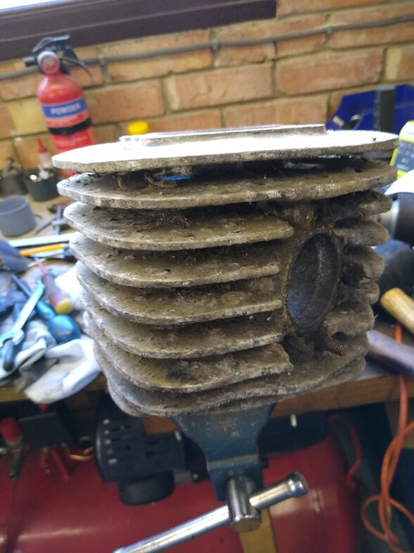

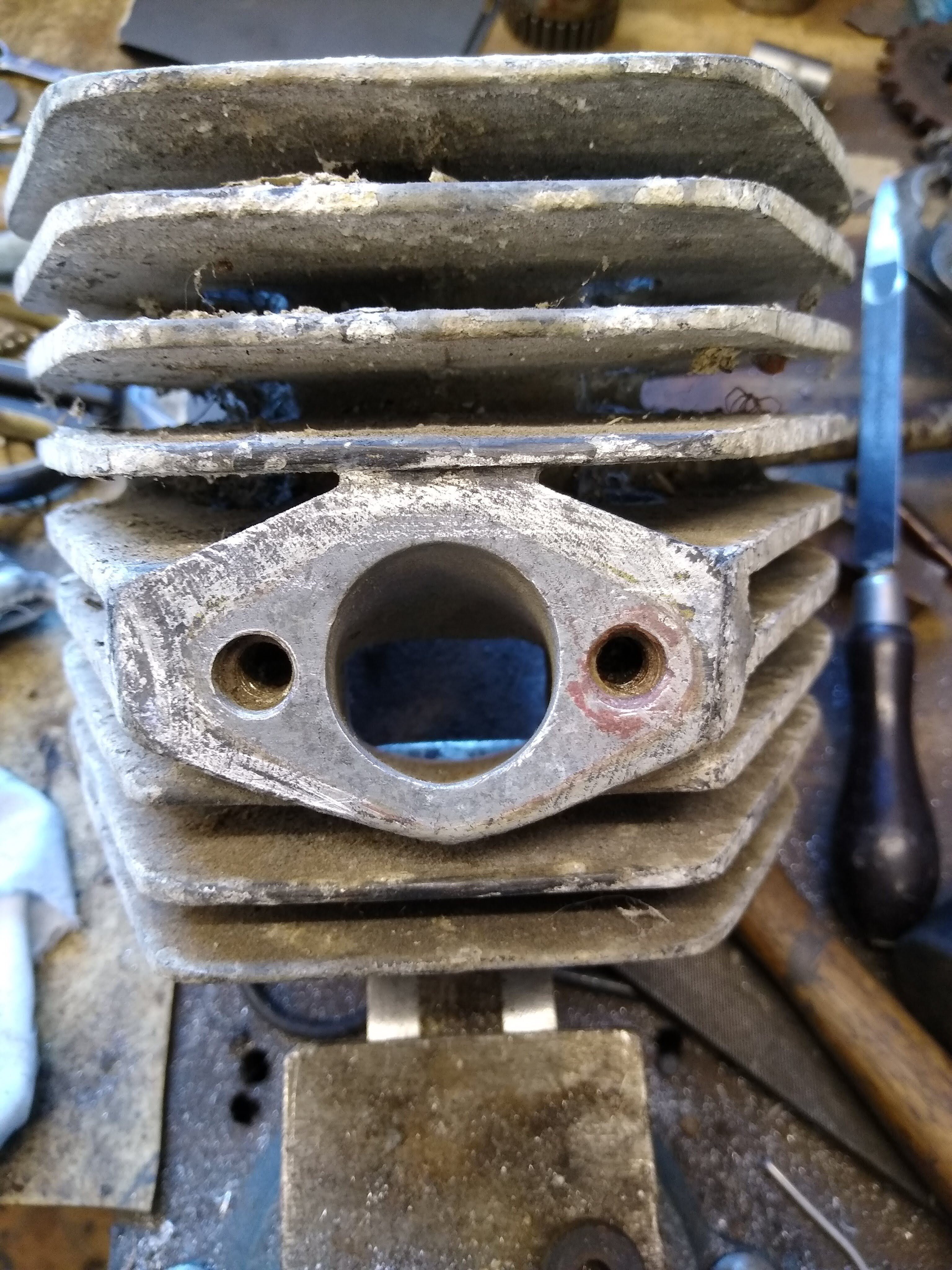

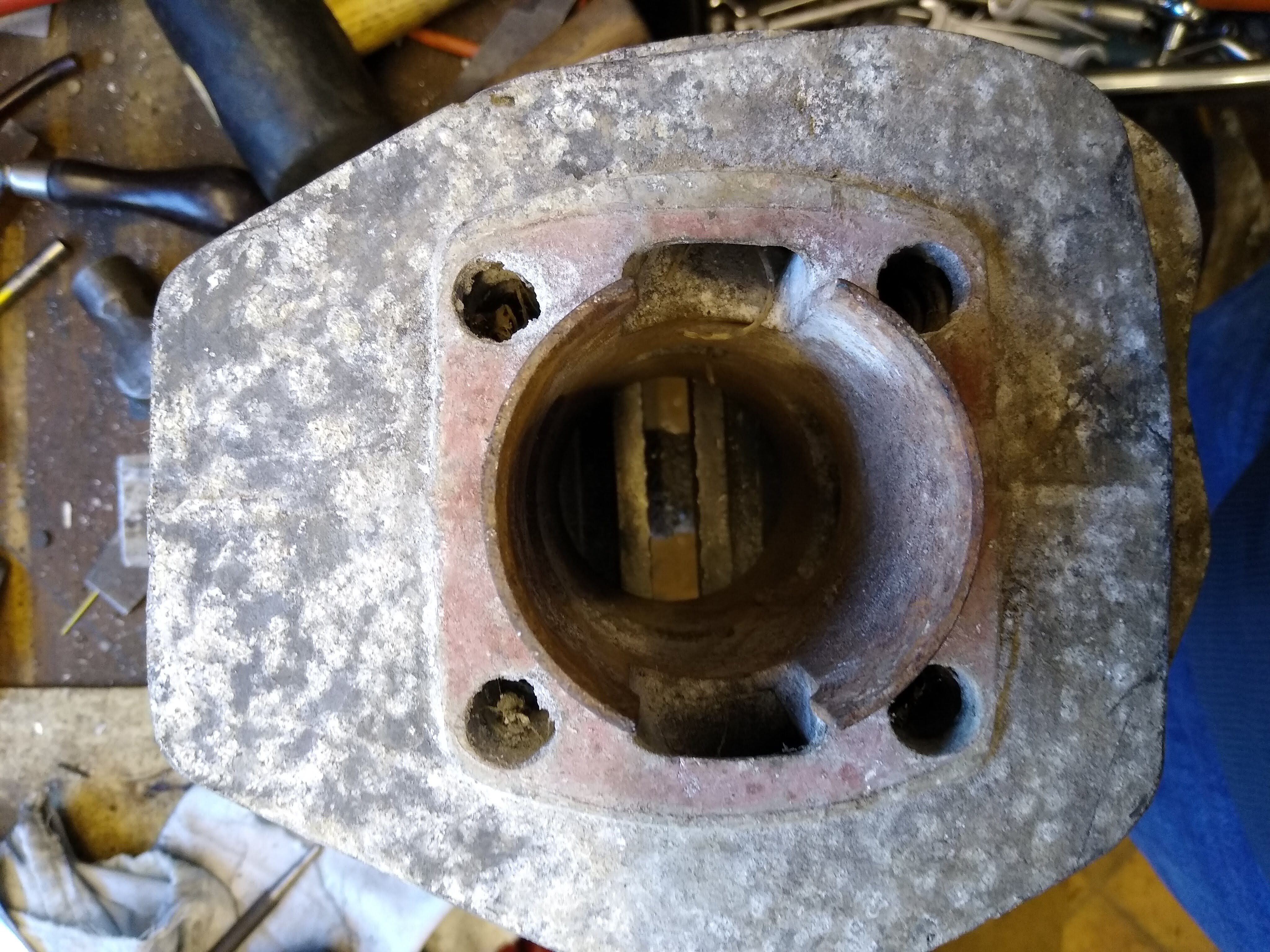

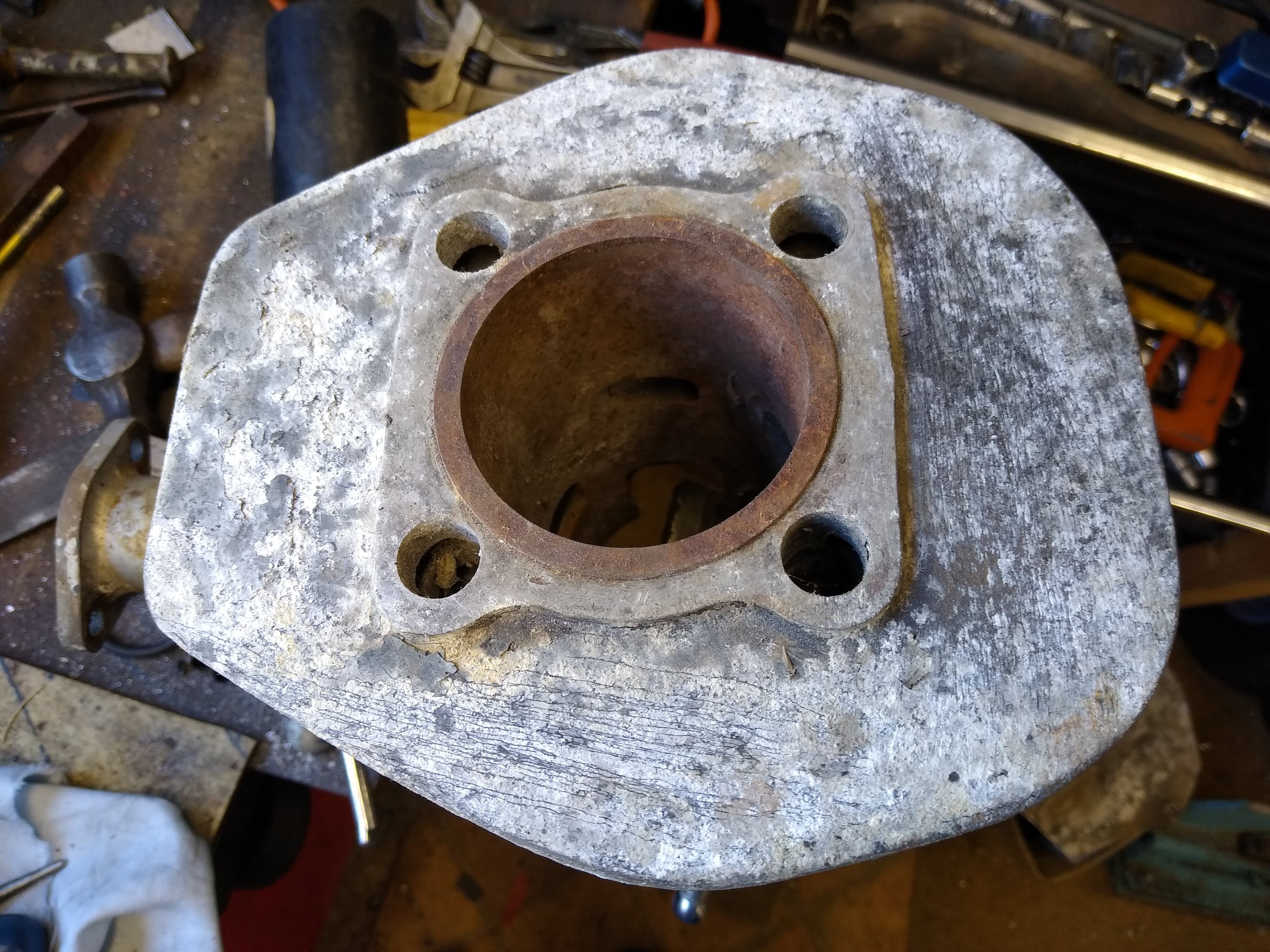

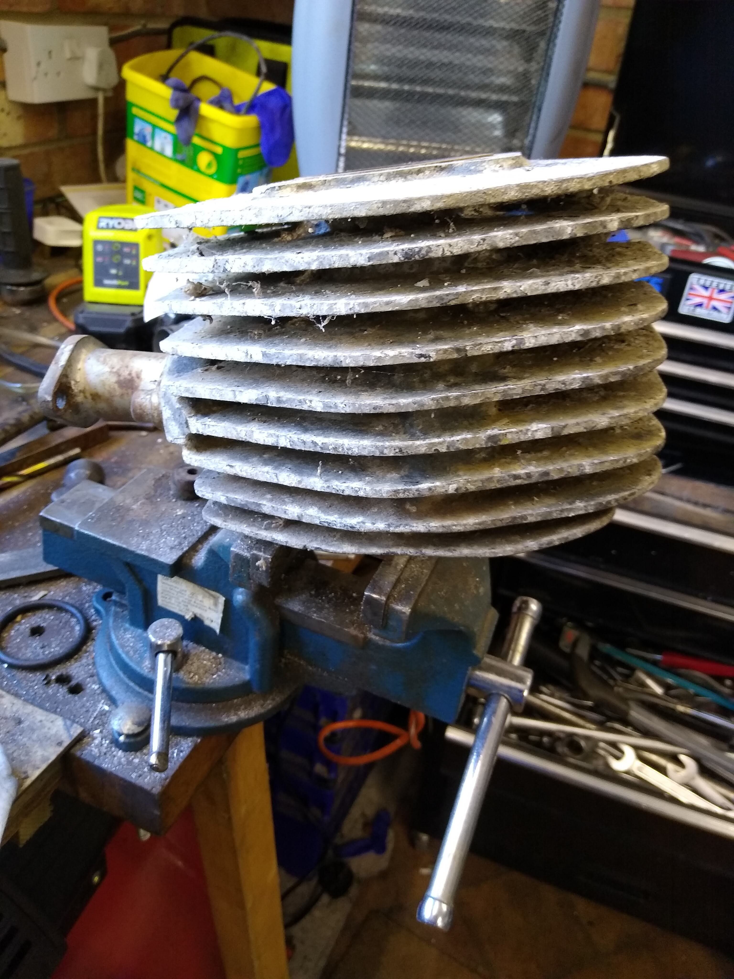

greevesman Posted March 25, 2021 Report Share Posted March 25, 2021 (edited) Can anyone help identify this Alloy barrel which came with some Villiers engine parts ?,it fits Villiers 37A cases and is 66mm bore . I'm sure its a trials barrel not scrambles Edited March 25, 2021 by greevesman add information Quote Link to comment Share on other sites More sharing options...
trialsrfun Posted March 25, 2021 Report Share Posted March 25, 2021 (edited) Ask Steve at Villiers Services but if I were to make a guess it could be a Greeves Challenger barrel with the fins cut back or less likely a DMW Marcelle? Can you post pictures of the head The Challenger barrel came in trials or MX versions but dont really know if other than the carb manifold and a spacer between head and cylinderthere was really much difference Edited March 25, 2021 by trialsrfun Quote Link to comment Share on other sites More sharing options...
greevesman Posted March 25, 2021 Author Report Share Posted March 25, 2021 (edited) Unfortunately I dont have the head , it maybe a cut down Greeves Challenger barrel I have Challenger barrel on 2 of my bikes so will check against them tomorrow. Simon Edited March 25, 2021 by greevesman Incorrect info Quote Link to comment Share on other sites More sharing options...

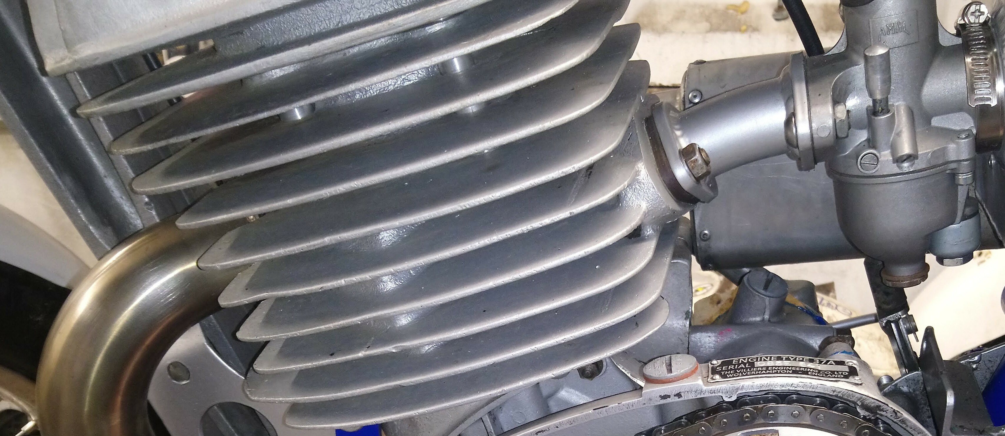

greevesrob Posted March 25, 2021 Report Share Posted March 25, 2021 Cut down challager barrel I would say. Looking at the photos the angle of the inlet suggests scrambles not trials. On the bottom of the inlet it should be stamped with model. This is mine Quote Link to comment Share on other sites More sharing options...
peterb Posted March 26, 2021 Report Share Posted March 26, 2021 I've seen a barrel just like the one in the first photo today, in a museum in Hamilton NZ, on a DMW. I thought it looked like it had been home made, and didn't think it was a Marcelle, but perhaps it is. The fins are a lot thicker than the Challenger barrel, so I don't think it would be one of those.Shame that I didn't take a close look at the exhaust mounting. I will be back there in a couple of weeks and have another look. Bye, Peter B. Quote Link to comment Share on other sites More sharing options...
teamferret Posted March 26, 2021 Report Share Posted March 26, 2021 (edited) Don't think it is challenger as the fins are too thick and few. Edited March 26, 2021 by teamferret Quote Link to comment Share on other sites More sharing options...
greevesman Posted March 27, 2021 Author Report Share Posted March 27, 2021 23 hours ago, peterb said: I've seen a barrel just like the one in the first photo today, in a museum in Hamilton NZ, on a DMW. I thought it looked like it had been home made, and didn't think it was a Marcelle, but perhaps it is. The fins are a lot thicker than the Challenger barrel, so I don't think it would be one of those.Shame that I didn't take a close look at the exhaust mounting. I will be back there in a couple of weeks and have another look. Bye, Peter B. Thanks Peter ,would be good to have photo if possible . Simon Quote Link to comment Share on other sites More sharing options...

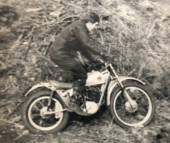

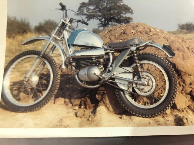

greevesman Posted June 4, 2021 Author Report Share Posted June 4, 2021 (edited) Had confirmation from Alan Garrett who help build bike and owned and rode the bike in the late 60s early 70s that it is a cut down Greeves Challenger ,I have managed to get Challenger head so will get cut down to match barrel. The bike it comes from is a Burian built by John Banks BSA works rider in 1965 . Will post photos of rebuild as it takes shape . Second photo is of Alan Garrett riding in the early 70s Simon Edited June 4, 2021 by greevesman Quote Link to comment Share on other sites More sharing options...
