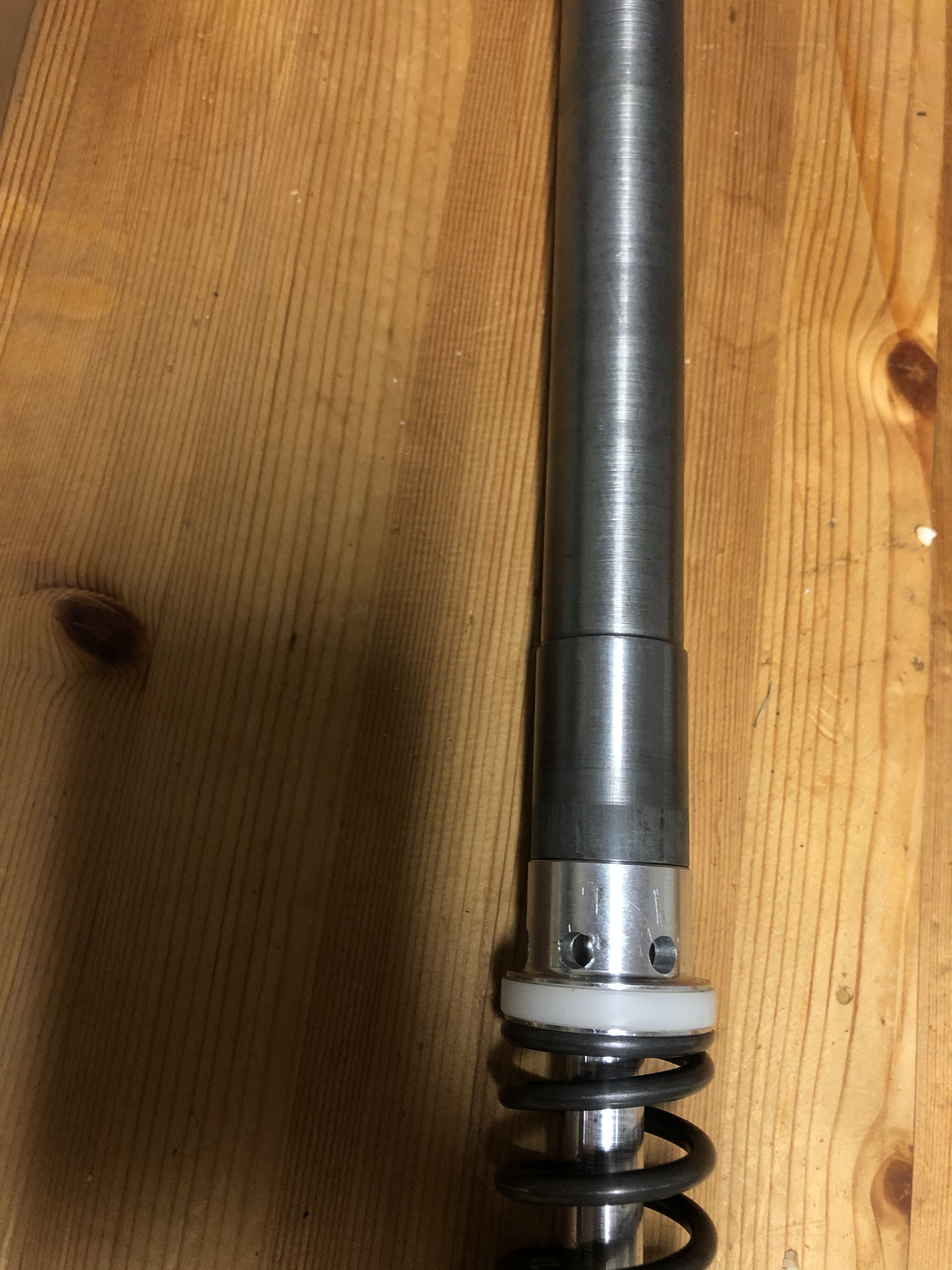

I’m hoping someone can explain how I remove the springs from  97 JTX 270.

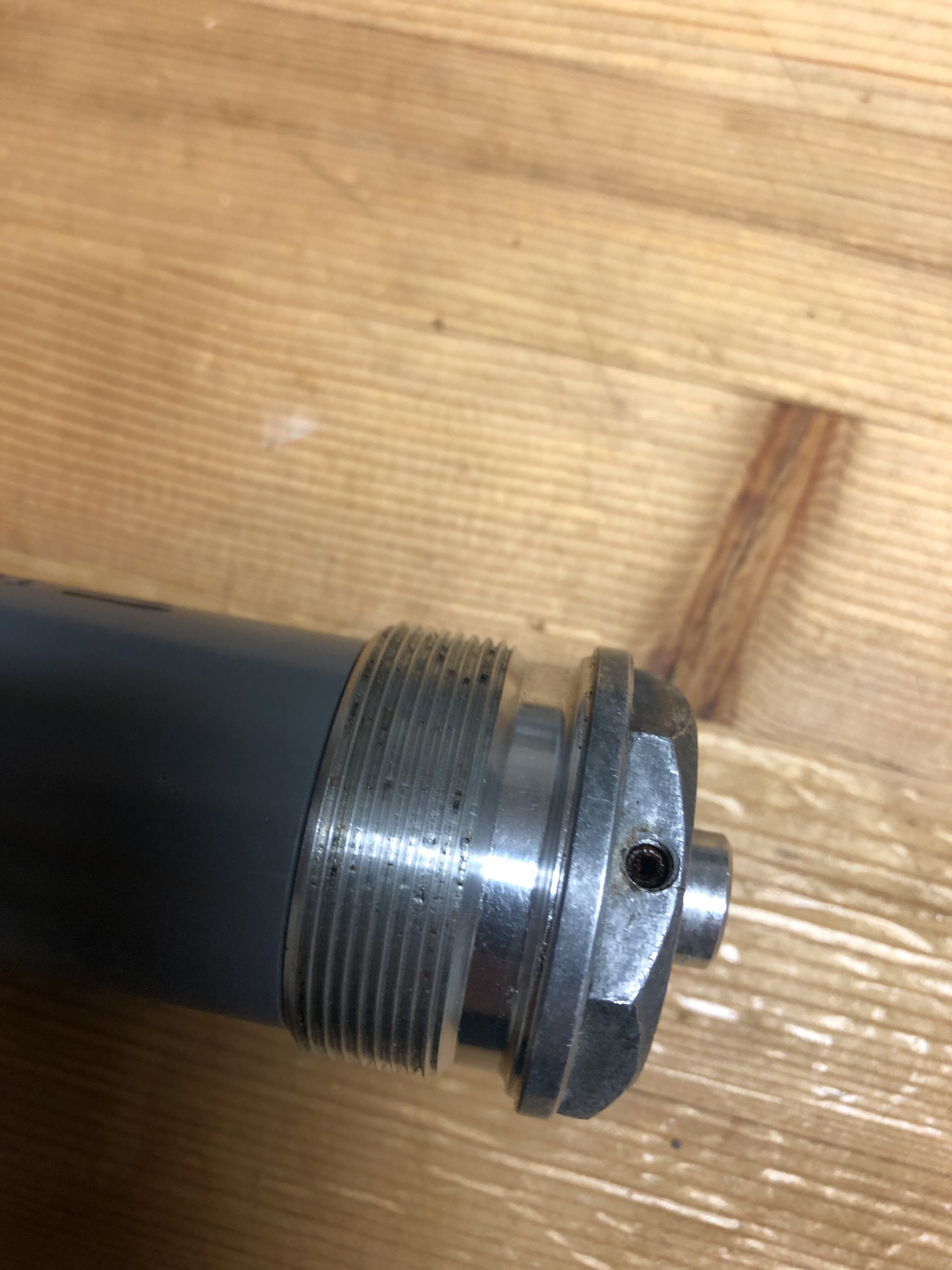

Bike was given to me and I’m fitting it with stiffer springs. Getting the cartridge pulled out was a snap,but now I’m struggling to remove the actual springs. There was a tiny Allen bolt in the cap and I was wondering if that has something to do with it? Other though was the aluminum ring on the lower steel section.
thanks Paul

Pull the spacer down at the top and you'll see that the top cap is screwed on and also held with a lock nut, there's a tool you can buy or make to hold the spring out of the way while you undo it.

Thanks so much. I guess I wasn't pulling it down far enough. Makes way more sense.
Found this after your message. So everything makes sense now
