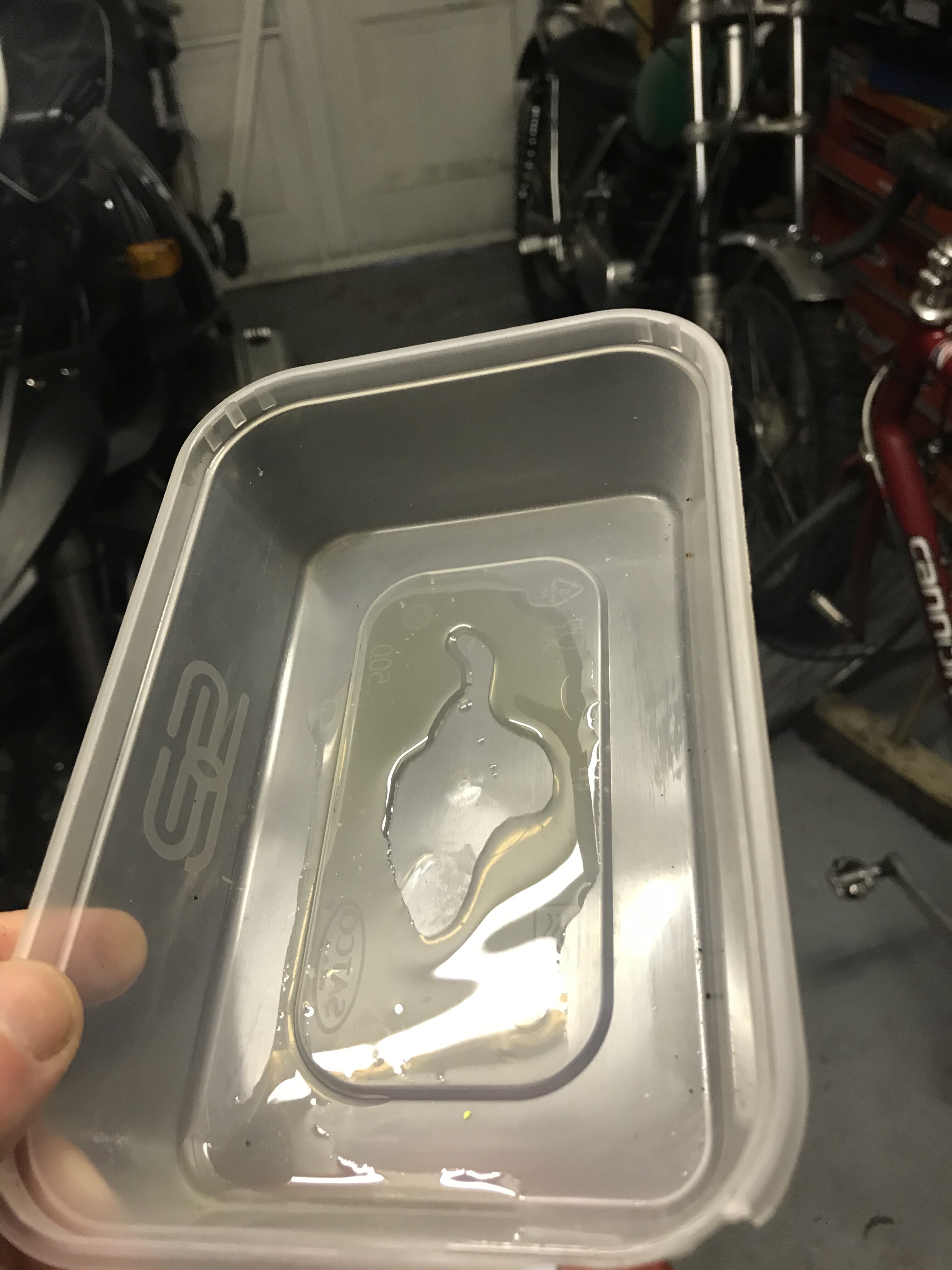

However, this increases if the engine is running. Its hard to measure accurately while using the bike but if I run the bike for 10 mins, shut it off and put a tray underneath I will have a patch of oil about the size of my hand by the end of the day . This continues for a day or so then reduces back to the odd drop
After all my rambling here’s the question. Is what I’m describing normal? If this is what I should expect from an old Spanish trials bike then fine, I won’t lose sleep over it. But if not I’m going back to the guy that rebuilt it . Just trying to set my expectations really!
I will try to include a pic of what I collected in a Chinese container over about 6 hours post the engine running. As I said if it hasn’t been running for a day or two the leakage is fairly insignificant .

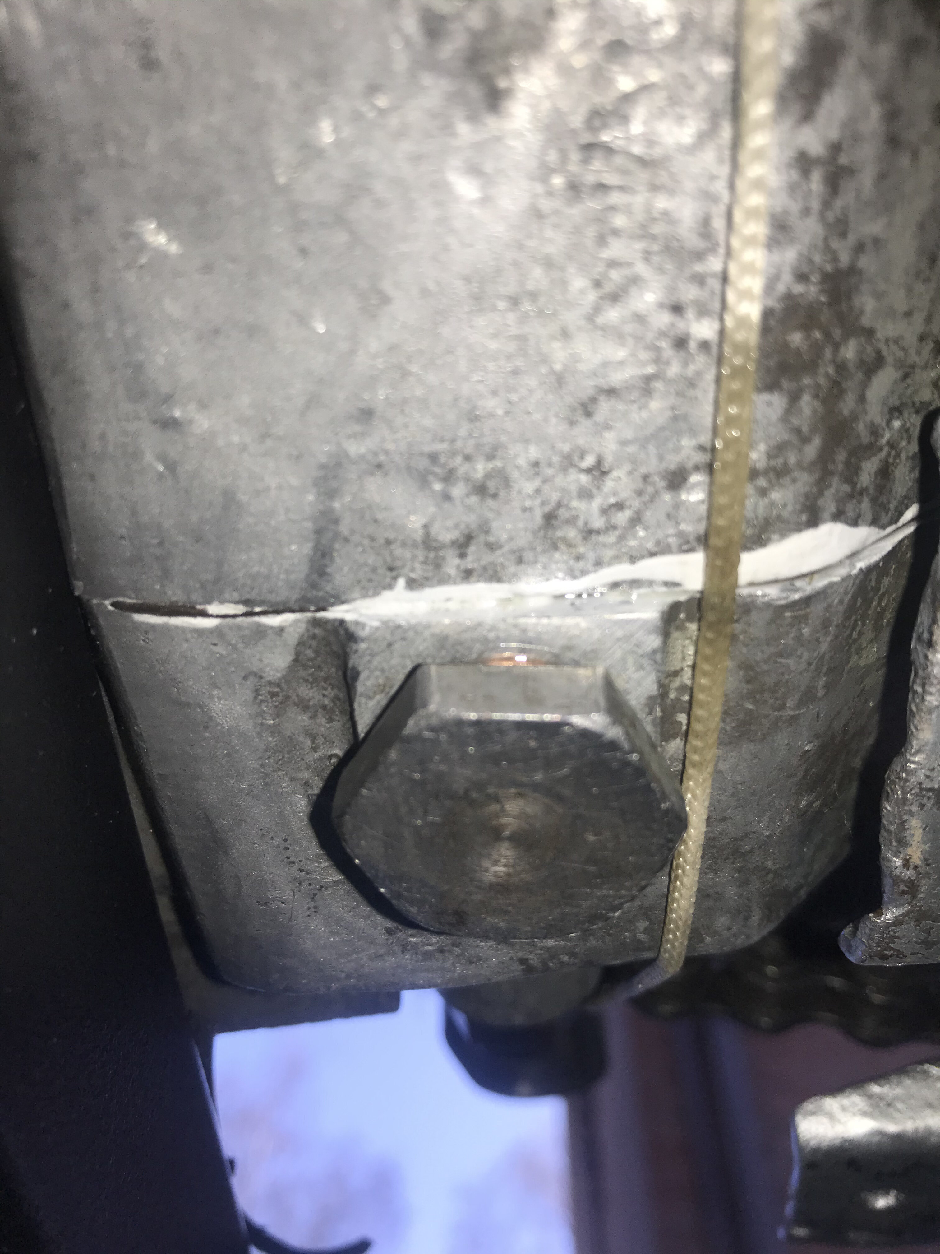

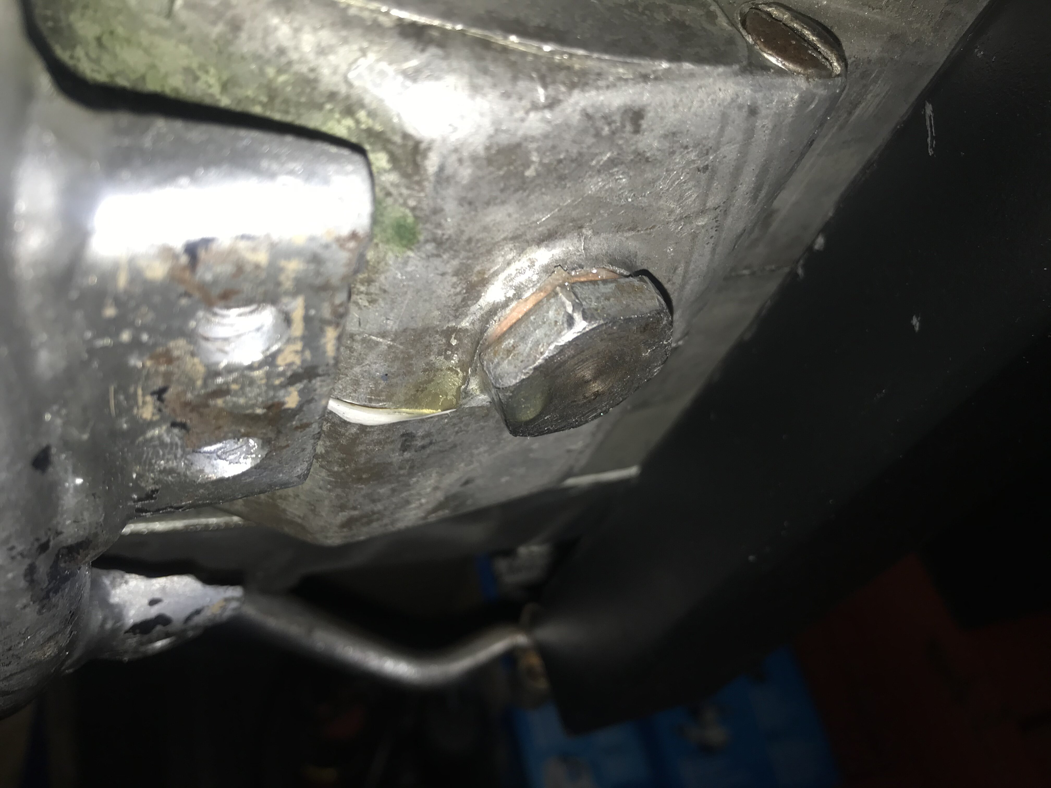

No sign of gasket poking through only what I assume is a white assembly/gasket paste or something. I’ve attached a picture. I tied this string over where I suspected the leak is to stop the flow continuing downwards. it’s at a slightly higher level than the drain plug and as you can see in the pictures it’s wet with oil. So pretty confident it’s not the plug and no sign of it flowing from another source higher up .
Thanks for the info, I’m going to give the builder a ring

They shouldn't leak. I've found using talc helps pinpoint where it first comes from, dry it all off, shower it in talc and then you can see where the wet patch first appears
What can happen with the MAR is that the bashplate gets bent upwards in the middle from repeated contact with the scenery and this can expose the sump plug. If the plug then starts taking hits it can crack the casing around the plug but yours looks fine. It could possibly cause distortion which stops the cases mating fully, not sure
Some of the gaskets these days are horribly thin and if there is any imperfection in the mating surfaces oil finds a way past and drips
Yours has grey sealer as well as a gasket., possibly 3 bond as that is grey but that would usually fill any imperfection in the mating surface I'd have thought as it's good stuff
The gear shaft has an O ring either end but from the ignition side it can't be replaced without splitting the engine as the shaft can't be removed without splitting. It might be possible with the end of the gear shaft cut off flush with the casing to expose the O ring if the shaft is pushed fully inwards with the clutch cover off
I've found with these older engines that it's best to put a little oil in before fitting back into the bike and leaving for a day or two to see if there are any leaks.
A short term fix is dry it all off once you've pinpointed the leak and apply some plastic padding leak fix along the gasket which should hold it. The only correct fix is a strip and inspection of the mating surfaces which might need facing off or to see if there is a hairline crack anywhere
First though, see if you can tighten the crankcase screws any further - you never know...
