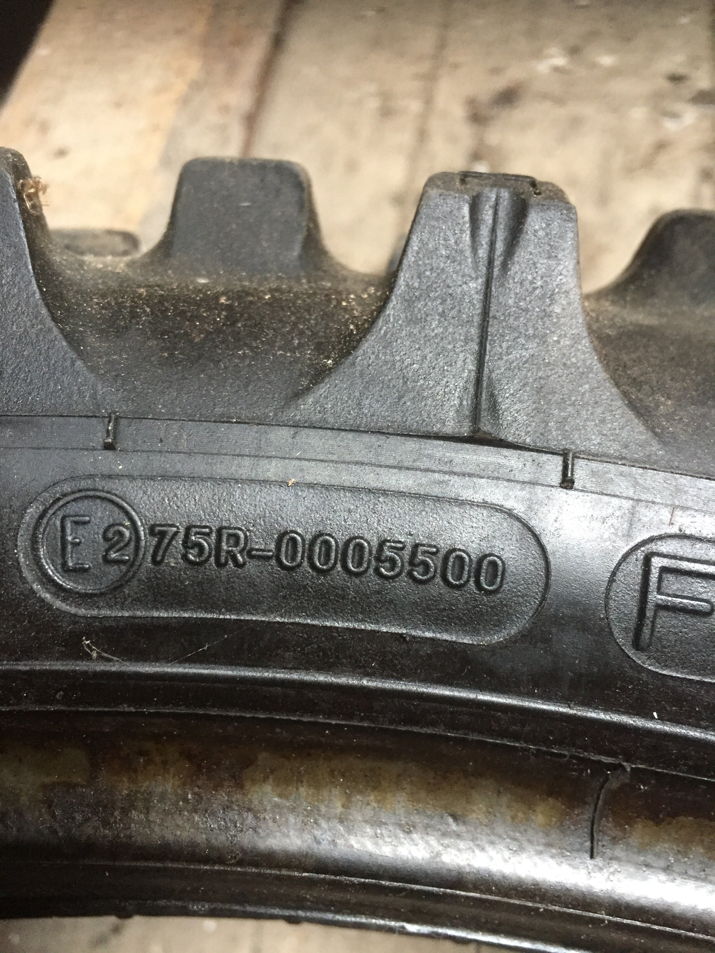

Lee halsall Posted April 6, 2021 Report Share Posted April 6, 2021 I looked up the E2 on this enduro tyre that I intend to fit to the rear of my Alpina . It looks like it’s road legal in France . Is it legal in UK ? Quote Link to comment Share on other sites More sharing options...
rcgods Posted April 7, 2021 Report Share Posted April 7, 2021 From the MOT Manual section 5.2.3 https://www.gov.uk/guidance/mot-inspection-manual-for-motorcycles/5-wheels-tyres-and-suspension Additionally, motocross tyres, tyres designated by their manufacturer as racing tyres and tyres marked ‘NHS’ or ‘NOT FOR HIGHWAY USE’ on the sidewall are also unsuitable, unless the tyre sidewall is marked with: an ‘E’ in a circle an ‘e’ in a rectangle JIS (Japanese industry standard) DOT (American standard) Quote Link to comment Share on other sites More sharing options...
Lee halsall Posted April 7, 2021 Author Report Share Posted April 7, 2021 Well that’s an E in a circle so I guess I’m good to go . Thanks . Quote Link to comment Share on other sites More sharing options...
jonboy883 Posted April 8, 2021 Report Share Posted April 8, 2021 It's type approve to use in the EU, thus the country designation, so, yes it's legal. the not for highway use stuff is for the US market, only ever taken note off, when they are no markings on the tyre. Quote Link to comment Share on other sites More sharing options...
rcgods Posted April 8, 2021 Report Share Posted April 8, 2021 And if the marking was on the tyre a little effort with a sanding disc would remove the wording apparently if you have a strict tester. A tester I know will look past little things like that as long as the machine is safe! Quote Link to comment Share on other sites More sharing options...
