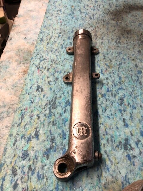

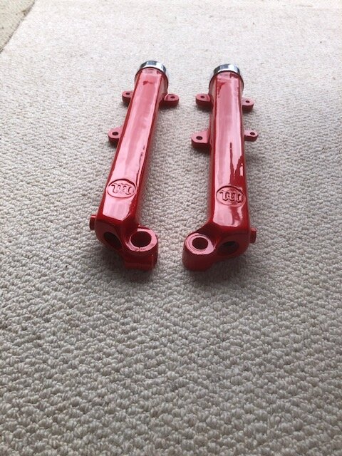

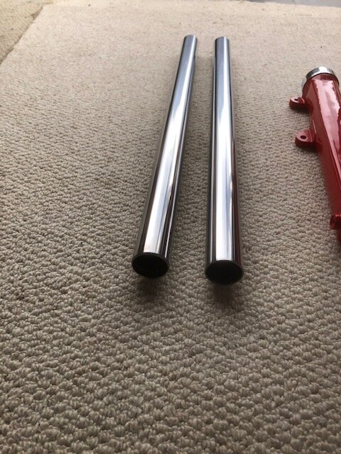

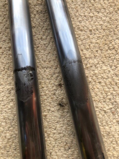

fox889 Posted May 3, 2021 Author Report Share Posted May 3, 2021 Moving on to the forks, there were signs of past chrome on the fork outers so this was flap wheeled off, primed & coated silver (photo not my silver job😜) looked ok, but didn’t jump out & say “that’s nice!”. Reading a comment or two on here plus looking on the ‘net I saw the majority of 349’s had red fork outers & not silver, this convinced me to re-spray them again, this time Montesa red, turned out ok, really pleased with them. If anyone is thinking of painting the same colour, it’s VW Mars red, I chose Hycote paint as it’s readily available on eBay at various prices, goes on a real treat & does come up well. I wet sanded with 2000 grit then a coat of fine compound then 3M finishing glaze, looks ok. The fork stancions........oh lord, they were bad! I tried the old cheapo trick of epoxy resin over the pitts, rubbed down with paper, this worked well......to a degree, and probably would be fine for the odd ‘pitt’ here & there, but as you can clearly see, they were goosed! Chose Philpotts from Luton, not the cheapest, but, their service was unquestionable from organising collection to delivery. Lead time was 8 weeks, but think mine were done inside 6 weeks. They look really good compared to what I sent them, £195 all in, which ain’t bad, is it! Quote Link to comment Share on other sites More sharing options...
