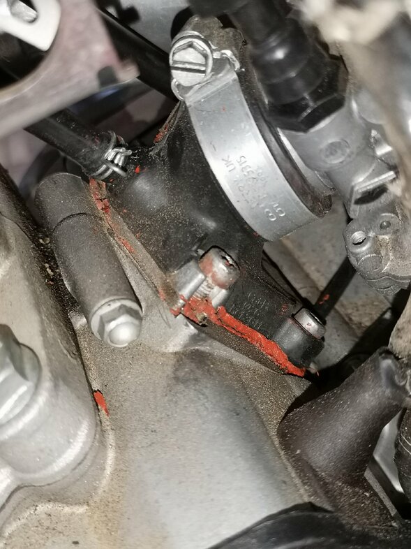

JonM Posted May 6, 2021 Author Report Share Posted May 6, 2021 (edited) OK, I spoke to the dealer today and they've agreed to take it back. All on good terms- easy. I'm just in the garage now having a look and thought I'd poke around a bit, and it looks like the inlet manifold is missing a corner? Now I wonder if that first 5mins was enough to heat the bike up, interfere with the sealant and cause an air leak? Also, whilst searching the forum I read a post where it was recommended to a Sherco owner to use LOWER octane fuel who had similar issues- is this a thing? Edited May 6, 2021 by JonM Added info Quote Link to comment Share on other sites More sharing options...
tony27 Posted May 7, 2021 Report Share Posted May 7, 2021 The sealant does suggest a problem there, possible that a new manifold would help. Is the dealer refunding you or going to sort the issue for you & give the bike back when it's running properly? Quote Link to comment Share on other sites More sharing options...
