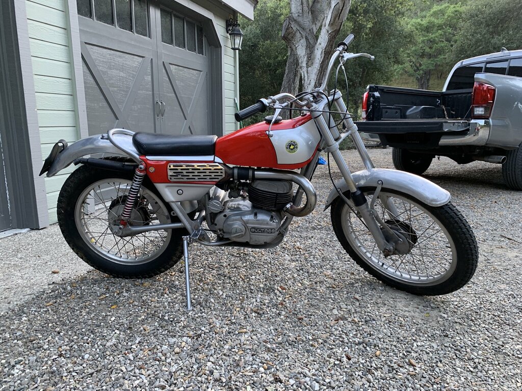

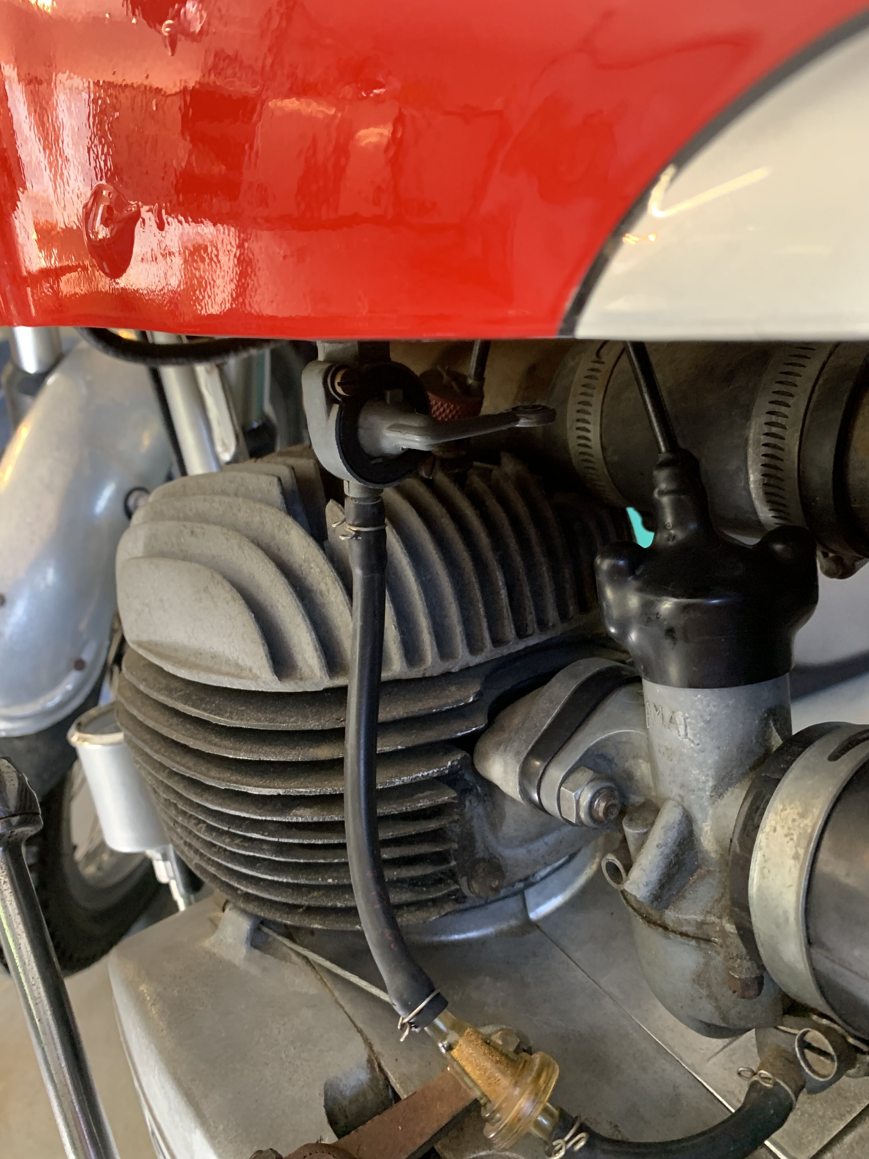

wilbur Posted May 4, 2021 Report Share Posted May 4, 2021 Proud owner of newly acquired 71 Bultaco Sherpa T 250 (seller said it was a '71 but I have not fully verified yet) First question! It's about the petcock, which I think the seller gave me incorrect info about...After some testing I believe the pic below is the "off" position (lever at 3 oclock, aka, pointing at right hand side). Is that correct? And "on" would be straight down (6 oclock) and reserve pointing at left hand side (9 oclock) ? 1 Quote Link to comment Share on other sites More sharing options...
naichuff Posted May 4, 2021 Report Share Posted May 4, 2021 You are correct down is on The lever is usually marked with a C and R closed and reserve 3 Quote Link to comment Share on other sites More sharing options...

feetupfun Posted May 10, 2021 Report Share Posted May 10, 2021 (edited) If it goes good before it dies during sustained high power then it's not float height. From what you have said it sounds like the fuel level goes down with sustained high power. The usual causes for this (apart from low fuel level in the tank which you have already tested for) are: Restrictive fuel tap. I can see in your photo that you have the original type fuel tap and they are notorious for having a poor flow rate. Blocked strainer on the fuel tap inlet. Blocked fuel strainer inside the banjo fitting on the carby. Blocked in-line fuel strainer. Blocked tank vent. To answer your question about the float height yes you can adjust the fuel height by using different thickness bowl gaskets. If I have misinterpreted what you said and you are actually saying that it dies when the front of the bike is above the back of the bike then that is a different kettle of fish and you can test for this by lifting the front of the bike up with the motor running and see if it makes a difference. There is a weakness with concentric bowl AMAL carbys in that if the front of the bike goes a lot lower than the back of the bike as in dropping down something extremely steep, the idle speed can drop off sharply. That weakness is one reason I use a modern carby on my model 49. Edited May 10, 2021 by feetupfun 2 Quote Link to comment Share on other sites More sharing options...

wilbur Posted May 17, 2021 Author Report Share Posted May 17, 2021 Replaced petcock, fuel line from tank to carb, and inline fuel filter. All those things helped. To be honest though... I think it needed *even more* gas in the tank. I realized the tank had been lined with something to protect the fiberglass from the ethanol. Which is great! But it gives the interior of the tank and bumpy and uneven inner topography. So I think it needs a pretty full tank in order to get full fuel delivery especially on a steep incline. Regardless, it is very peppy going UP the dirt road now. Descending a steep hill I experienced the sudden drop in idle that you mentioned @feetupfun - if I was doing more serious rides on a frequent basis, I would probably look into replacing the carb, but for now I will just keep it original. Thanks for the tips. 1 Quote Link to comment Share on other sites More sharing options...
