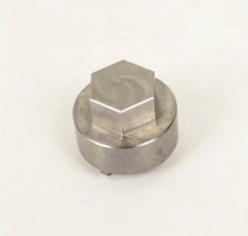

user7743 Posted May 14, 2021 Report Share Posted May 14, 2021 Hi all, I need to change my fork oil and seals on a 2017 Factory. I was looking at the right hand fork and realised its not the standard square bolt for cap fitting. Does anyone know the proper way to remove the fork cap on this? You can see what I mean in the picture. Thanks! Quote Link to comment Share on other sites More sharing options...
wheelieman14 Posted May 14, 2021 Report Share Posted May 14, 2021 Beta makes special tool for that fork cap, costs around $60. Someone posted on FaceBook that they can make them for much less. Quote Link to comment Share on other sites More sharing options...
mcman56 Posted May 15, 2021 Report Share Posted May 15, 2021 I made a tool by putting a couple of dowel pins at the right distance in a bar of 1/4" aluminium. The cap was pretty loose so maybe even a pair of needle nose pliers would work. Quote Link to comment Share on other sites More sharing options...
overdale Posted May 15, 2021 Report Share Posted May 15, 2021 As mcman56 says, a simple tool can be made, or carefully use circlip pliers. The cap should not be very tight as it relies on the o-ring as the oil/air seal. If you are ever loosening the cap in the bike, remember to slacken the top yoke clamp screw first as it can nip the thread of the cap. 1 Quote Link to comment Share on other sites More sharing options...
user7743 Posted May 15, 2021 Author Report Share Posted May 15, 2021 Thanks all. I suspected it would be something similar. Quote Link to comment Share on other sites More sharing options...
John54 Posted May 15, 2021 Report Share Posted May 15, 2021 I’m sure Hippel Racing in Germany were selling the tool on their Facebook page for about 14 Euros (I think) plus postage 1 Quote Link to comment Share on other sites More sharing options...
MIckyT Posted May 15, 2021 Report Share Posted May 15, 2021 strong circlip pliers will undo the cap Quote Link to comment Share on other sites More sharing options...
