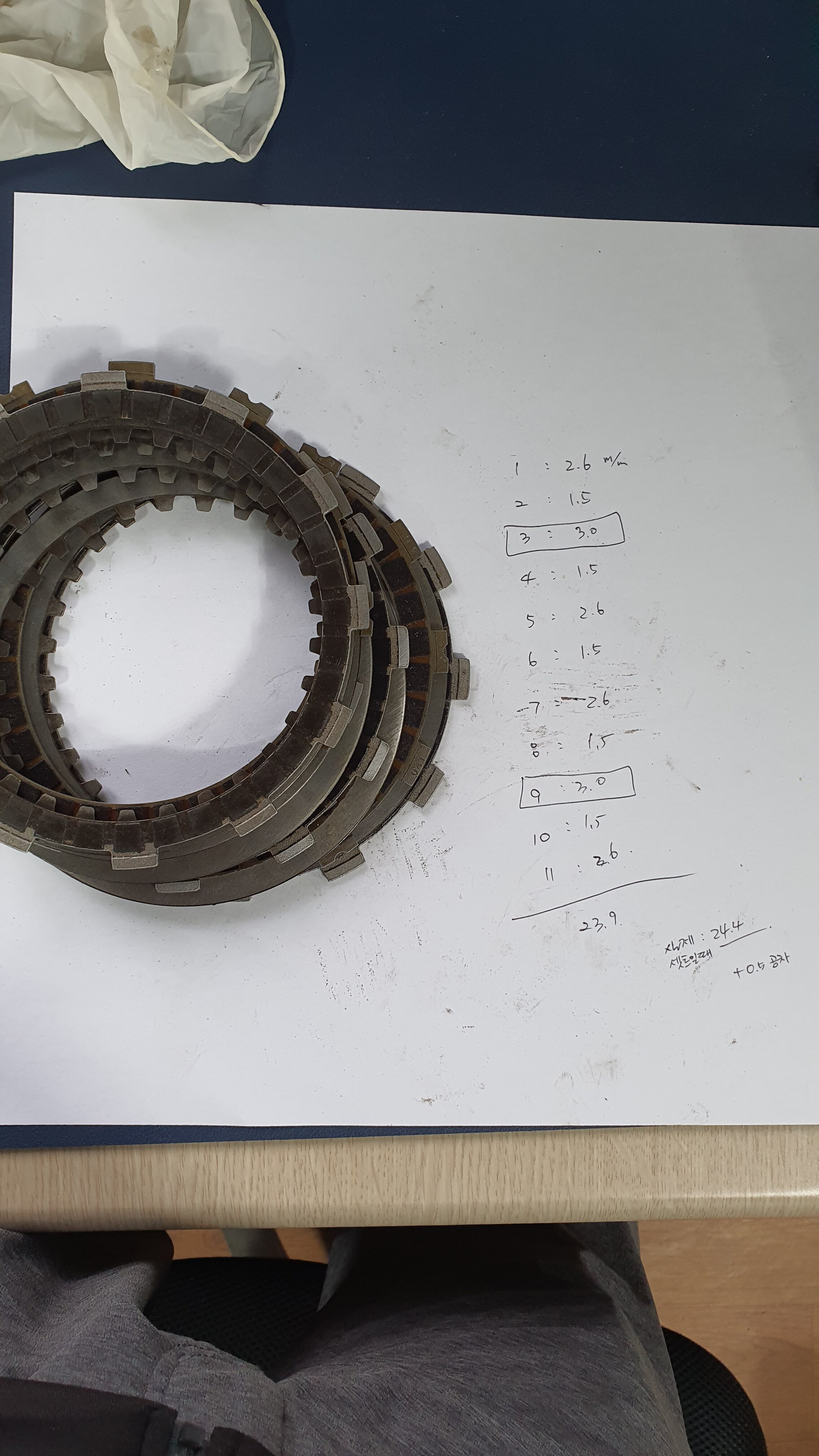

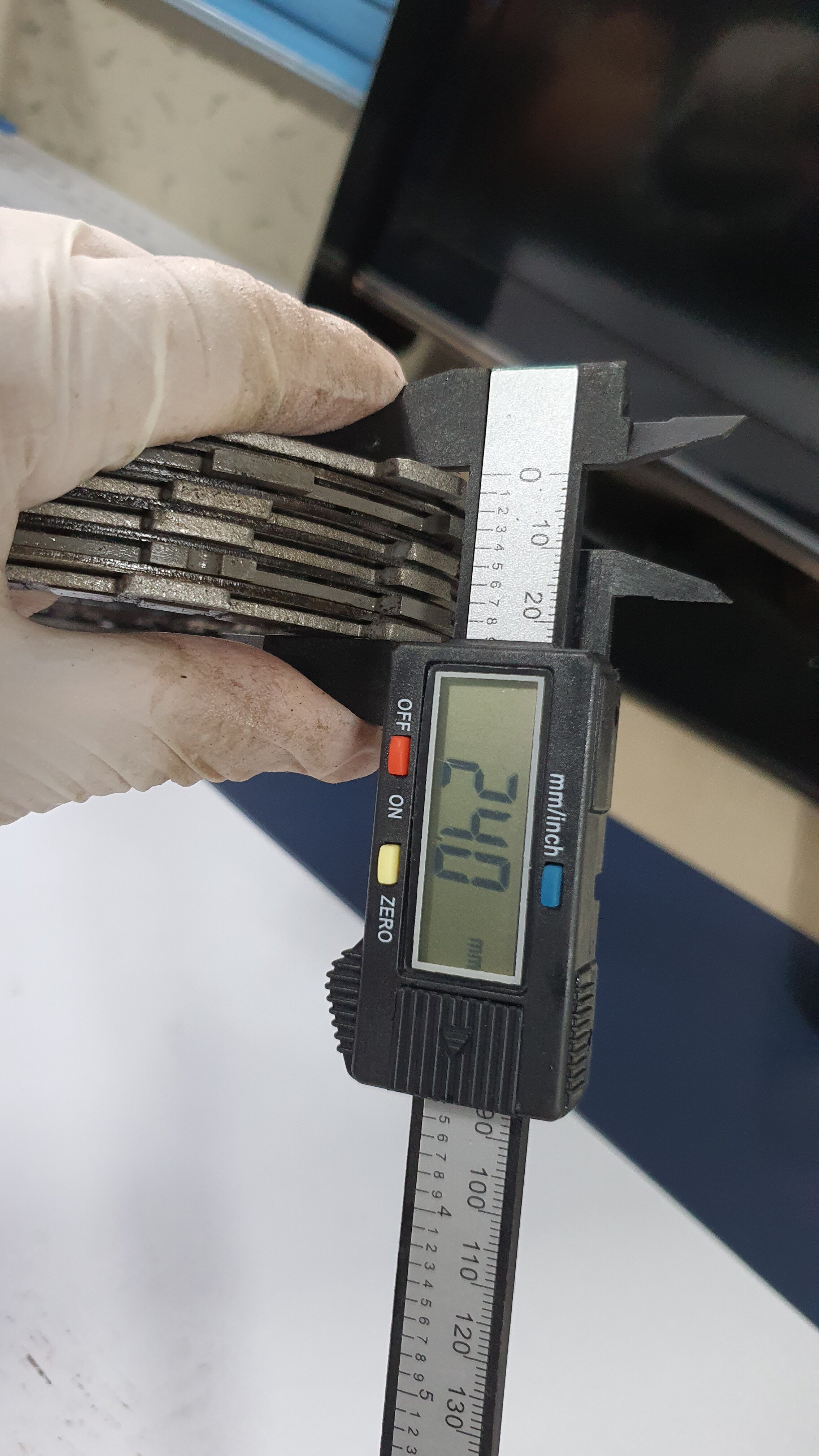

jacsal Posted June 3, 2021 Report Share Posted June 3, 2021 Hi, friends. I have a Sherco 2016 st300 trials bike. The clutch's too heavy. I'd like to know the clutch replacement cycle. The manual says the clutch is up to 2.6 millimeters thick.(per 1 plate) When I measured mine, four were 2.6 millimeters and two were 3 millimeters. I don't know why there are two 3 millimeters in here.I wonder if this is how the new clutch pack works. And the total is 24.0 millimeters. Let me know the thickness of them when combined. Or tell me if I need to replace clutch mineral oil. Thank you, fellas. Quote Link to comment Share on other sites More sharing options...

Saulus Posted June 4, 2021 Report Share Posted June 4, 2021 The reason there are two thicker plates is the racing friction clutch from 2014 models. Maybe stiffer springs that are reason for heavier pull. Have you tried do drive with 4 springs? Any suggestions? Quote Link to comment Share on other sites More sharing options...
