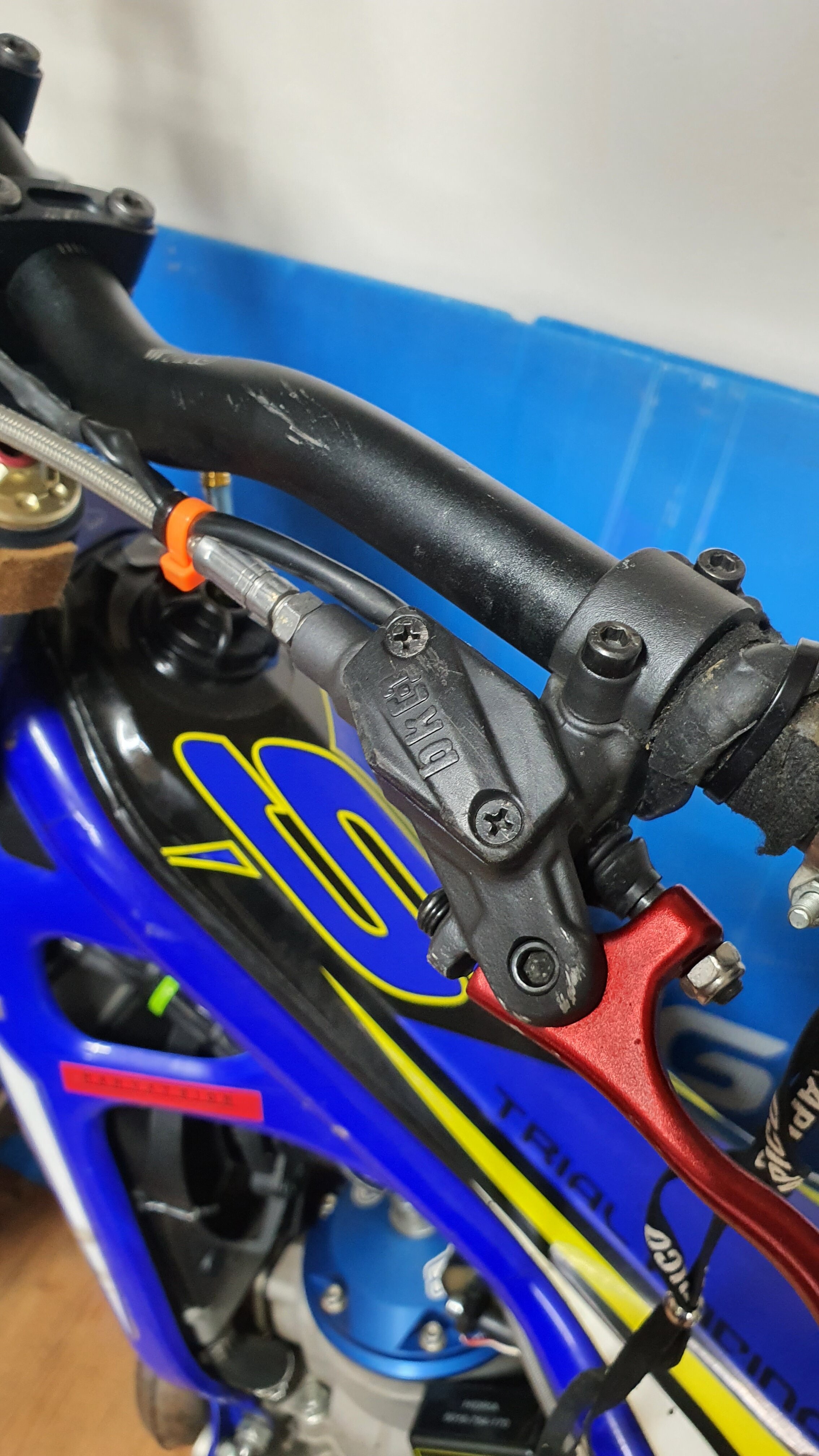

jacsal Posted June 4, 2021 Report Share Posted June 4, 2021 What kind of clutch oil should I use? sherco trial 300 2016. Do I have to use mineral oil? I know the mineral oil cap is green. But, The cluch cap is black, can I use brake oil? Quote Link to comment Share on other sites More sharing options...

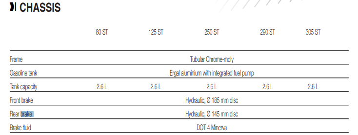

kaarelj Posted June 4, 2021 Report Share Posted June 4, 2021 Manual Says DOT 4 (they prefer Minerva as vendor, but does not matter) Quote Link to comment Share on other sites More sharing options...
jacsal Posted June 4, 2021 Author Report Share Posted June 4, 2021 1 hour ago, kaarelj said: Manual Says DOT 4 (they prefer Minerva as vendor, but does not matter) Thank you, but what I'm asking is clutch oil. Quote Link to comment Share on other sites More sharing options...

cascao Posted June 5, 2021 Report Share Posted June 5, 2021 In fact it is not the cap that is green. The rubber under the cap that is green when mineral oil is used. (Mostly) You can double check with a drop in water: 1 dot oil mix well with water and turn white. 2 mineral oil floats 2 Quote Link to comment Share on other sites More sharing options...
