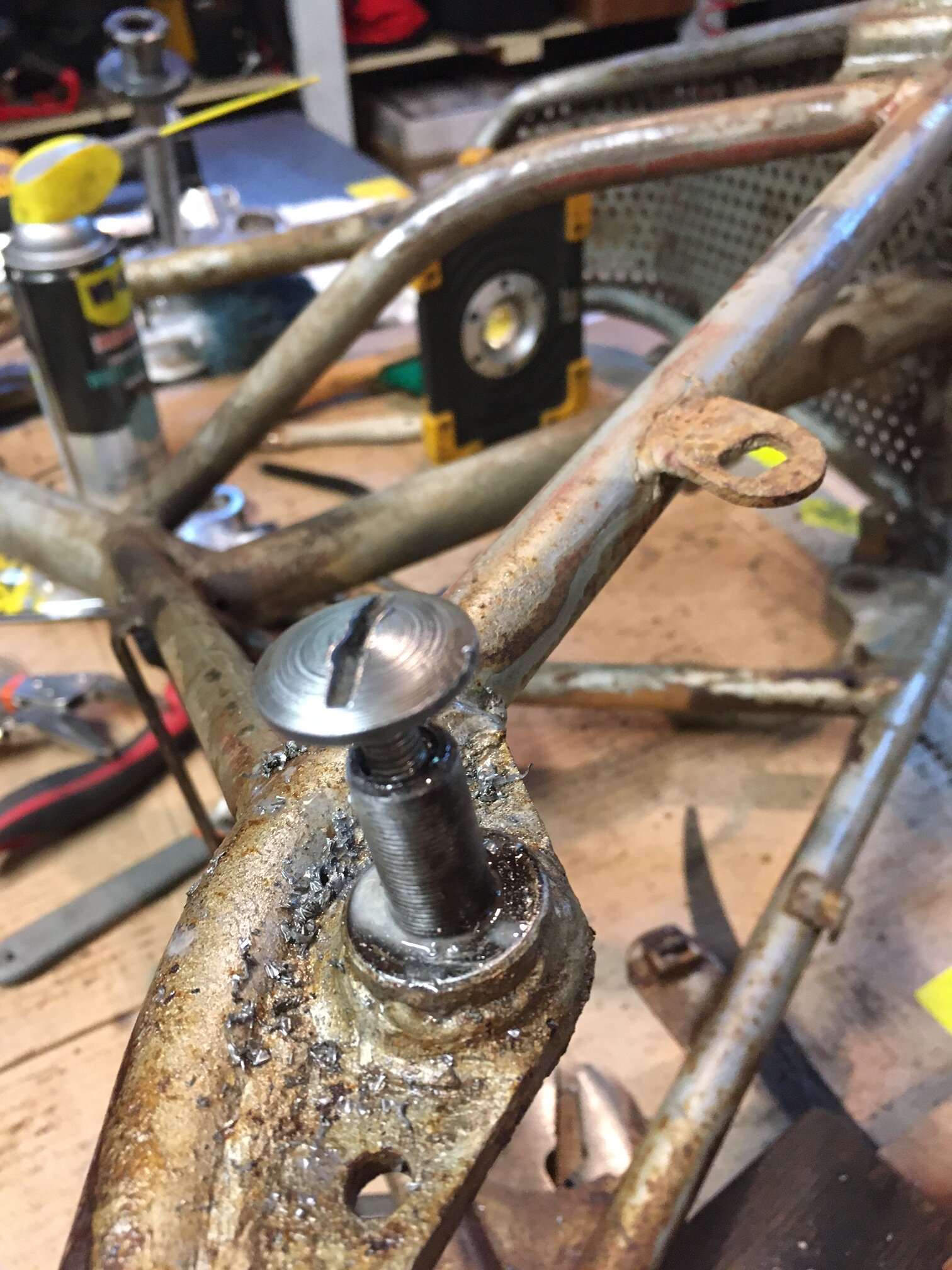

Divouneh Posted June 30, 2021 Author Report Share Posted June 30, 2021 Shock Absorber screw repaired: drilled and tapped..🙄 Seems to be a common trouble ? 1 Quote Link to comment Share on other sites More sharing options...

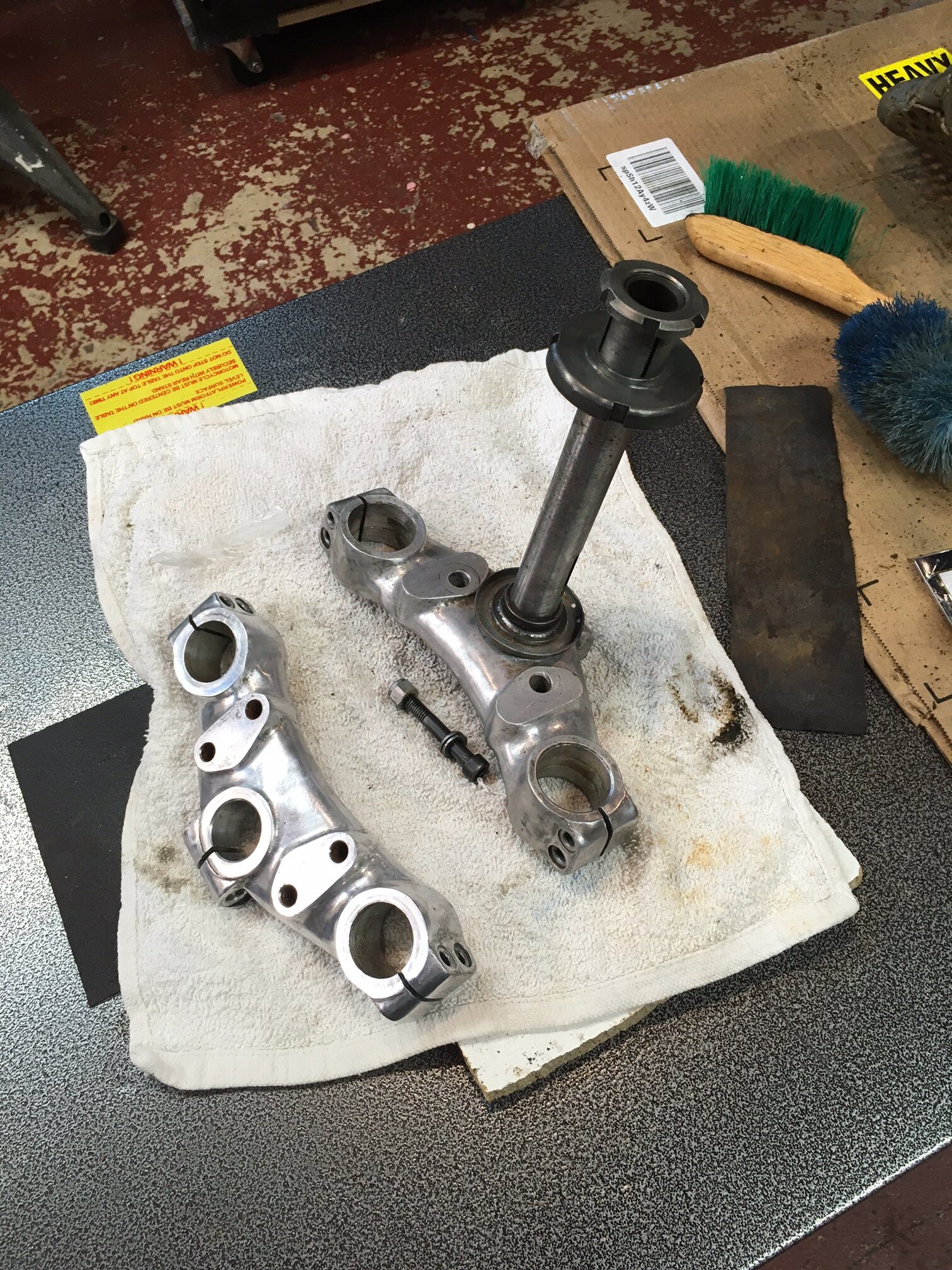

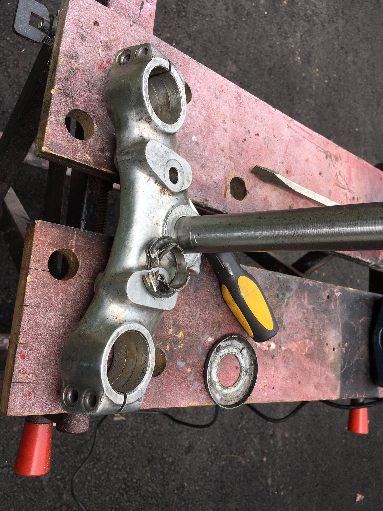

Divouneh Posted July 3, 2021 Author Report Share Posted July 3, 2021 Today: Cleaning from the frame with HP water. Removing the steering head bearings, I am looking for good quality Steering Bearings Tapered (not Chinese one). The originals were 45 years old, I need 45 more ☺️ Quote Link to comment Share on other sites More sharing options...
Divouneh Posted July 3, 2021 Author Report Share Posted July 3, 2021 Removing the steering head bearings: also the parts in the frame....😏 Quote Link to comment Share on other sites More sharing options...

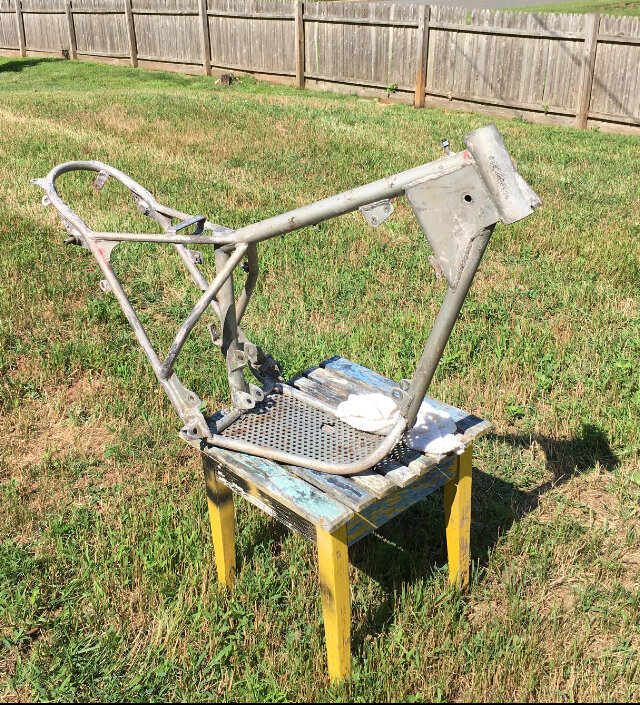

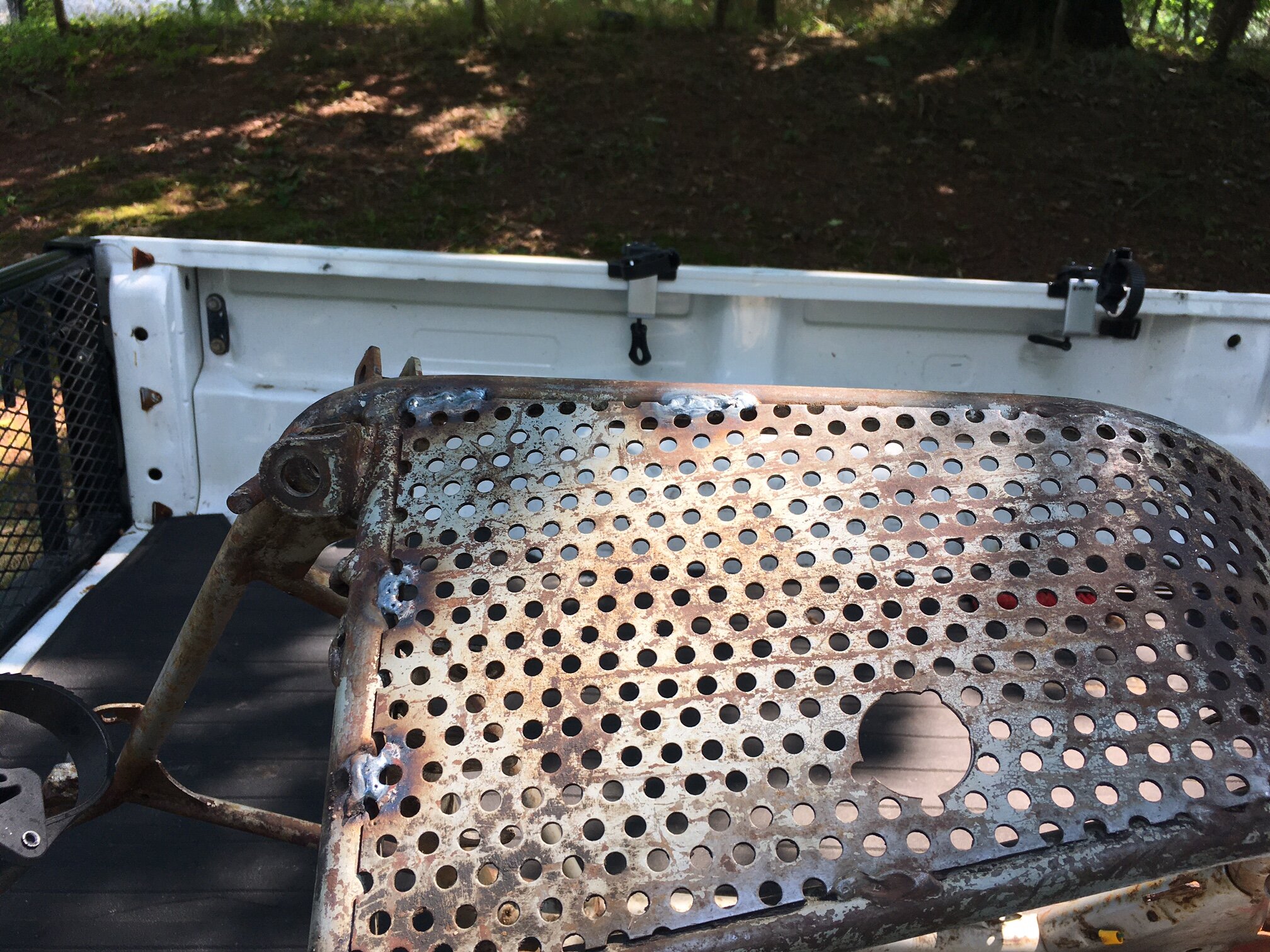

Divouneh Posted July 6, 2021 Author Report Share Posted July 6, 2021 Frame in workshop for some welding issues, will be done tomorrow... Swingarm is ready for the painting... I will finally paint the frame in black 😆 Quote Link to comment Share on other sites More sharing options...
Divouneh Posted July 6, 2021 Author Report Share Posted July 6, 2021 Frame is ready for painting...😀 Quote Link to comment Share on other sites More sharing options...
feetupfun Posted July 7, 2021 Report Share Posted July 7, 2021 You are very fortunate to only have those frame repairs required. The following model Alpina (137/138) was their first attempt at using a fancy alloy steel for the frame tubes and when I rebuilt my model 138, the frame was cracked in about 10 places, which I believe is a fairly common situation. It was worth rebuilding it though. The 138 is a fabulous bike to ride as I'm sure your 115 will be Quote Link to comment Share on other sites More sharing options...

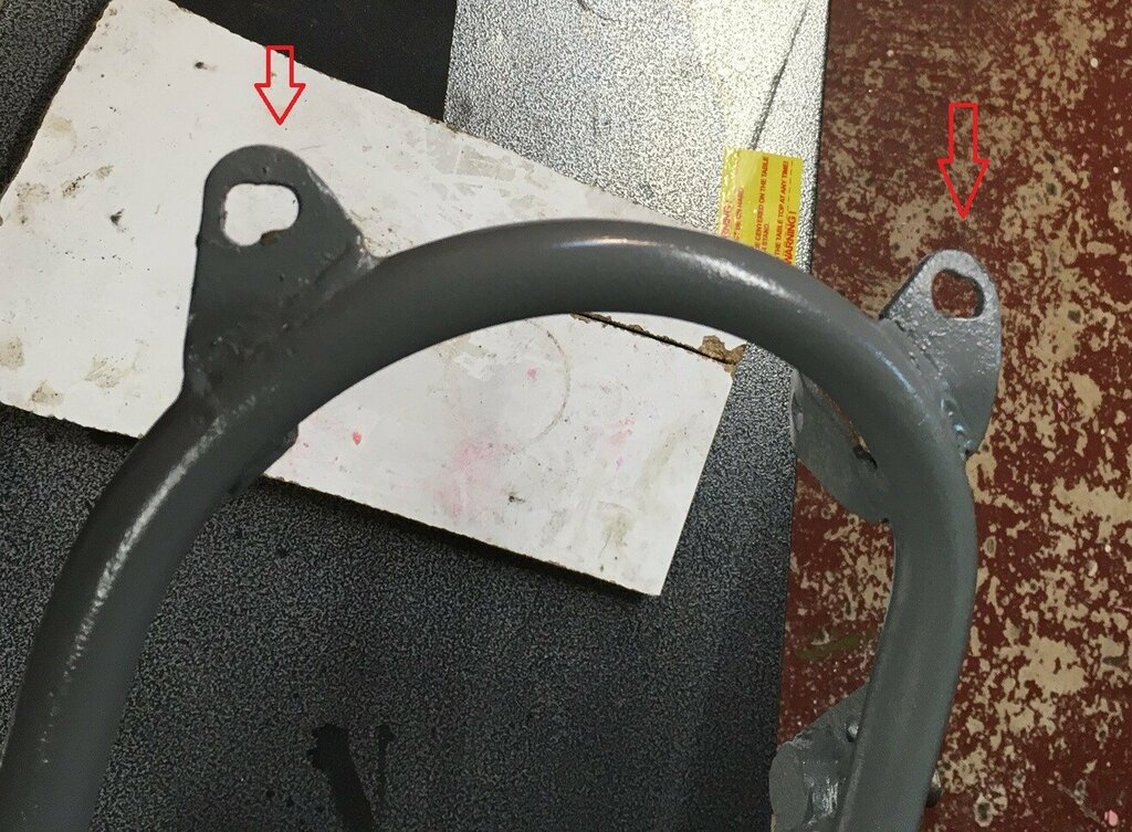

Divouneh Posted July 10, 2021 Author Report Share Posted July 10, 2021 Step by step; I said black but why not grey ☺️. I used a rust remover 🙄 1 Quote Link to comment Share on other sites More sharing options...

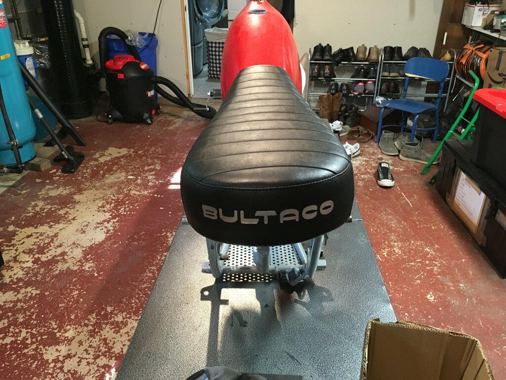

Divouneh Posted July 14, 2021 Author Report Share Posted July 14, 2021 New seat arrived today 😑. I will have to work in the alignement with the frame/ gas tank / seat.... 1 Quote Link to comment Share on other sites More sharing options...
Bloomfield Posted July 15, 2021 Report Share Posted July 15, 2021 Where did you end up getting the seat from? Also, would it be possible to post a couple close-up shots of the frame while it is still bare? Namely the area of the exhaust hanger on the right side seat stay (just down from the shock mount) and also the seat mounting bracket that runs horizontally between the tubes just to the rear of the main vertical tube? Mine has some weird things going on in those areas and I'd like to put it right. Thanks Quote Link to comment Share on other sites More sharing options...

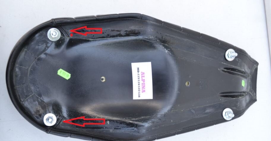

Divouneh Posted July 15, 2021 Author Report Share Posted July 15, 2021 I bought the seat : https://www.inmotiontrials.com/product-category/parts/twinshock/bultaco/seats-bultaco/ I will had some pictures soon, I need to understand why the seat is not on line with the frame and the gas tank: Frame or position from the screws under the seat ? Gas tank and seat must be in one piece before lying in the frame... Quote Link to comment Share on other sites More sharing options...
Divouneh Posted July 15, 2021 Author Report Share Posted July 15, 2021 Any misalignment holes/screws will induce a seat not in line with the frame... Someone had this "trouble" in the past ? Quote Link to comment Share on other sites More sharing options...
