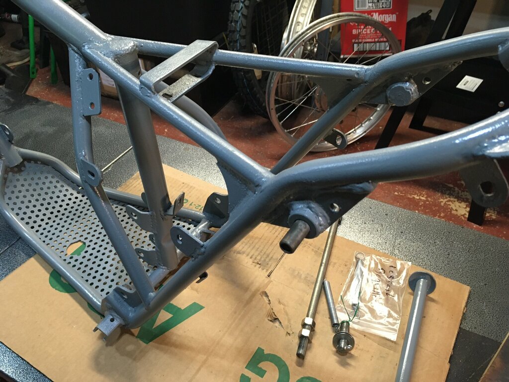

Divouneh Posted July 18, 2021 Author Report Share Posted July 18, 2021 Sunday job 😃... I have a small issue with the kickstand bought on Ebay, I will have to cut the base and weld it properly... Next job: fork seals 😬... Quote Link to comment Share on other sites More sharing options...

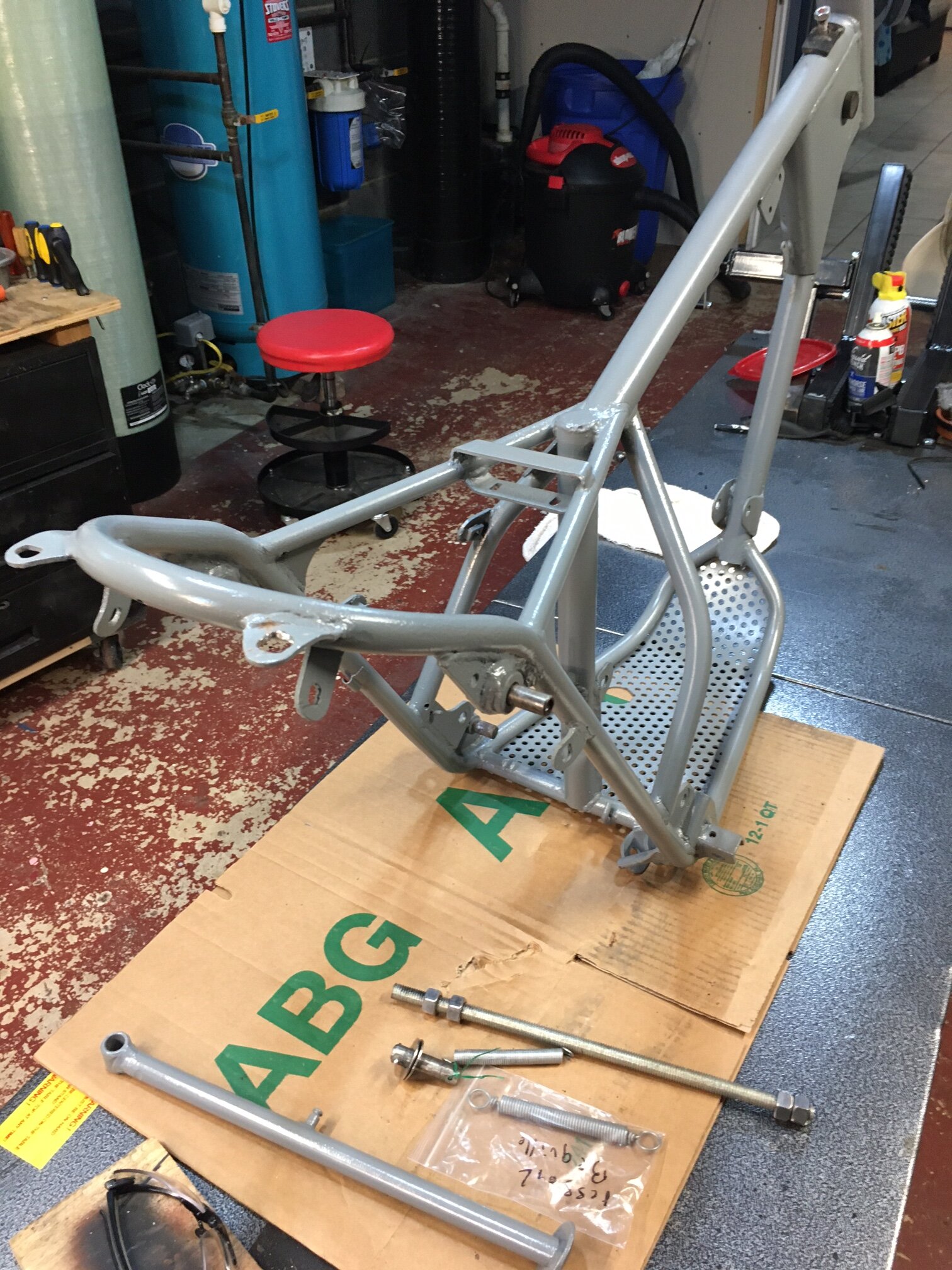

Divouneh Posted July 18, 2021 Author Report Share Posted July 18, 2021 Frame pictures for Bloomfield 😉 1 Quote Link to comment Share on other sites More sharing options...

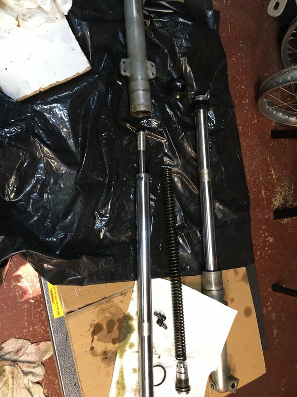

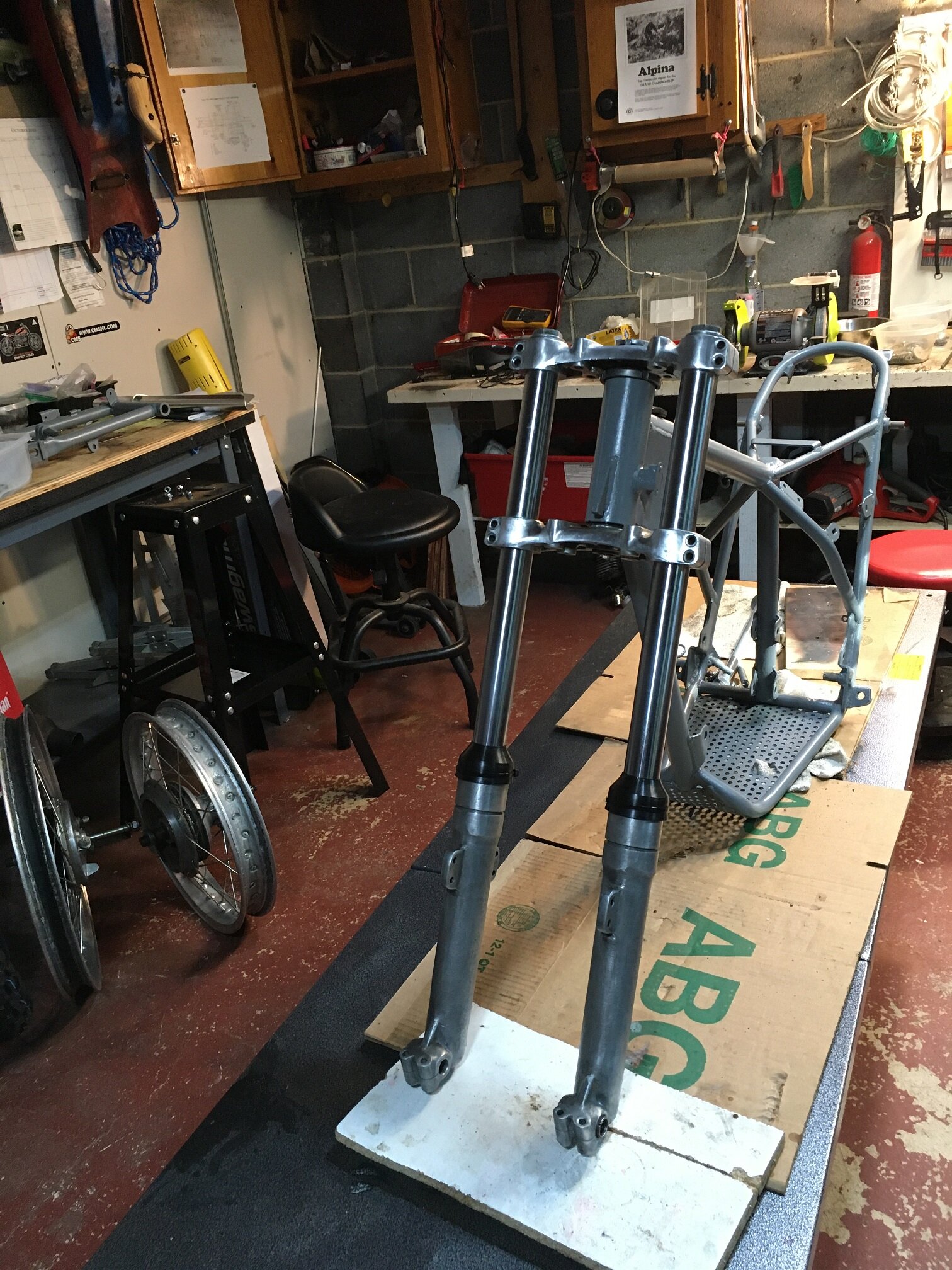

Divouneh Posted July 23, 2021 Author Report Share Posted July 23, 2021 last news: The broken spokes in the rear wheel were replaced by my local mechanic ... The fork is on way to be rebuilt, I am fighting with the old seals 😒. Good news: I found oil in the tubes, without water. I succeed to remove the retaining screws from the bottom of each tube. 🤪. The circlips to keep the seals in place are out of order 😌. Quote Link to comment Share on other sites More sharing options...

Divouneh Posted July 24, 2021 Author Report Share Posted July 24, 2021 Damned; Each fork leg has two seals; I need to order another set 😔. The main job is to disassemble and clean, small delay... Quote Link to comment Share on other sites More sharing options...
carl ekblom Posted July 24, 2021 Report Share Posted July 24, 2021 (edited) You really don´t need two seals/leg. One quality seal (like skf or similar) is adequate, but you may have to manufacture a spacer for the missing seal. I have found "all balls 35mm fork seals" to be not good at all. Life is OK but the friction.........🙄 Benefit is lower friction (not all balls), which is needed on these old forks As far as I can remember the seals are 35x47x10. They don´t need to be 10 but a spacer might be needed. A spacer can med machined from an oil resistant plastic. Make sure you don´t damge the seal when assembling. That is very easy to do (yes I know😢). The stanchions should be in good condition otherwise they may leak. Leaking seals can be cleaned between the seal and stainchion by inserting a deburred feeler gauge. Some x-tra life can be gained, but only if the stainchion is in good condition Edited July 24, 2021 by carl ekblom 1 Quote Link to comment Share on other sites More sharing options...
Divouneh Posted July 25, 2021 Author Report Share Posted July 25, 2021 "Benefit is lower friction (not all balls), which is needed on these old forks" good remark. I bought double-lip seals, machining the spacers will cost me more than a new set of single-lip... Thanks again for the support 🙂 Quote Link to comment Share on other sites More sharing options...

Divouneh Posted July 31, 2021 Author Report Share Posted July 31, 2021 Fork is 90% ready ... 1 Quote Link to comment Share on other sites More sharing options...
carl ekblom Posted July 31, 2021 Report Share Posted July 31, 2021 I have replaced the bloody "All Balls" seal today with "Ariete 012" which I hope will have lower friction. The All Balls dust scraper remains. Original are 2 fork seals and one external dust cover but no locking ring. For me, one fork seal, spacer and one dust scraper and still no locking ring. It has worked for me before. Perhaps the locking ring isn´t needed but I would like to see one above the fork seal for safety´s sake. I have several SKF scraper rings but they are 47.8mm and some turning is needed to make them fit properly. The fork seal from "SKF Kit 35M" would fit but they are expensive. Hoping the Ariete fork seal is a cheaper alternative. Unfortunalely I have no SKF fork seals lying around today but will be interesting to find out about the cheaper Ariete option. Perhaps the original two fork seals are because of the not very effective external dust cover🤔 If I had the dust cover instead of a the more modern dust scraper ring i think it would be good practice to clean under the dust cover after a some hours of running. 1 Quote Link to comment Share on other sites More sharing options...
feetupfun Posted July 31, 2021 Report Share Posted July 31, 2021 The most recent fork work I did on a Bultaco included green SKF seals with spacer rings I made from PVC electrical conduit (in a model 49 Bultaco). I wouldn't normally bother with fork seal spacer rings but the seal seller told me that the SKF fork seals are more prone to moving within the slider than other brand seals. I found the SKF seals do function exceptionally well. Quote Link to comment Share on other sites More sharing options...
Divouneh Posted July 31, 2021 Author Report Share Posted July 31, 2021 I used: https://www.ebay.com/itm/303132310214 https://www.ebay.com/itm/281880258398 I ordered today dust covers (the one installed were too short).... 1 Quote Link to comment Share on other sites More sharing options...
