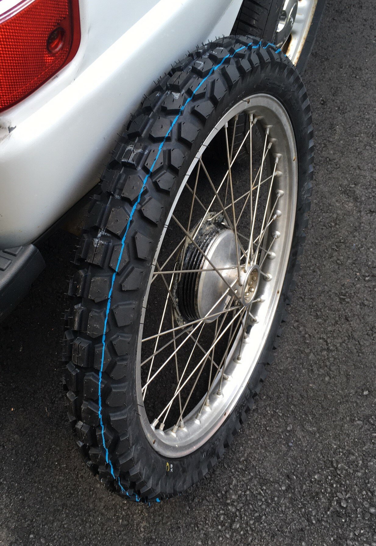

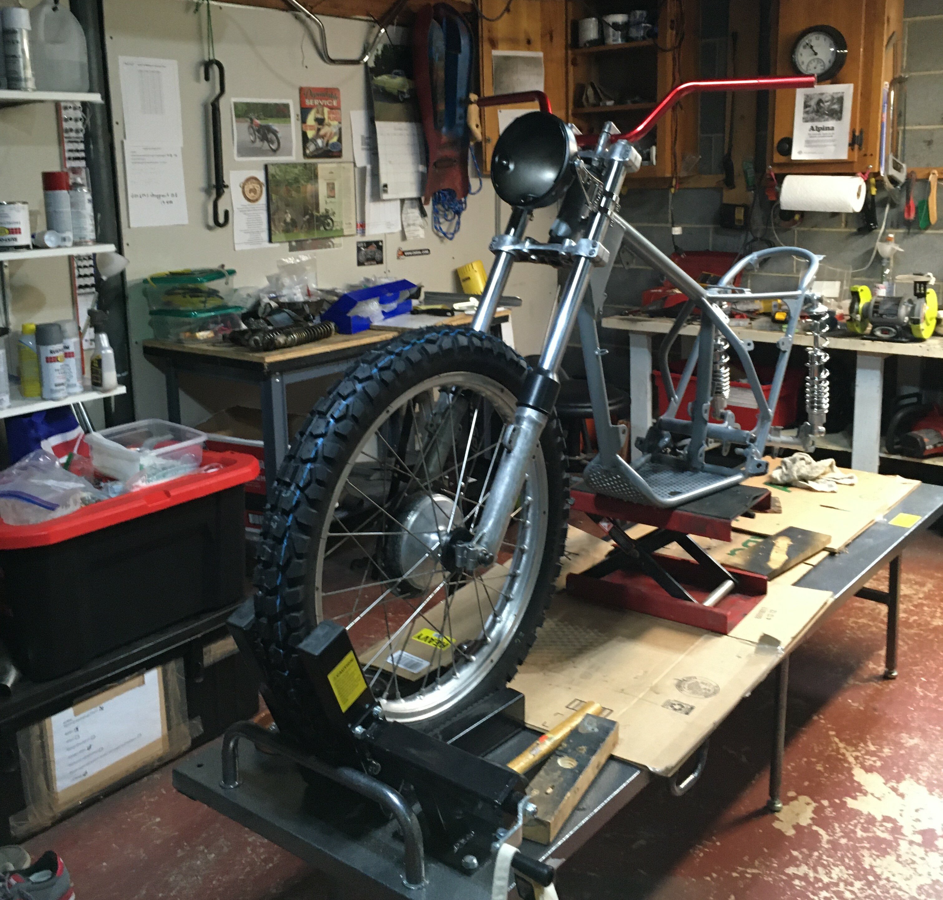

Divouneh Posted August 10, 2021 Author Report Share Posted August 10, 2021 Yes it's going slowly: I am waiting the SKF ball bearings for the wheels and the tools to remove the old one properly. One from the front wheel is out of order, and without seals ? The front tire is in place, the target is to have both wheels in place by end of the week. 1 Quote Link to comment Share on other sites More sharing options...

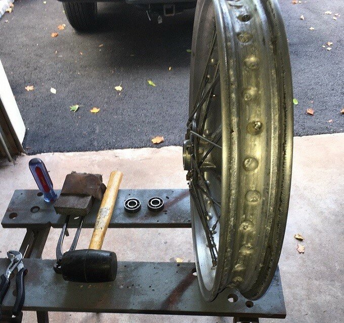

Divouneh Posted August 11, 2021 Author Report Share Posted August 11, 2021 Rear wheel, seals and bearings are out ... Quote Link to comment Share on other sites More sharing options...
Divouneh Posted August 11, 2021 Author Report Share Posted August 11, 2021 The good news is the grease was fresh, bearing was easy to remove 🤨... They need to be tight in the wheel and "loose" in the shaft, I will see with the new one expected for this week-end. Just remember how old is the bike 😬. One needs to be replaced the other one seems ok but will be replaced too. 1 Quote Link to comment Share on other sites More sharing options...

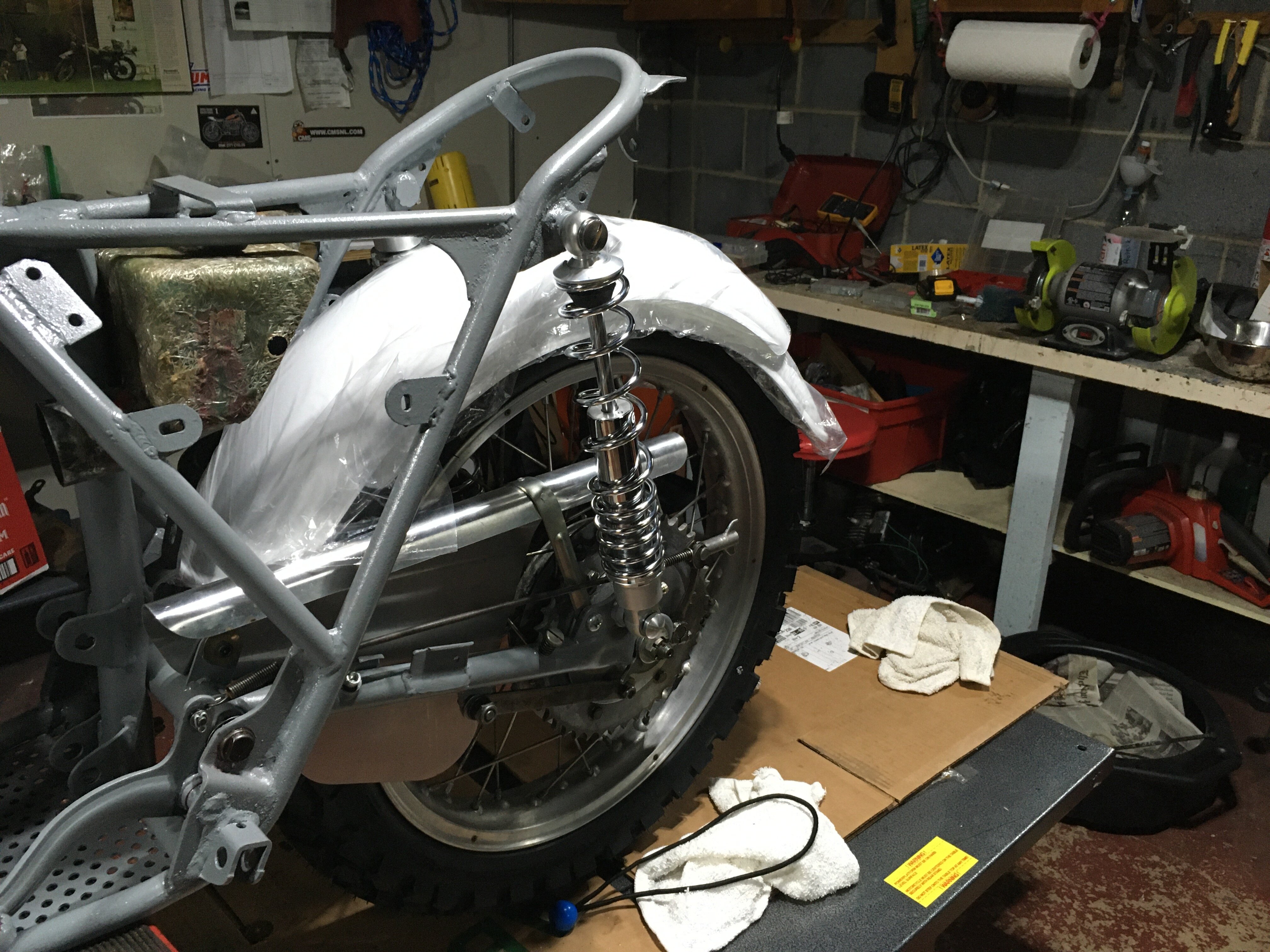

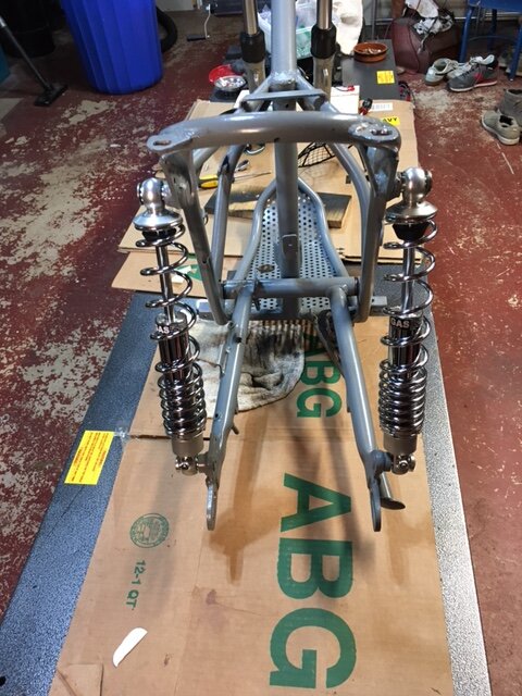

Divouneh Posted August 15, 2021 Author Report Share Posted August 15, 2021 Today, swingarm and rear shocks...😆 I will probably start a new post, I can't load any more pictures 🥵.. Quote Link to comment Share on other sites More sharing options...

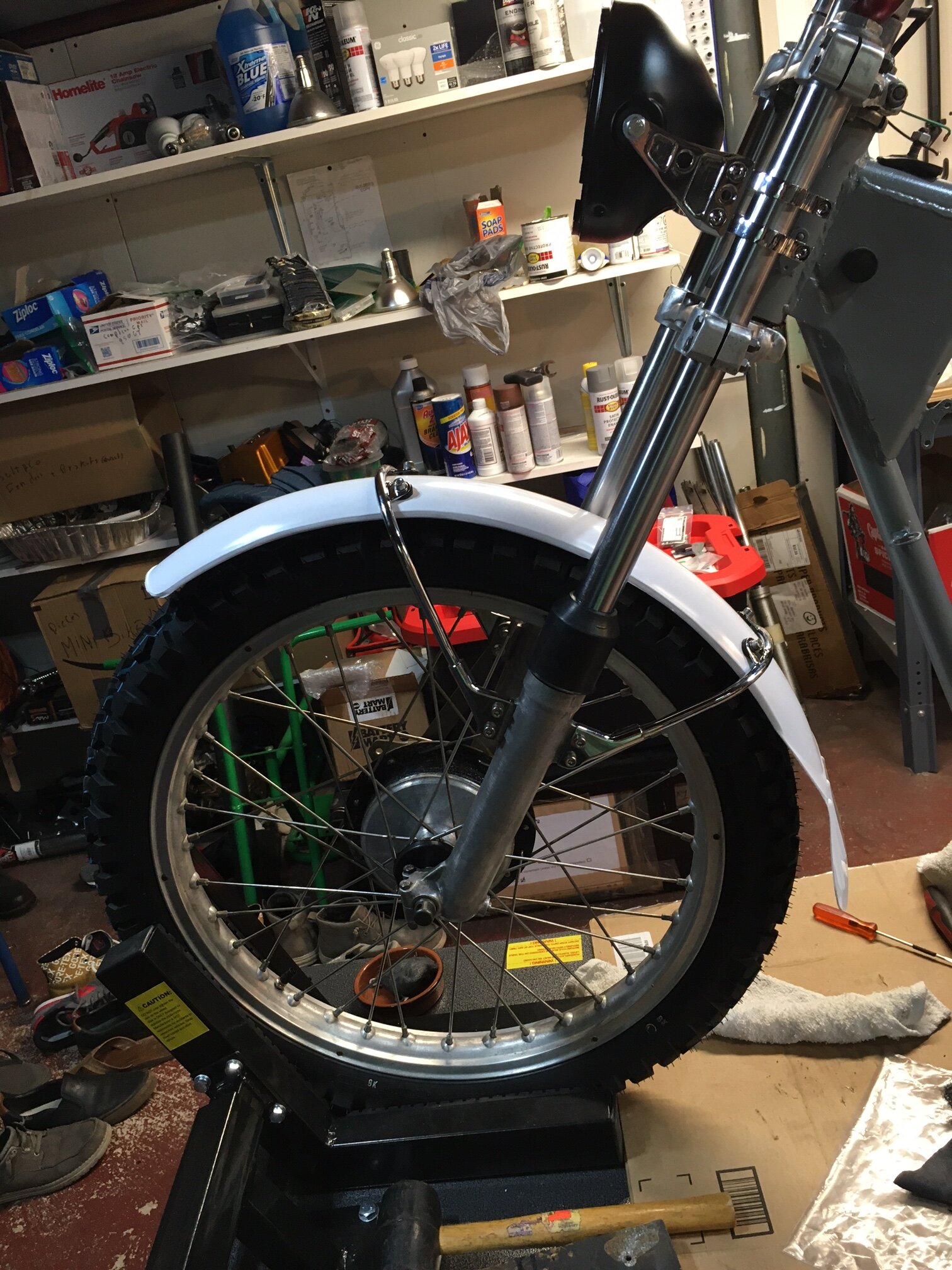

Divouneh Posted August 21, 2021 Author Report Share Posted August 21, 2021 Front wheel is done 🧐... I could start to install the front fender, speedo and brake hardware 🤨. I have in my shelves an old speedo bought for a previous project but never used: I will use it ☺️. https://dcmotive.com/products/dcm-gps-speedometer I am still waiting the compound for the rear wheel bearings 😔 Quote Link to comment Share on other sites More sharing options...
Divouneh Posted August 21, 2021 Author Report Share Posted August 21, 2021 In practice much better what you can see in the picture 😒.... Quote Link to comment Share on other sites More sharing options...

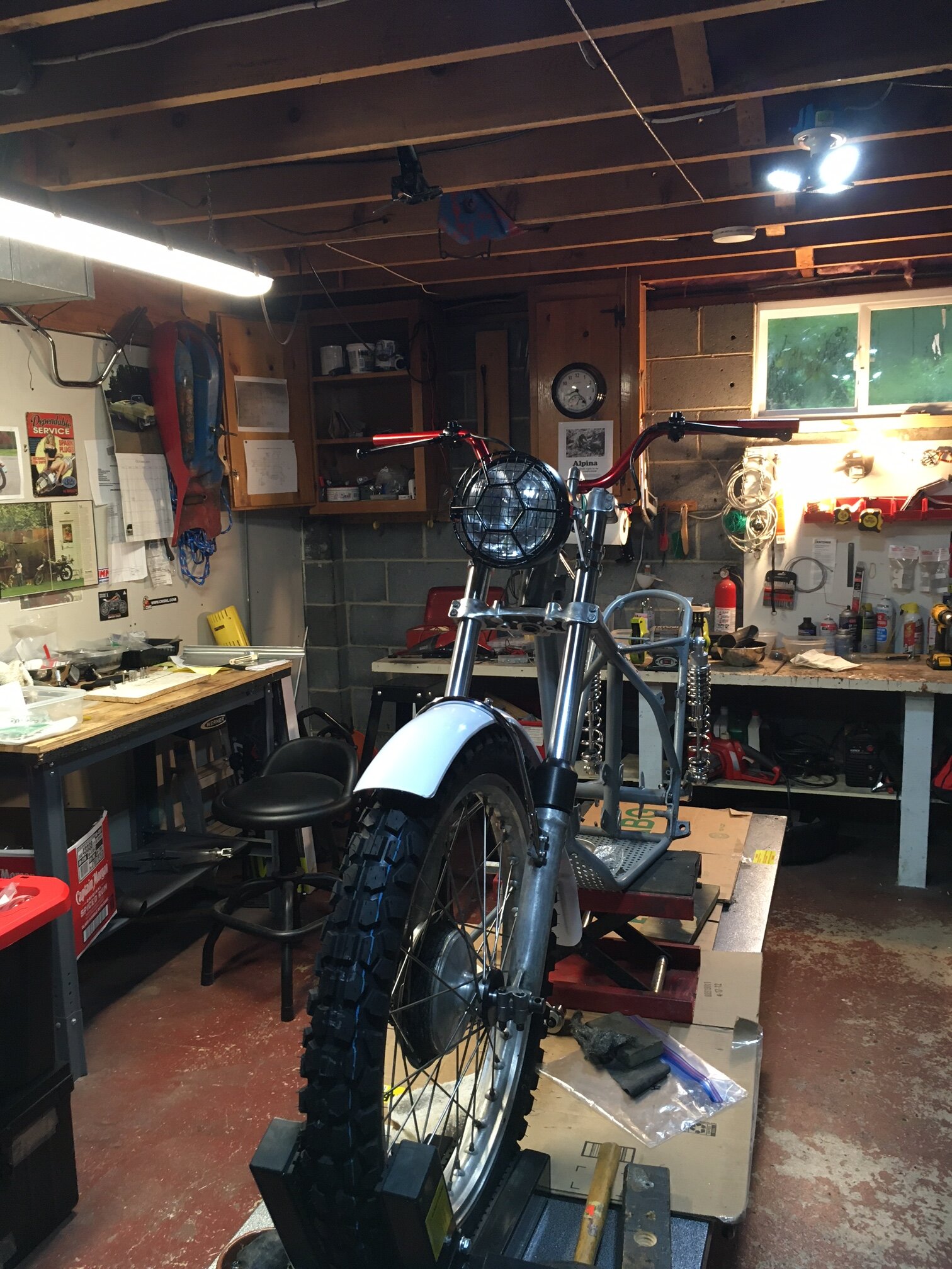

Divouneh Posted August 22, 2021 Author Report Share Posted August 22, 2021 Just the front light , the complete electrical circuit to be done in 12 volts.... Quote Link to comment Share on other sites More sharing options...

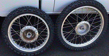

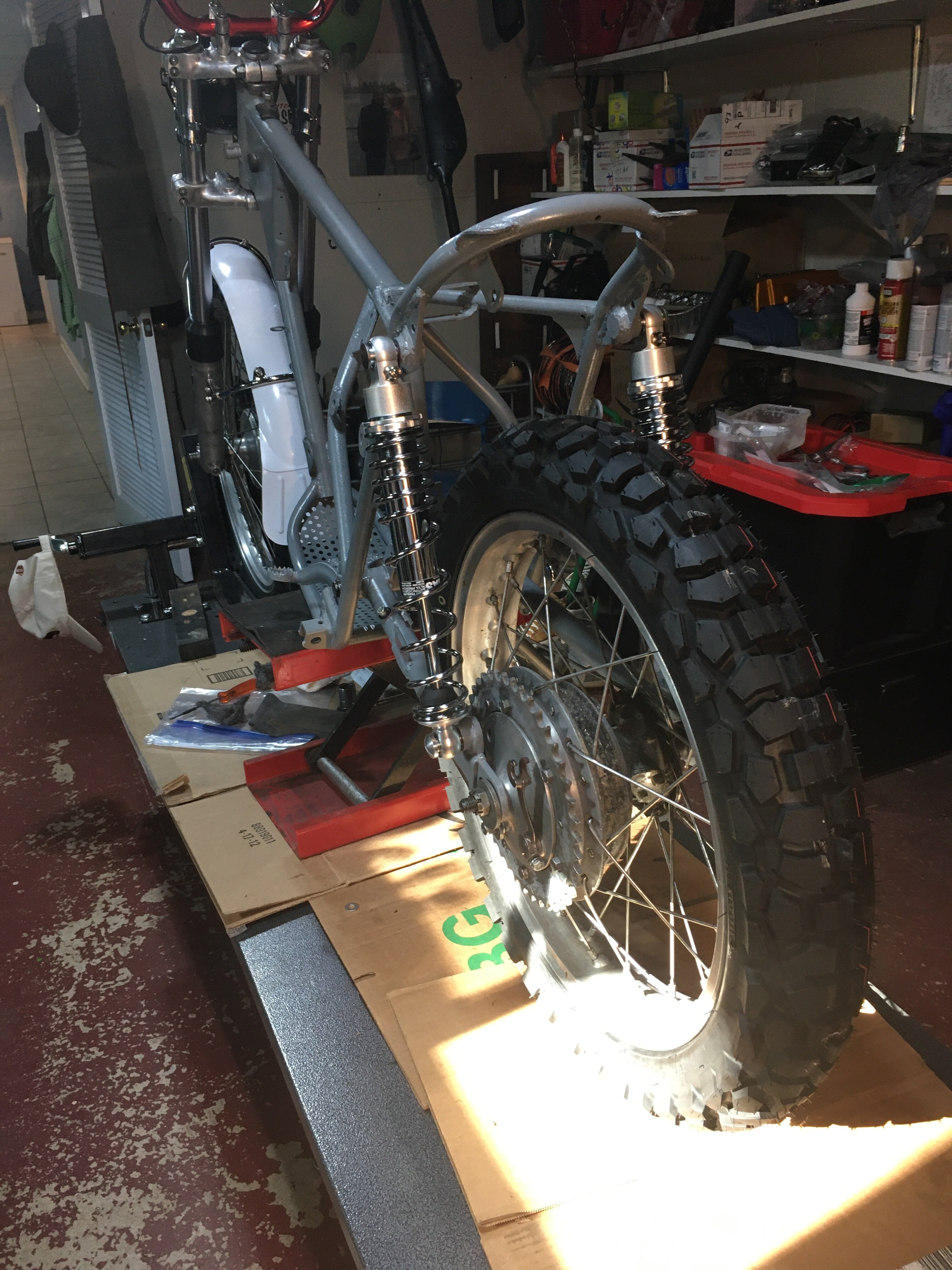

Divouneh Posted August 26, 2021 Author Report Share Posted August 26, 2021 Rear wheel is done 😅, we will see if the bearing repair is working when running. I made some adjustments (grinding) to remove swingarm play 😏, you could see that you have a dirt bike not a race bike 🤫. Next step: back fender and rear tail light... 1 Quote Link to comment Share on other sites More sharing options...
