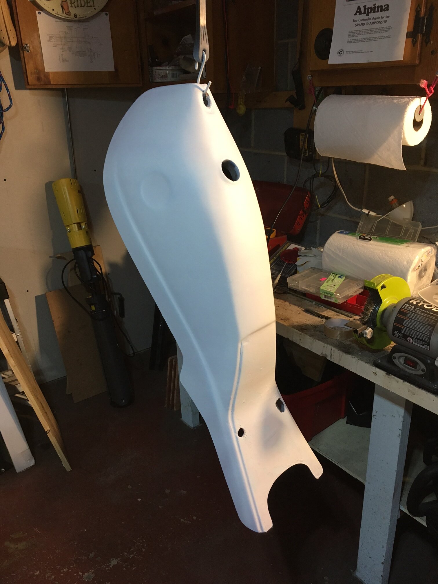

Divouneh Posted November 19, 2021 Author Report Share Posted November 19, 2021 Primer is done, I have seen some impacts to be done before the final color 😁... 1 Quote Link to comment Share on other sites More sharing options...

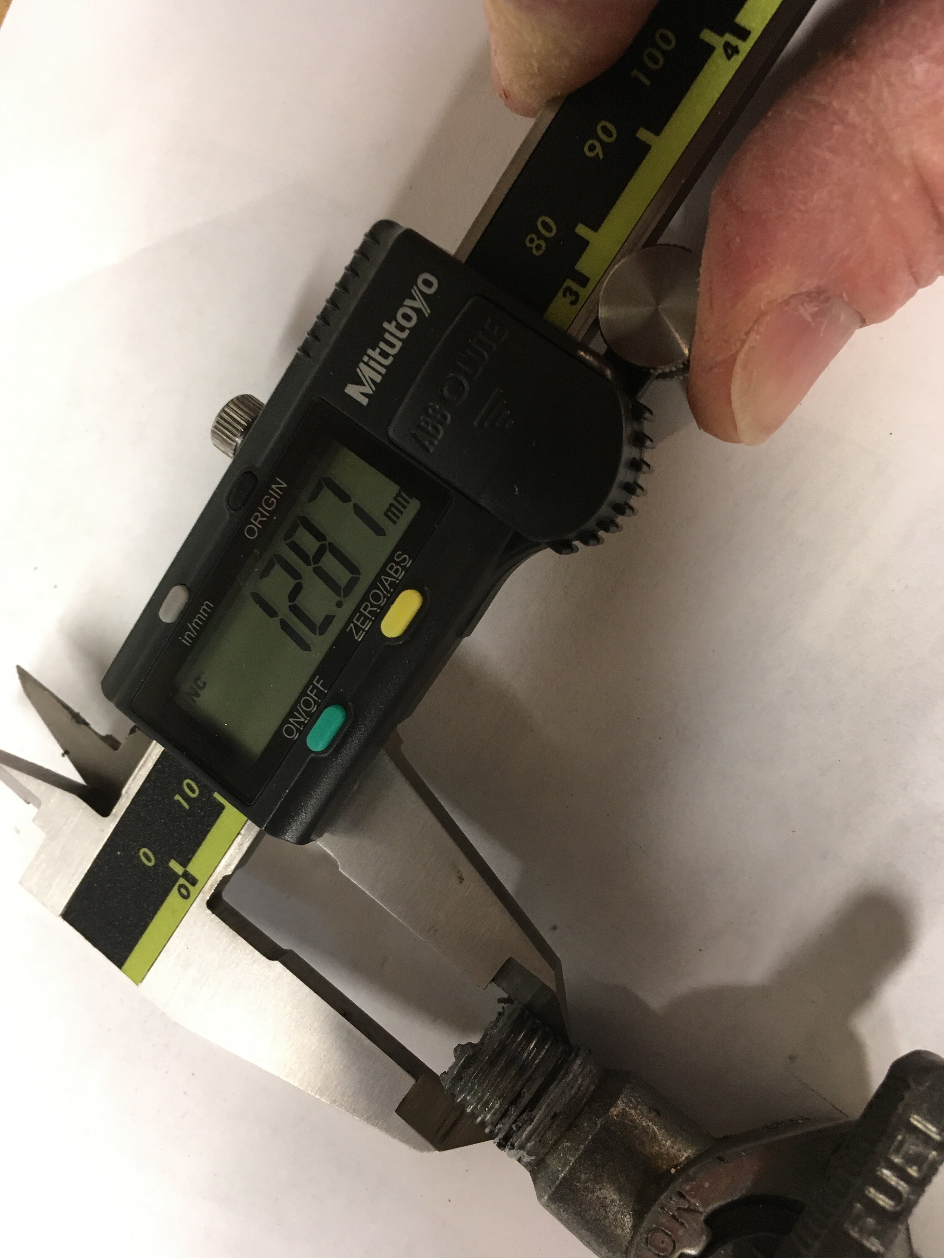

Divouneh Posted November 23, 2021 Author Report Share Posted November 23, 2021 Petcock issue: I discovered i have an English Petcock , I found the same in EBAY: https://www.ebay.com/itm/390669025482 Someone had such experiences ? Quote Link to comment Share on other sites More sharing options...

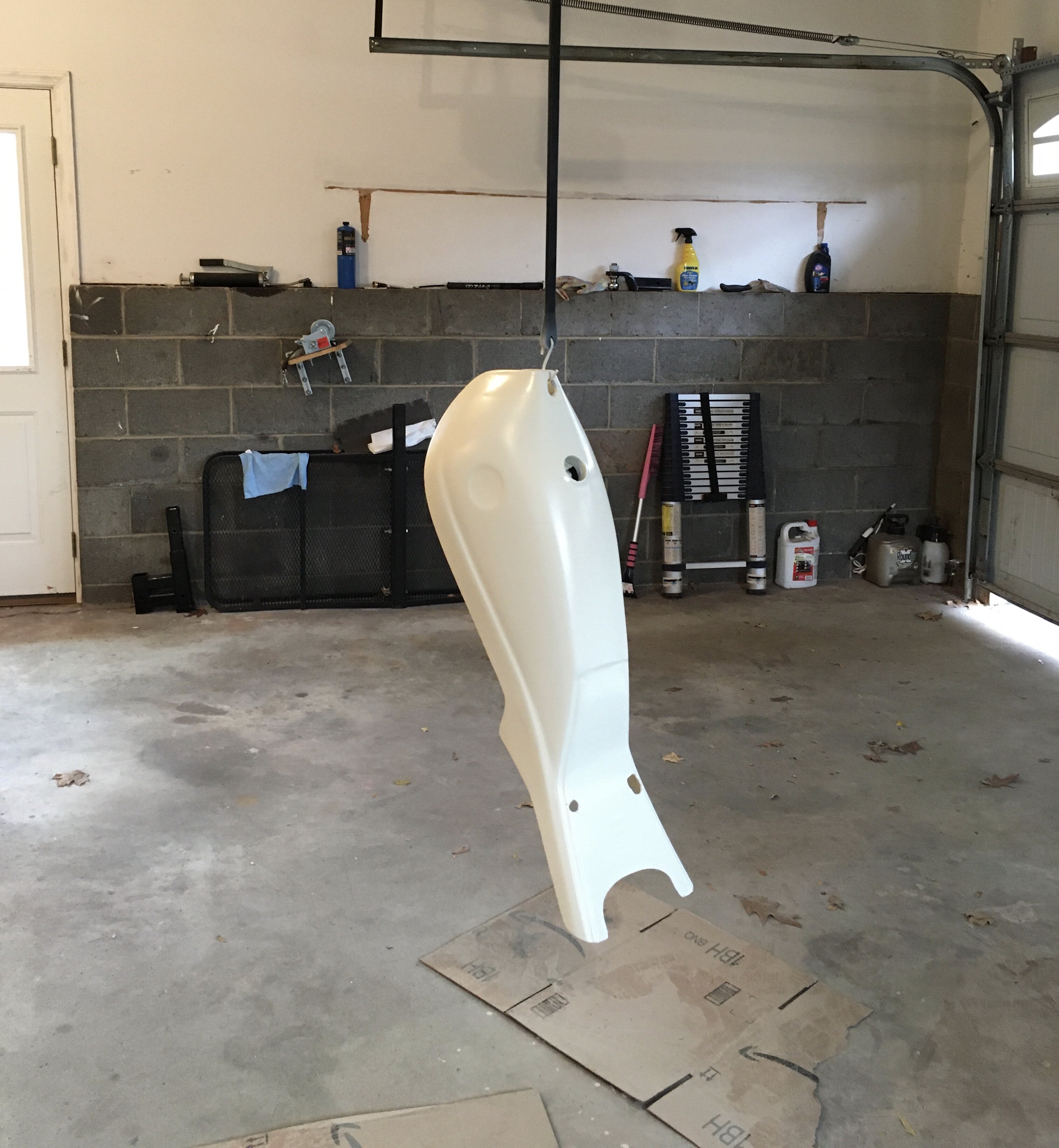

Divouneh Posted November 24, 2021 Author Report Share Posted November 24, 2021 New ignition arrived today 😃... Next will be the piston, if needed 😆. Then I will have all to renew my engine: ball bearings, seals, new connecting rod (by experience, I always change bearings for old bike to prevent a reopening ). I never keep engine open, you never know what could happen (loose elements, corrosion)... At first to finish my gas tank, but the temperature drops to winter season 🤥: difficult to paint in such condition. Quote Link to comment Share on other sites More sharing options...
feetupfun Posted November 24, 2021 Report Share Posted November 24, 2021 On 11/23/2021 at 10:13 PM, Divouneh said: Petcock issue: I discovered i have an English Petcock , I found the same in EBAY: https://www.ebay.com/itm/390669025482 Someone had such experiences ? Expand The standard fuel tap thread in an Alpina tank is a metric thread M12 x 1.5 1 Quote Link to comment Share on other sites More sharing options...
Divouneh Posted November 26, 2021 Author Report Share Posted November 26, 2021 Thank you, the fuel tap was probably out of service and repair with US thread... I already ordered the one from Ebay. Painting is on way, stickers and clear coating to come .. Quote Link to comment Share on other sites More sharing options...

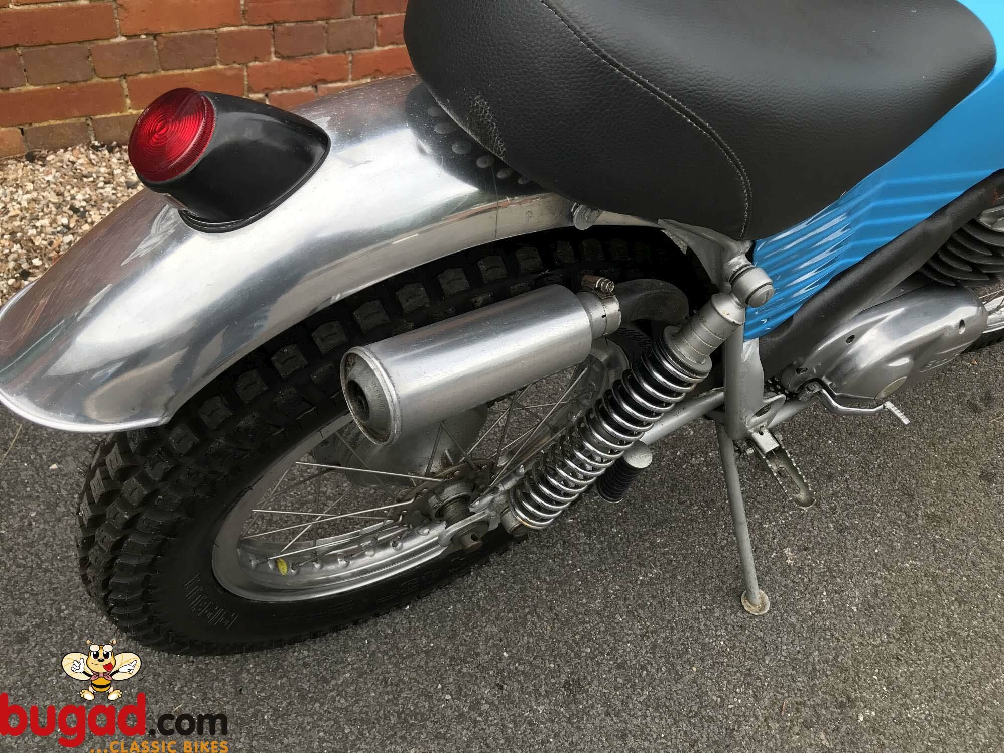

Divouneh Posted November 28, 2021 Author Report Share Posted November 28, 2021 Exhaust / muffler: not the central part. This bike seems to be done with a "standard" from the web. I don't want to put 250USD for this silencer I love this example, any idea ...🤨 Quote Link to comment Share on other sites More sharing options...

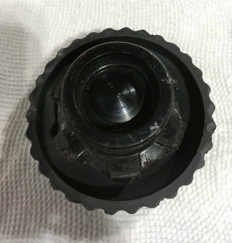

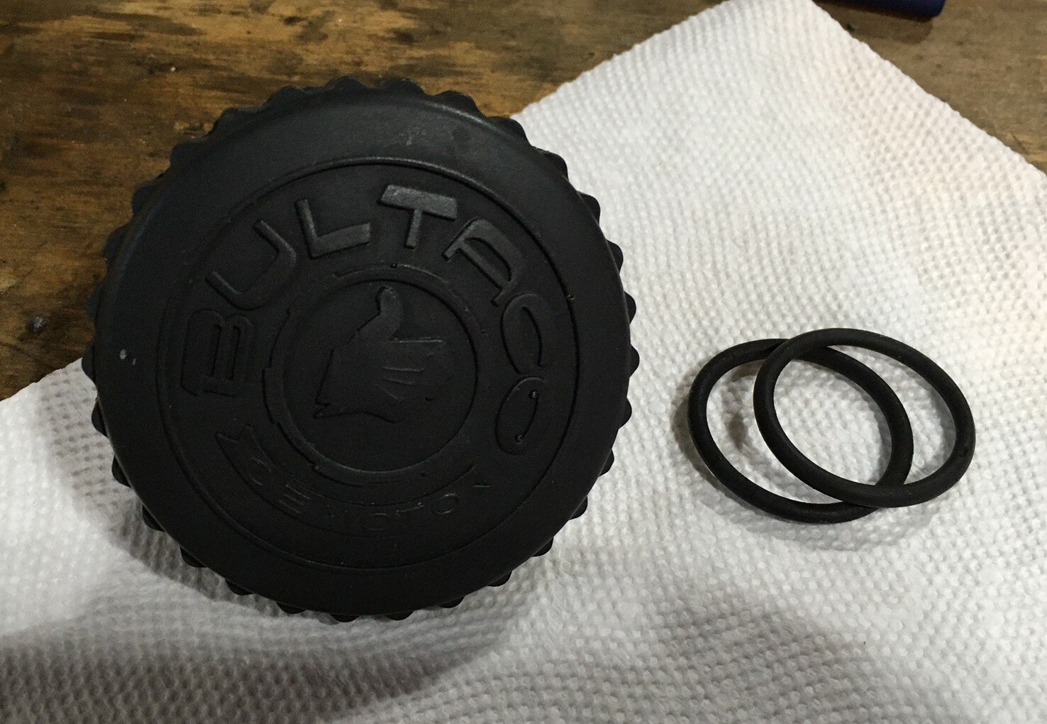

Divouneh Posted December 5, 2021 Author Report Share Posted December 5, 2021 I received the petcock, the gas cap is redone (waiting the new "O" rings)... Quote Link to comment Share on other sites More sharing options...

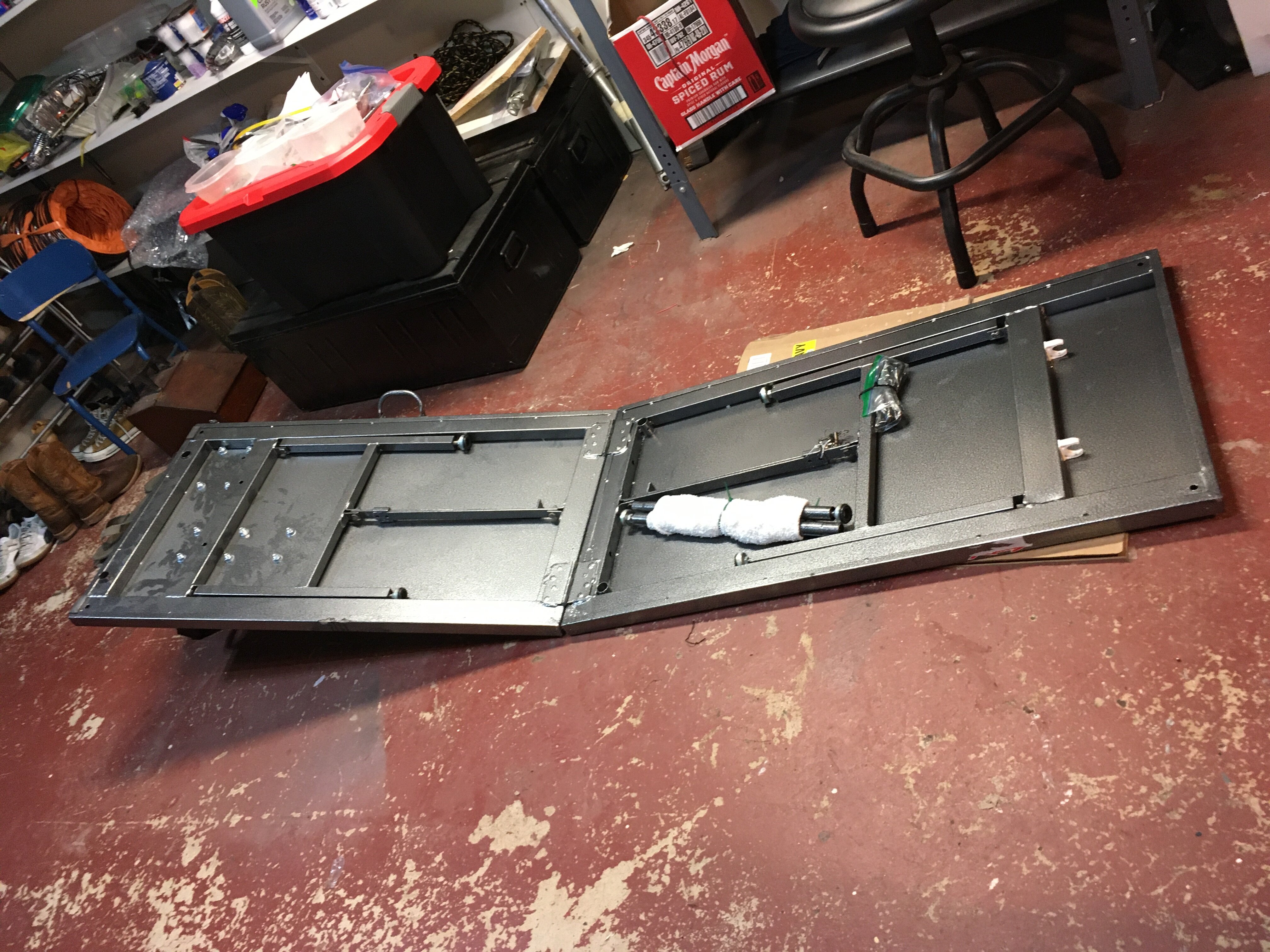

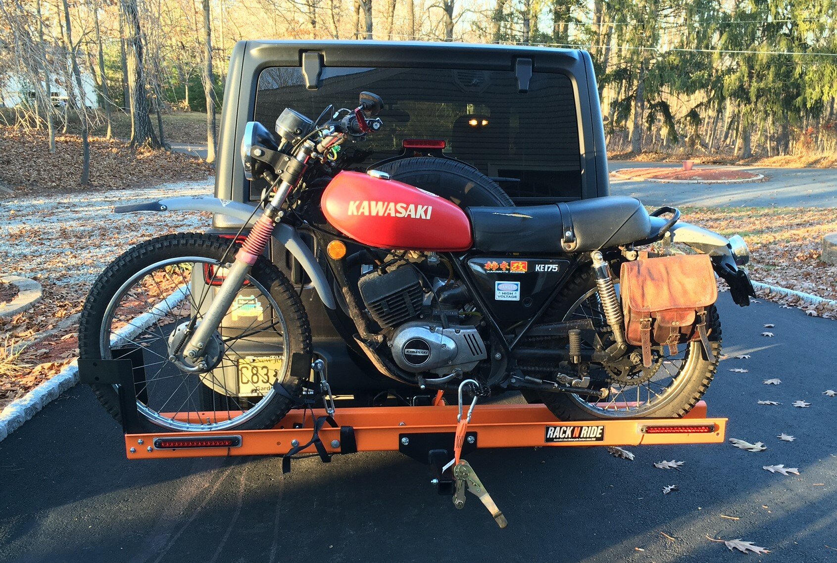

Divouneh Posted December 5, 2021 Author Report Share Posted December 5, 2021 Otherwise I got my new carrier, I did some improvements (lights / Turnbuckles replaced by 2" straps). It's a very good solid product , but expensive 😒 Quote Link to comment Share on other sites More sharing options...

model80 Posted December 5, 2021 Report Share Posted December 5, 2021 On 12/5/2021 at 3:26 PM, Divouneh said: To come back to previous question, this seems to be the original design: Expand Original Exhaust for the US. Quote Link to comment Share on other sites More sharing options...

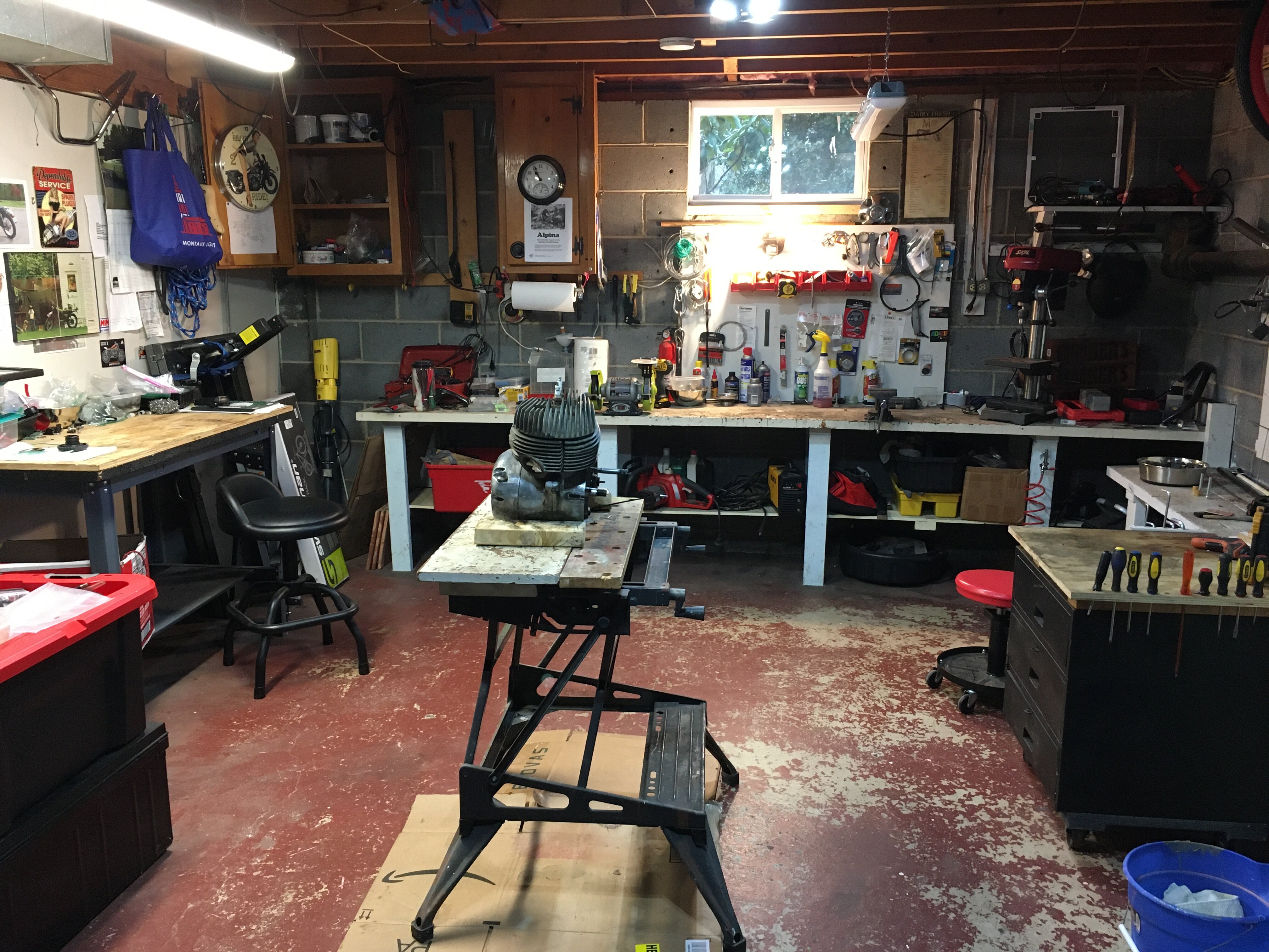

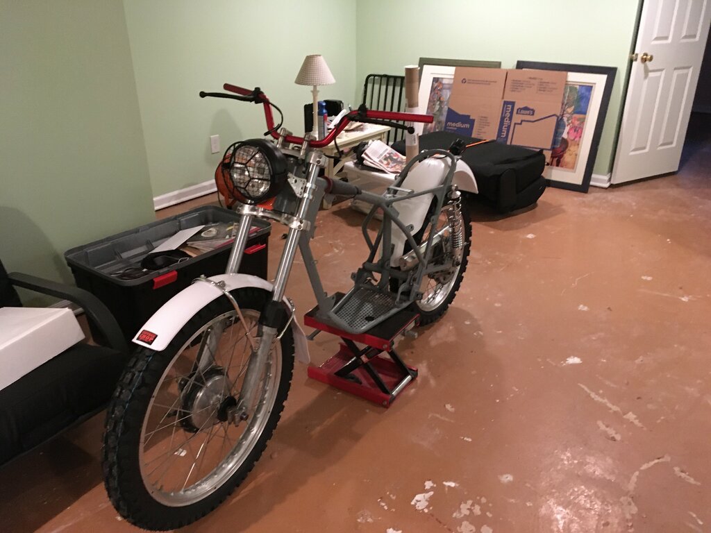

Divouneh Posted December 11, 2021 Author Report Share Posted December 11, 2021 Cleaning from my workshop for the next phase 😗... Quote Link to comment Share on other sites More sharing options...
Divouneh Posted December 11, 2021 Author Report Share Posted December 11, 2021 We are ready for the engine inspection: Quote Link to comment Share on other sites More sharing options...

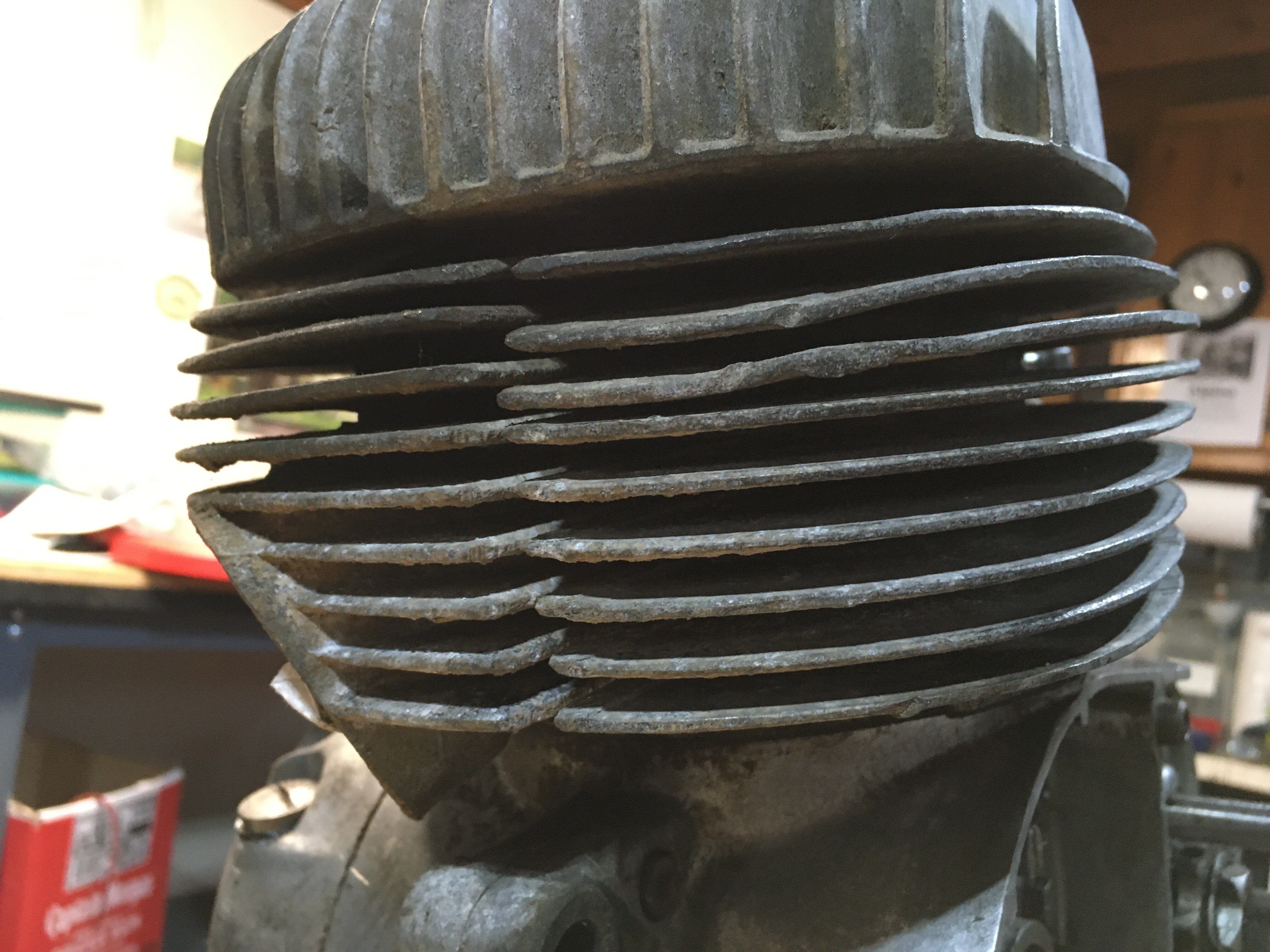

Divouneh Posted December 11, 2021 Author Report Share Posted December 11, 2021 Cooling blade: I will keep as it is (any advices ?).🙂 Quote Link to comment Share on other sites More sharing options...
