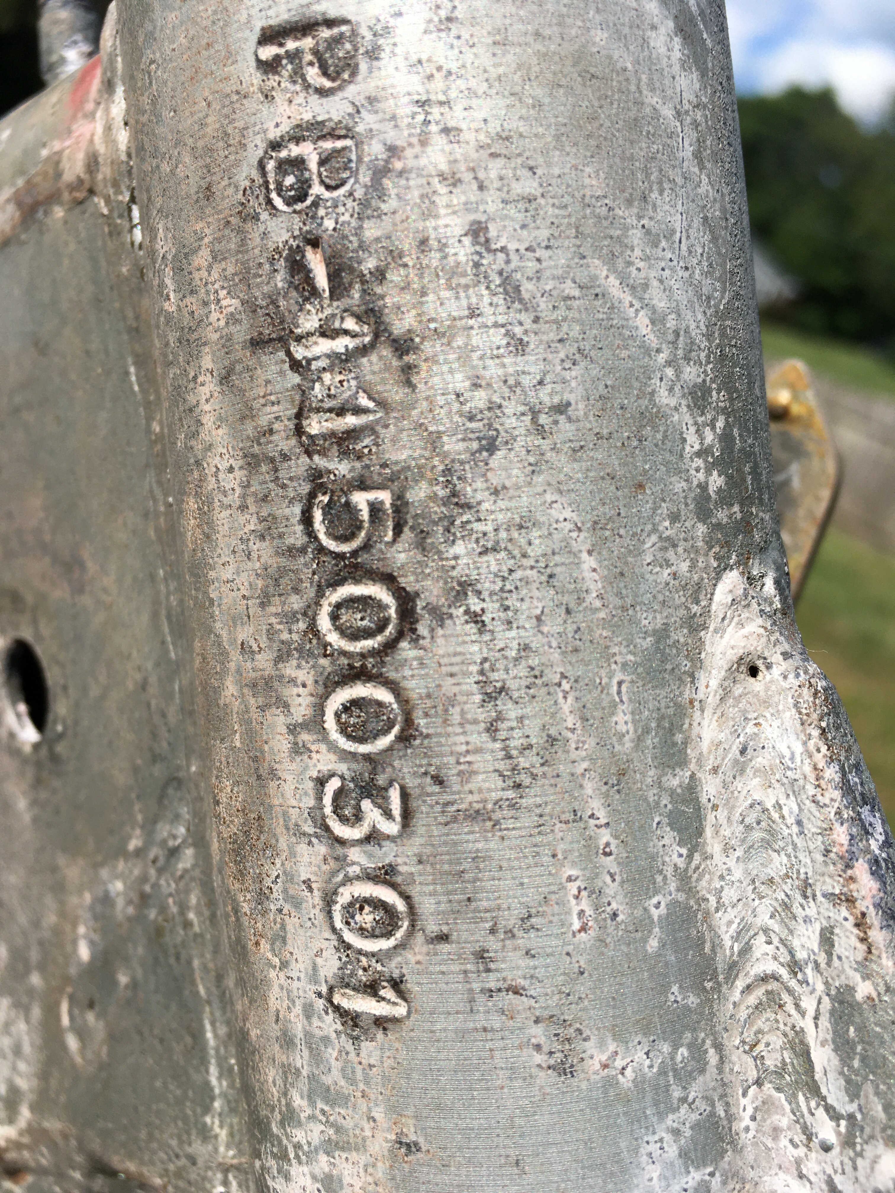

Divouneh Posted December 13, 2021 Author Report Share Posted December 13, 2021 My serial number: interesting remark Quote Link to comment Share on other sites More sharing options...

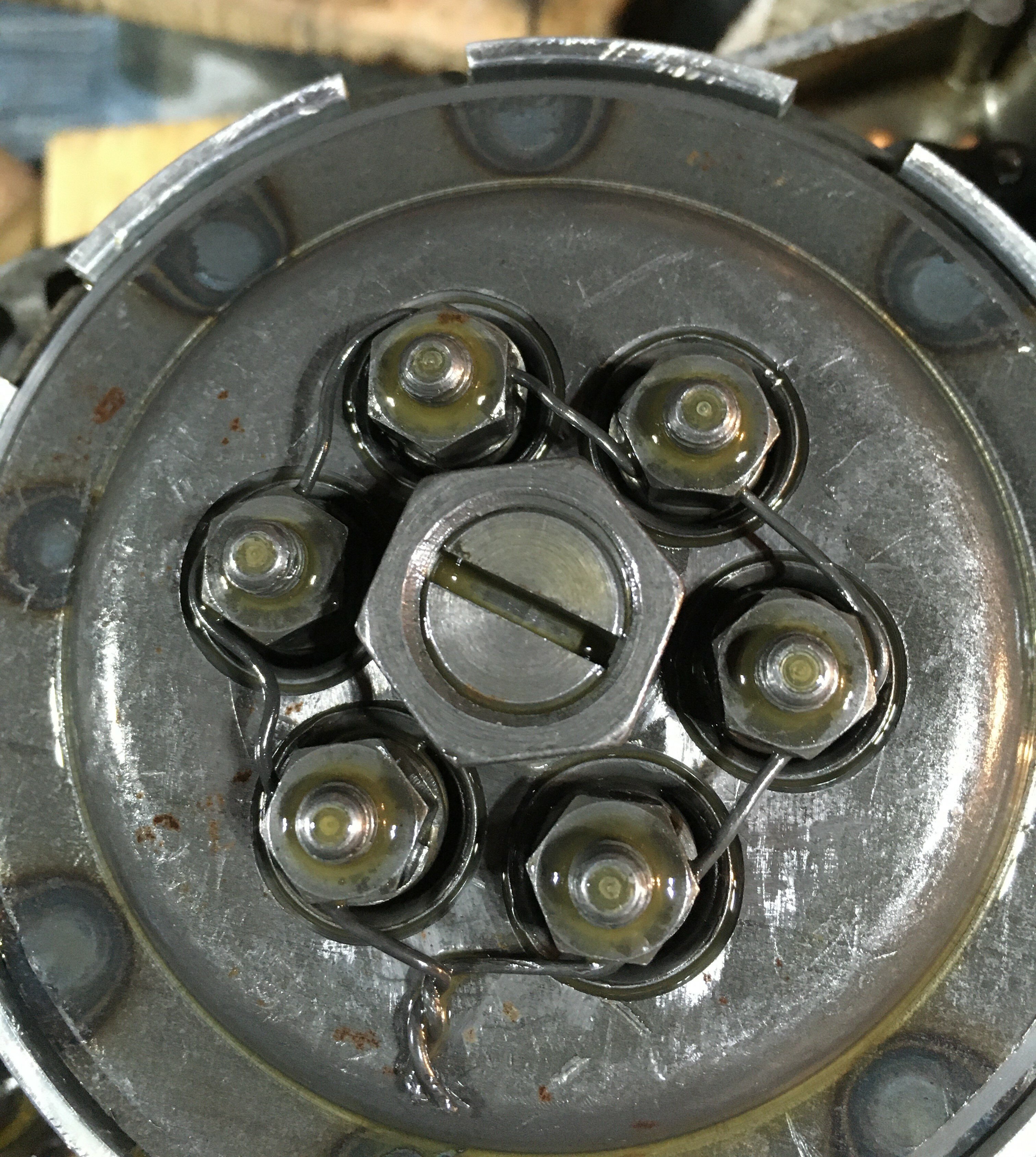

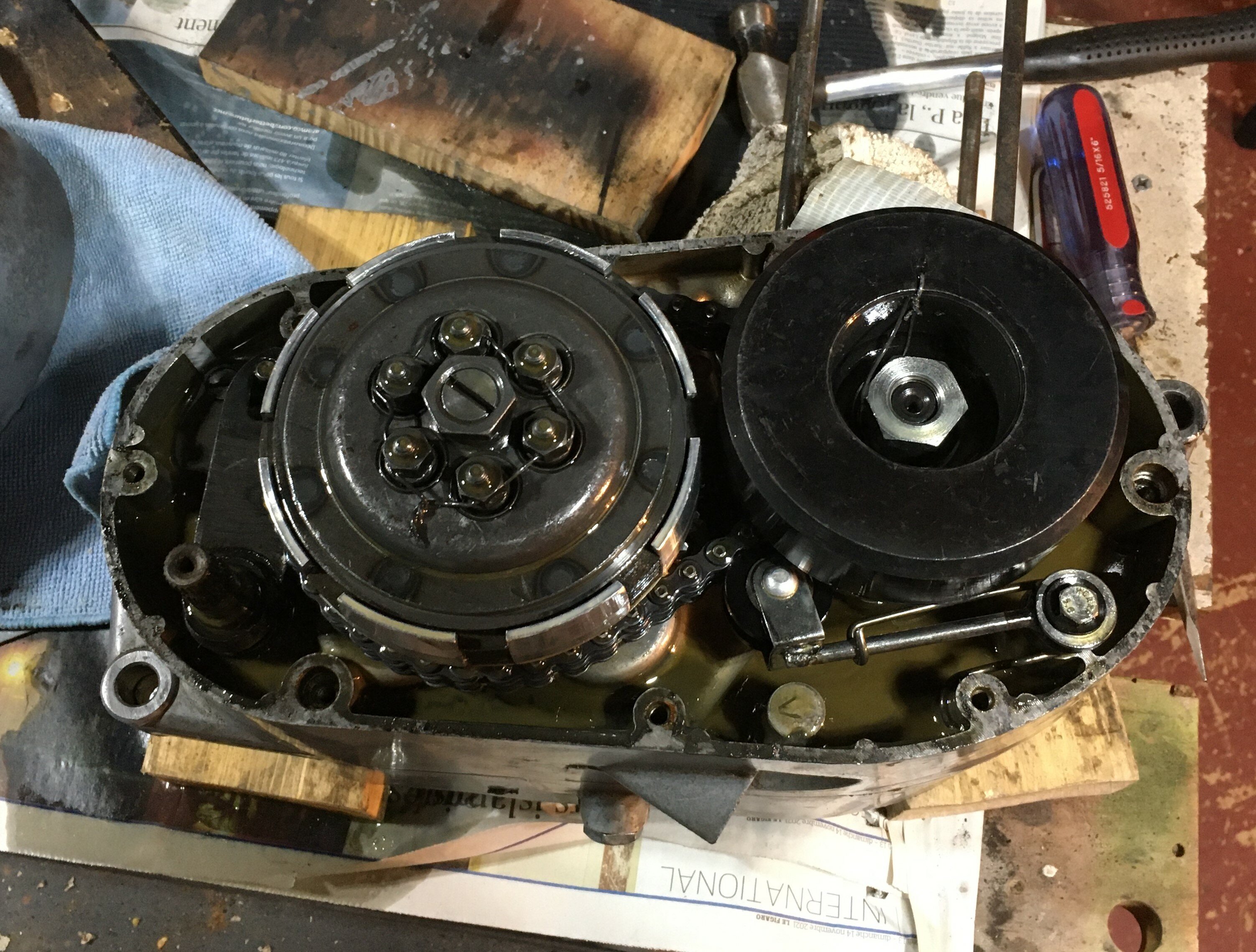

Divouneh Posted December 21, 2021 Author Report Share Posted December 21, 2021 Cover opened .. Quote Link to comment Share on other sites More sharing options...
