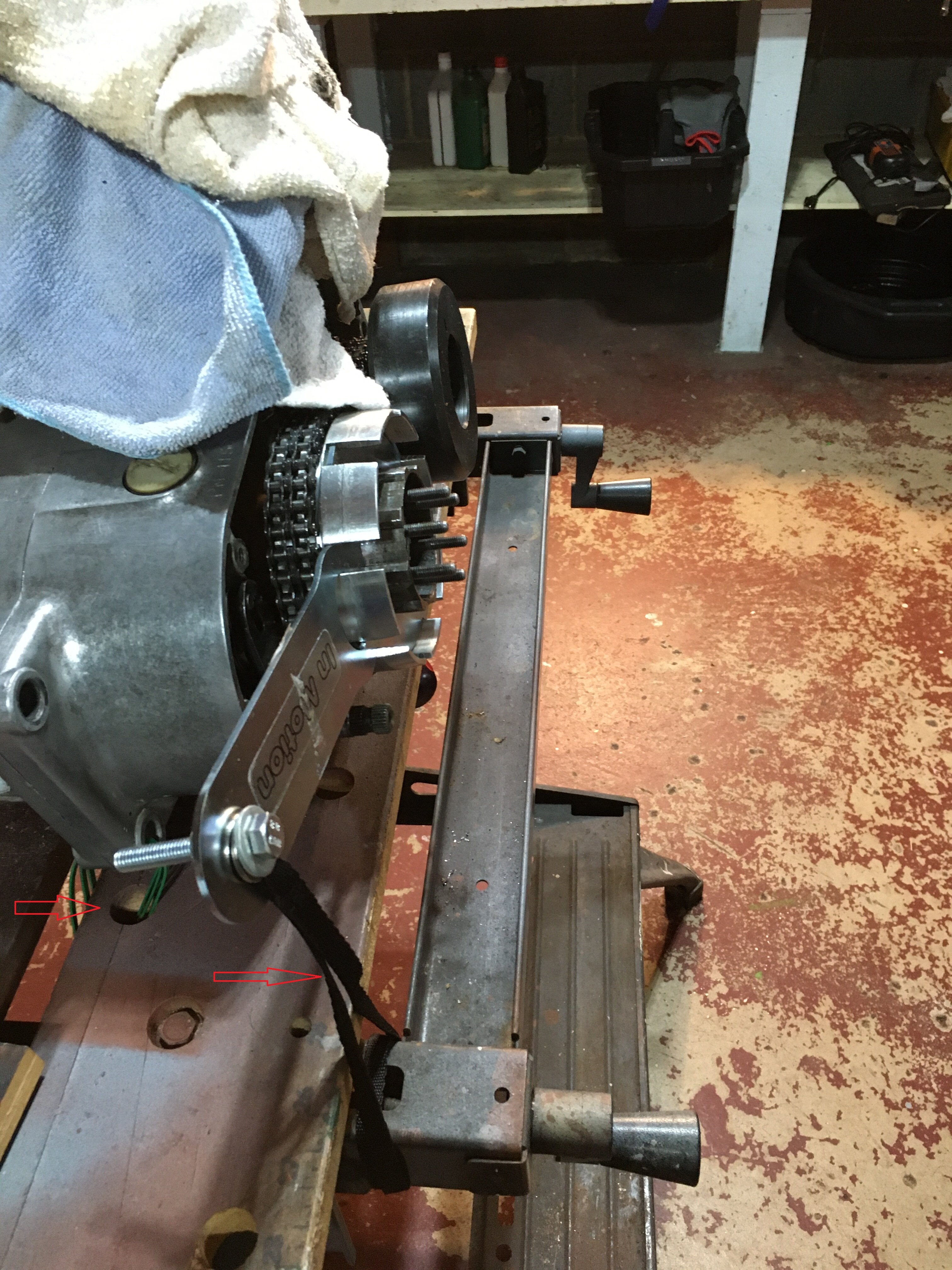

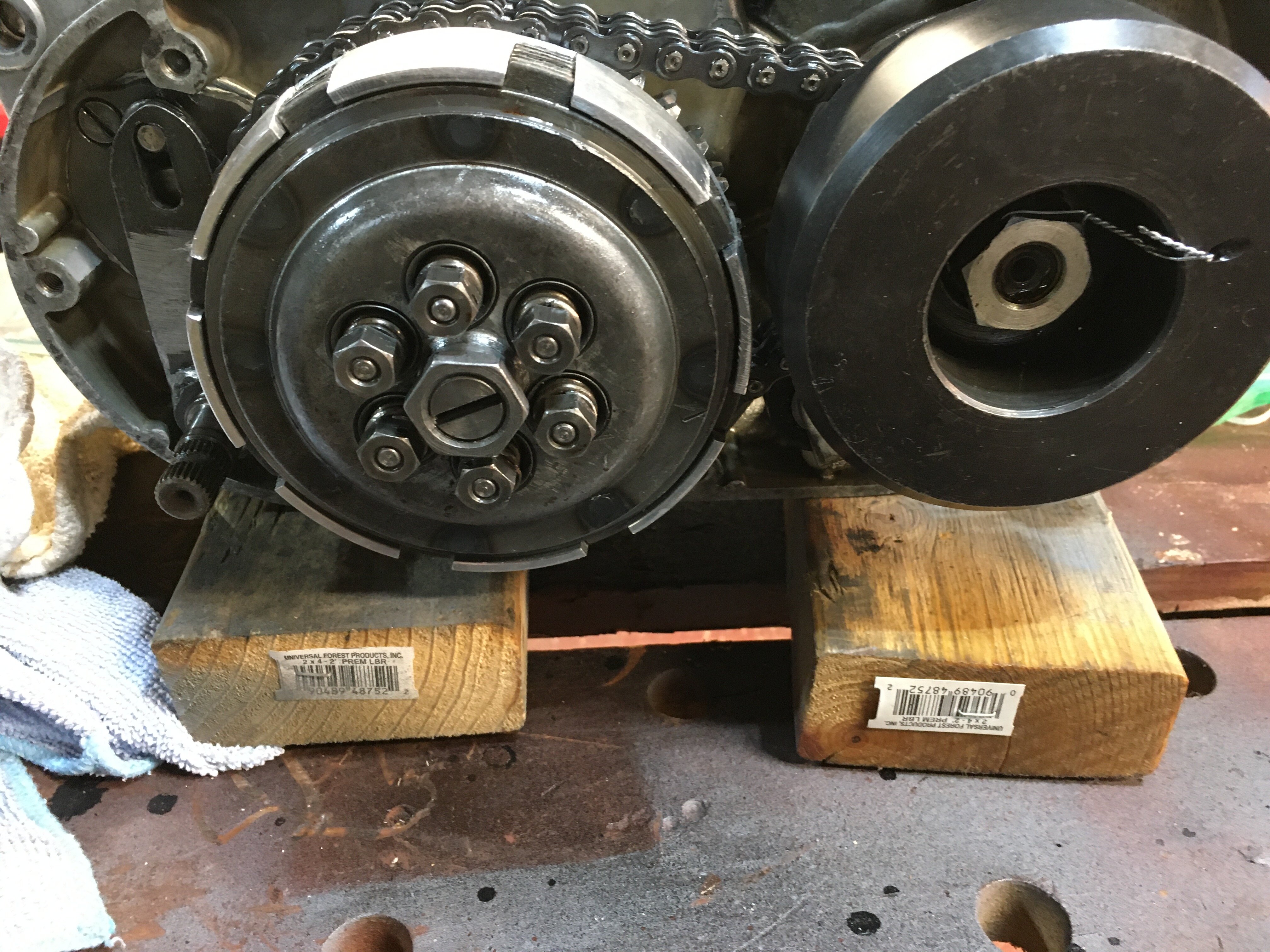

Divouneh Posted February 21, 2022 Author Report Share Posted February 21, 2022 I need to adjust the clutch nuts.... 1 Quote Link to comment Share on other sites More sharing options...

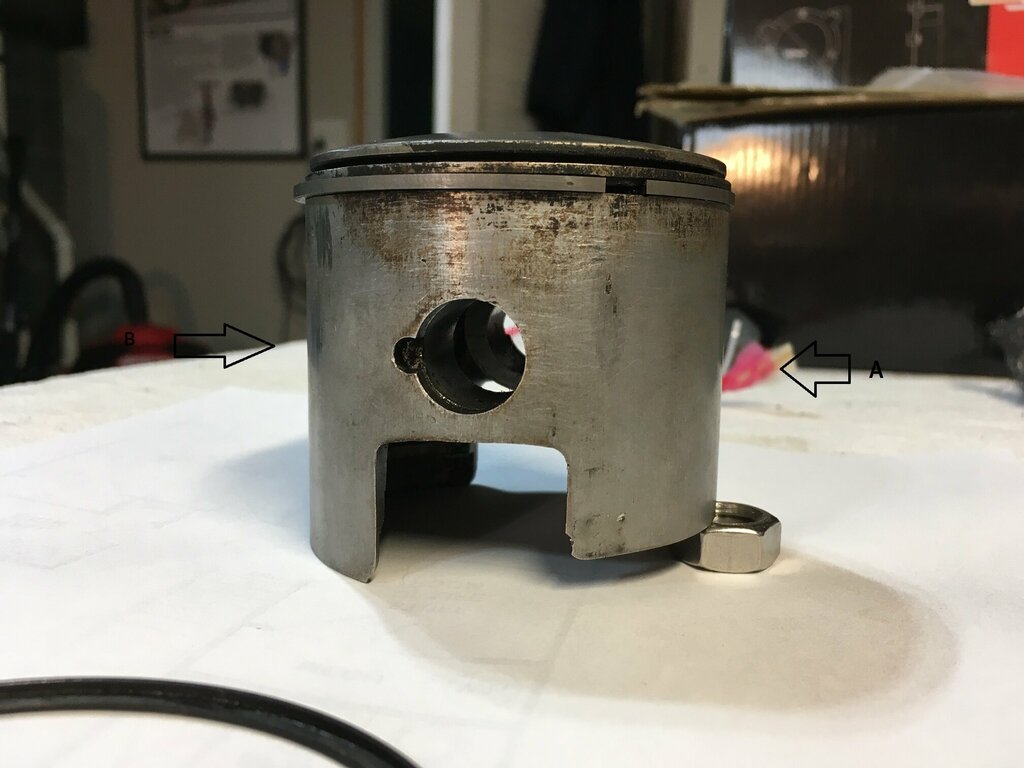

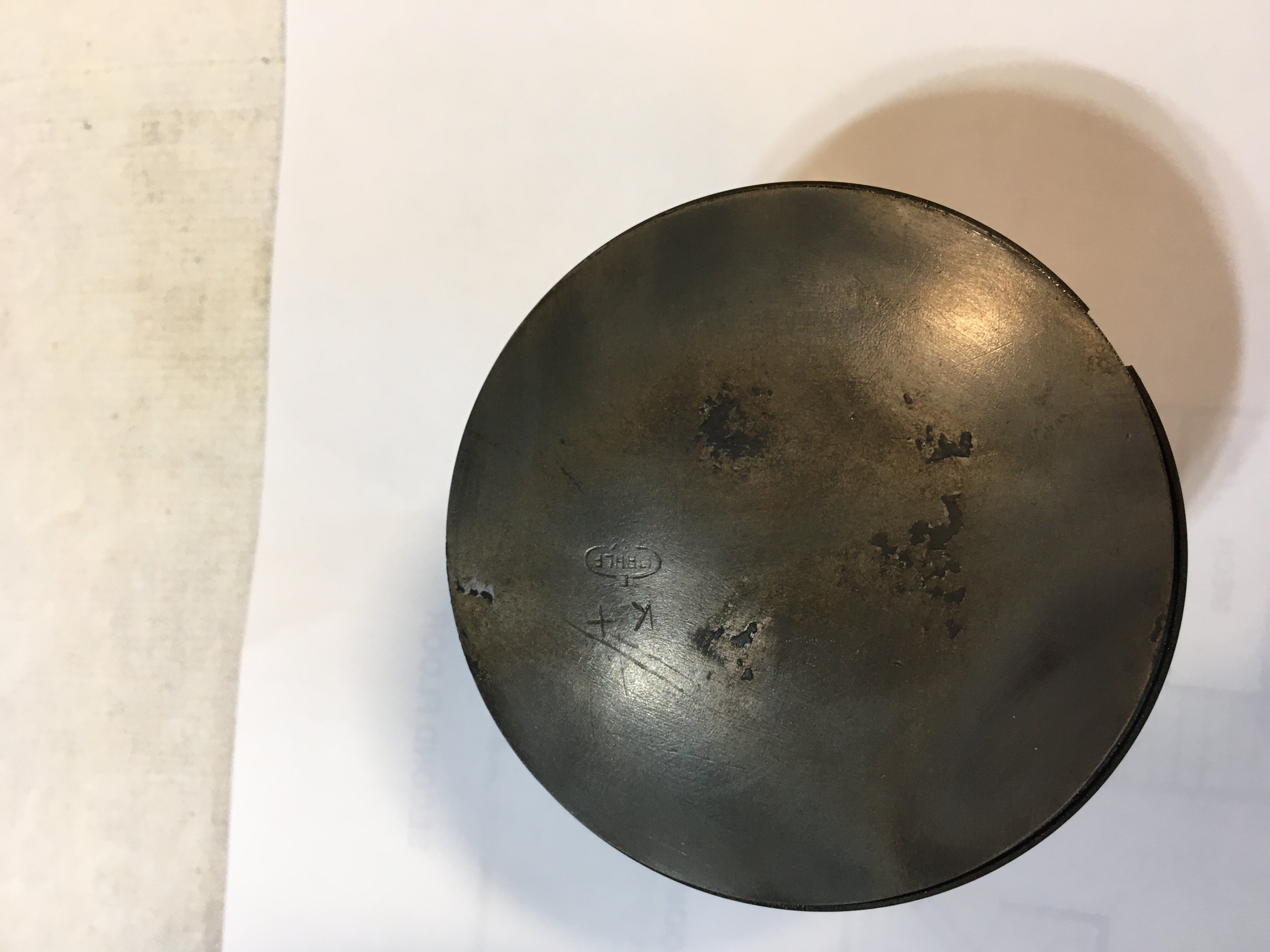

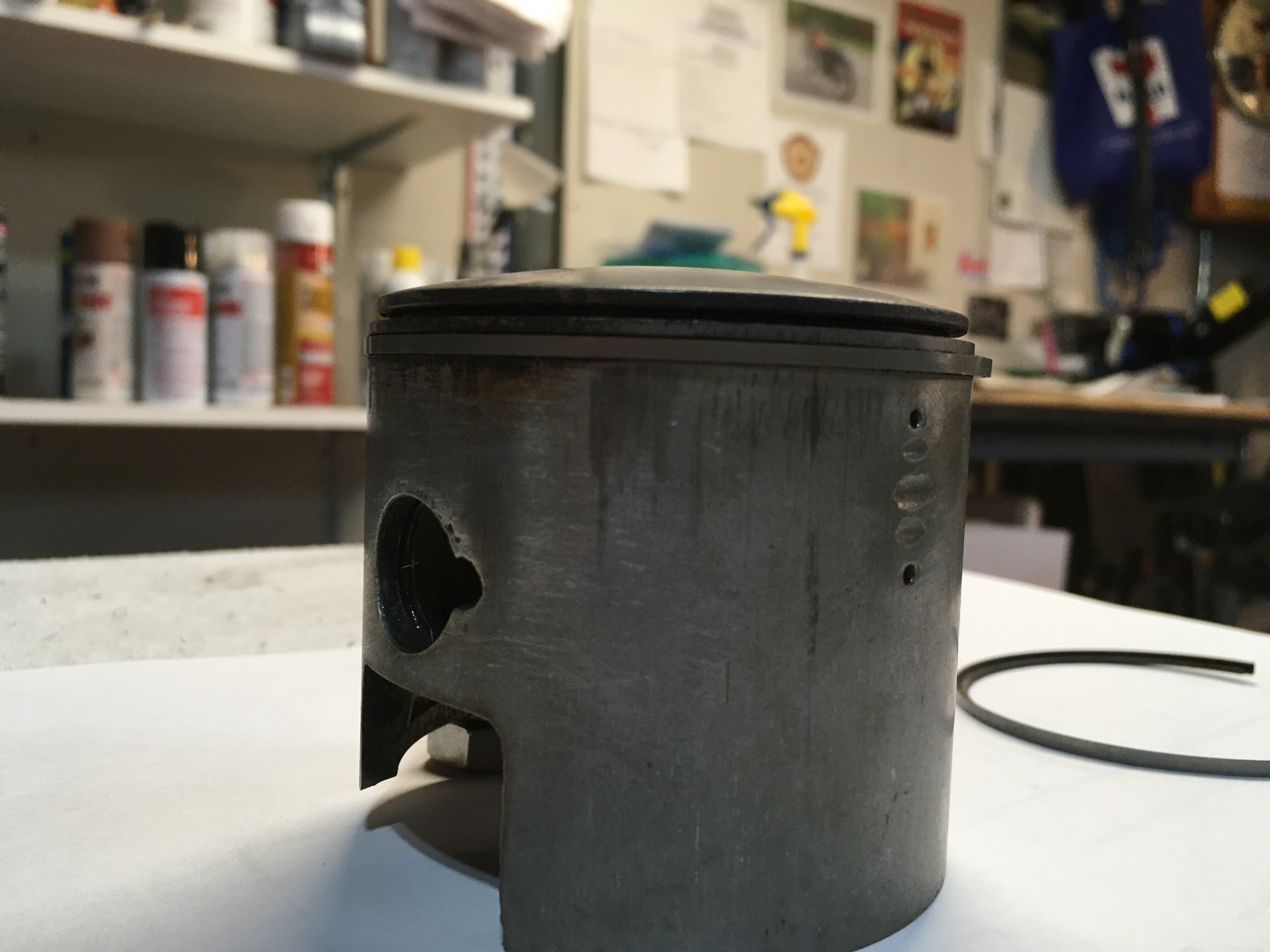

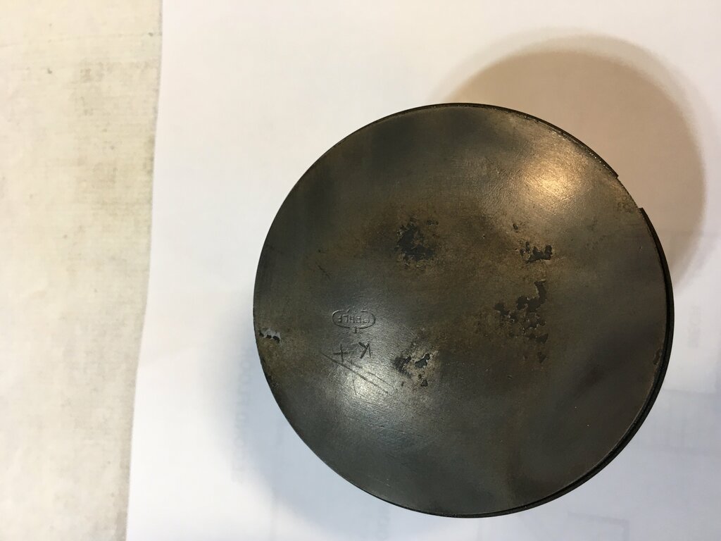

Divouneh Posted February 26, 2022 Author Report Share Posted February 26, 2022 Piston : Help ... I have no arrow in the top, A or B in the exhaust side ? I will put the "B" with the holes probably for the lub oil ...😒 To reduce the costs, I will keep the piston (the cylinder has no scratches and is very clean) Quote Link to comment Share on other sites More sharing options...
vintagenut Posted February 26, 2022 Report Share Posted February 26, 2022 Your Alpina project is coming along nicely! As long as your old piston, rings and cylinder aren't too worn, there's no reason to replace. Check the end gap on your rings when seated in the bore and compare to the tolerance measurements to the specs that can be found in the manual. Same with the piston. Measure the width of the bore and piston to determine if it's within spec. and, if so, just clean up your piston and run with it. As may have been mentioned earlier, a new piston pin and bearing would be advisable. As to orientation... the piston ring locating pins (in each ring groove) face toward the intake (carb) side of the cylinder. You're doing great - almost there! Looking forward to hearing about and seeing your final results. Good luck! Quote Link to comment Share on other sites More sharing options...
Divouneh Posted February 26, 2022 Author Report Share Posted February 26, 2022 Thank you for such nice words🙂, Piston is in place, pin is to tight (I never had such issue in the Japanese bikes 😆)... Probably the cylinder and cylinder head tomorrow... Quote Link to comment Share on other sites More sharing options...

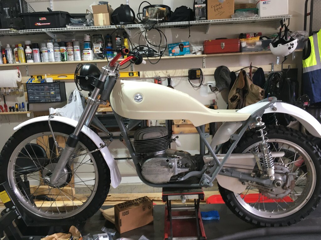

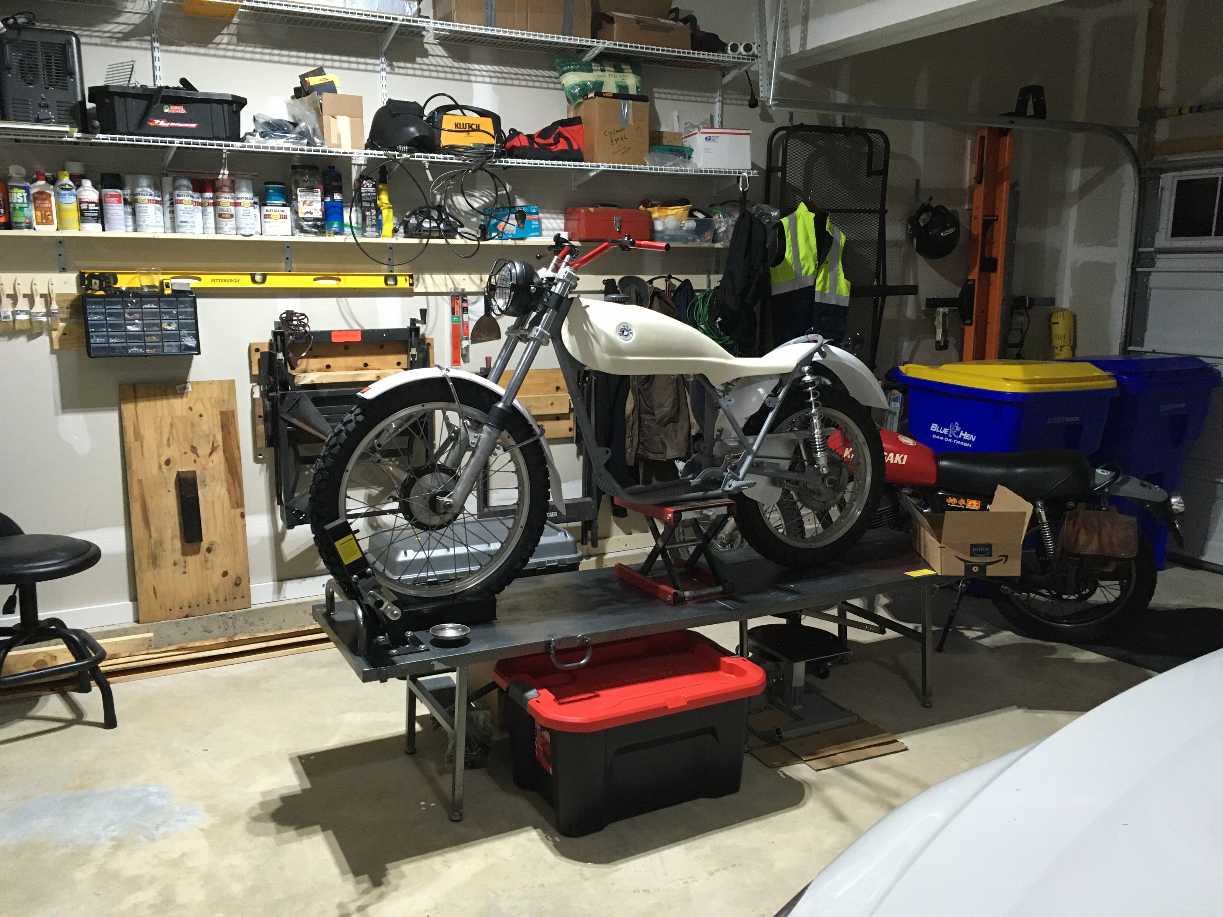

Divouneh Posted May 9, 2022 Author Report Share Posted May 9, 2022 Miss Bultaco will be back soon, my new workshop is ready... Less room but well organized the new garage, new bench... Quote Link to comment Share on other sites More sharing options...
Divouneh Posted May 21, 2022 Author Report Share Posted May 21, 2022 Quote Link to comment Share on other sites More sharing options...

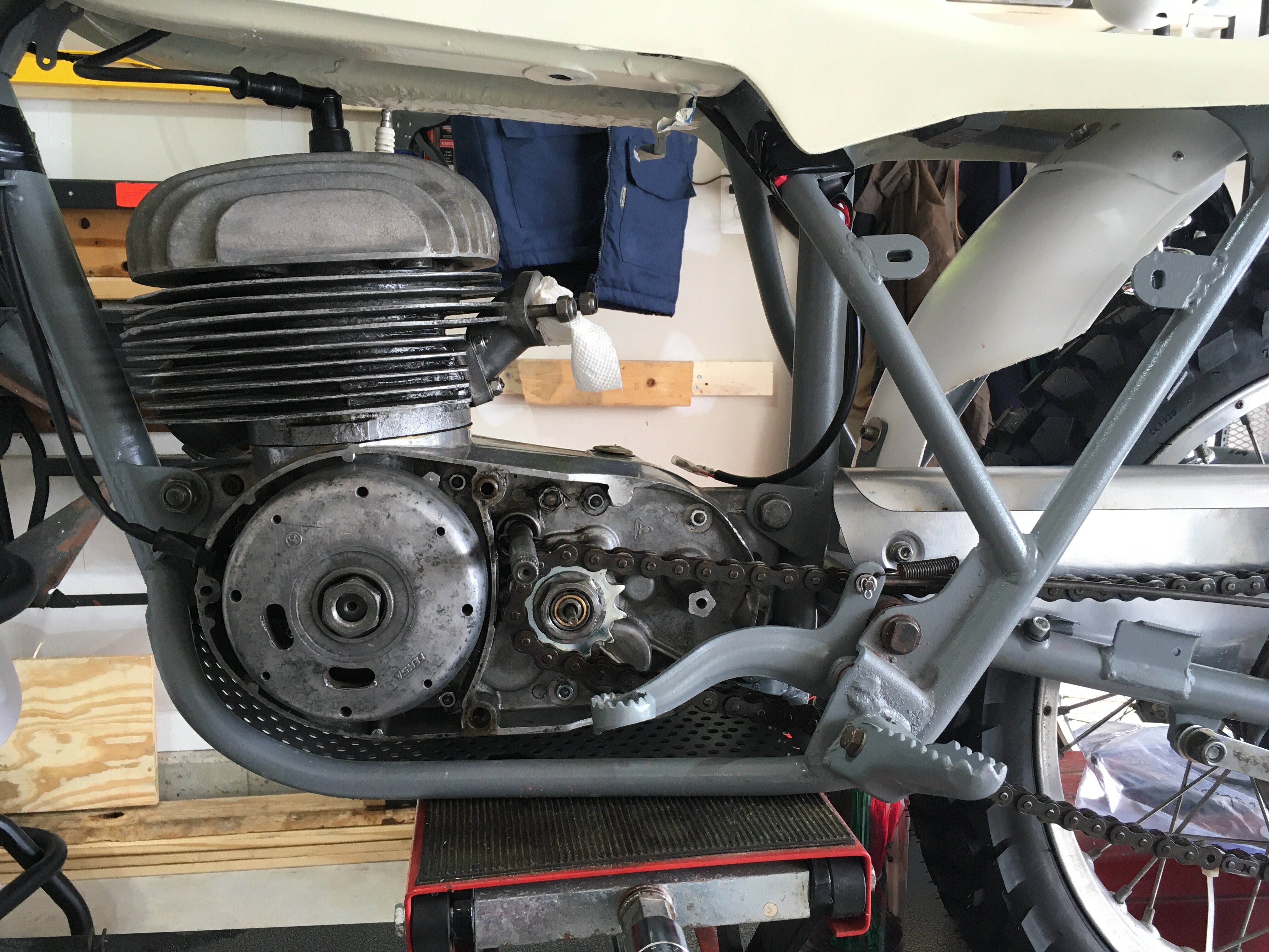

Divouneh Posted May 24, 2022 Author Report Share Posted May 24, 2022 Engine is in place, starting to implement my electronic ignition... and 12vdc supply without battery ... Quote Link to comment Share on other sites More sharing options...
Divouneh Posted June 3, 2022 Author Report Share Posted June 3, 2022 Chain to short 😝, I try to find why: was the one in the bike month ago 🤫....day, big Quote Link to comment Share on other sites More sharing options...
lorenzo Posted June 4, 2022 Report Share Posted June 4, 2022 Would be easier to fit connecting link at rear sprocket.....is the chain in two (or more) pieces ? What's happened to chain on lower run beneath brake arm bracket (bottom r/h. corner of pic) ? Quote Link to comment Share on other sites More sharing options...
pschrauber Posted June 4, 2022 Report Share Posted June 4, 2022 So you did not change anything (You haven't mounted a bigger front or rear sprocket)? Then probably the position of the wheelaxle has changed. Last not least all my Bultacos needed and need a half link to have tbe proper chain length?. May be that is missing right now? Quote Link to comment Share on other sites More sharing options...
