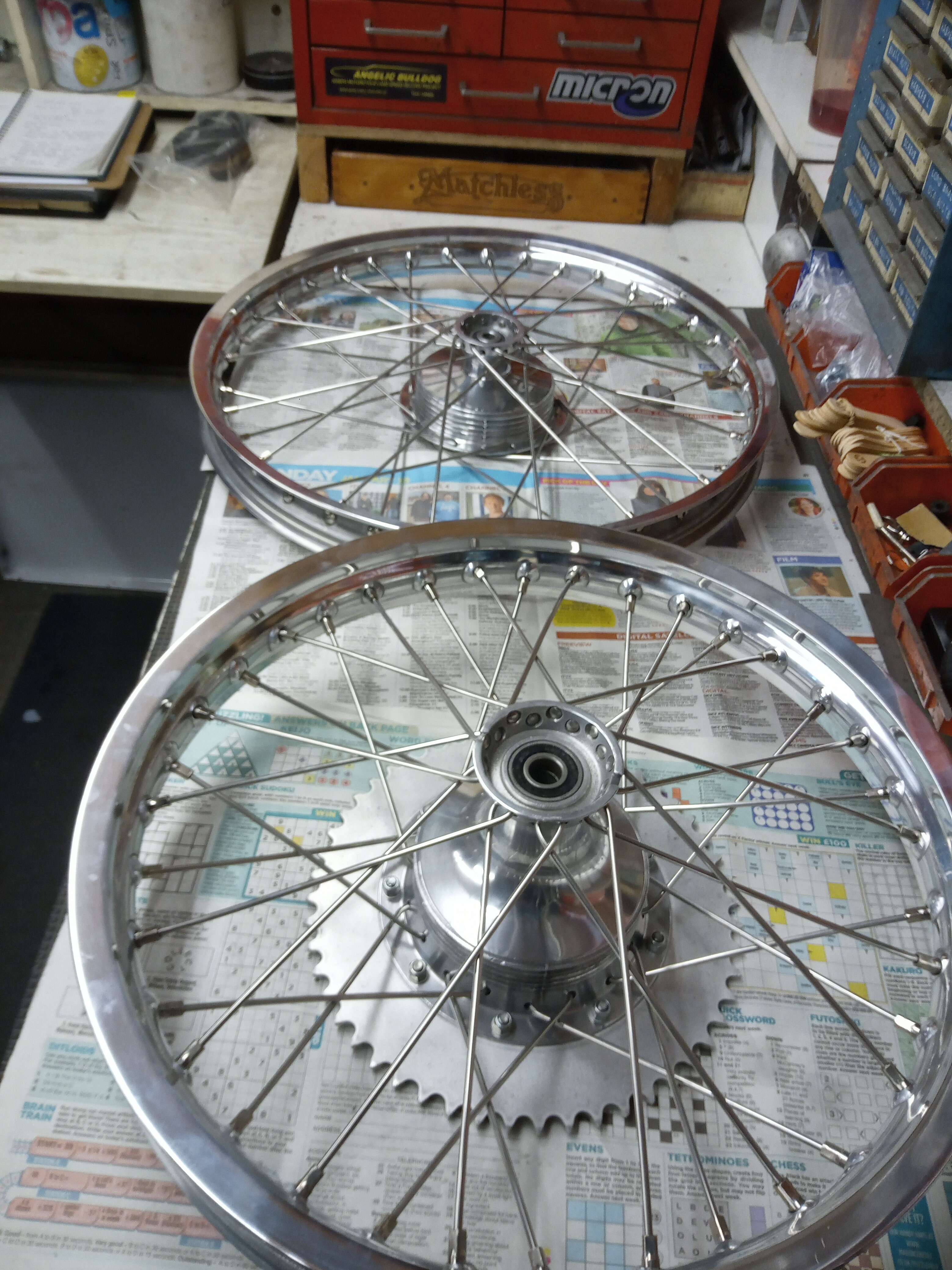

colinf Posted June 14, 2021 Report Share Posted June 14, 2021 Just rebuilt a pair of wheels for the 191.Polished the hubs,got Mike Danby to re-line them.Inmotion supplied Morad rims but I had Central Wheel Components supply spokes.I have Michelin H/duty tubes and IRC tyres + security bolts ( all from in motion) but the rims aren't drilled for the security bolts.Has anyone drilled these? Would put it opposite the valve but anything else I should or shouldn't do? Quote Link to comment Share on other sites More sharing options...

lorenzo Posted June 15, 2021 Report Share Posted June 15, 2021 colinf - Dealing with the front wheel first :- Placing the security bolt diametrically opposite the valve stem hole is a bad idea - as b40rt pointed out, that's where the join weld is. This would be where the Akront label is placed on an original rim; also unsuitable for the reason that it's where two spokes are converging at the rim. Placing the security bolt hole as close as possible to opposite at a point with diverging spokes would locate it at just two nipple holes away from the join weld, probably equally undesirable. If you look at your wheel, you will see that the nipple holes/dimples in the rim are disposed in (nine) groups of four. I have only original Akront rims and all are drilled the same, with security bolt hole between 3rd. and 4th. groups from the valve hole, between 12th. and 13th. spoke from valve stem. .. Viewing wheel from the left, this means that with the valve at 6 o'clock, the security bolt hole is at 10 o'clock, i.e. security bolt trails valve in forward rotation. Hope this makes sense. Looking at your pic. something doesn't look quite right with the rear wheel lacing.......... Quote Link to comment Share on other sites More sharing options...

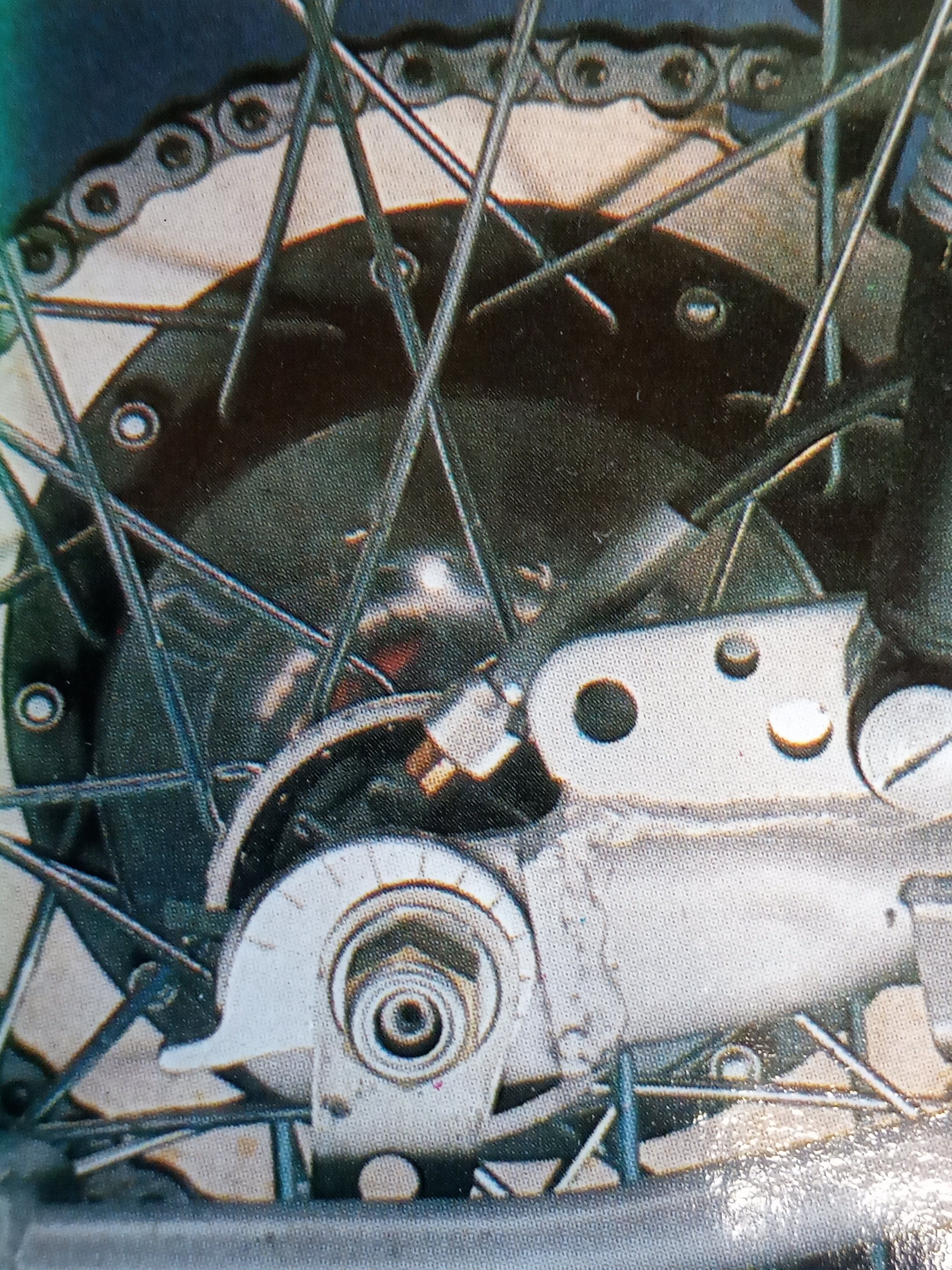

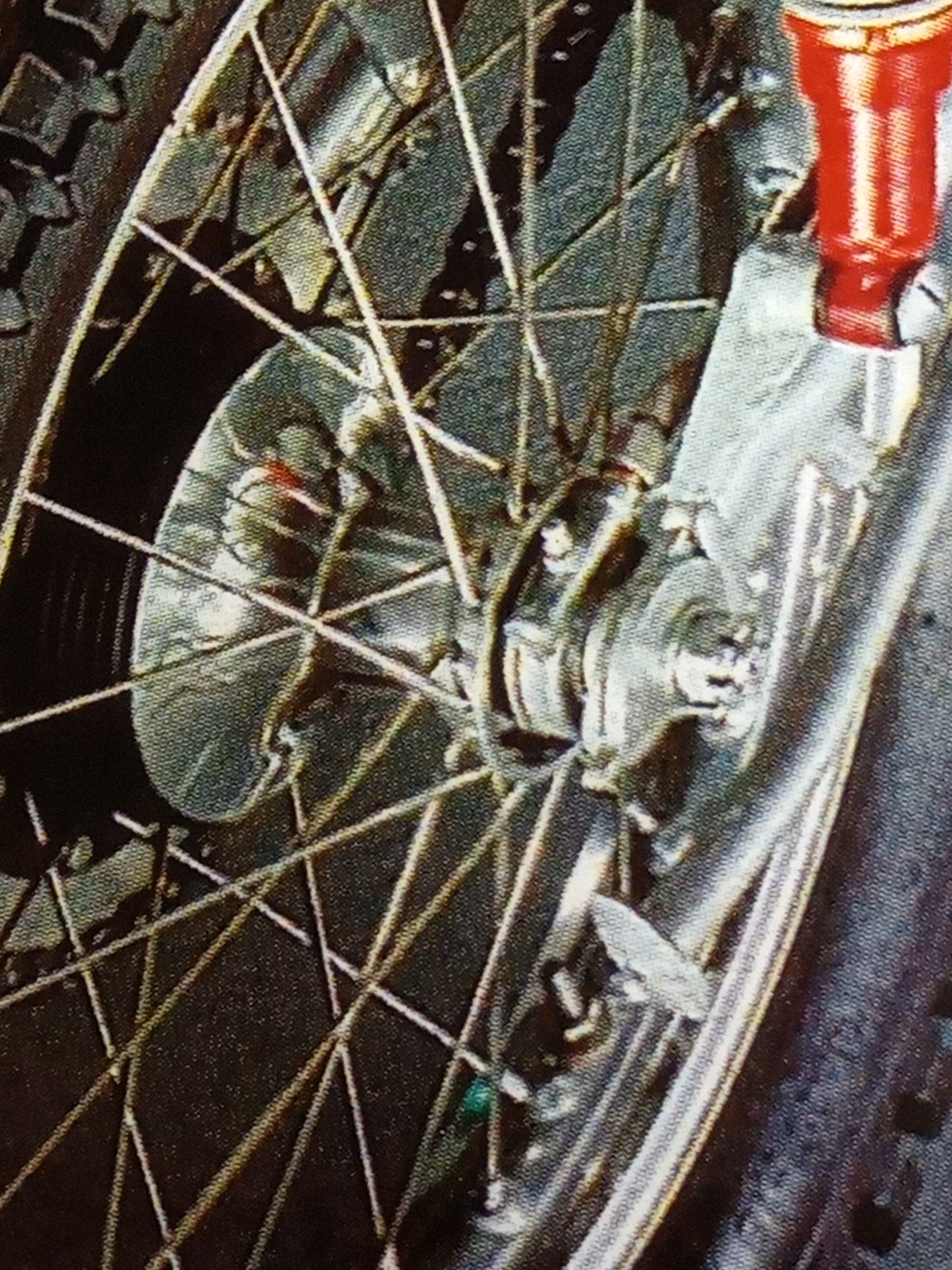

colinf Posted June 15, 2021 Author Report Share Posted June 15, 2021 Right, diverging not converging spokes.....got that. Lorenzo, what specifically looks wrong to you? I posted the pic so that anyone could point out if I'd done something wrong, I wouldn't be offended as I'd like to do it right ( learning curve as these are the first wheels I've built).These pics and the parts manual are what I used as a guide ( I didn't strip the original wheels, they were in bits when I got the bike). Quote Link to comment Share on other sites More sharing options...

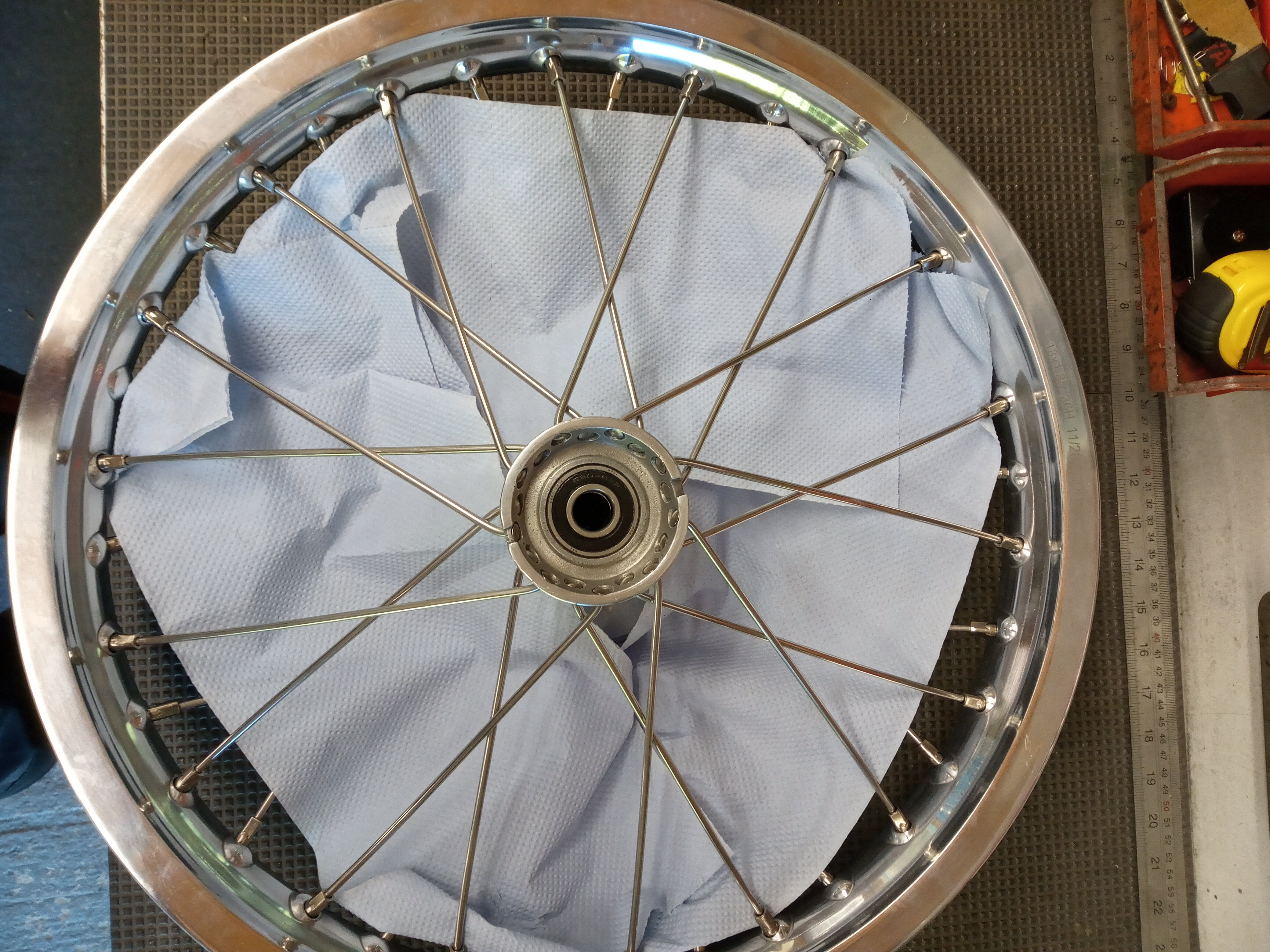

lorenzo Posted June 15, 2021 Report Share Posted June 15, 2021 colinf - There may well be nothing wrong and it could just be the angle the wheels are at to the camera........a full side-on shot of the whole wheel from the right (non-brake) side would probably help. Don't worry about it being a learning curve ; I also like to do things right (first time if possible) and after decades of working with bikes I'm still learning, too. Quote Link to comment Share on other sites More sharing options...
colinf Posted June 16, 2021 Author Report Share Posted June 16, 2021 Don't know if this is any clearer Quote Link to comment Share on other sites More sharing options...
lorenzo Posted June 16, 2021 Report Share Posted June 16, 2021 colinf - Yes, that's clearer - it was probably just the angle of the camera. as I said earlier. Do you know the gauge of your new spokes ? Quote Link to comment Share on other sites More sharing options...
