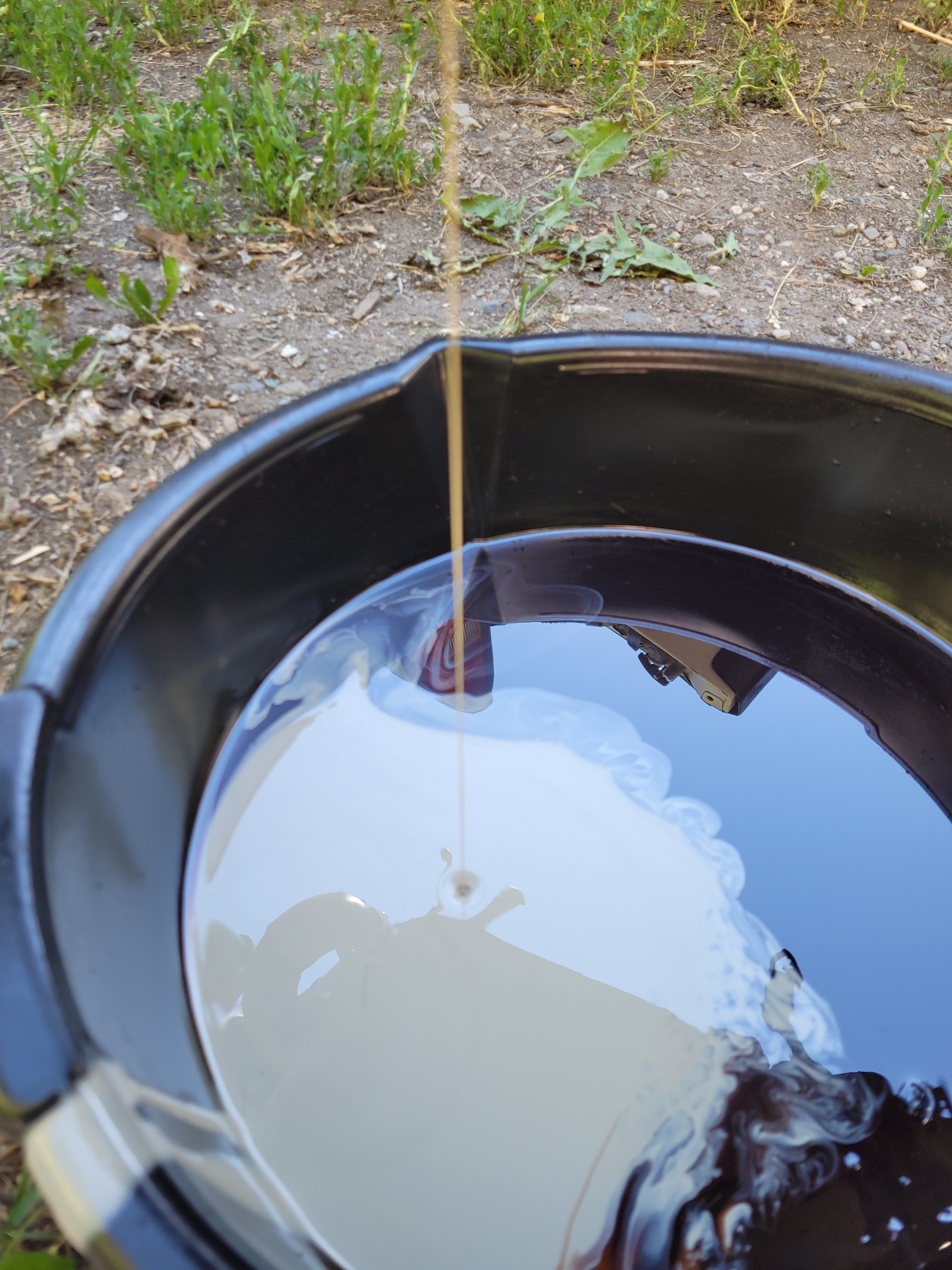

Glayne Posted June 28, 2021 Report Share Posted June 28, 2021 I feel like I should have wrapped my head around this, but I'm struggling. I pulled the 2012 gasser 280 out this morning , before ride I noticed milk coloured oil. Impeller, seal and shaft have been done within the last 40hrs. I changed the oil, still milky and rode for maybe 15mins, noticed the fan not coming on. After the ride I jumped the fan to a spare battery, it works great, testing the thermostat, it seems to always have resistance and isn't opening, put it in boiling water, no click and no real changes in resistance. So... I would say bad thermostat, but could this overheat coolant into the oil? or do I have multiple issues? Or am I missing something! FYI it is over 40 degrees celsius in western Canada! Yikes! Quote Link to comment Share on other sites More sharing options...

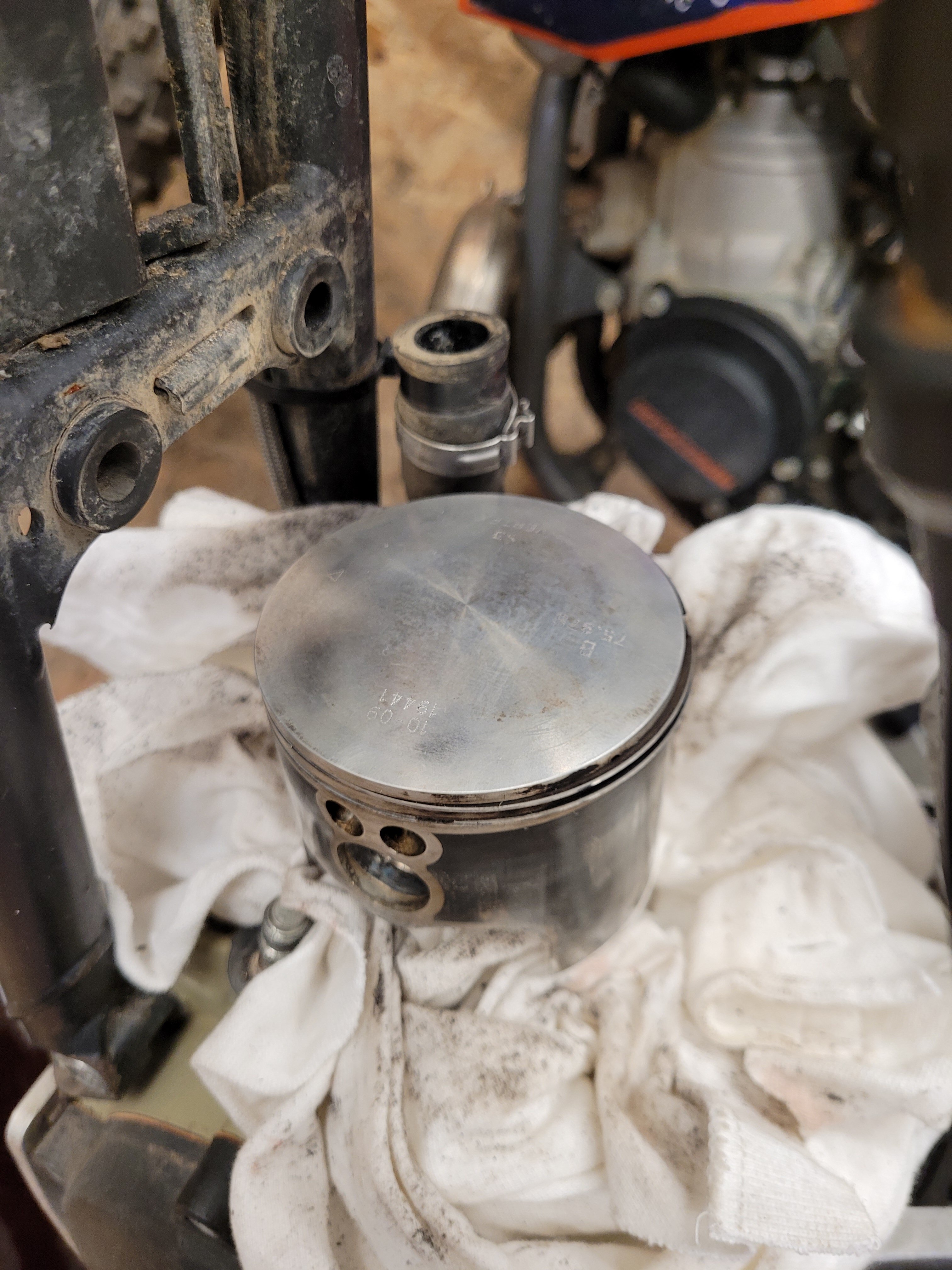

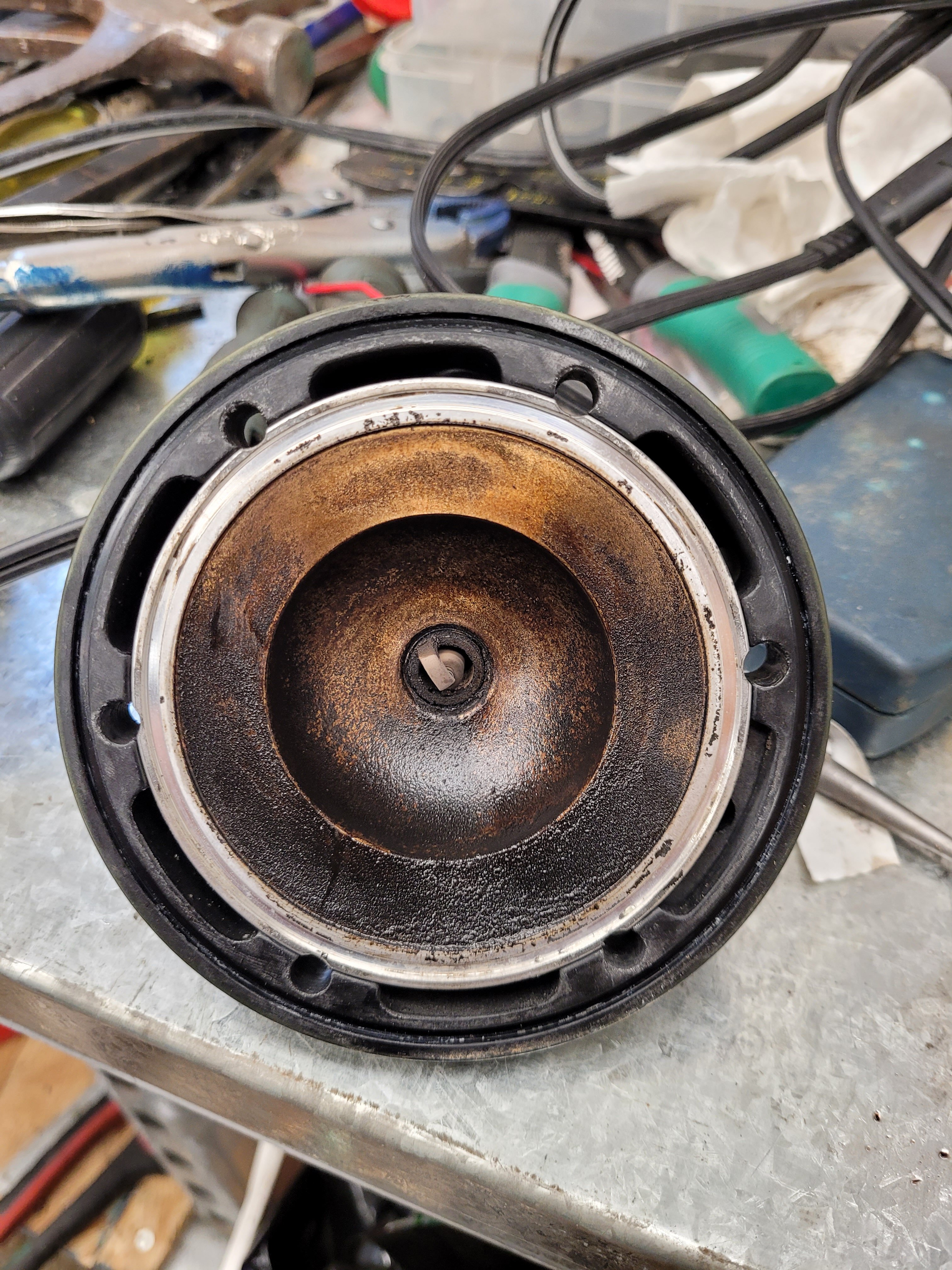

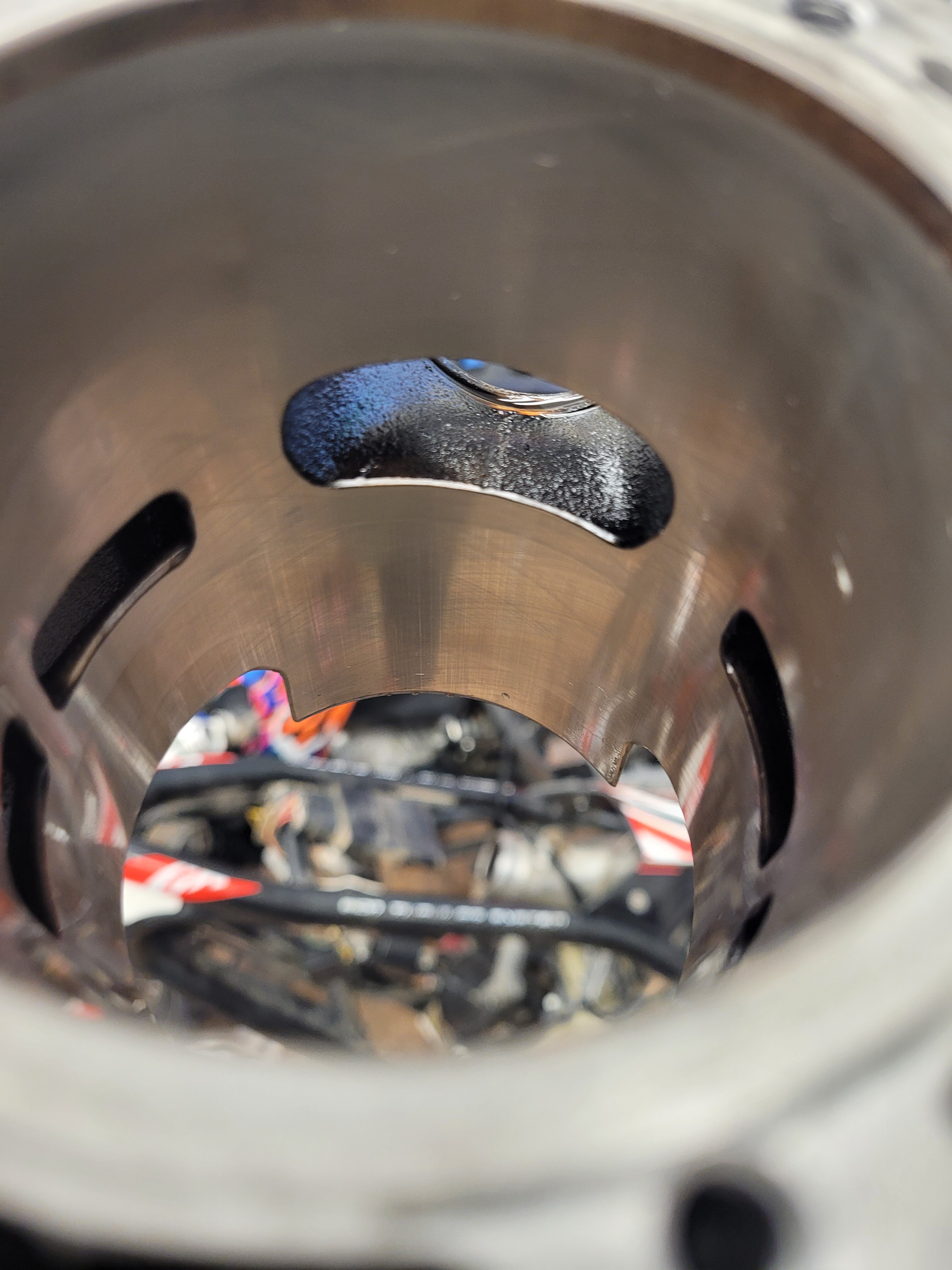

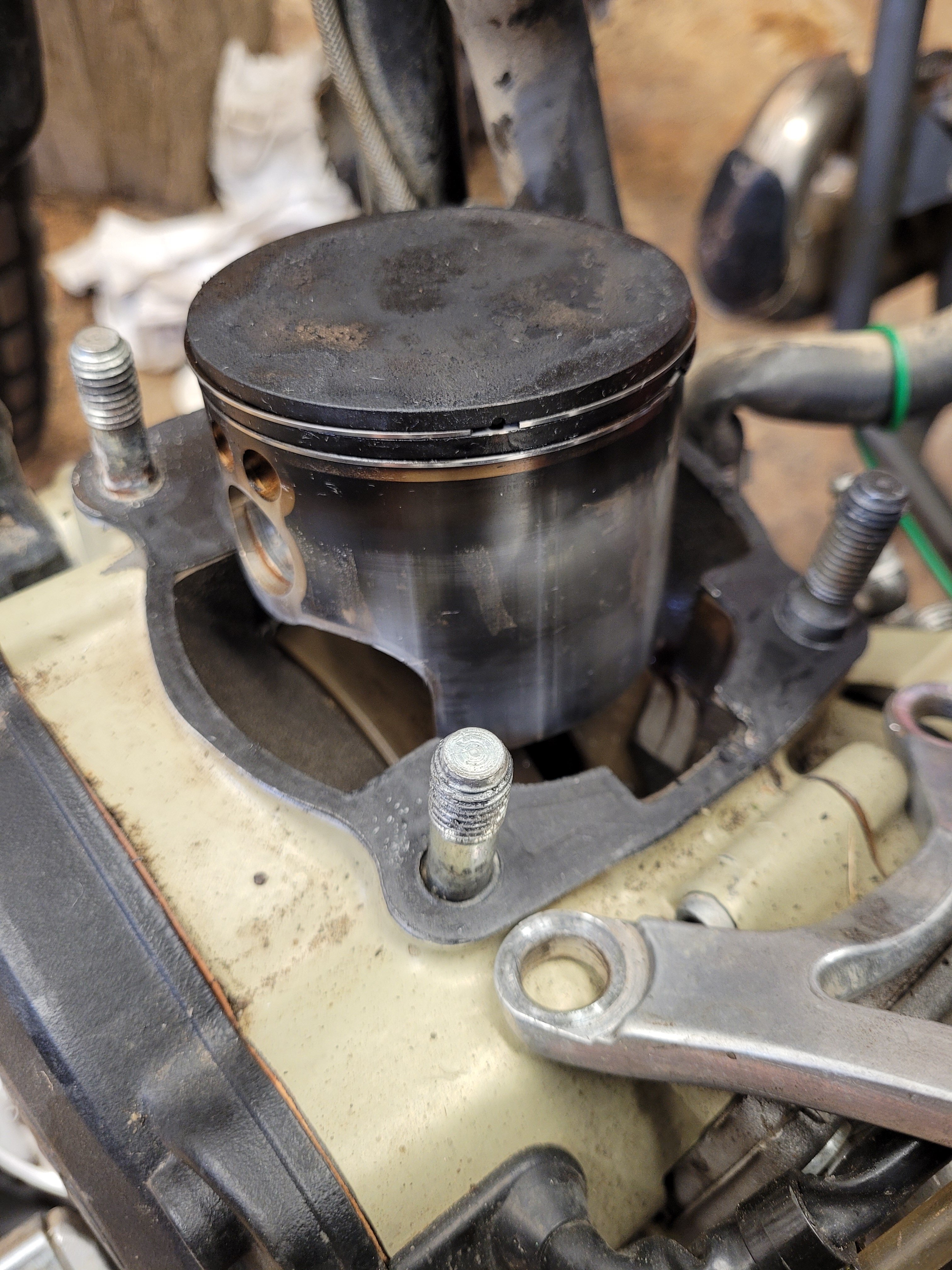

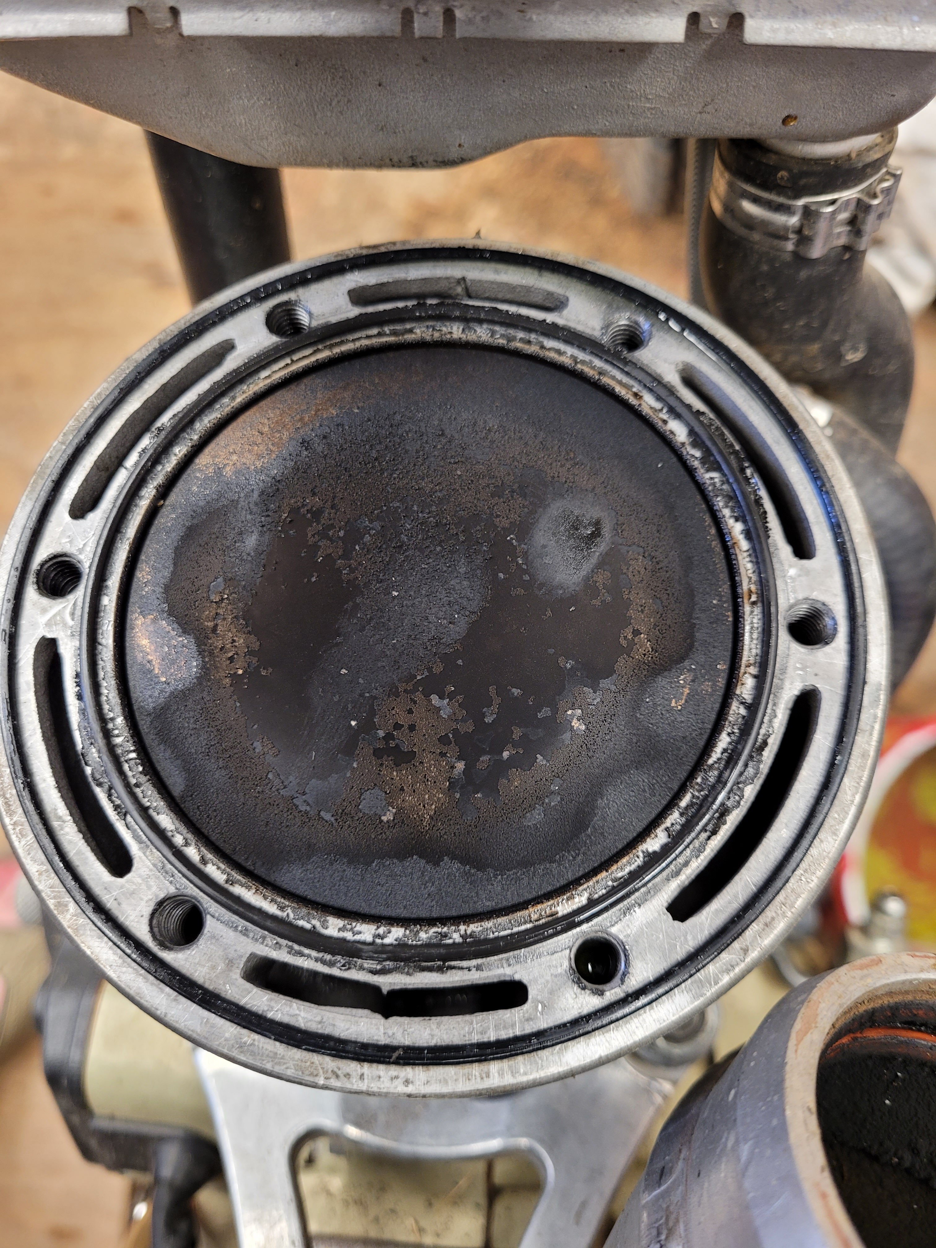

Glayne Posted June 30, 2021 Author Report Share Posted June 30, 2021 Cylinder great, piston hmmmm. My enduro pistons are a little cleaner. How does this look for a trials piston without a power valve? Why no power valve? Quote Link to comment Share on other sites More sharing options...
richt Posted June 30, 2021 Report Share Posted June 30, 2021 The piston and bore look ok. The inner O-ring looks very poor and I reckon it has leaked hot gas into the coolant. Its not so clear on the photo but the top surface of the cylinder looks burnt/pitted, I hope it will clean up well. It may be worth turning it upside down onto an sheet of Wet & Dry sandpaper on a flat surface and polish it. at worst it may need skimming. What is the condition of the cylinder head looking like? Quote Link to comment Share on other sites More sharing options...
Glayne Posted June 30, 2021 Author Report Share Posted June 30, 2021 Both o-rings are starting to deteriorate, pretty sure I cooked them! coolant looked clean though. New S3 o-rings, base gasket and thermostat showed up today. Piston just looks dirty not pitted, pretty sure it was burning an unhealthy diet of coolant, will be cleaning it up for sure. Piston had new rings maybe 40hrs ago Head is dirty as well and will get a cleaning, however the plug looks good. Thanks richt for the suggestions. Quote Link to comment Share on other sites More sharing options...

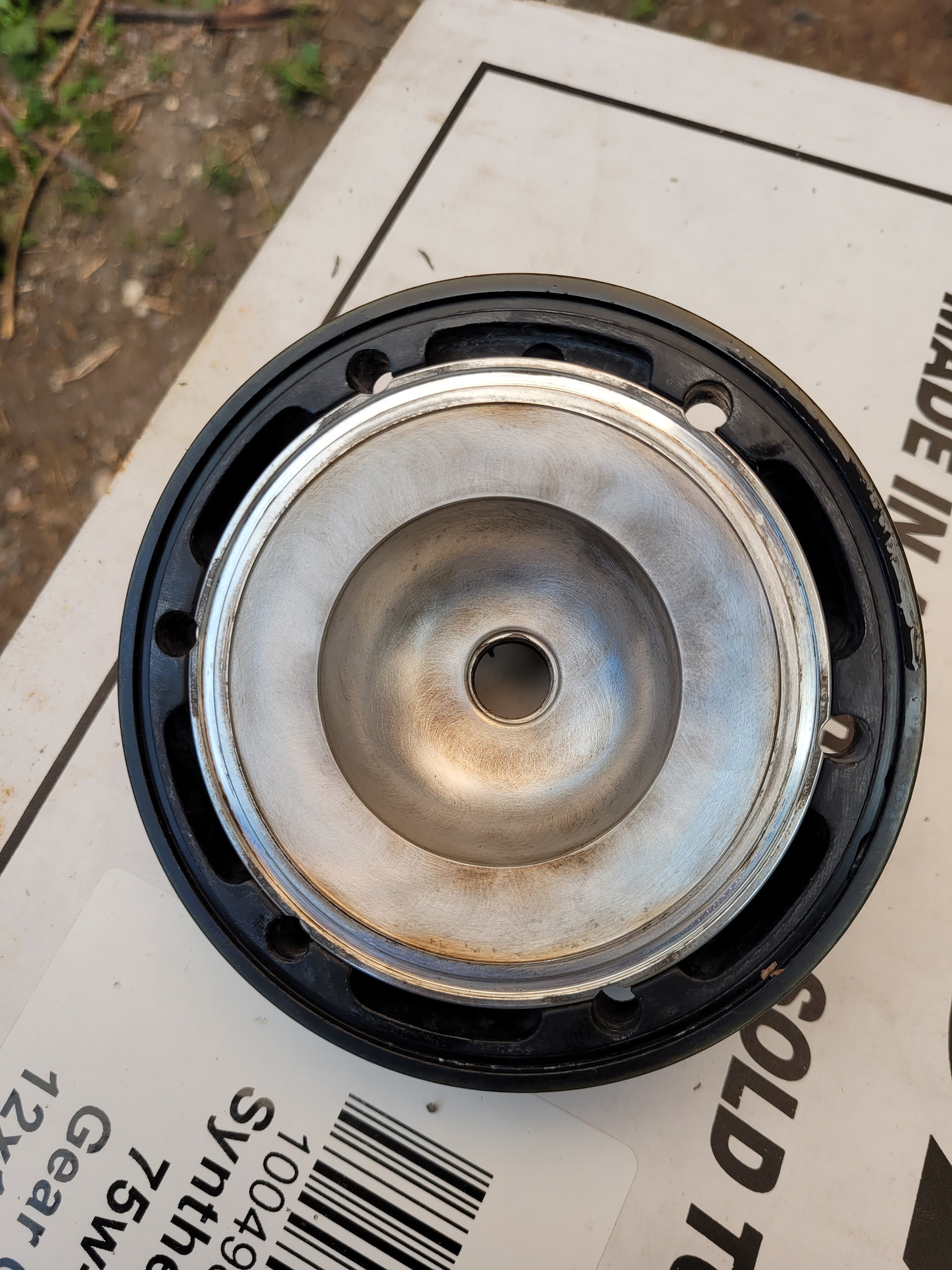

Glayne Posted July 1, 2021 Author Report Share Posted July 1, 2021 More pictures here, head before and after, everything cleaned up easy. 43 degrees here for the first time ever, forest fire close, ash snowing from the sky. Picture of my truck hood is me parked at home for only 2 hours. Quote Link to comment Share on other sites More sharing options...

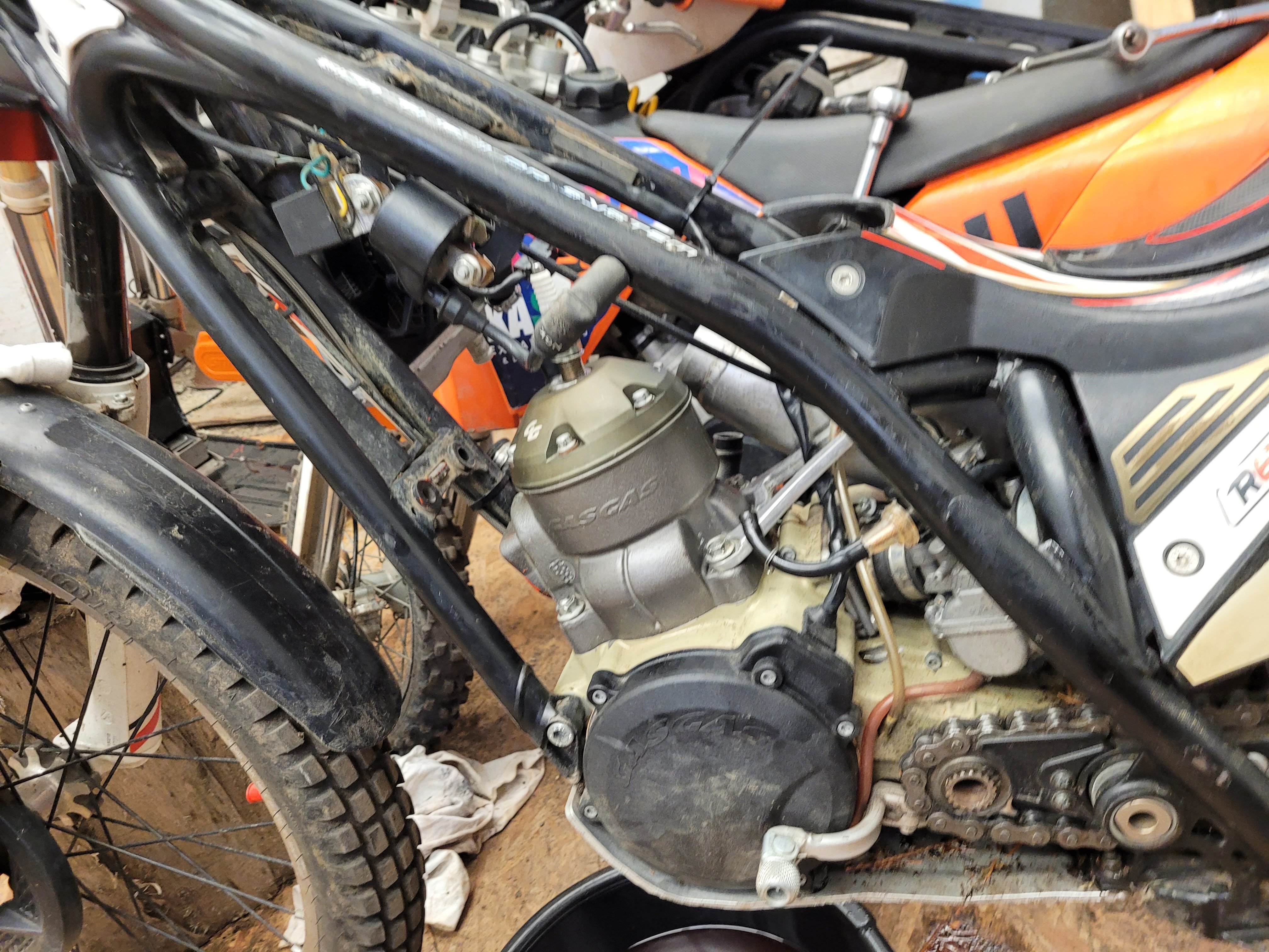

Glayne Posted July 1, 2021 Author Report Share Posted July 1, 2021 Nearly back together, kids needed damage control! Off work tomorrow for Canada day! Quote Link to comment Share on other sites More sharing options...
richt Posted July 1, 2021 Report Share Posted July 1, 2021 Cleaned up well, it should run like a new bike. 43 degrees that's too hot to ride, Its 18 degrees today in UK. I've never felt that type of heat except when I worked in a power station it still wasn't as hot as 43 though but at least you could go outside to cool down. How far away is the forest fire from you? On a lighter note, Your work bench gives the impression you've been busy (just like mine) but I hope you have used correct the tools and not the hammer and grips to fix your Gasser🤣 Enjoy Canada day and be careful. Quote Link to comment Share on other sites More sharing options...
