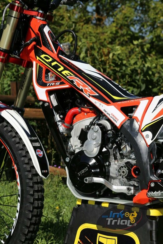

LB208 Posted June 30, 2021 Report Share Posted June 30, 2021 Hi , I have a 2020 250 trs one rr and I find it really hard to kick start due to compression this is know becoming a game changer for me and I’m thinking of looking for something else, was wondering if there is anything I can do to make it easier to kick start? Quote Link to comment Share on other sites More sharing options...
