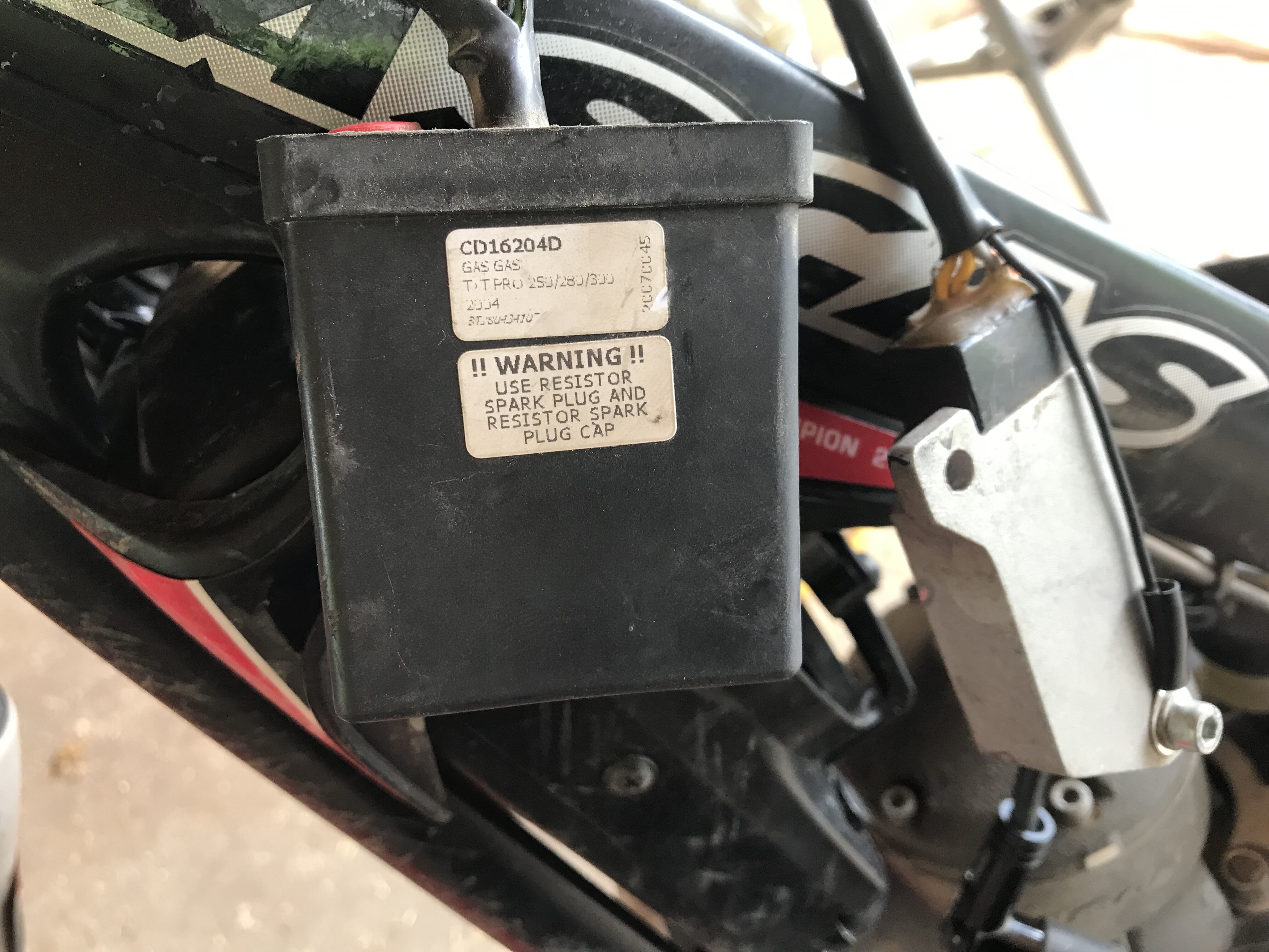

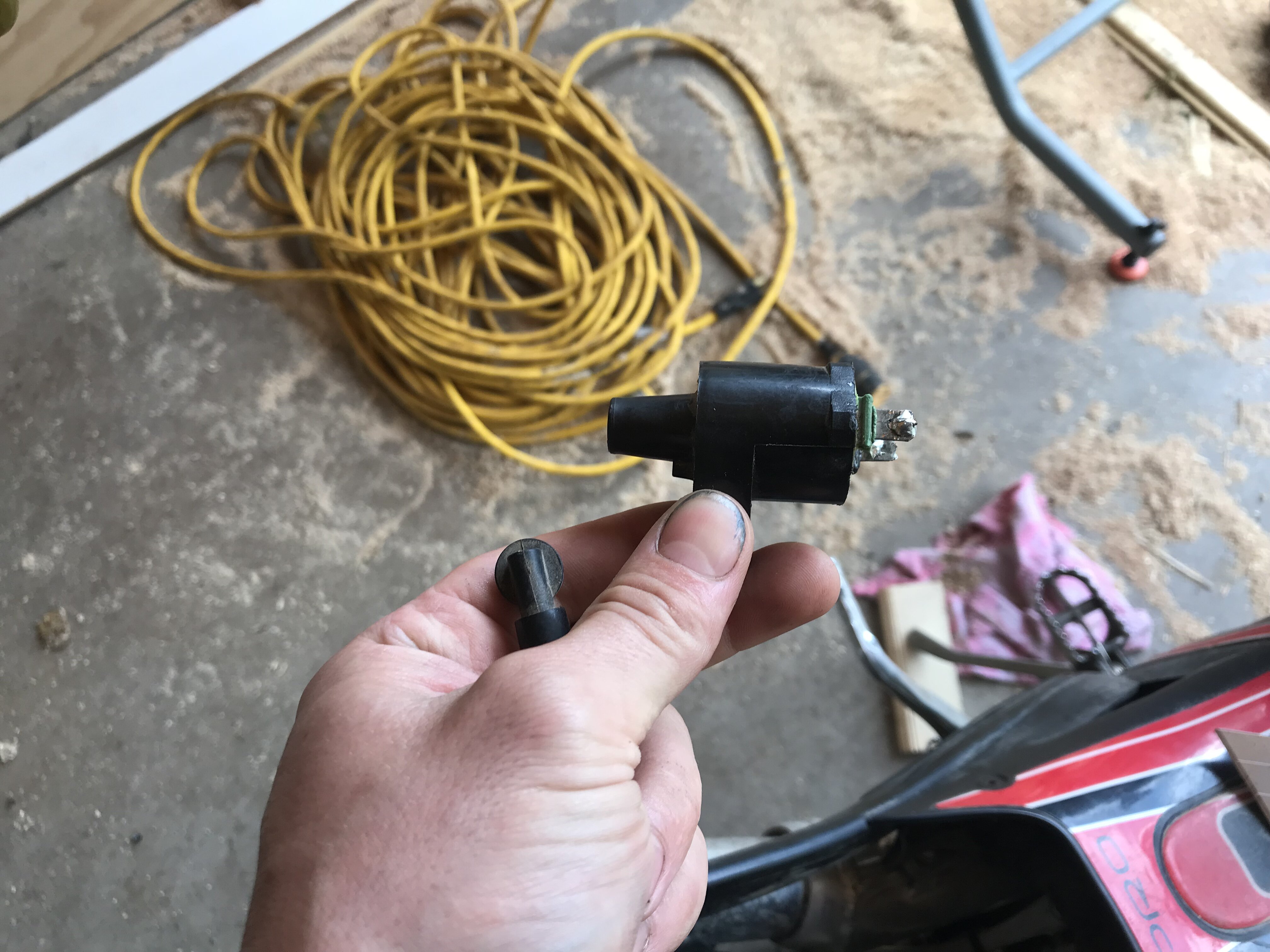

Dannydangles Posted July 1, 2021 Report Share Posted July 1, 2021 (edited) Hello, been creeping the forum for awhile now and was hoping you guys could help me work through an issue! 07 gas gas txt pro, bought this year, bike was like new with original tires, been having a blast using it to poach mountain biking and hiking trails. Brought it with me on a trip and had to do a creek crossing, it was a little deeper than expected and the bike died when I got to the other side, kicked it over for 30 min and finally went. Then I had to go back across, well soon as I hit the water same issue. This time I kicked the poor thing over for an hour and got it started, was running terrible , misfiring etc. Now it won’t start. Performed the following Cleaned Carb etc and no go. Checked for spark and seems there is none installed New plug and no go. checked continuity of plug wire and resistance for plug cap 5k ohm (seems ok) Checked resistance across stator and I have 1.0 ohm (seems ok) Checked resistance across coil and I have 2200 ohm (seems ok?) checked resistance across magnetic pickup and I have 250 ohm (seems ok) I am having troubles identifying the ignition system? I recall the previous owner mentioning it was upgraded from the Ducati but I can’t tell, I’m away from my shop and do not have the tools to pull the flywheel. Here is a pic of my ignition system, and the wiring matches the Ducati pictured below as well. Hoping for some help identifying so I can perform more thorough troubleshooting and order parts/upgrade. Edited July 1, 2021 by Dannydangles Quote Link to comment Share on other sites More sharing options...

sectionone Posted July 1, 2021 Report Share Posted July 1, 2021 It doesn't look like Ducati which is a silver finned box with Ducati written on it. They are known to go bad and the common replacement is a Kokusan ignition which is used on most gas gas of that era so maybe that is what you have. Quote Link to comment Share on other sites More sharing options...
