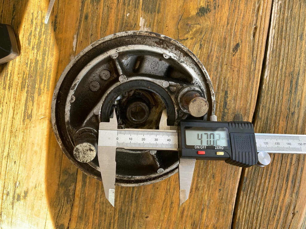

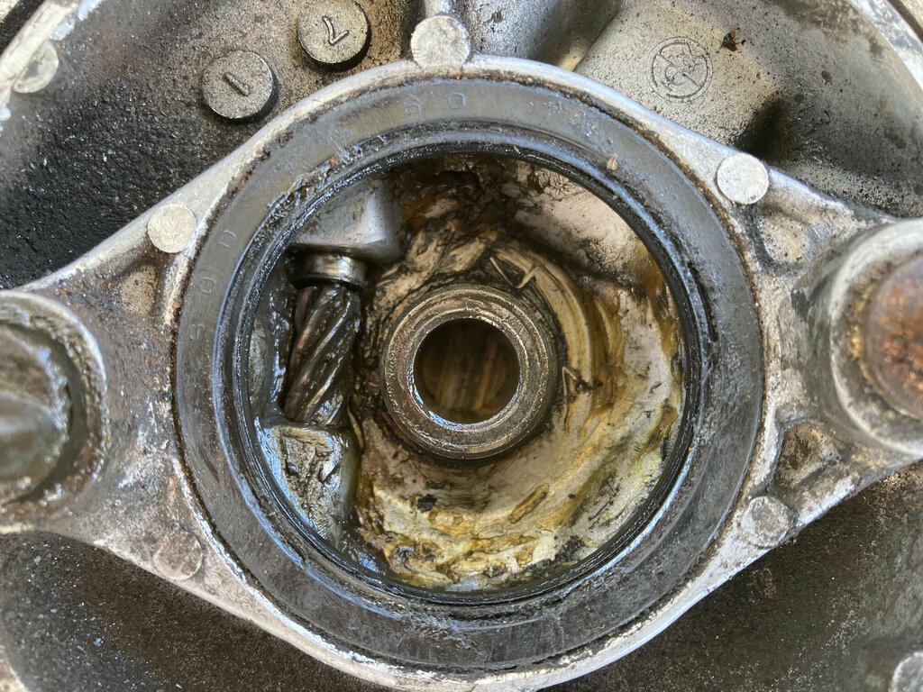

MrWeedster Posted July 4, 2021 Report Share Posted July 4, 2021 Hi. I'm in the progress of getting an old TL125S back to the street and make it street legal. I got everything working so far, except the tachometer, because i'm missing the gear in the front wheel hub (part no 44804-355-003). This gear seems to be impossible to find, no one can get it. I tried to fit one of a XL125, but thats too large to fit. Now i'm curious if theres another alternative that's fitting, maybe from another honda. I don't want to use another tachometer or make any dirty hacks, but thats an option if anything else fails. Any good advice on alternatives? Thanks in advantage Quote Link to comment Share on other sites More sharing options...

trialman Posted July 5, 2021 Report Share Posted July 5, 2021 Simple and cheap way to get back on the road is to use a cycle speedo kit, you just measure the outside dia. of wheel and input length into unit. this keeps you going until you find one.. In the meantime, send photo of hub and dia. of spigot that gear goes onto, will look in my junk box?? also look up david silver spares, he keeps lots of classic bits. all the best. Quote Link to comment Share on other sites More sharing options...
