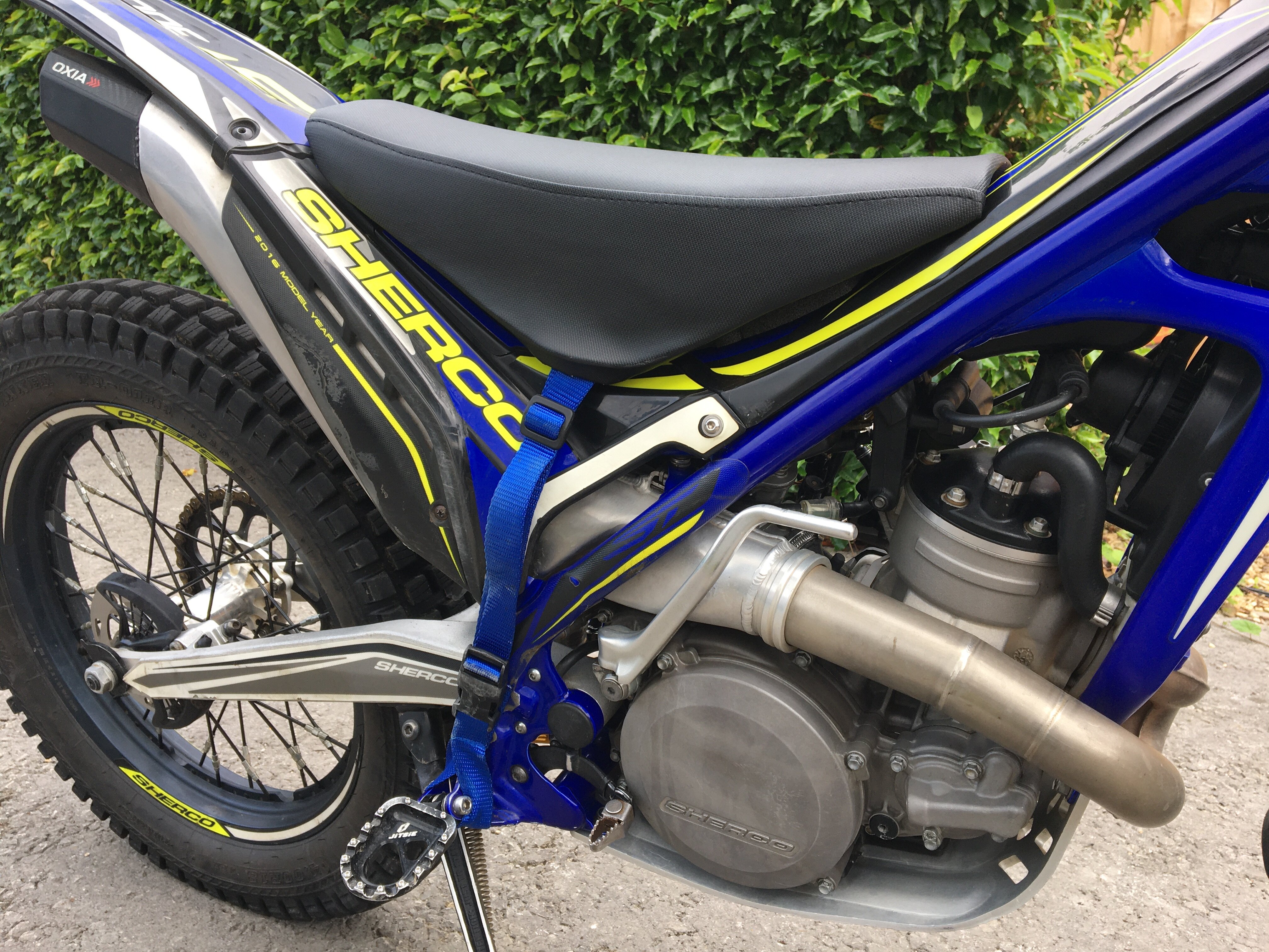

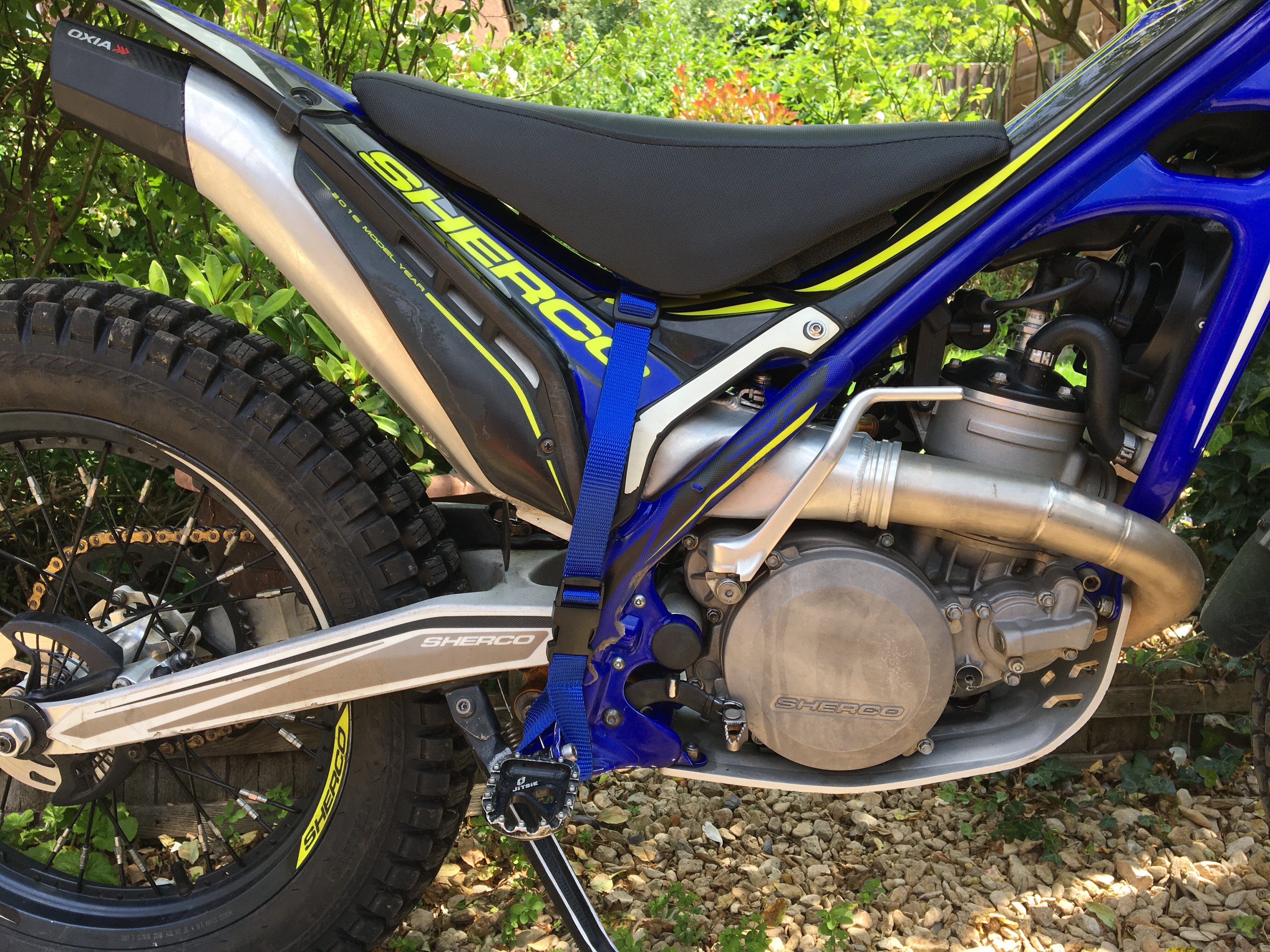

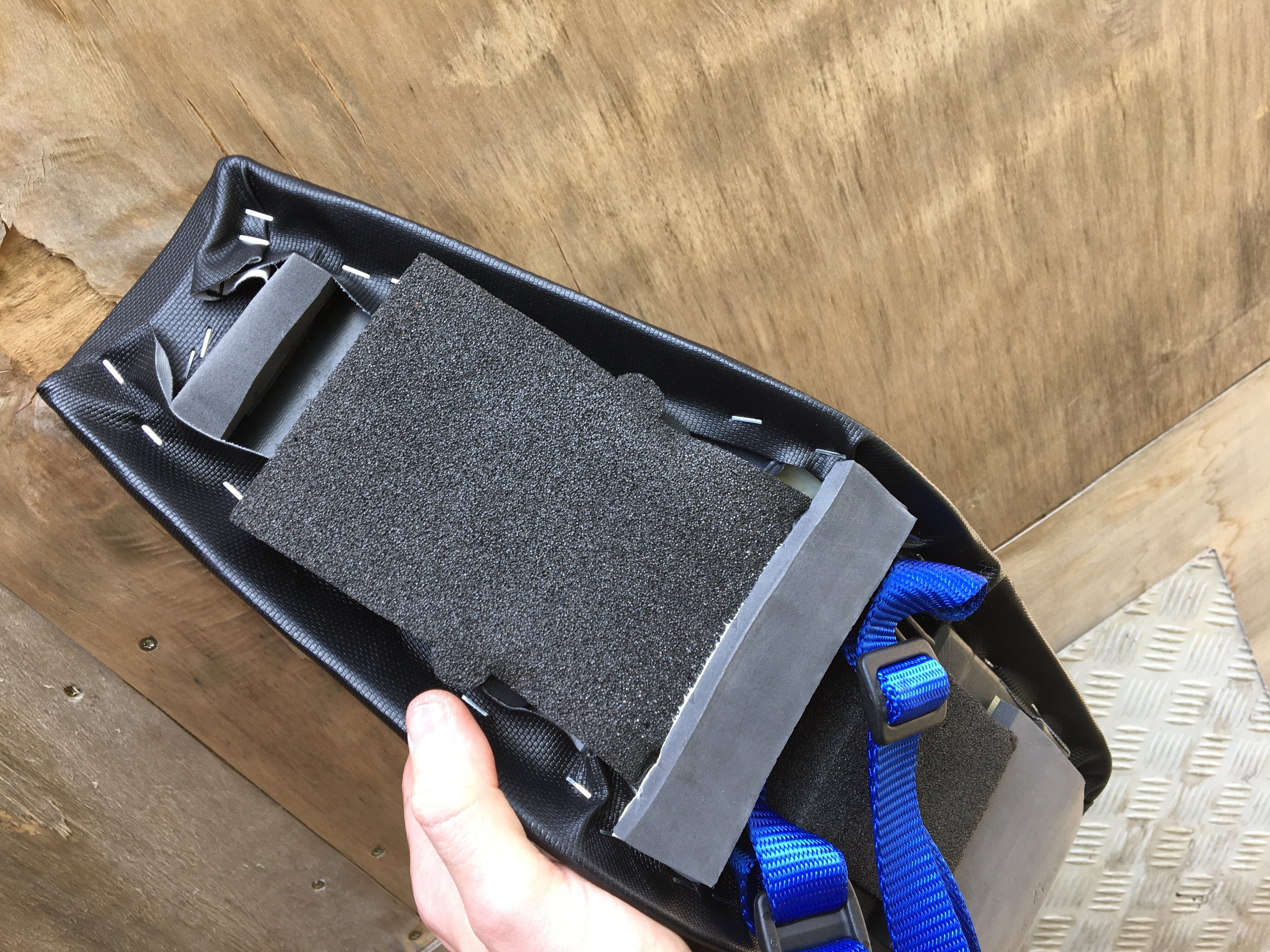

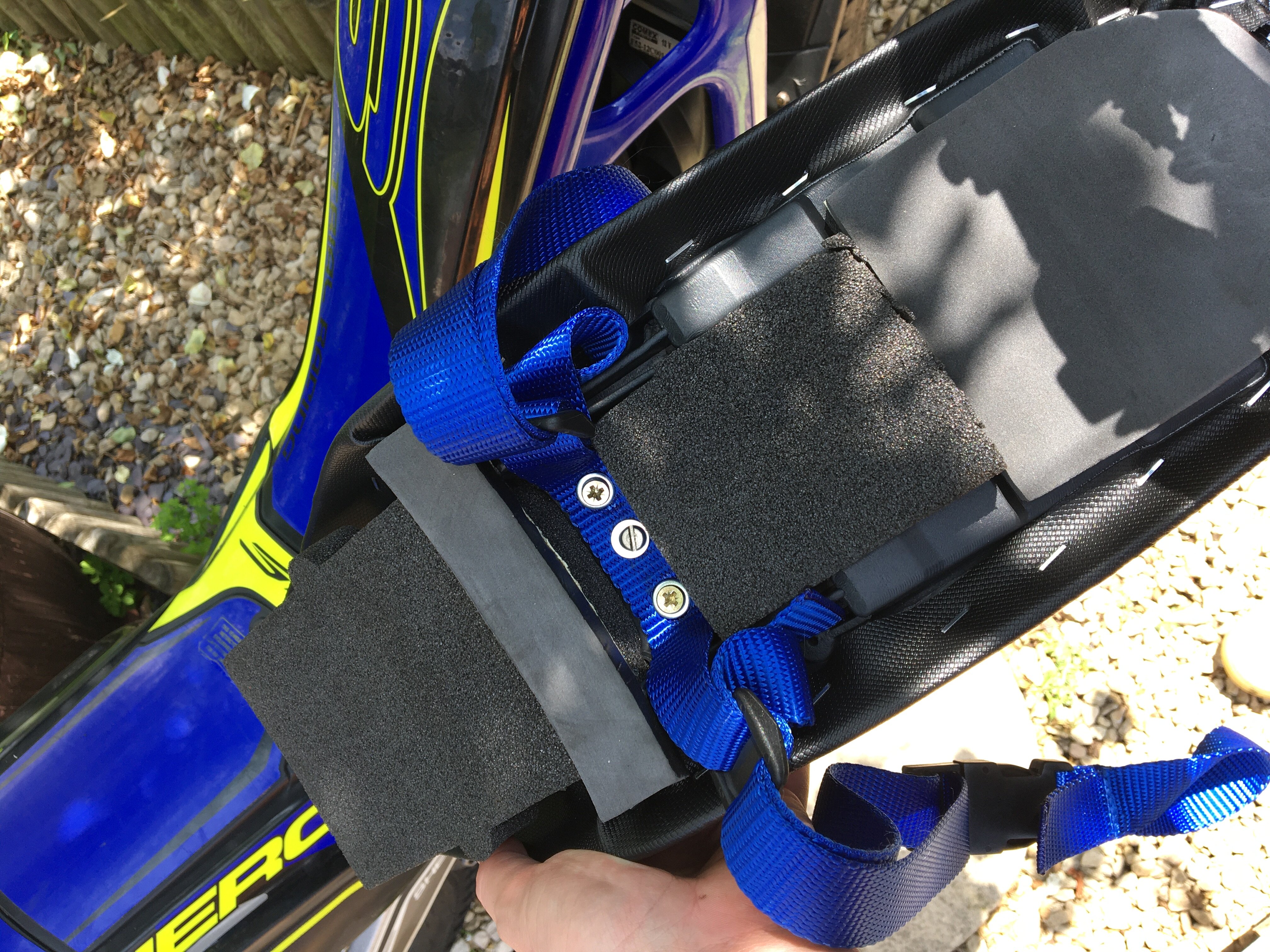

Nishijin Posted July 7, 2021 Report Share Posted July 7, 2021 There are threads across various forums. You’ll be recommended to just buy the Buttrest one for £50-odd. The alternative is using a pit bike seat. Someone actually made a ‘mushroom’ mount to lock it in place. Can’t find that link. You cut all the plastic tabs from the seat, then somehow attach it. I sewed up some loops and side release clips, then melted holes to avoid fraying the webbing when screwing to the plastic. 10mm foam stuck to avoid scratching the bike and to reduce the risk of slipping about. Haven’t tried it on the road yet, but felt secure enough. Quote Link to comment Share on other sites More sharing options...

Nishijin Posted July 8, 2021 Report Share Posted July 8, 2021 I haven’t had a chance to use it, but going back and lashing down tight, I didn’t like the risk of the screws coming out. It didn’t feel lashed down as tight as I’d want even for a quick couple miles. Instead, I have now removed some of the staples and run the webbing on the inside, between the plastic and the seat foam. This way it is a single continuous piece of webbing and the force is distributed across the width of the plastic seat pan. Immediately that I tightened the webbing, the seat pan formed better to the bike. I would recommend you do this rather than waste time trying to screw it on to the underside. Next steps are probably covering the underside’s added foam with a thin sheet of rubberised material, stapled to the seat pan. That would tidy up the appearance and hold everything firmly. Quote Link to comment Share on other sites More sharing options...

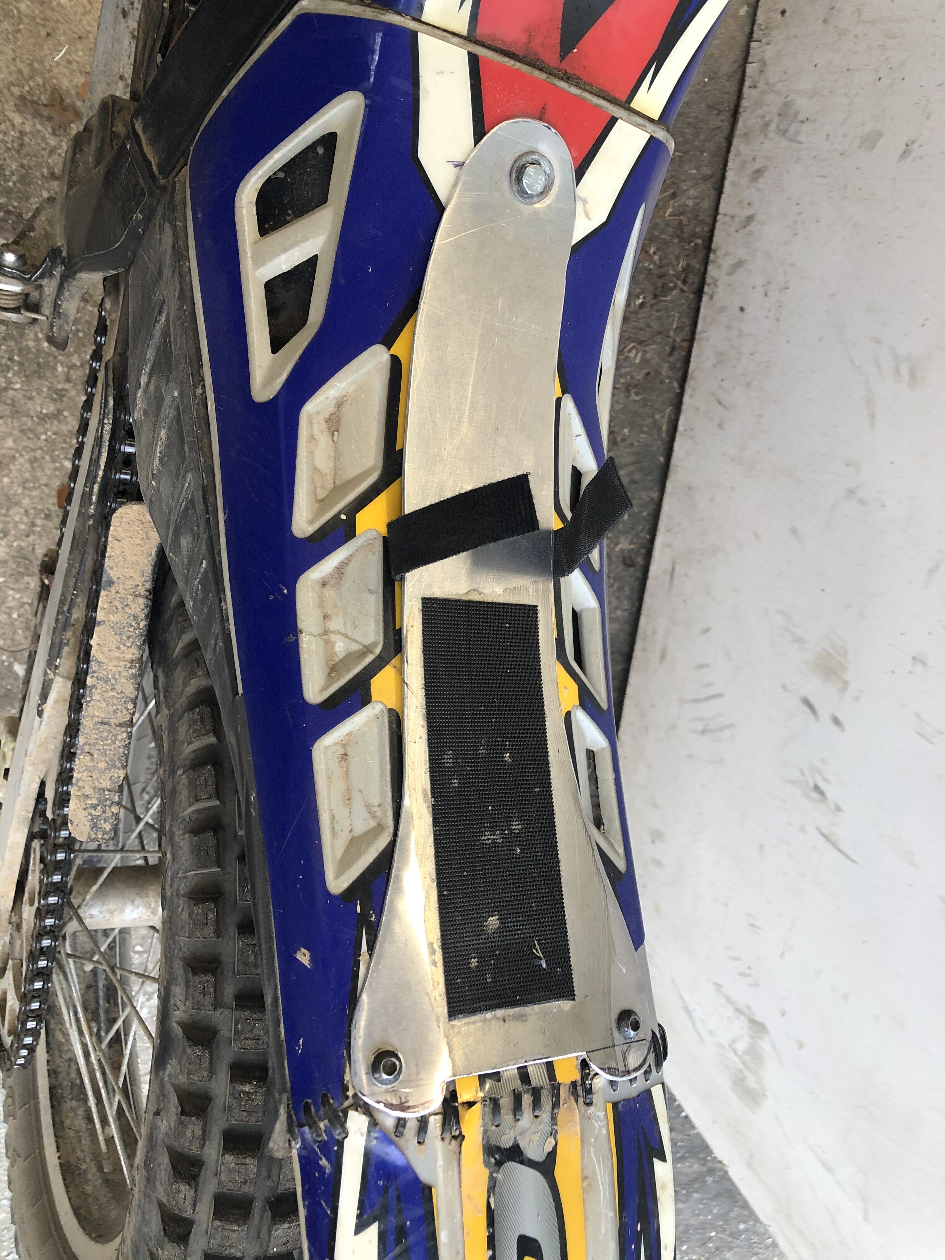

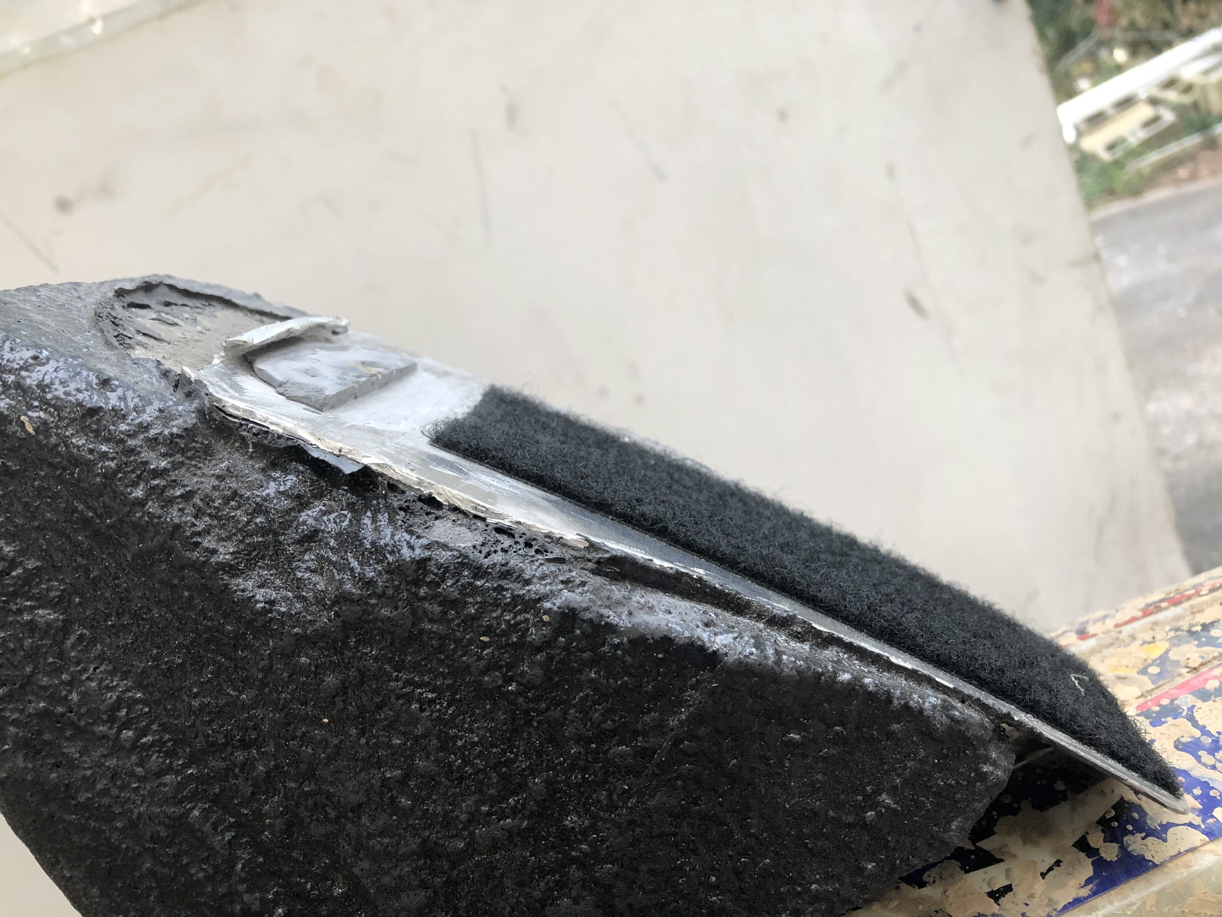

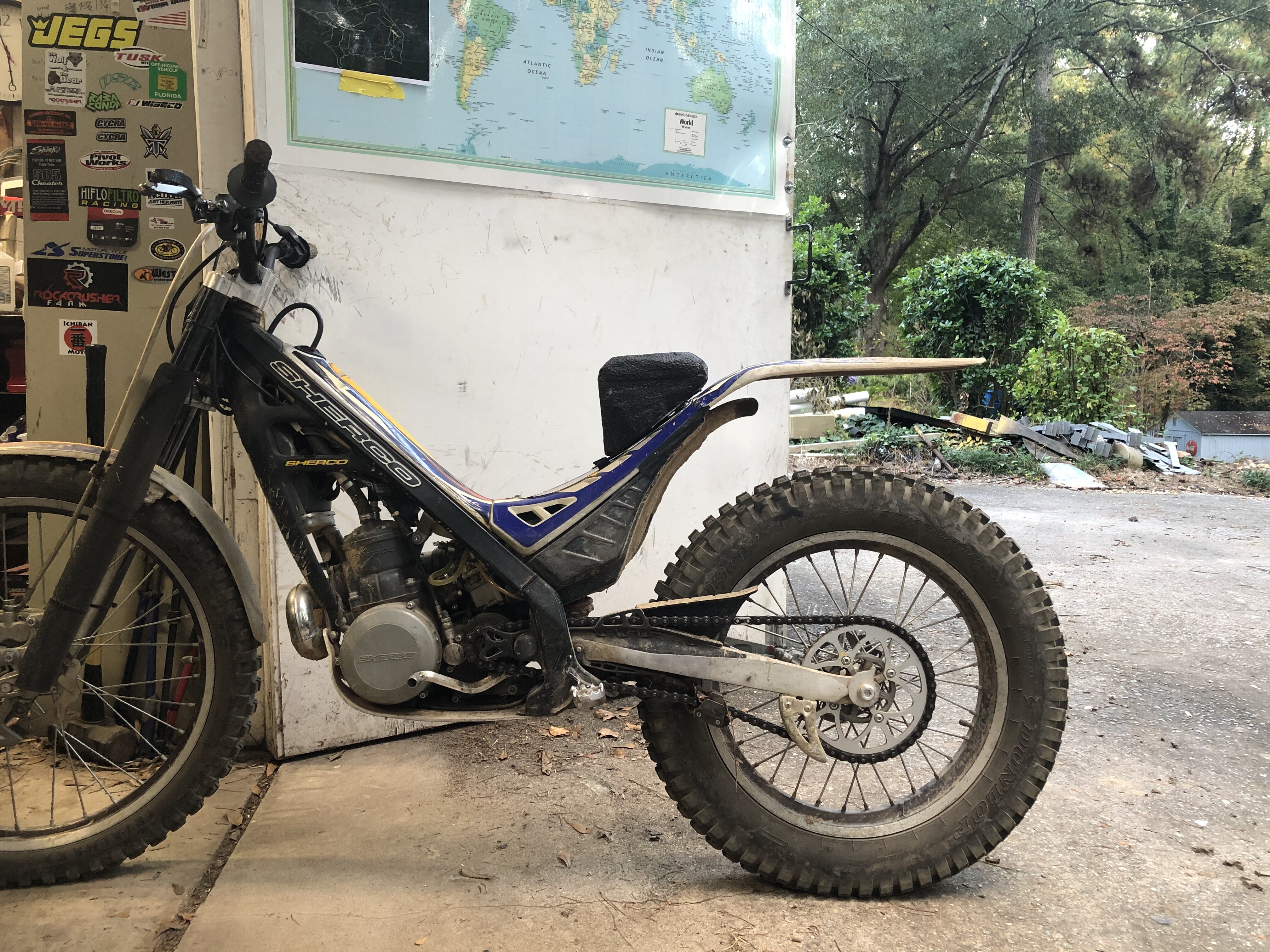

sectionone Posted July 8, 2021 Report Share Posted July 8, 2021 To ride comfortably sitting I like the seat to be the same height as the gas cap. This one that I made is easily removeable after I'm done trail riding and the mounting bracket always stays on. I've since added a knob screw to mount the front down and the back is held by the hook and velcro. I cut the seat from firm foam and coated with Herculiner. Quote Link to comment Share on other sites More sharing options...
Nishijin Posted July 9, 2021 Report Share Posted July 9, 2021 Only around 6 miles I think, back and forth a couple stops. Seat holds fine, and is comfortable ‘enough’. Totally appreciate why @sectionone prefers the seat much higher. Quote Link to comment Share on other sites More sharing options...
