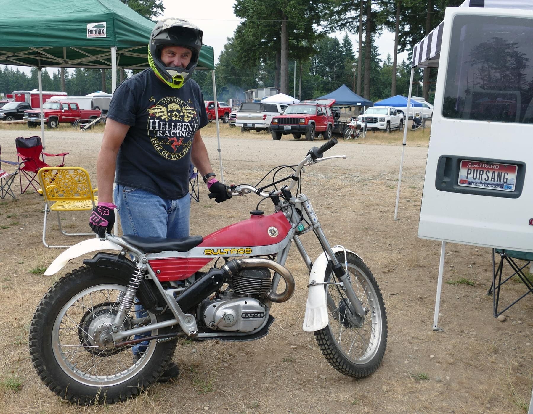

onthegas Posted July 30, 2021 Report Share Posted July 30, 2021 You don’t say what model of Bultaco you have. This is key. I have an M98 Alpina that I turned into a trials bike for vintage trials. I used the trans gears and heavier primary flywheel from an M91 Sherpa T to compliment all the other modifications. Quote Link to comment Share on other sites More sharing options...
