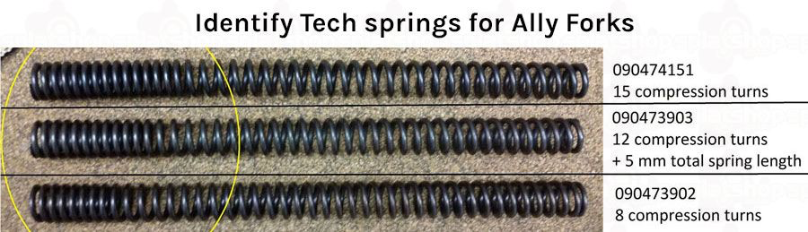

As far as I understand there are three Tech Spring options. A Soft, standard and stiff. The springs are identifiable by the number of compression turns. The standard spring (12 compression turns should be suitable for rider weight of 75-90Kg. I discovered this when I bought a Mont 300 (aluminium tubes), turned out that someone had replaced the stock spring with a softer spring. Take a look at Splat Shop's website and you will see this along with an indication of rider weights. Hope this helps.
