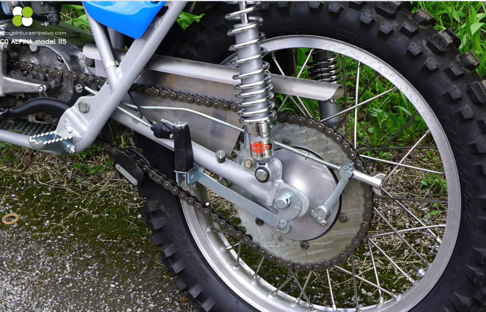

Divouneh Posted August 15, 2021 Report Share Posted August 15, 2021 Hello In my 250 Alpina (115), I am looking to install the rear brake switch in the swingarm... What do you have, pictures ? Thank you Divouneh Quote Link to comment Share on other sites More sharing options...
Divouneh Posted August 16, 2021 Author Report Share Posted August 16, 2021 I found this one in Internet...😒 1 Quote Link to comment Share on other sites More sharing options...

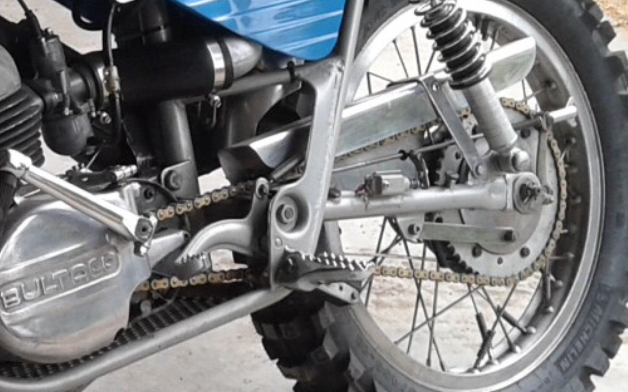

Divouneh Posted December 5, 2021 Author Report Share Posted December 5, 2021 I found this idea, I will try ... Just to be legal, I am always using the front brake first 😏.. Quote Link to comment Share on other sites More sharing options...
