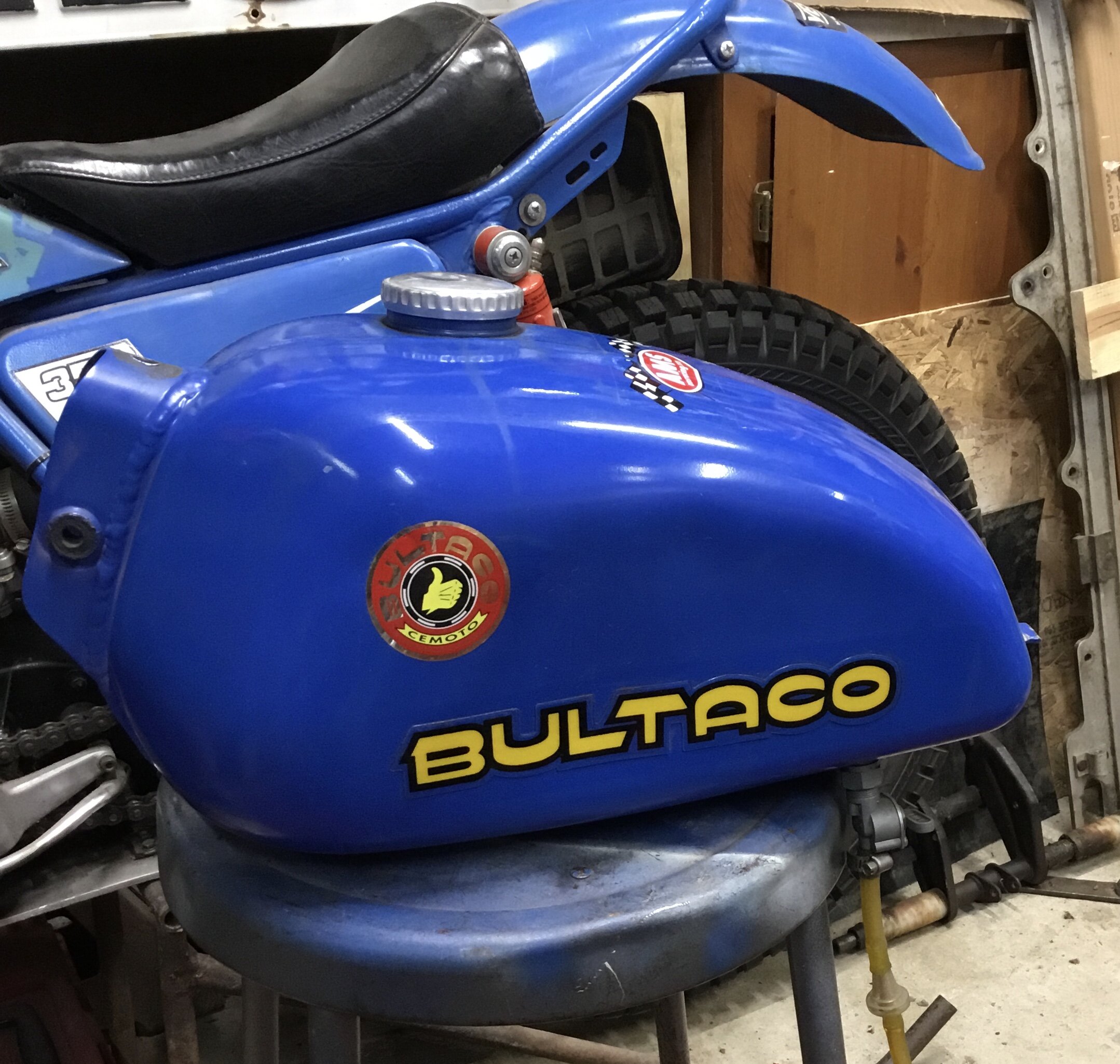

Fogcity Posted September 27, 2021 Report Share Posted September 27, 2021 Hi. Brand new member (and brand new to dirt). Just acquired a '73 Pursang with newly painted tank/side panels. I have another set of panels but I'd really like another tank, any tank, to swap on the bike before I destroy the one on there now. Any suggestions (other than finding another, old beaten up Pursang tank - I'm looking now) for a tank that I can adapt to this frame with little modifications? Many thanks. bultaco.pdf Quote Link to comment Share on other sites More sharing options...
scot taco Posted September 28, 2021 Report Share Posted September 28, 2021 I ran a 78/79 Maico tank on my 74 Pursang for a few years with no troubles. I used JB weld to secure a tab at the back of the tank and then a heavy zip tie to hold it to the frame. In the front I drilled the gusset in the frame for a through bolt. Quote Link to comment Share on other sites More sharing options...
