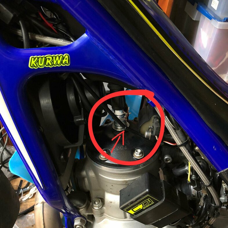

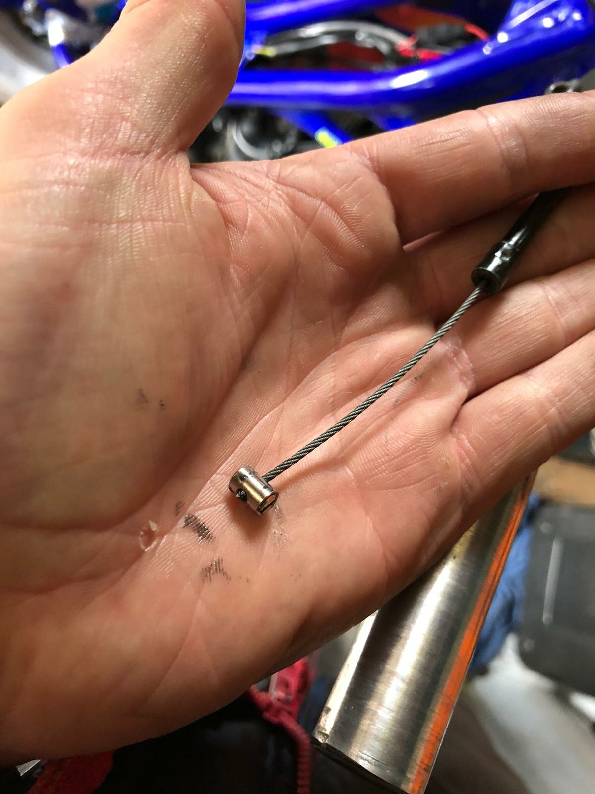

b40rt Posted October 5, 2021 Report Share Posted October 5, 2021 If you are very careful you can shorten the outer cable, which effectively give some slack for the inner. 1 Quote Link to comment Share on other sites More sharing options...
Nishijin Posted October 5, 2021 Report Share Posted October 5, 2021 2 minutes ago, b40rt said: If you are very careful you can shorten the outer cable, which effectively give some slack for the inner. Agreed. If you have a dremel handy (if not, check Lidl/Aldi this week) you can mark and cut the outer and with some finesse, leave the inner intact. Alternatively grab a ‘cable repair kit’ set like Oxford sell. You cut the old cable out, ideally at the throttle end. Fit the new (repair) inner cable, and cut some cm’s longer than the original. Then you attach a barrel end to the throttle side, and with the adjusters, work out how much slack you want before cutting (and ideally soldering) the excess. The second option is what I did with my Sherco, as I didn’t like the look of this kink in the outer when I bought the bike used. I actually cut a whole length of bicycle brake outer, added ends and fitted a new cable. It was cheaper than purchasing as I had all the parts laying around. Quote Link to comment Share on other sites More sharing options...
Nishijin Posted October 5, 2021 Report Share Posted October 5, 2021 Like so Quote Link to comment Share on other sites More sharing options...
