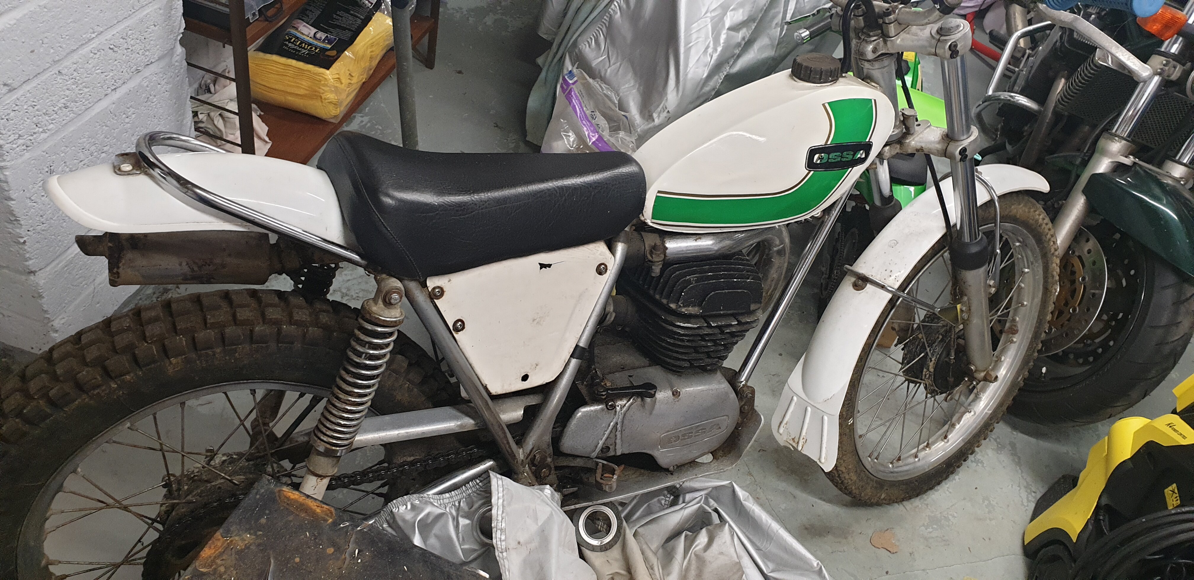

wiyon Posted October 27, 2021 Report Share Posted October 27, 2021 Hi I am new to Ossa and would appreciate some help with the identification of my bike, cc, model and year of manufacture I originally believed the bike to be a Mick Andrews replica 250cc approximately 1975. I have looked on Ossa frame and engine number lists and cannot find this one, the frame number is B430092 and engine number M430092. Also is anyone aware where I might be able to purchase a manual/service repair/parts list book for this bike. Thank you in advance Wiyon Quote Link to comment Share on other sites More sharing options...
feetupfun Posted October 28, 2021 Report Share Posted October 28, 2021 It certainly is 1975 vintage and looks exactly like mine apart from yours having a British fuel tank. I too have looked through on-line OSSA ID lists and not seen a prefix 43 model mentioned. I have a suspicion that your bike model may be very rare hence not well known enough to be listed. The production sequence number on yours (92) is extremely low which could also align with there being not many of them made. I'm wondering if it might originally been a 175cc Mk2 MAR rather than a 250cc Mk2 MAR 1 Quote Link to comment Share on other sites More sharing options...
woody Posted October 28, 2021 Report Share Posted October 28, 2021 Prefix 43 is a '75 310cc MAR. There are a couple of chassis prefixes that are missing from the ID charts for some reason Fingers crossed your engine is in good order as the 310 cranks can crack around the pin and are like rocking horse teeth and 310 pistons are also very hard to find 2 Quote Link to comment Share on other sites More sharing options...

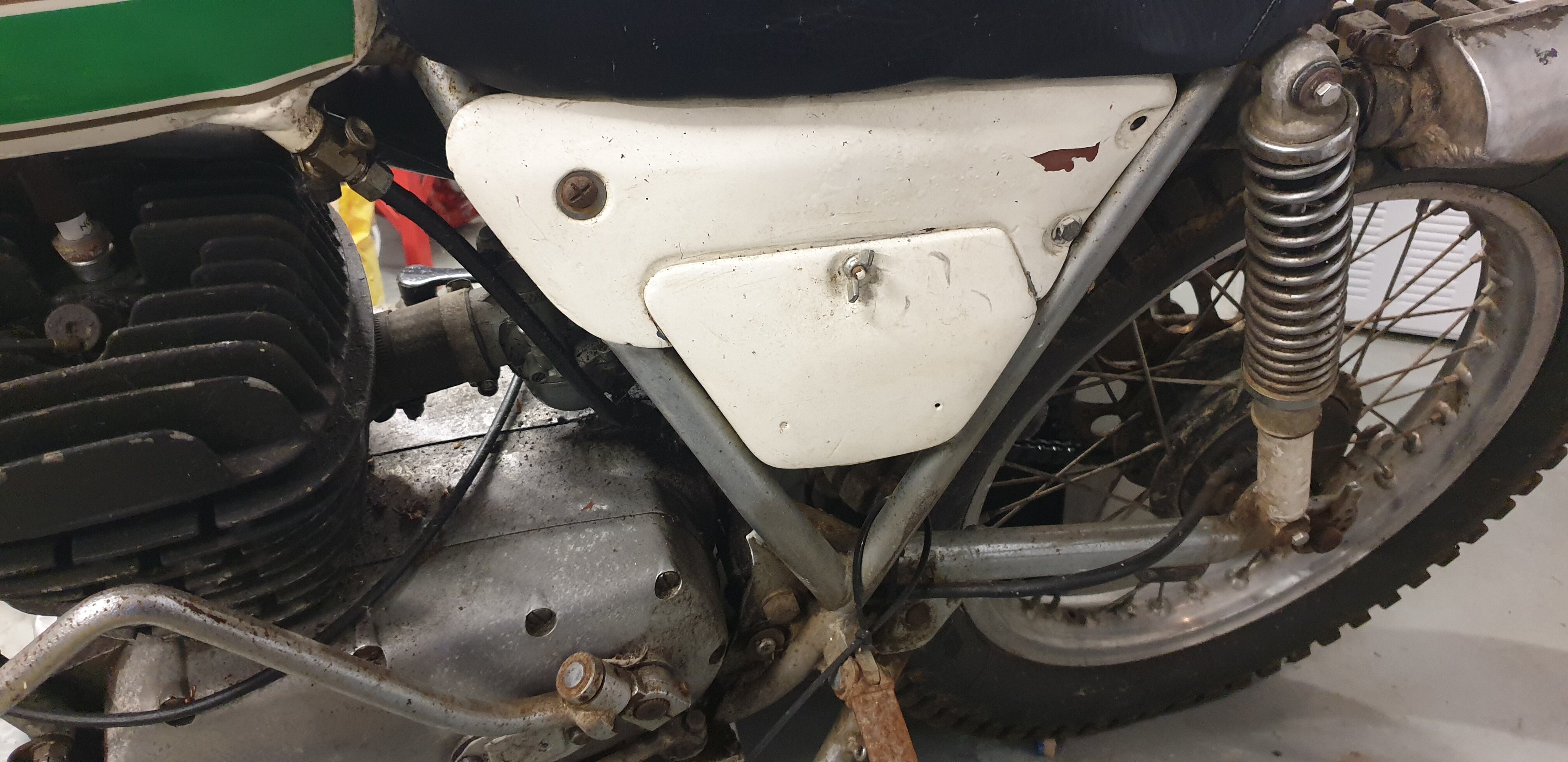

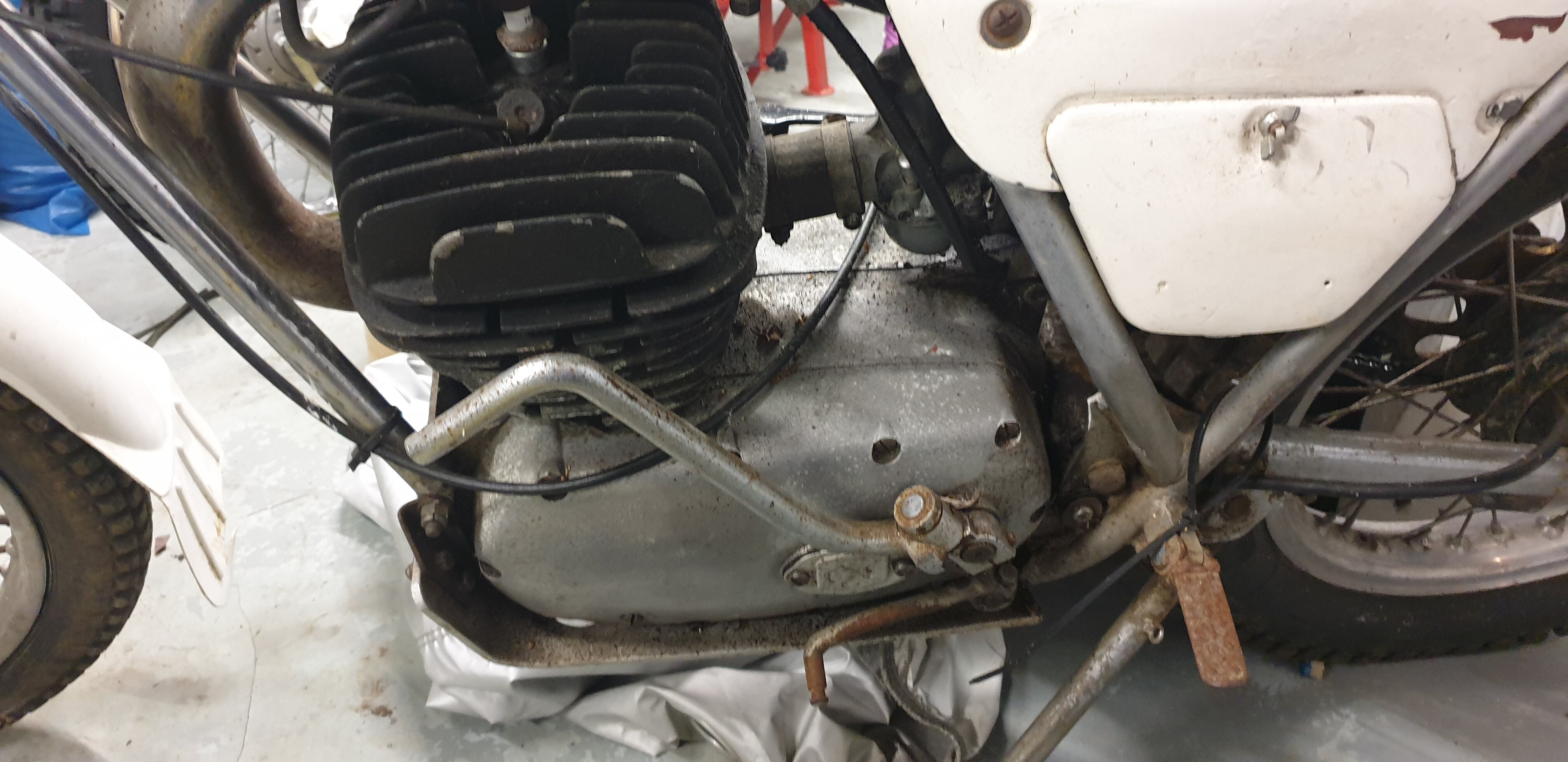

cleanorbust Posted October 28, 2021 Report Share Posted October 28, 2021 The interrupted cylinder fins suggest 310 rather than 250. The green-only tank stripe might make it look like a 250 (310 was green and orange) but the striping on the bike in the photo isn't original. 1 Quote Link to comment Share on other sites More sharing options...
phiggs Posted October 28, 2021 Report Share Posted October 28, 2021 That wing nut on the additional side panel looks to be an accident waiting to happen... Quote Link to comment Share on other sites More sharing options...
