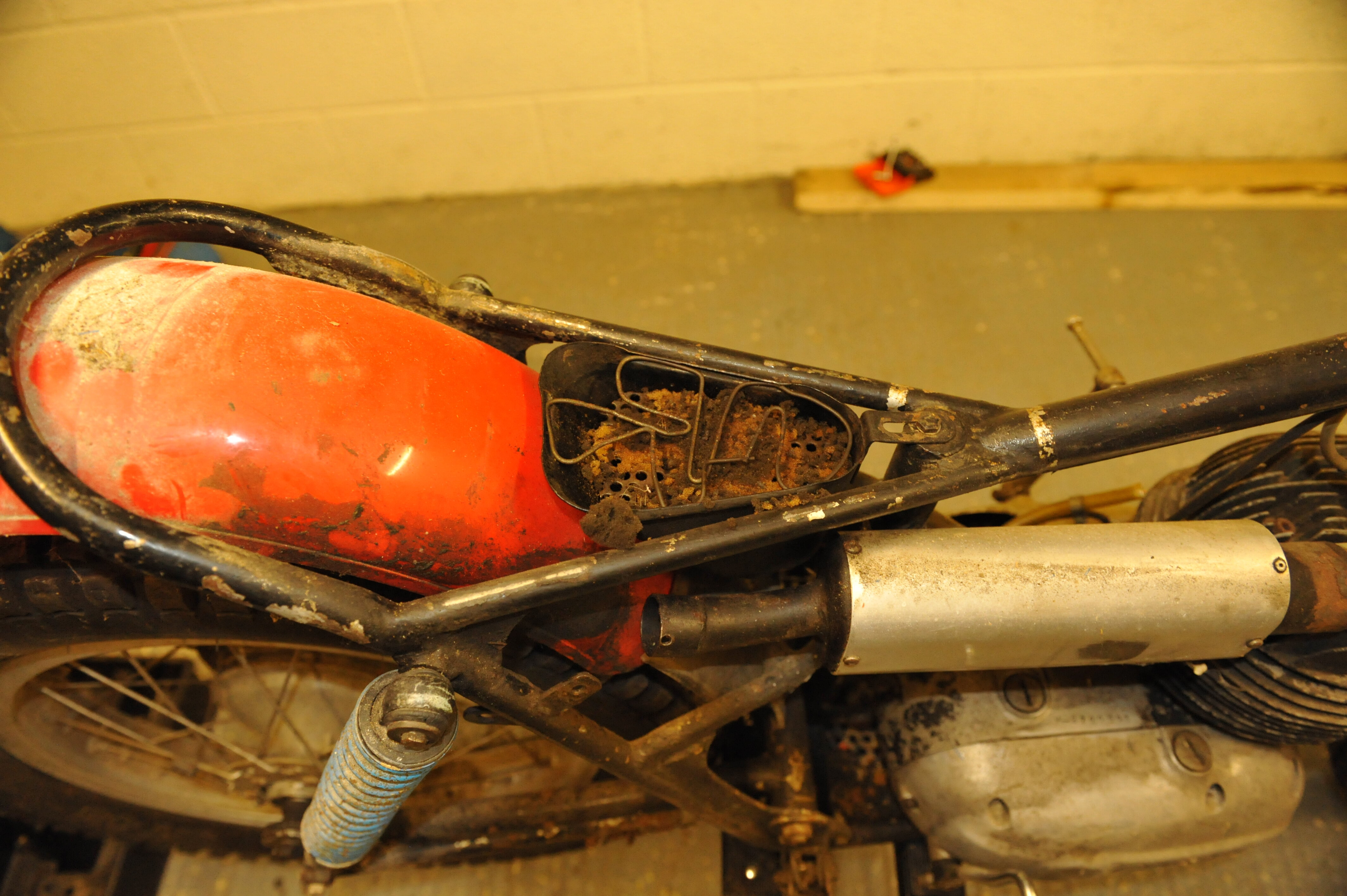

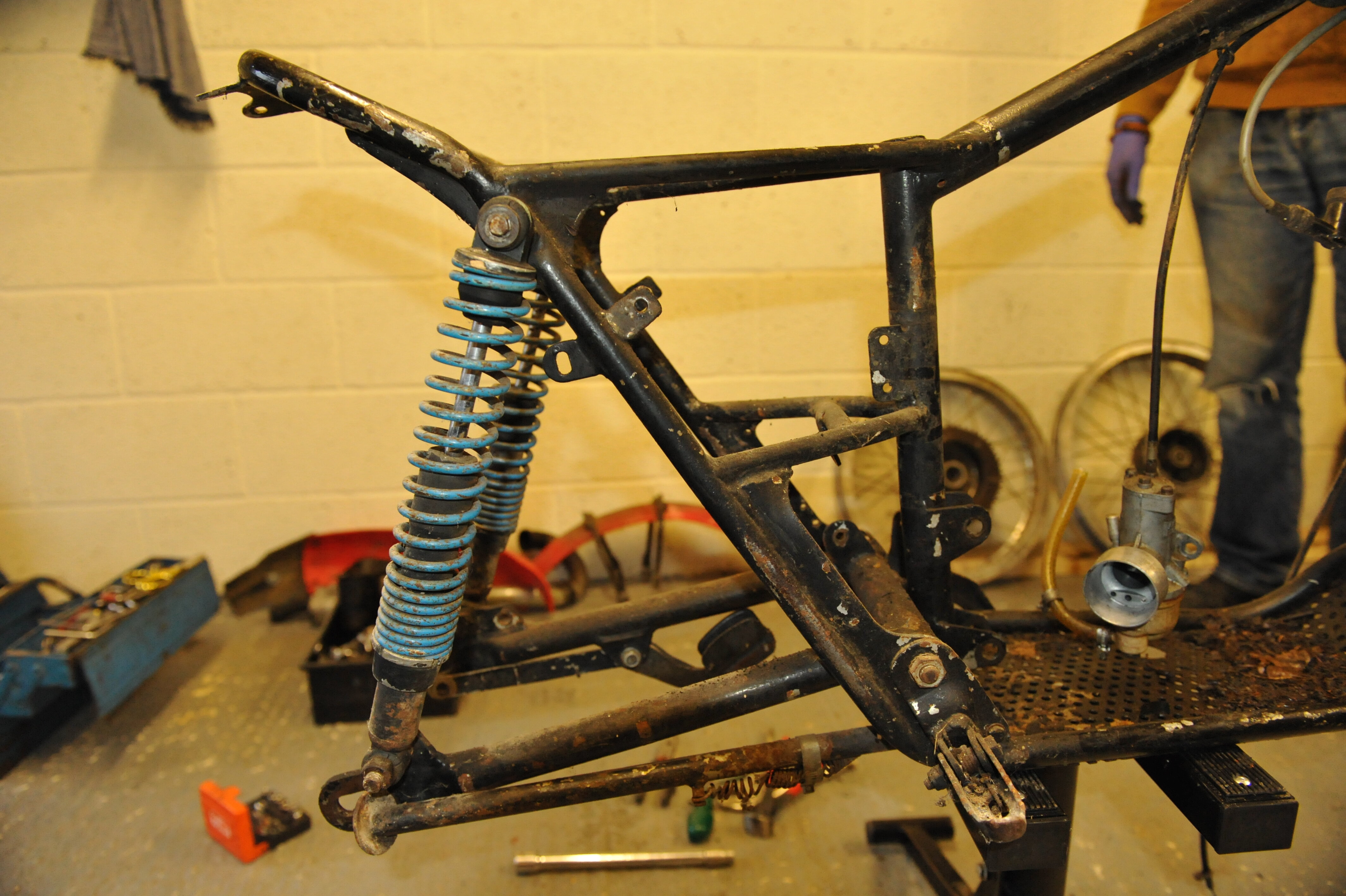

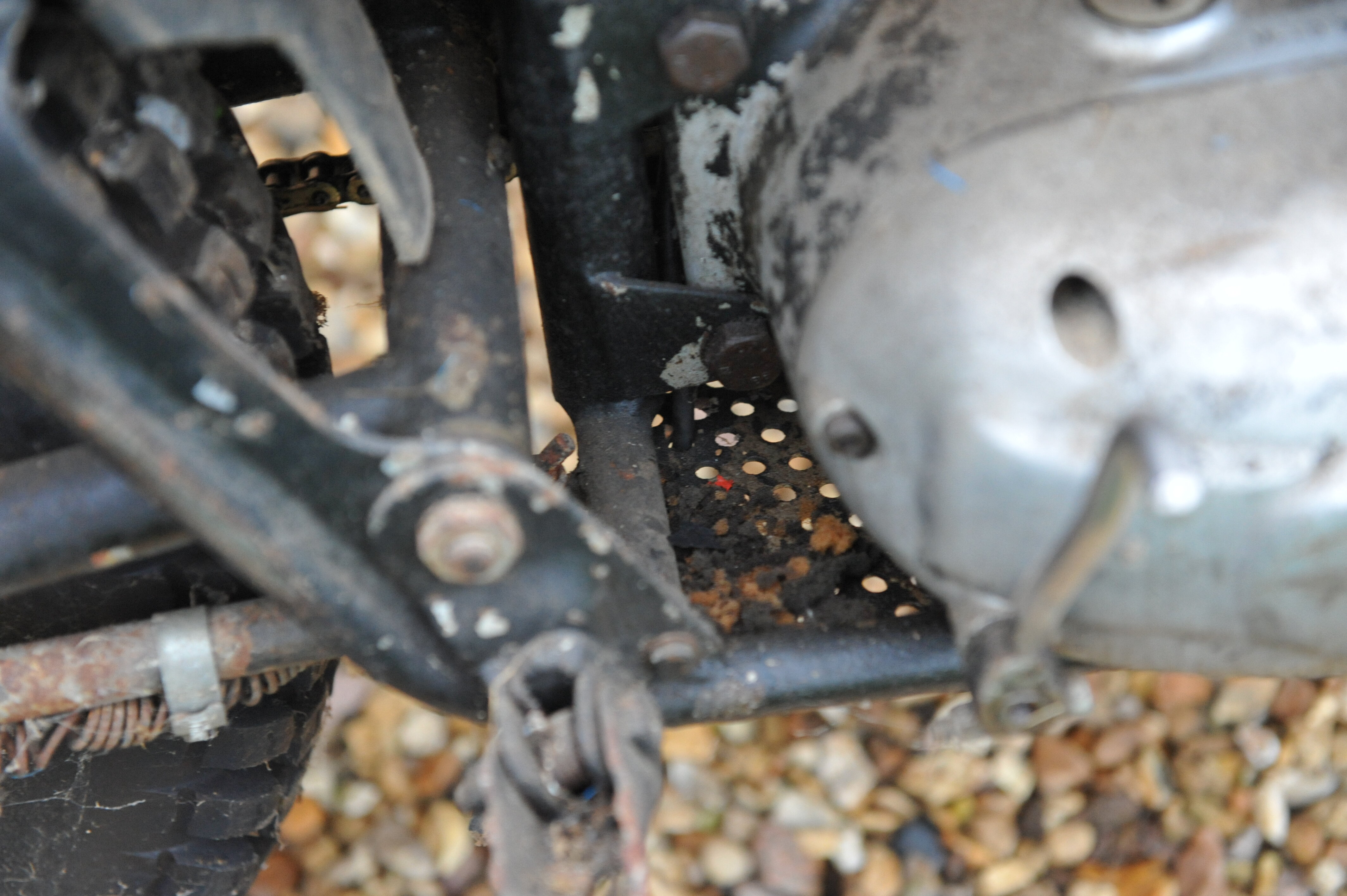

Ainsley Posted November 14, 2021 Report Share Posted November 14, 2021 I have owned this 1967 Bultaco Sherpa T for ages, it was the first bike I bought and rode.Originally bought in 1982 for £400, I did some competitions on it then sold it when I was skint.Years later bought it back off the chap I sold it to, he needed the money, but it was in bits in a box then. He had road registered it and had it taxed and running on the road at one point. So it does have a number registration YMO 215F.I did a few more competitions on it, but it needed a restoration even back then. There was no working front brake when I last rode it back in the early 90's.Its sat in the corner of my garage getting dusty since then. So I've now decided to fully restore it back to original spec. A weekend of research leads me to at least know its year and model number - I think. Looking at the various websites, the matching chassis and engine number tell me its model 27, but the tank / seat unit seem to be from a later model. Except I did read those, plus a different exhaust, came as a competition upgrade. However, all the pictures I've seen for the 27 do not show a built in sump guard, whereas mine has one.Can anyone confirm the 27 did come with the same built in sump guard as mine ?I've been to see a chap who can rebuild the engine and wheels, I've also seen a chap who can clean up the frame and paint it. I want to do as much as I can myself, but happy to pay experts to get an expert result. Last time I rebuilt my KX250 motocross bike about 4 times, probably four times because I was not too good at it. So paying someone to do the Bultaco professionally should mean its done once.Just to add a bit of oddness, the gear lever is on the right and the brake on the left. Side stand is also on the right hand side. I believe that's so they could import and sell in the US. Harley made the US government rule that all bikes had to have left hand brakes to stop the competition, so Bultaco got round that by having the ability to switch them left to right. Quote Link to comment Share on other sites More sharing options...

woody Posted November 14, 2021 Report Share Posted November 14, 2021 The frame isn't a model 27 frame, it's from a later model, looks like a model 80, could be a late model 49 or even an Alpina. The number on the headstock would normally identify it but if that is a prefix 27 number it has been restamped. The M27 frame didn't have a mesh guard between two frame tubes, it had the Y shape frame under the engine with a bolt on sump guard To restore to an original M27 spec is going to be an awful lot of work and first you need a frame. Also a tank, seat, airbox, sidepanels. It's going to cost a lot. Personally I wouldn't bother, you have the basis of a useable bike which you could use and enjoy for what it was intended - throwing up sections. Does it matter if it is a non matching frame/engine, it won't cost you marks in sections... You could make it look like a model 80 slimline for a lot less than trying to restore to M27 looks. I'd guess Motofibre could restore the tank side piece where it's been cut off for the exhaust. Recover the seat, get the exhauist altered to the correct angle and you're nearly there. In terms of engine performance there is little if any difference between the M27 through to M80 range The upgrade you mention was made available to convert the model after the M27. the M49, to M80 spec 1 Quote Link to comment Share on other sites More sharing options...

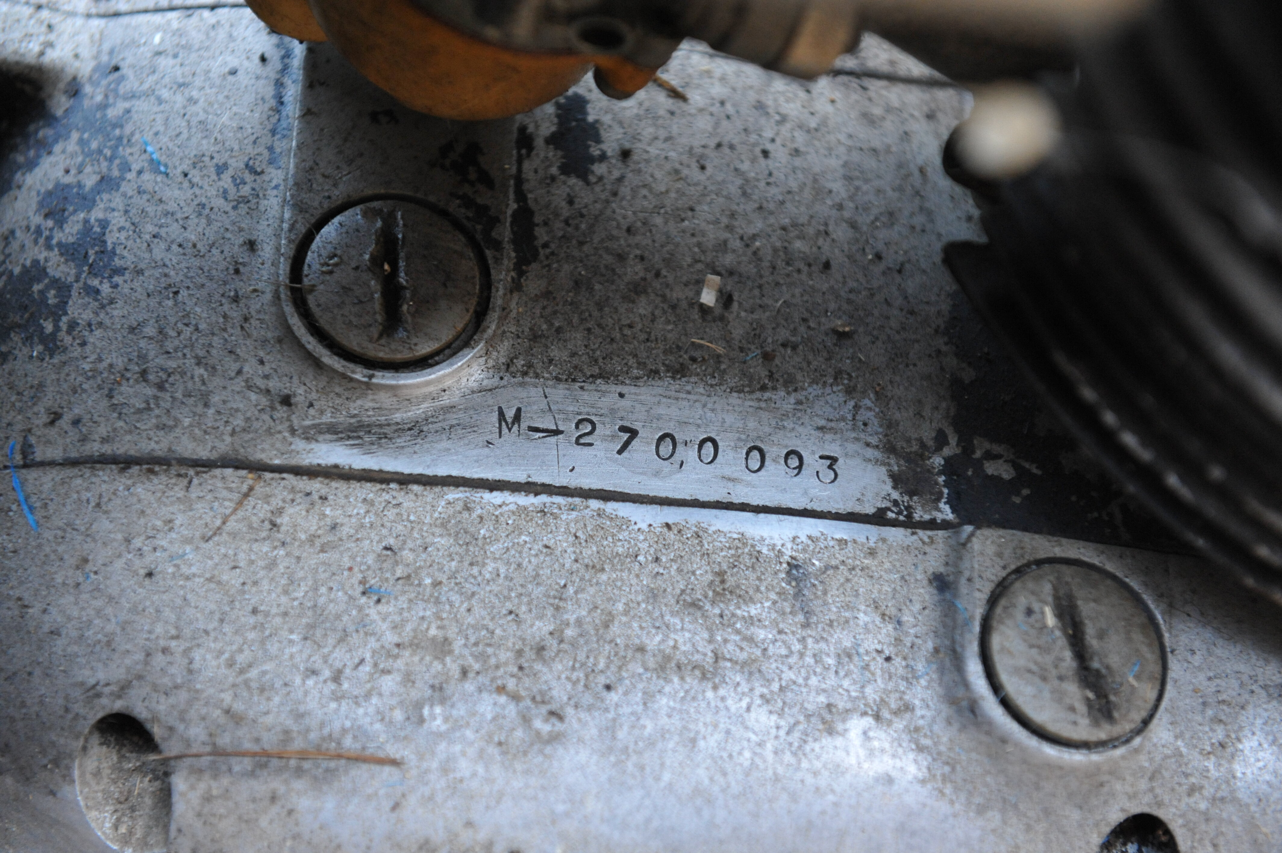

Ainsley Posted November 14, 2021 Author Report Share Posted November 14, 2021 Ah, so someone stamped a false number on the frame then. Blimey, wonder why they did that. Id better start looking at model 80's or 49's then. I assume the engine is a model 27, though, or do you reckon that's been "adjusted" as well ? Quote Link to comment Share on other sites More sharing options...

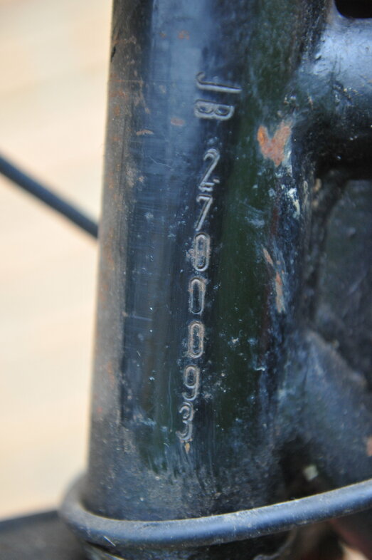

Ainsley Posted November 14, 2021 Author Report Share Posted November 14, 2021 (edited) This is the frame number. Edited November 14, 2021 by Ainsley Quote Link to comment Share on other sites More sharing options...
rcgods Posted November 14, 2021 Report Share Posted November 14, 2021 Bultaco never stamped their frames that way. And its on the wrong side of the headstock. Should be on the throttle side and running like the JB in that photo. 2 Quote Link to comment Share on other sites More sharing options...
Ainsley Posted November 14, 2021 Author Report Share Posted November 14, 2021 Ah. Oh well, perhaps they figured it would be good to have matching numbers then. When I first bought it in the early 80's I never looked, or know about numbers. Could have been done by the chap I sold, then bought it off, but not sure why he would do that. Its not like he tried to sell it for any money, I bought it back off him for about 400 quid I seem to remember. But it does seem to be a 27 engine though. Quote Link to comment Share on other sites More sharing options...

woody Posted November 15, 2021 Report Share Posted November 15, 2021 2 hours ago, Ainsley said: Ah. Oh well, perhaps they figured it would be good to have matching numbers then. When I first bought it in the early 80's I never looked, or know about numbers. Could have been done by the chap I sold, then bought it off, but not sure why he would do that. Its not like he tried to sell it for any money, I bought it back off him for about 400 quid I seem to remember. But it does seem to be a 27 engine though. As mentioned above the frame number is a DIY stamping, not Bultaco, The number isn't even formatted correctly as there should be no 'J', that prefix was introduced around 1975, it should just be a B prefix. It would need to have a frame number related to its age to get a dating certificate to register it on an age related plate, that's probably why it has been stamped up like it is. If you take the paint off the other side of the headstock you might find a trace of the orginal number unless it's been completely ground away Engine stamp is genuine Quote Link to comment Share on other sites More sharing options...

woody Posted November 15, 2021 Report Share Posted November 15, 2021 2 hours ago, Ainsley said: Would the exhaust for that engine fit properly into the later 80 frame ? Or is that why its been bodged ? It fits the frame as you can see as it's already in there, but it isn't the right exhaust for that tank/seat unit which is why it's been cut. The model 80 silencer slopes down to the footrest. It also has a small triangular end silencer between the frame and the shock but the bracket for that has been cut off. Just google images for model 27, 49 and 80 and you'll see the similarities and differences Quote Link to comment Share on other sites More sharing options...
