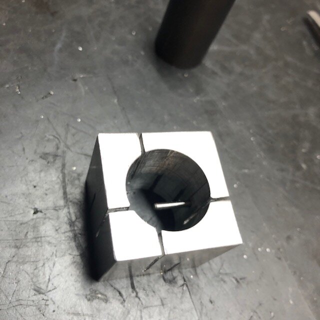

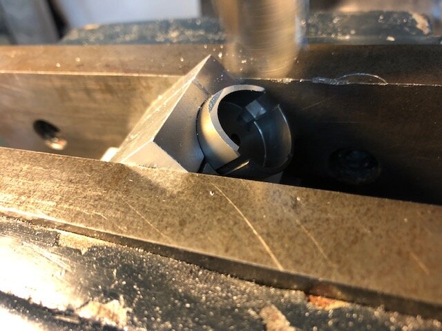

mcman56 Posted April 20, 2022 Author Report Share Posted April 20, 2022 Troubleshooting further, I did notice a little black smoke at the stumble spot so it was in fact rich. Increasing the slide cut away from 2.5 mm to 3.5 mm like the OEM TL250 carb has eliminated the issue. When looking on line how to cut the slide, I found nothing so will pass on how I did it. See pics. If you are good at doing things by eye, it would be much simpler to use a file. 2 Quote Link to comment Share on other sites More sharing options...
