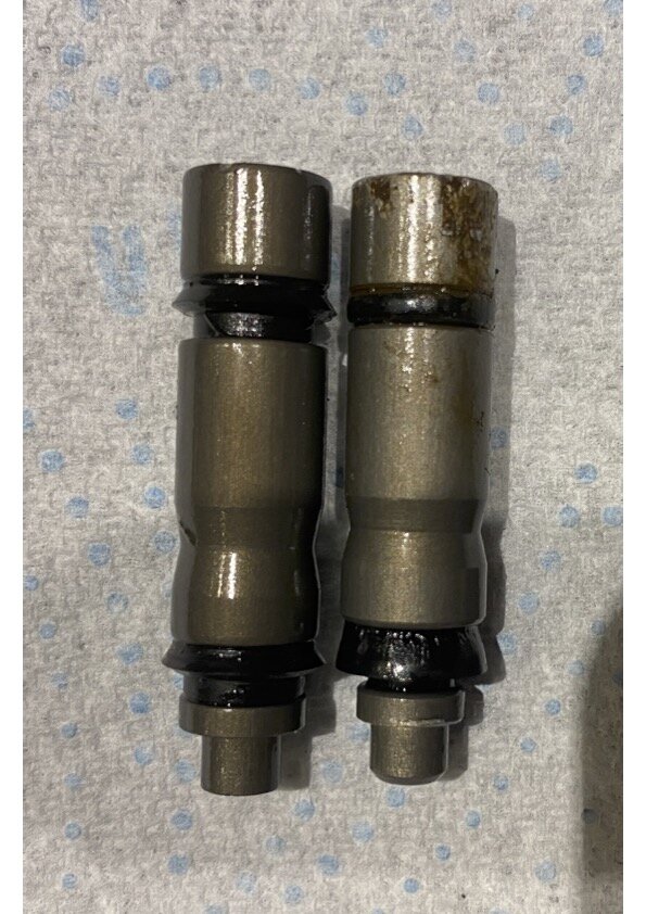

Hello. I was replacing the rear master cylinder piston on a 125 txt I picked up for my son and it wouldn't bleed at all afterwards. After checking some of the threads here I pulled it back out and put a syringe on it to force some fluid through but it seemed to be blocked.
After taking the piston back out it appears to be a different length to the original (longer) and the seal blocks the port from the reservoir once the circlip is installed. Is it me being daft or is the piston wrong? It came in the proper kit for this master cylinder.
