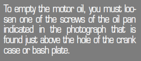

This is from an 03' manual:
image.png.cc5fa3604593537beecbf9bc6e1cc882.pngimage.png.a33d5dd87c9776b8148e9cfc6979d986.png
The translation to English leaves a lot to be desired. Basically, you remove a left side case screw below the shift lever. It should have a triangle above it. Make sure you don't miss the sealing washer.
