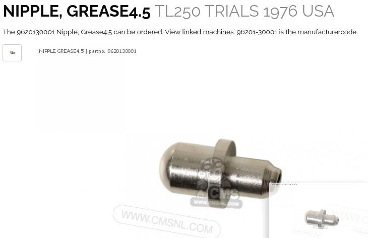

mcman56 Posted January 20, 2022 Report Share Posted January 20, 2022 The TL250 has an external grease fitting for a the clutch actuator on the left side cover. This does not look like a standard grease fitting and the standard tool does not fit. See picture. How do you fill it? I thought about threading in a standard fitting but it would stick out farther and would be easy to tear off. Quote Link to comment Share on other sites More sharing options...
lineaway Posted January 21, 2022 Report Share Posted January 21, 2022 (edited) Old school needle type grease fitting. Even in the 90`s alot of trials bikes took a needle type fitting Example of these. https://www.amazon.com/Low-Profile-Grease-Zerks-5-Piece/dp/B07B8WM3QZ/ref=sr_1_15?keywords=needle+grease+fitting&qid=1642730422&sr=8-15 Edited January 21, 2022 by lineaway 1 Quote Link to comment Share on other sites More sharing options...
Glayne Posted January 21, 2022 Report Share Posted January 21, 2022 Chainsaws also use these on their bars, I bought one from our local chainsaw shop. I believe it was maybe 12$ Quote Link to comment Share on other sites More sharing options...
